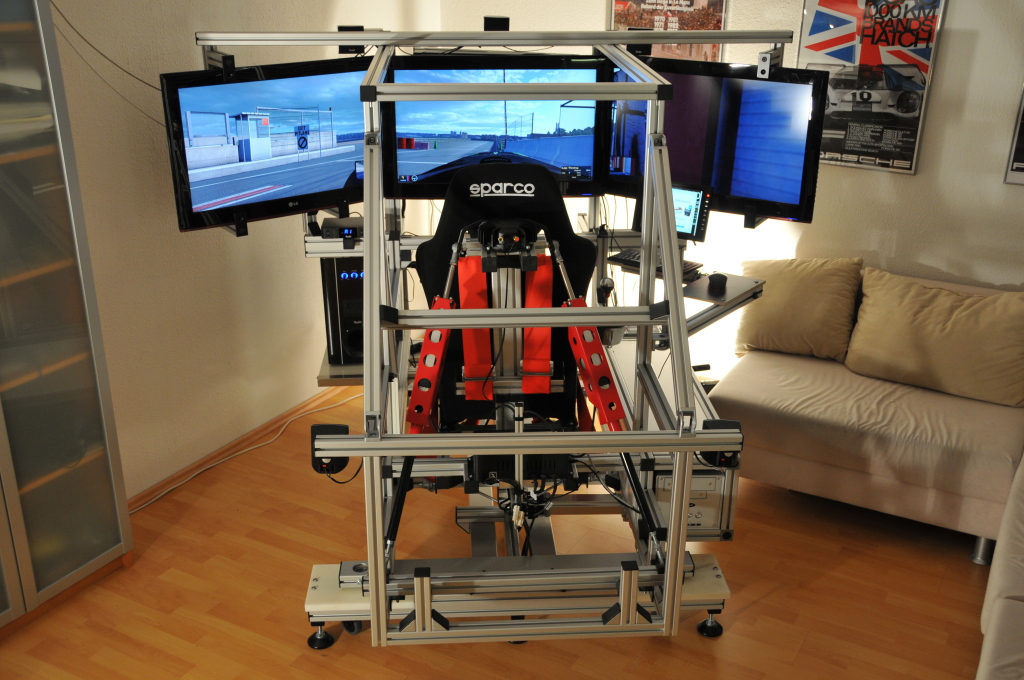

    Looks great with nicely timed and accurate movements.
    How does it feel to drive?
    A superb looking and motion sim in my opinion A+++++

    Hm, how should I say it. The motion looks very good, precise and defined and it feels even better, but... hm, there is no x-sim anymore powering this rig. I am testing a new software because the silence here in this forums afraids me, and this software feels so much better. My old profiles felt spectacular but they never felt precise and realistic like the new ones. . Now I believe my rig what it is doing.
    If someone had let me testride the same rig but said he had upgraded some hardware for movement enhancements I would have spend 2000 Euros after that test ride, just because of that big difference.... But it was only software that was changed.

    Schaut wirklich super aus..... :) Bemerkenswert, dass die dritte Achse soviel Mehrwert bietet.

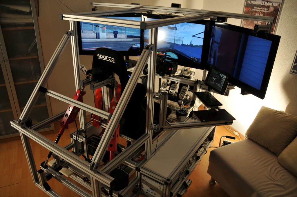

    Because my old pictures server (.mac from apple) stopped service here some new:
    here you go:
    more pictures here (and some more gallerys with all construction pictures with details)
    http://s1066.photobucket.com/albums/u413/PiezSim/Final Rig Showcase
    Panorama aus 3 Bildern, daher die miese Qualität
    http://www.youtube.com/watch?v=2srJXTwnRy4&list=UU9_0l62A-wQUU59XDqkZJiA&index=4&feature=plcp
