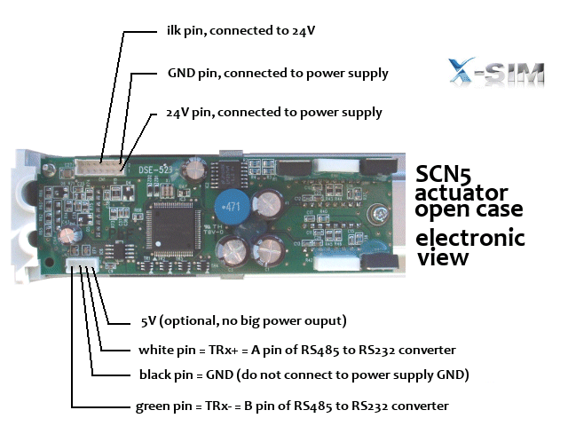

    Anyone know how to identify and where to buy the two small wire plugs on the inside of the SCN5 plastic cover?

    you could tell me the codes of contacts? the plastic is: H3756-ND and A25571-ND in DIGI-KEY site but contacts? I can not understand what they are.
    Thank you.
  7. bvillersjr
    bvillersjr Active Member
    Oct 11, 2008
    1,174
    Ohio, USA
    437Coins
    +23 / 1 / -0
    Re: SCN5 Hardware Thread
    I would prefer connecting them internally buy connecting the smaller plugs shown above. The number on the plugs are as follows.:
    Larger 14-pin Plug # - H JST 14
    Smaller 4-Pin Plug # - HJST II 4
    Anyone have any ideas where I can buy these?

    Look here http://www.jst-mfg.com/c00sea/SearchIchiran00_e.html

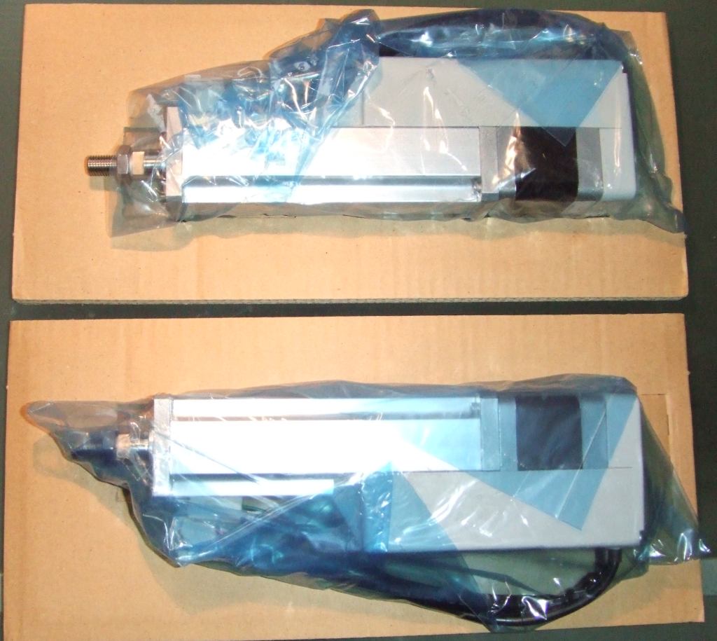

    I've picked up my pair of SCN5 100mm today :yippiee:
    Just had to pay 19% EuSt = 95,81Euro. Mirai marked the correct Taric code on the parcel and saved me a lot of explanations this time :thbup:

    Christian
