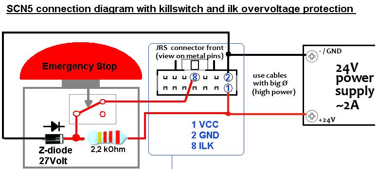

    Hi sirnoname,
    thanks for these hints !
    I already bought these 2,2k resistors (tried both, 0.5W and 0.25W - I guess the 0.25W one is better, isn't it ?) and will go to the Conrad store tomorrow to buy the Z-Diodes. Could you please give me the exact specifications ? (Maybe you have a Conrad catalogue and have access to any ordering number) I just want to buy the right ones ;) ... thanks in advance !
    If you need some parts from there as well, give me a short feedback - I can get them for you and we could manage a short meet 'n greet on weekend (Augsburg) for exchanging the parts.
    Another question: Does the new changed ilk protection schematic change anything on the position of the emergency switch ??? The switch is missing on the new graphics !
    Thanks in advance + best regards,
    Chris

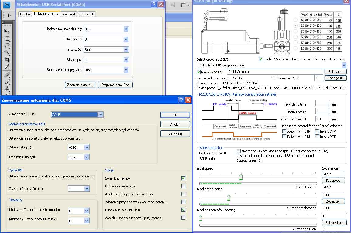

    Hi all!
    I hope this is the right thread to post my problems. I seem to have seen something about the first one once, but I just cannot find it now, so here goes:
    The first thing is that on one of my two machines the system sometimes loses one actuator. The RS converter shows no errors in the windows comport setup, but the actuator suddenly stops and is not seen by the Profiler at all. Once it came back on quickly after I reconnected it and reran detection, but on another occasion I just could not have it come on again (maybe because I was panicked - it was a corporate event). On both occasions it happened after about 2h of continuous play.
    My system is a converted Frex setup, with FTDI-based converters. No emergency button - I use a switchable socket on my power strip instead (actually never used it over the 3 years I've had it). I have not connected any resistors between pins - was not sure if instructions about resistors apply to Frex-modified SCN5's the same way.
    I have attached my comport and SCN5 setup. You may also want to know that my Athlon 3000+ is struggling a bit with X-sim software - X-Sim slows rFactor by about 1/3 of the FPS count on that machine. I guess I need to invest :)
    So, any ideas about what it could be? The ilk pin? The timings? The converter? Actuator?
    The other thing may not be quite a problem, but it is concerning a bit. On my other machine, the SCN5 setup feeds current to the computer through the USB port - when I turn off the computer - front switch, back switch, cable - the power LED remains on, and so is the LED on my USB-charged mouse. They only go out when I unplug the SCN5 power supply. Do you think this can damage anything, and is there something to be done about it.
    Thanks in advance!
  9. egoexpress
    egoexpress Active Member
    Dec 13, 2006
    3,839
    Germany - Frankfurt/M
    422Coins
    +10 / 1 / -0
    Re: SCN5 Hardware Thread
    Did you try to deactivate the pnp detection in the XSim interface setting window?
  10. mrpio
    mrpio New Member
    Mar 12, 2009
    27
    0Coins
    Yes, I've done that, sir! :)

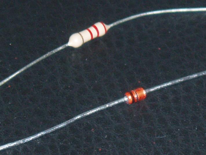

    Hi guys,
    I;ve bought the following:
    27Volt 1.3W Zenode Diode
    2200 Ohms Resistor.
    But I do not understand the SCN5 ilk circuit diagram. :(
    It shows that all three wires are linked in a circuit. I thought the circuit is just to do with the ILK wire and nothing to do with the other 2 wires (ground wire, 24vpower wire)
    Have any of you guys sell the circuit with the emergancy stop button? I am not sure I'm capable to do a circuit.
    Kind Regards.
    The Zener diode is like an relief valve.
    It does not let pass current through as long as the voltage is under 27V.
    Just if the voltage is higher than 27V, the Z-diode opens to safe the SCN5 from overvoltage.
    Dont worry, you wont produce a shortcut. But be careful and mount the Z-diode in correct direction!!!
    The parts do not have neccessarily to be in the killswitch casing. I just would place them there, if you have such a casing.
    As well The parts should be soldered together, to ensure a good connection. Or use at least screw terminals.
    Regards

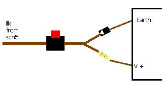

    I do not understand basic circuitary. :)
    Please see picture. Is this How I will wire it? :) ilk.JPG
  14. egoexpress
    Dec 13, 2006
    3,839
    422Coins
    +10 / 1 / -0
    Earth :)
    Yes, it is correct :thbup:

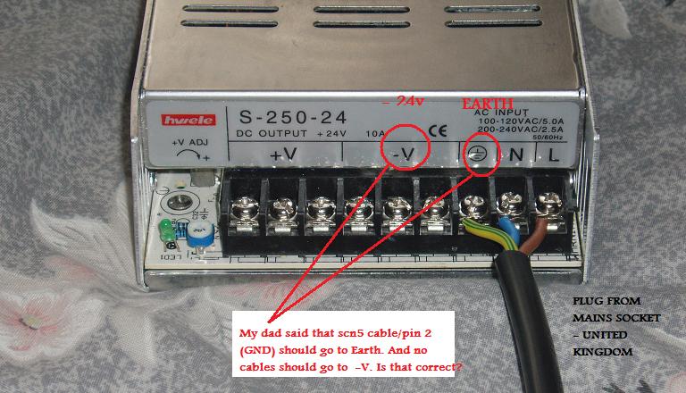

    553Coins
    Just another check to how to do things properly.
    Is the below statement correct? What I am trying to say is ... Can V- mean ground?
