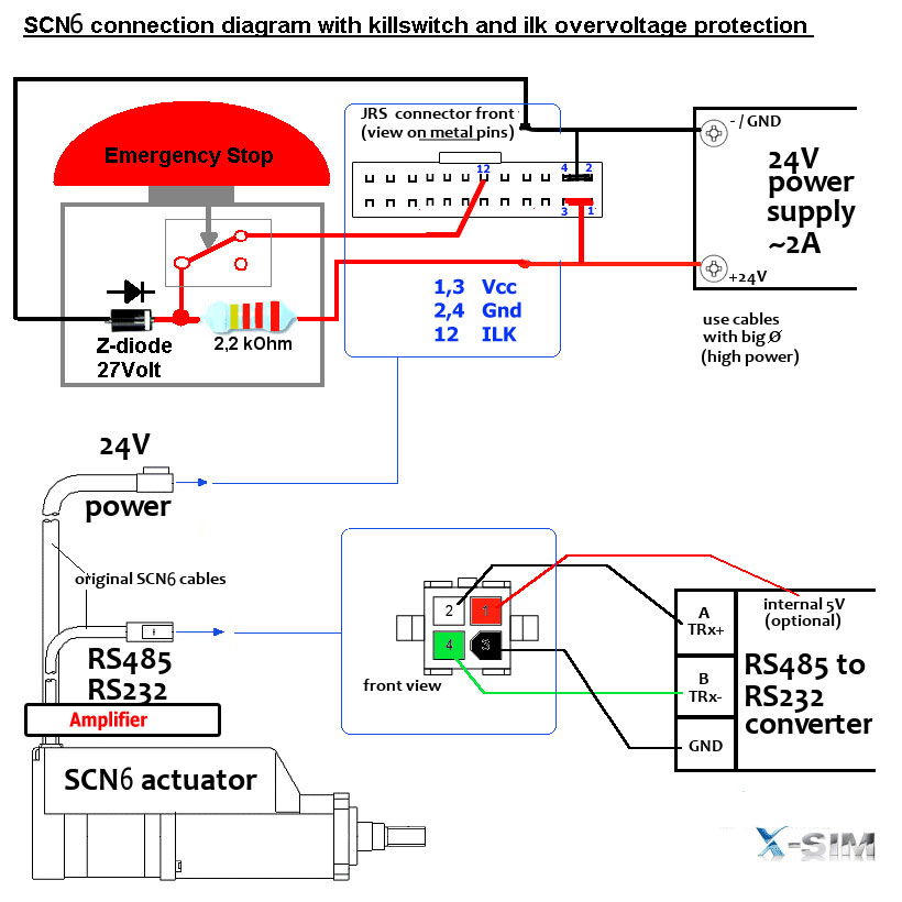

  11. degrancanaria
    degrancanaria Member
    Feb 10, 2009
    31
    9Coins
    Re: SCN5 Hardware Thread
    Hi all,
    I'm going to use a SCN6 actuator in my motion simulator. I would like to say in this thread that SCN6 is automatically detected by Force-Profiler using SCN5 serial. So it is compatible with SCN5 plugin.
    Below there is connection diagram with ILK protection. The pins connetion is different to SCN5.
    Pins 1 and 3 are connected to VCC
    Pins 2 and 4 are connected to GND
    Pins 12 is ILK
    Regards,
