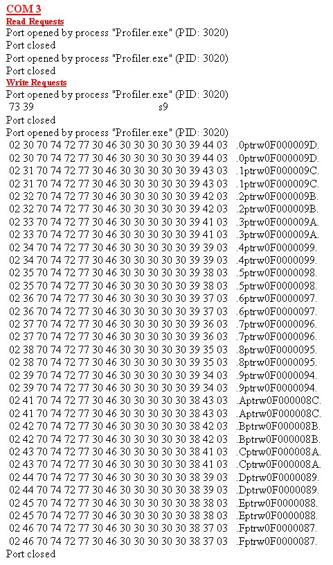

    I have just completed my moton platform and find when I start Force-Profiler I am getting exactly the same problem as was described in a previous post here. My platform is as follows ;
    COMPONENTS USED :
    Two SCN5,s
    Two Daventech USB-RS485 Modules
    Metap IM151C24-1M – 6.4 amp – 24V
    I have discovered that nether of the SCN5,s are being detected by the Force-Profiler. Idiscovered this when I found that they were not been shown in the “Interface Settings” section.
    By using the “debugmode” I followed the sequence of directions in the Force-Profiler at the start of the program where it looks for information from the SCN5’s.

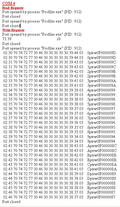

    COM 3 and COM 4 had been set up in my PC to handle the platform. Now it went through the scanning like this :
    1. “Try to scan SCN5 #0 on COM 3”
    2. “Response from SCN5 #0 on COM 3”
    3. “Response is not correct from SCN5 #0 on COM 3”
    4. “Try to scan SCN5 #1 on COM 3”
    5. “Response from SCN5 #1 on COM 3”
    6. “Response is not correct from SCN5 #1 on COM 3”
    This continued until SCN #15 on COM 3 and then moved onto exactly the same procedure for COM 4 with the same results.

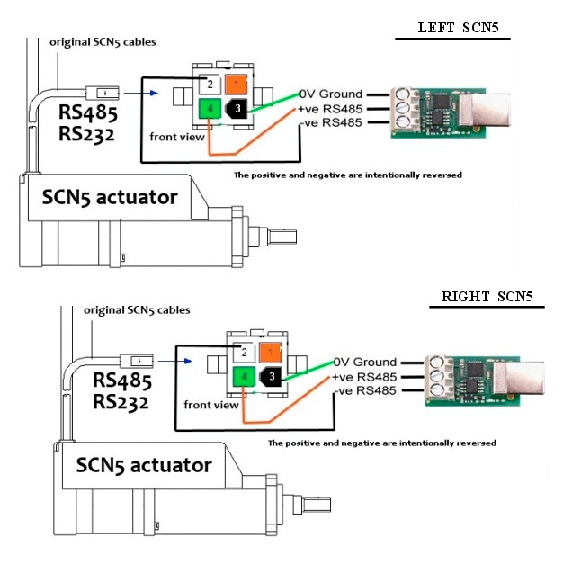

    I have checked the wiring a dozen times and it is exactly as shown in the diagrams below. This wiring is a combination of what I have found other members are using (Connection to Power supply not shown but is standard).
    Below you will find details of COM 3 and COM 4 from “Free Serial Port Monitor”
    Most grateful for any help

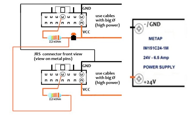

    I've just received my news converters. It seems they work find : profiler well detects the actuator. But I still have a problem, Profiler says that ilk pin is not connected to 24V but in fact it is. I've try my other actuator thinking first one has a problem, but it's the same. Ilk pin is connected directly without any resistor or diod. My actuators are Frex one and 24v is not connected on wires from the first big plug (like your drawing) but from a little one with 3 wires (black, red, grey). Wires on the big plug corresponding to your drawing are already cut. Is it possible that the grey wire I've connected from the little plug is not the good one?
    Thanks for your answer.

    Finally I've solve my problem with PC tool from Dyadic. By putting Ilk pin on ON position. It seems that Frex actuators have modification compare to normal one : I saw that another user has had same issue as me.
    So now my actuators are well recognized by Profiler but I've no Ilk security

    toktiny has been able to solve the issue by swapping the RS485 data wires. (Never invert VCC/GND btw!)...

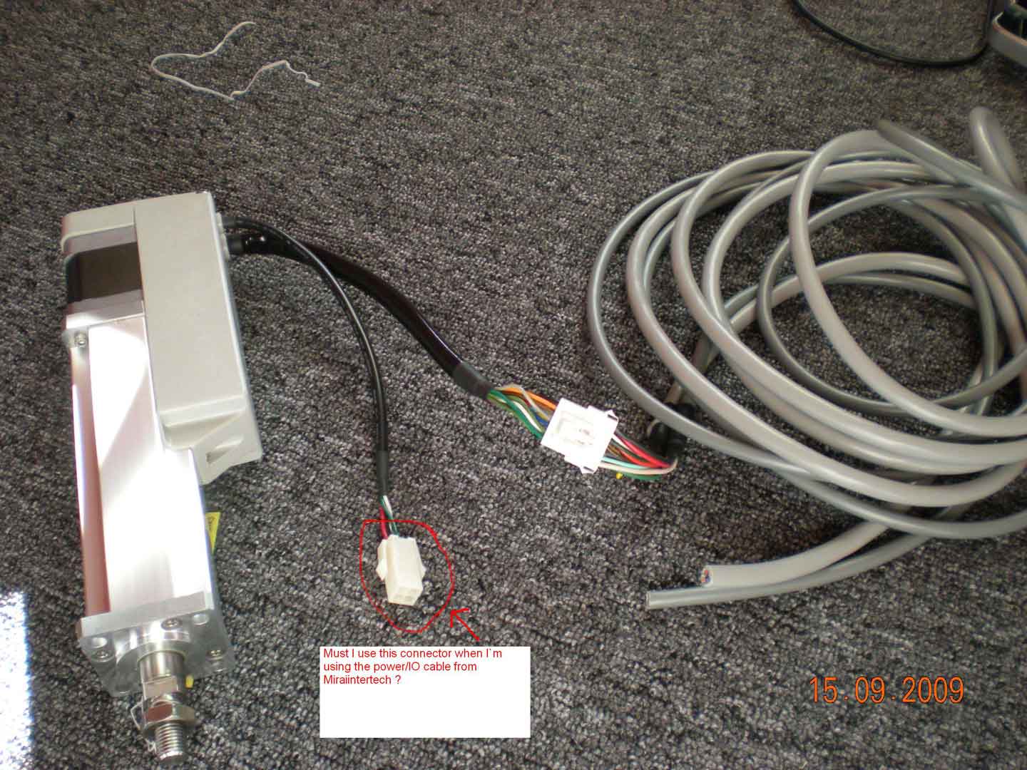

    Hi, i´m new here. First of all ,Thanks to all of you in this forum for all the tips and hints . I´m started my x-sim project for about 3 weeks ago and it´s starting to shaping up. :)
    Have a question- Must i use both connectors when i have power/IO cable from Miraiintertech ?
    Thanks, ribban

    Welcome ribban
    I believe that you will still need to connect the smaller cable as well. The smaller cable is for data communications and gets connected to your USB<-->RS485 adapters. Have you made it through the suggested reading for those building an SCN5 based simulator? Below is a link to my suggested posts. It's alot of reading but once your done, you'll fully understand what's going on and possibly avoid some costly mistakes.
