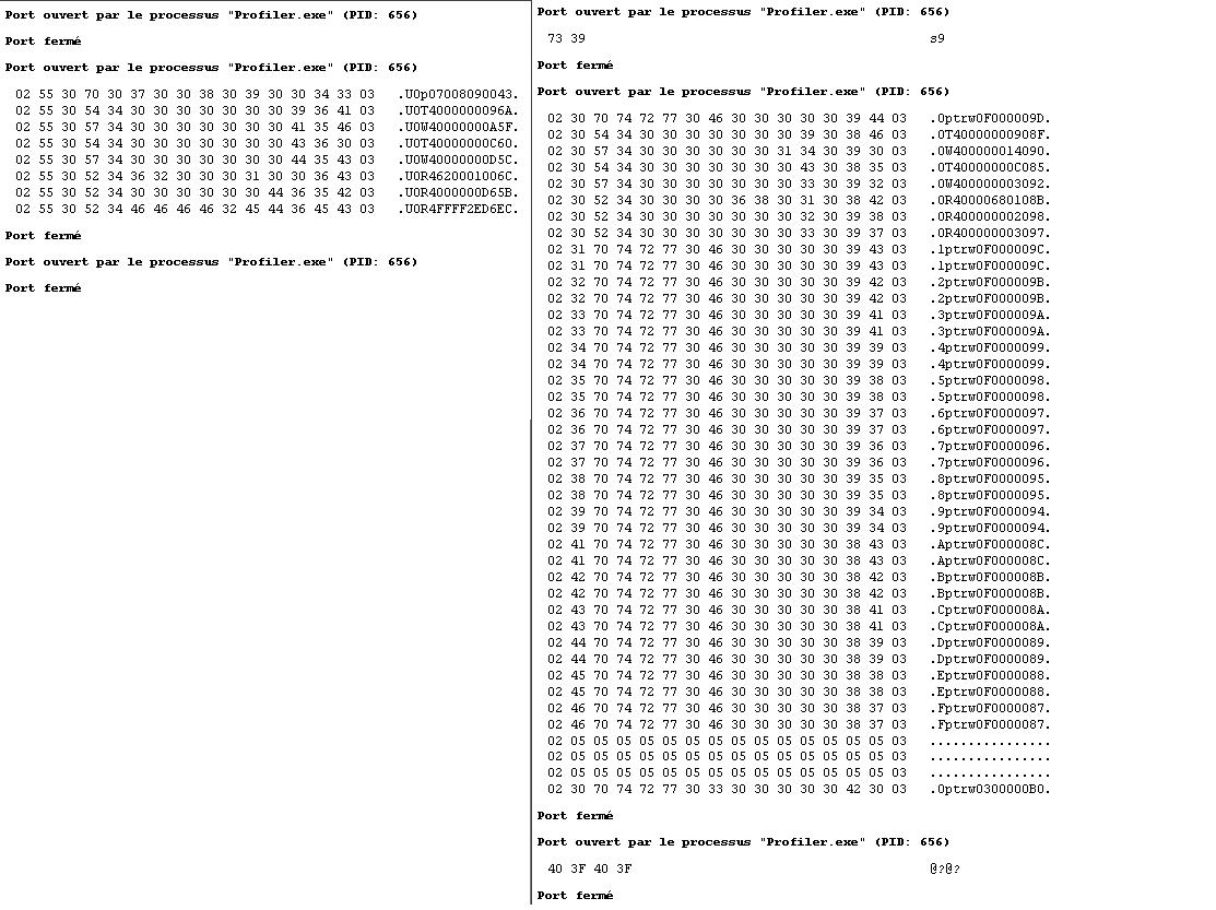

    But my SCN refuses to show up in the interface settings of the Profiler, although the debug messages and the Serial Port Analyzer give encouraging results :
    Debug Messages :
    open found comport : COM1
    try to scan SCN5#0 on COM1
    response from SCN5#0 on COM1
    response accepted from SCN5#0 on COM1
    now init SCN5#0 on COM1
    write 115.2 kbps data response is accepted, SCN5#0 on COM1
    write memory switch delay data is accepted, SCN5#0 on COM1
    try reading serial number SCN5#0 on COM1
    serial number from SCN5#0 on COM1 is 62000100
    now start scanning registry SCN5#0 on COM1
    registry scan done SCN5#0 on COM1
    starting COM1 parameter update
    COM1 parameter update was successfull
    COM1 SCN5#0 try to init delay again
    COM1 SCN5#0 delay set failure
    Port Analysis : attached

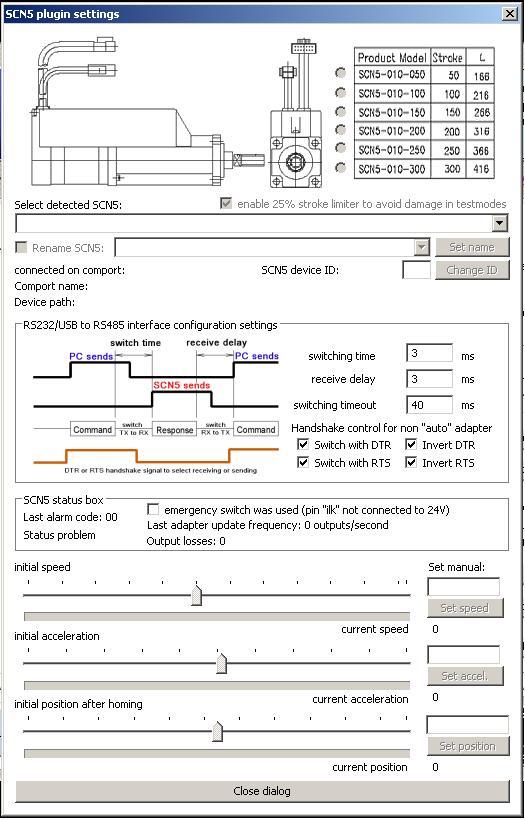

    Adapter is on a RS232 9 pin port (not USB)
    Timing setup : is the attached what you need ? I have blindly tried all sorts of combinations DTR / RTS, and tried adding a zero to the delays, without success so far.

    This is not a new or experiemental actuator? It is the 100mm /sec version of the SCN6-020 or 040 series that would traditionally be used by sim builders.
    Your switching timeout is too low, which is probably the reason for the delay set failure. Try upping it to 120, 40 will not work.
    Also uncheck all of the check boxes. You can enter the remaining timeout values as 3,3,120. If this doesnt work, try clearing the X-Sim registry section.

    The actuator is a standard SCN product. I wrote experimental meaning that if I manage to get it to operate properly, I will proceed with the acquisition of the others I need. I also wrote experimental because all the litterature I see around refers to SCN5, not to SCN6 (I feel somewhat relieved when I see you write that SCN6s are traditionnaly used by sim builders).
    I have just tried with a delay of 120 with all 16 combinations DTR / RTS to no avail

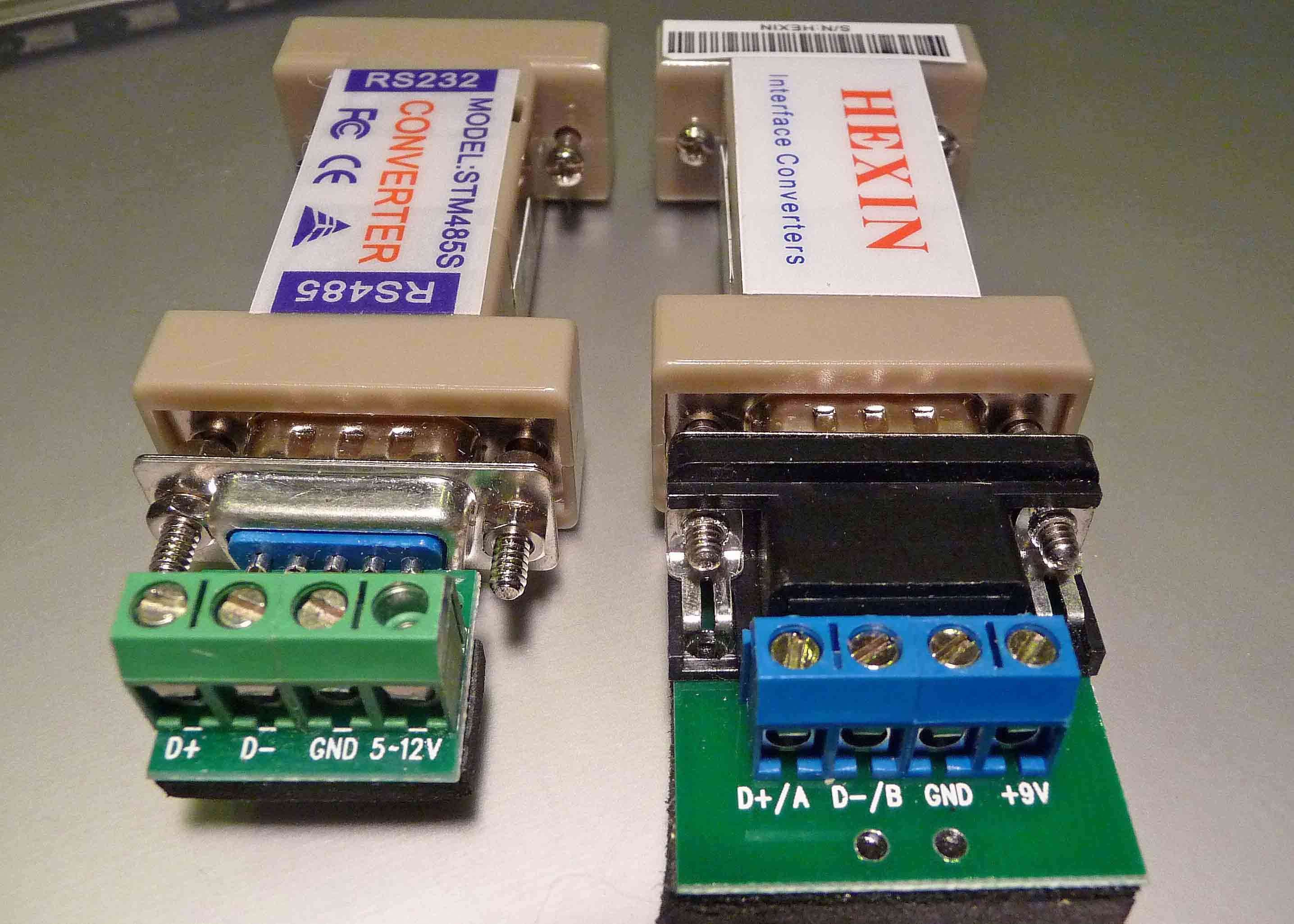

    Are you using a half-duplex adapter? The full-duplex Hexin adapter does not work well. Can you show us a picture of your adapter and the wiring.

    IT WORKS !
    I changed the HEXIN to the equally cheap STM485S on the left of the picture and swapped the wiring + and - , simple as that ! :clap:
    Thank you so much for your tip

    Hi bvillersjr, I just bought this adapter for mouser, can you share SCN5 plugin settings you used for testing with it? Also should I need to reverse the wiring for Data+ and Data- like some other adapters in order for it to work with X-sim. Thanks!

    All FTDI adapters that I have tested so far (including these) work well with X-Sim plugin settings of 0,0,100. If for some reason you have difficulty, use SCN5 Plugin settings of 1,1,100.
    I honestly don't recall if the Trx+ and Trx- needed reversed or not with this adapter. I believe that it did, but please don't quote me on that. We only used these adapters for a very short while before I decided to scrap them and design an adapter that better suited my needs. However, of all of the adapters I have seen so far, it is the best performing off the shelf option for DIY users, barring my own of course ;-)
    Let us know how your install goes.

    Hi Bernard, I confirmed that the settings 0,0,100 in SCN5 plugin works. As for the TRX+/TRX- wiring. I found that there is NO need to reverse for this adapter. Will proceed to try out the game profiles. Thanks.

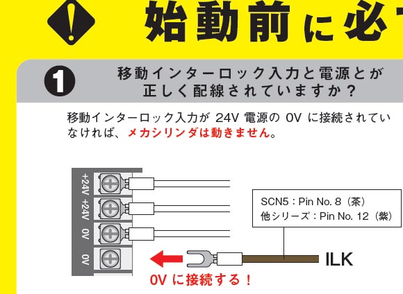

    For Japan Dyadic actuator connect ILK to 0V !!! not to +24
