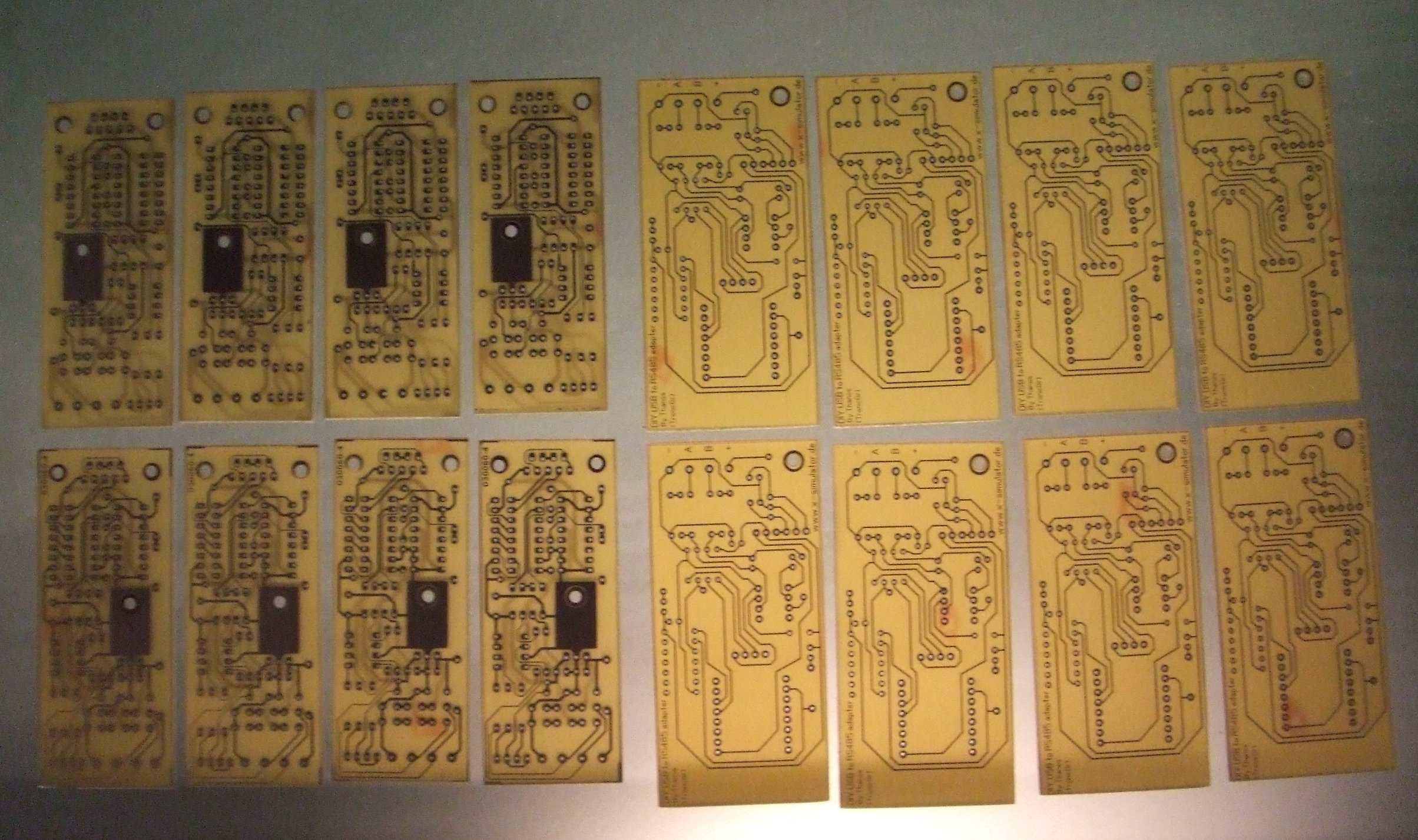

  3. egoexpress
    egoexpress Active Member
    Dec 13, 2006
    3,839
    Germany - Frankfurt/M
    422Coins
    +10 / 1 / -0
    Re: SCN5 Hardware Thread
    The pcbs arrived today...
    Regards
    Christian

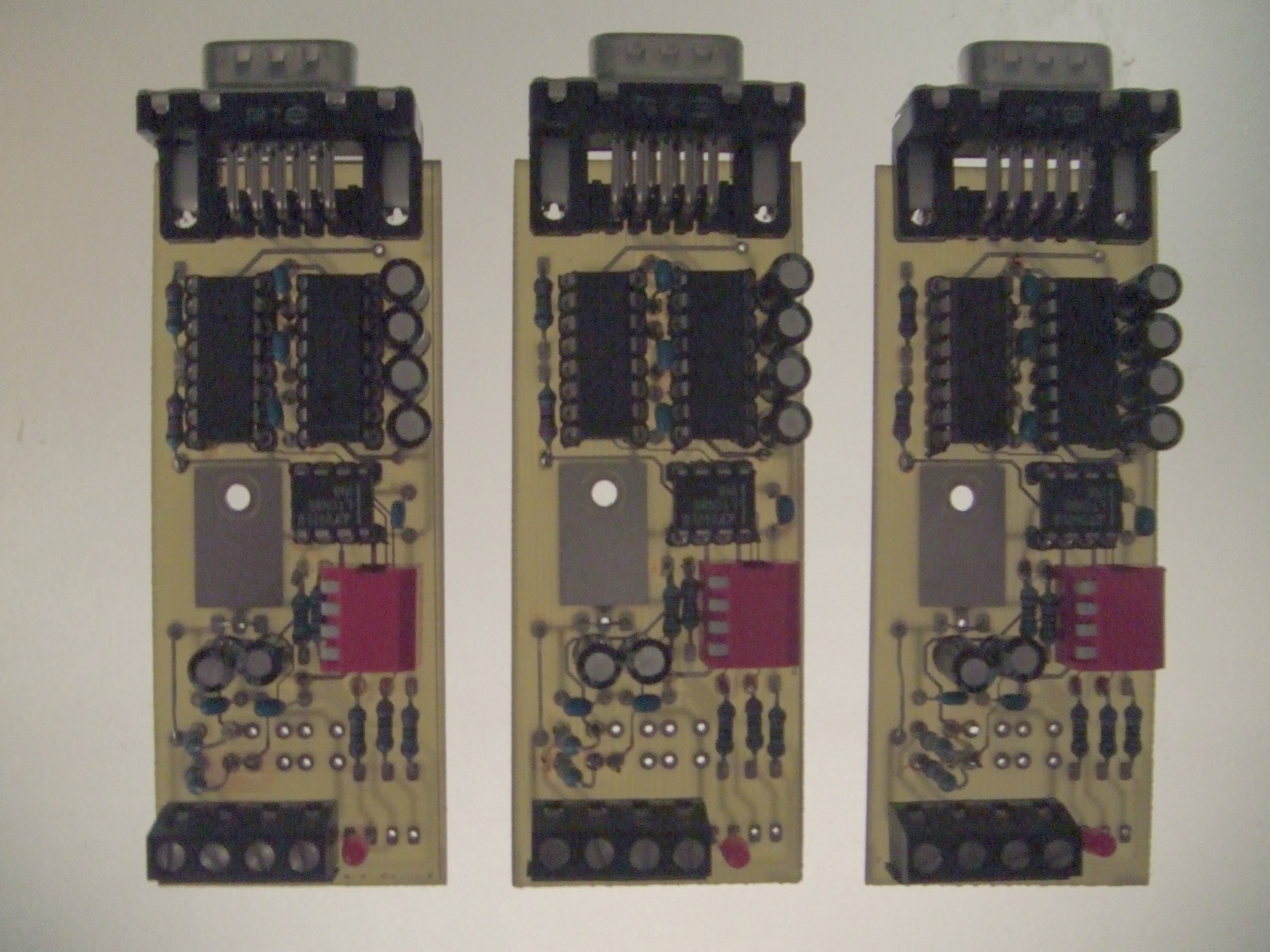

  11. egoexpress
    Dec 13, 2006
    3,839
    422Coins
    +10 / 1 / -0
    Does someone have an idea how to test them? Is it possible to send data packages from one comport to another, while connecting 2 adapters in between?
    Btw, there is a connection which is not plated-through on the picture, but I've fixed it already.
    Regards
    Christian

  14. egoexpress
    Dec 13, 2006
    3,839
    422Coins
    +10 / 1 / -0
    I've sent 2 raw USB pcbs to Thanos last week. When he will give green light, I will assemble some USB versions.
    Regads
    Christian
  15. egoexpress
    Dec 13, 2006
    3,839
    422Coins
    +10 / 1 / -0
    The RS485 adapter connectors arrived with delay, finally. Now I have all needed parts to make the adapter cables.
    Regards
    Christian
