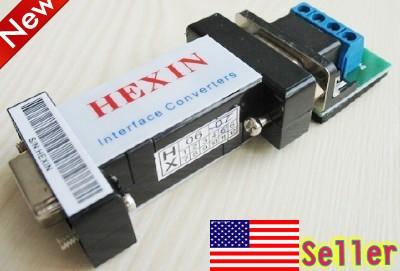

  16. djmerritt
    djmerritt New Member
    Feb 1, 2012
    11
    0Coins
    ok i have read all the pages of the scn5/6 software and the 49 pages hardware and followed many dif setups and still cannot get the profiler to detect my scn6 . I might add that when o connect to my old pc winxp direct serial it does detect and center but on my vista or win7 i cannot detect can anyone help as i am sure it is just windows settings i am overlooking
    note >>> I have tried the 120ohm resistor and grounding to the computer and th rts / dts settings have been trying for 4 days with information on this forum
    I want to add that this is the USB to 232 i am using http://www.ebay.com/itm/150525882505?ss ... 1438.l2649
    also here is the 232 to 485 i am using

  20. bzdadwith5
    bzdadwith5 New Member
    Feb 13, 2012
    0Coins
    I am having problems with my Hexin converter , Yesterday all was working fine and moving my scn6 actuator but today when using it the force profiler came up and said warning an interface was unplugged and then it would no longer detect the scn6's i checked all wires and looked good changed to a new converter and it worked just long enough to detect the actuators and again sent same message, warning an interface was unplugged, and would no longer detect any actuator. this has happened with 3 converters.
    ANY HELP APPRECIATED !!!!
