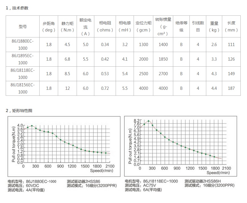

    I think I finally found the motor I was looking for..
    8Nm closed loop Nema 32 with 1.4NM at 1800rpm
    Will keep looking further but this find makes me smile and getting more and gives me more faith that I will reach my goal!
    I think I will go back to 1605's
    Damn. AC voltage 70v.. where would I get those.. I think I will continue the search for a DC version :-(

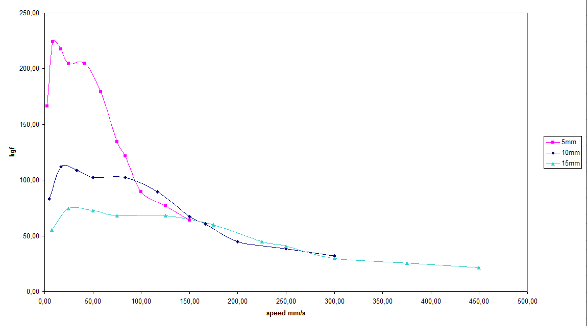

    I have taken this rpm-torque curve(red curve) of a closed loop nema 23 with 2Nm:
    and made a chart with 3 force-speed curves in combination with a 5mm, a 10mm and a 15mm spindle:
    The 10mm and the 15mm spindle overlap each other in the range from 150 to 300 mm/s. Below 150 mm/s the 10mm spindle has more force, but the speed ends at 300 mm/s.
    But 10mm spindles are not easy(and cheap) to get and 15mm spindles doesn't exist(i believe), so the best way would be to use a 1605 spindle and a belt drive between motor and spindle to get the higher speed.
    For a 2dof seatmover with shoulder-mounted actuators this nema 23 would have enough force, but if you plan to build a 3dof with heave i think a nema 34

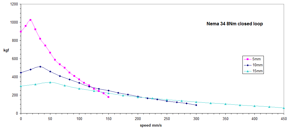

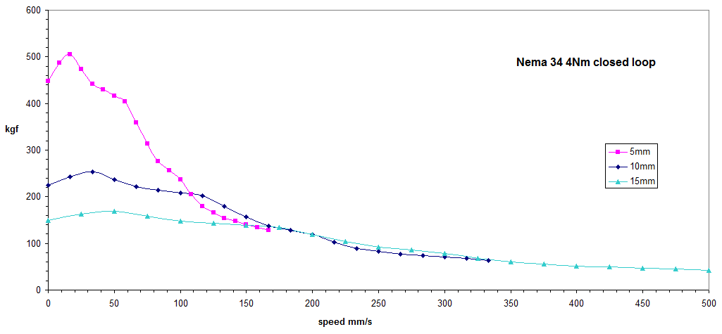

    Here a the updated charts for your above posted Nema 34 4Nm and 8Nm. The 4Nm has higher speed.

    Wow.. thanks for all you efforts.. You make it so much clearer .. The 8Nm has more torque at 300mm/s but the problem is AC power supply .. I am not keen on that..
    Rather have DC, easier to get and lower priced .. But I think I can pull it off with the 4Nm motors.. and limit all at 300m/s .. If all the movements are converted 1:1 then you probably still have a hell of a ride..
    Thanks again.. I have found acceptable prices 1610's .. so the belt is not needed..
    Motor would be then the Nema34 4Nm

    By the way, the nema 34 4Nm set you chose above comes with the 2HSS86H-driver board. This has only AC-input 30-75V.
