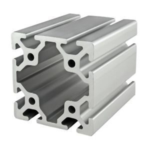

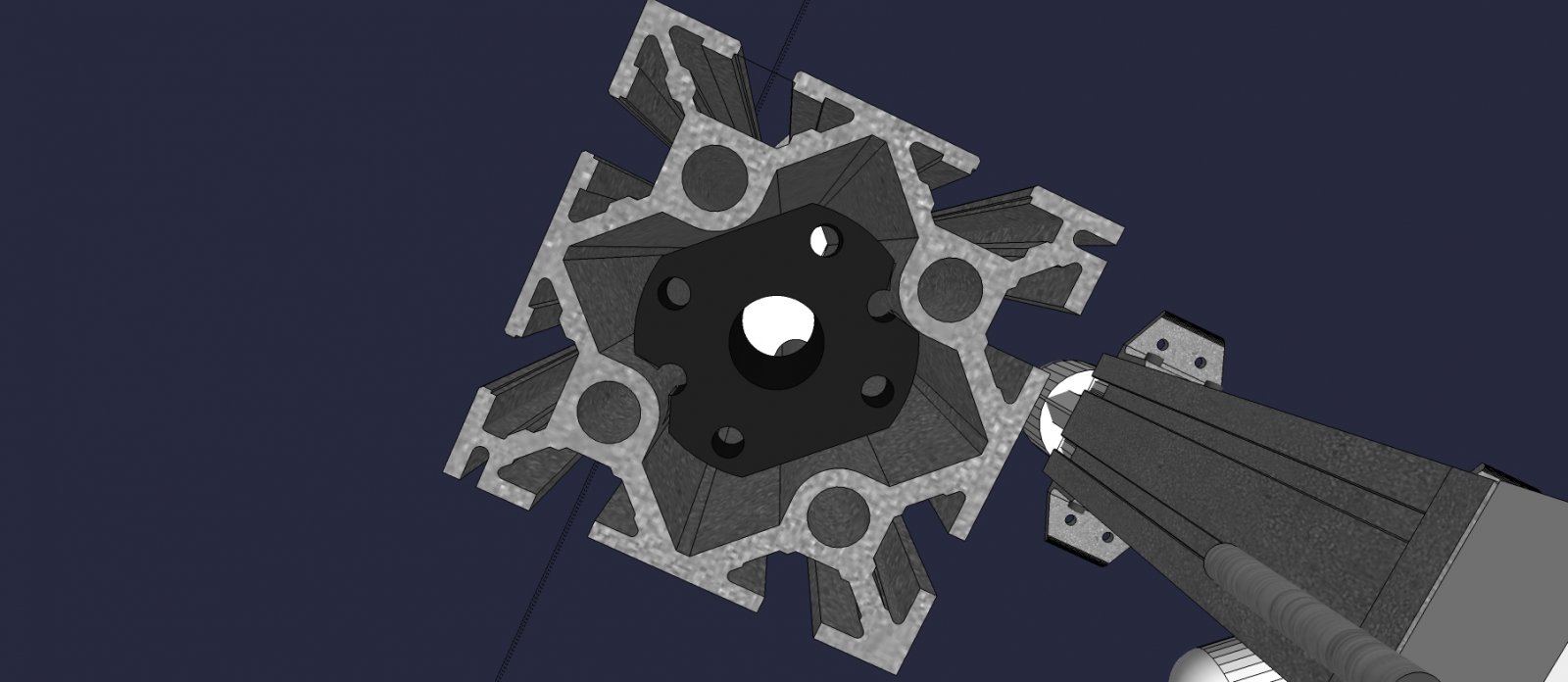

    Micheal, I've been brainstorming about how to fabricate the small 350mm actuators and put down this rough idea in sketchup last night using 8080 extrusion. The ball screw fits on a bias if you cut a small notch in the two wider sides of the flange which would very easy to do. If the magnipot strips that @kermitkong discovered work well, they would be a perfect fit in this compact profile.
    I was also thinking one could cast the centre section of the extrusion with a solid plug of urethane and use the natural shrinkage to make a rounded bottom push rod from it. I'll draw up that idea as I'm not sure it makes sense from my description.

    @Limongi, good idea with the 8080.
    If you mount an optical encoder on one of the belt-pulleys you don't need a MagnetoPot. Then the exact position is always known.
    If there is a closed loop stepper motor used, even that is not needed, it has the encoder already on board.
    For safety there are only two limit switches needed, one of them can also be used for finding the zero-point at start-up.

    Thanks Bernd, one of the issues that I found is that this design leaves little surplus for room and my second idea that I'm drawing up would basically eliminate it. Right now if you wanted to have a belt tucked inside you'd only be able to fit half of it inside with the other half running down the outside. So the magnetopot's extremely low profile (or another beltless solution) could be the keystone of this idea working or not.

    Actually scrap the above comment about not being able to fit the belt, now going back and looking at it you could, in a similar fashion to 3-D printers run the belt down the inside of one of the outer slots.

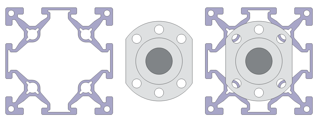

    I think you misunderstood me. I meant to to place the quadrature encoder on the pulley which is on top of the actuator (the belt from the motor to the ballscrew), not inside the profile. The encoder counts the revolutions of the ballscrew.
    But there is another problem: The ballnut does not fit into the 8080 profile:
    EDIT: I've just seen that there is a 100100 profile available.

    Hi Bernd, thank you cor clarifying, I did misunderstand but it's clear now. I was hoping if aligned on the bias and the wide part of the flange notched/ milled it would fit perfectly in the 8080

    The 100100 is also most likely the path of least resistance and not much compromise to the compact design.
    Edit: not that it's much cost in the grand scheme of things sim related but interestingly the 100100 is double the cost of 8080!

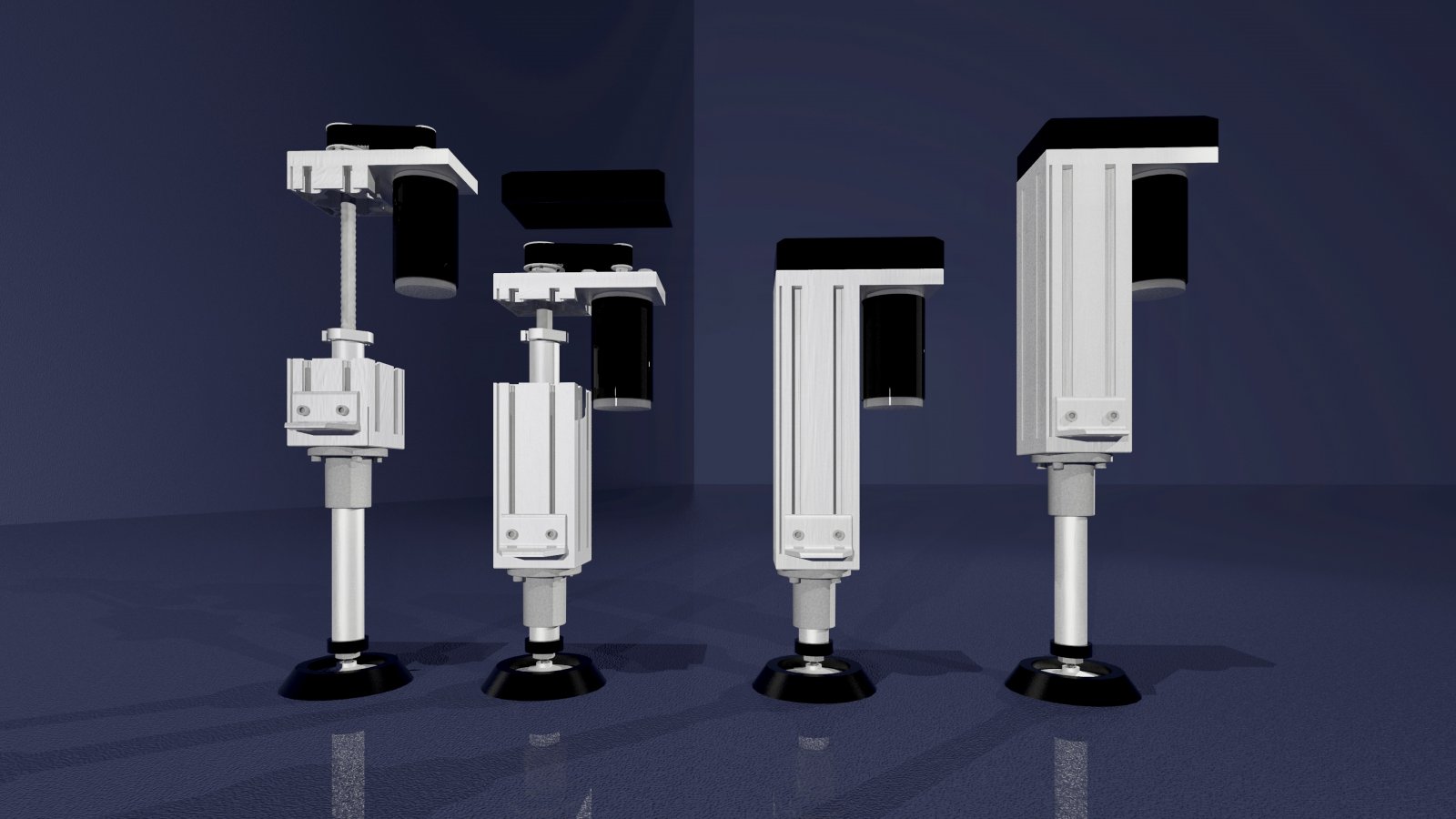

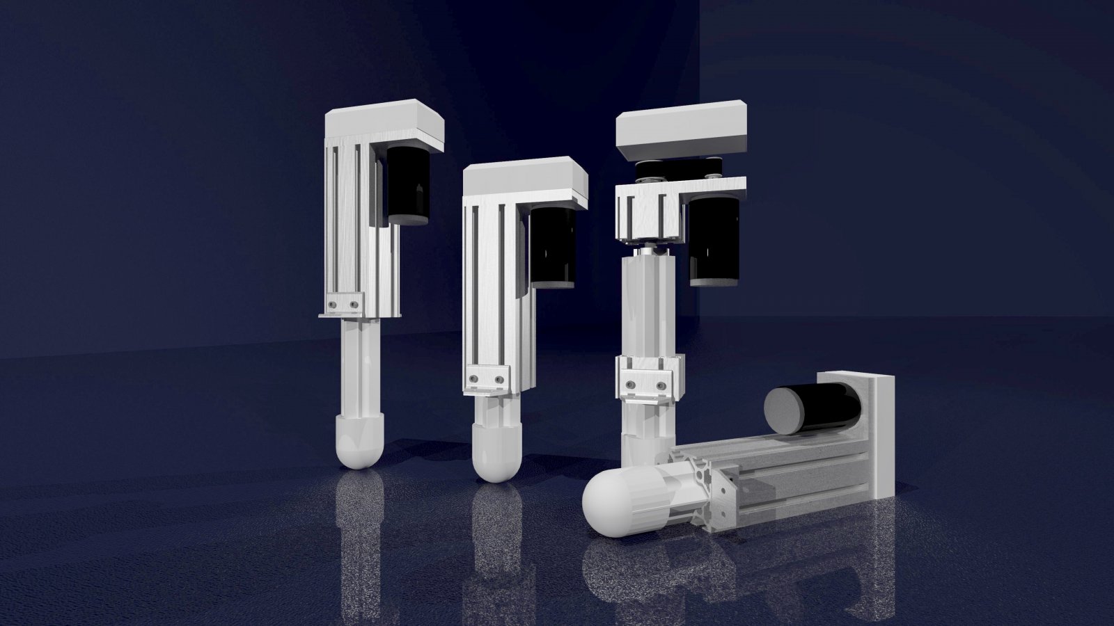

    Intention was not to make something so phalic in design, but it happens! This is the aforementioned idea using a telescoping cast or 3d printed centre section with a rounded bottom (like some dbox designs).
    Not shown here would be a cnc cut 15mm delrin end cap to act as the linear bearing, and assuming it would all have to be greased to deal with friction. Not sure if there is much benefit to this idea as it feels like it would have the greatest mechanical loss.

    I would ad a PTFE liner inside then.. give it more slide and protect it from excessive wear..

    I was thinking of small swivel feet but this looks cool too..

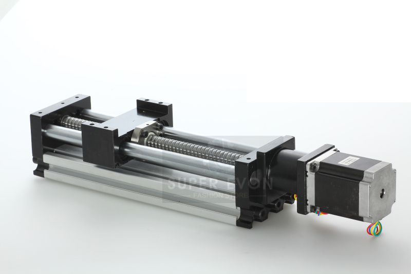

    What about going more to this direction:
    This linear bearing systems have practically no friction and the dimensions are not larger than a 100100 profile.(I guess that's a nema 23 with 57x57mm)
    Ok, it's no optical highlight, but i would not care if i had a working actuator.
    There is always room for improvements and a housing.

    But in this particular case I would reverse the ball bearing.. (need to print an adapter for it :) otherwise you've got a hand full off balls .. hmm sounds weird..)

    If you want that youre actuators last, you need to build riggid ones.
    When youre sim tilts the actuators get a little side loaded this is very bad for a actuator.
    Frex sells now reinforced hyper axis because of this.
    Bernds idea with a linearslide is great ,mount a pushrod on it and those forces come on the linearslide

    I think I will follow Bernd's idea.. Thanks for that, makes me think again..
    Would make the linearslide with 20mm, and the weight need to be close to the rail ..
