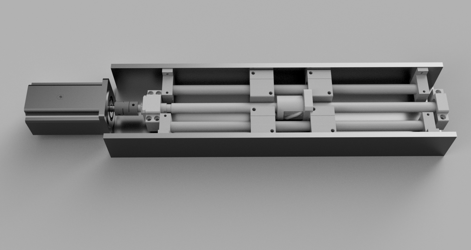

    I've been a member of this community for a while now and been quietly acquiring parts for my build, in the breif moments of spare time I've been trying to create my own linear actuator design...
    I'm not sure if the brass guides will work but they can easily be replaced with a linear bearing if needed. The motor I plan to use is normally found on electric scooters. Its only 150W but 24V and so I hope its got enough power for my needs. To provide positional feedback I'm goig to use a linear softpot resistor.

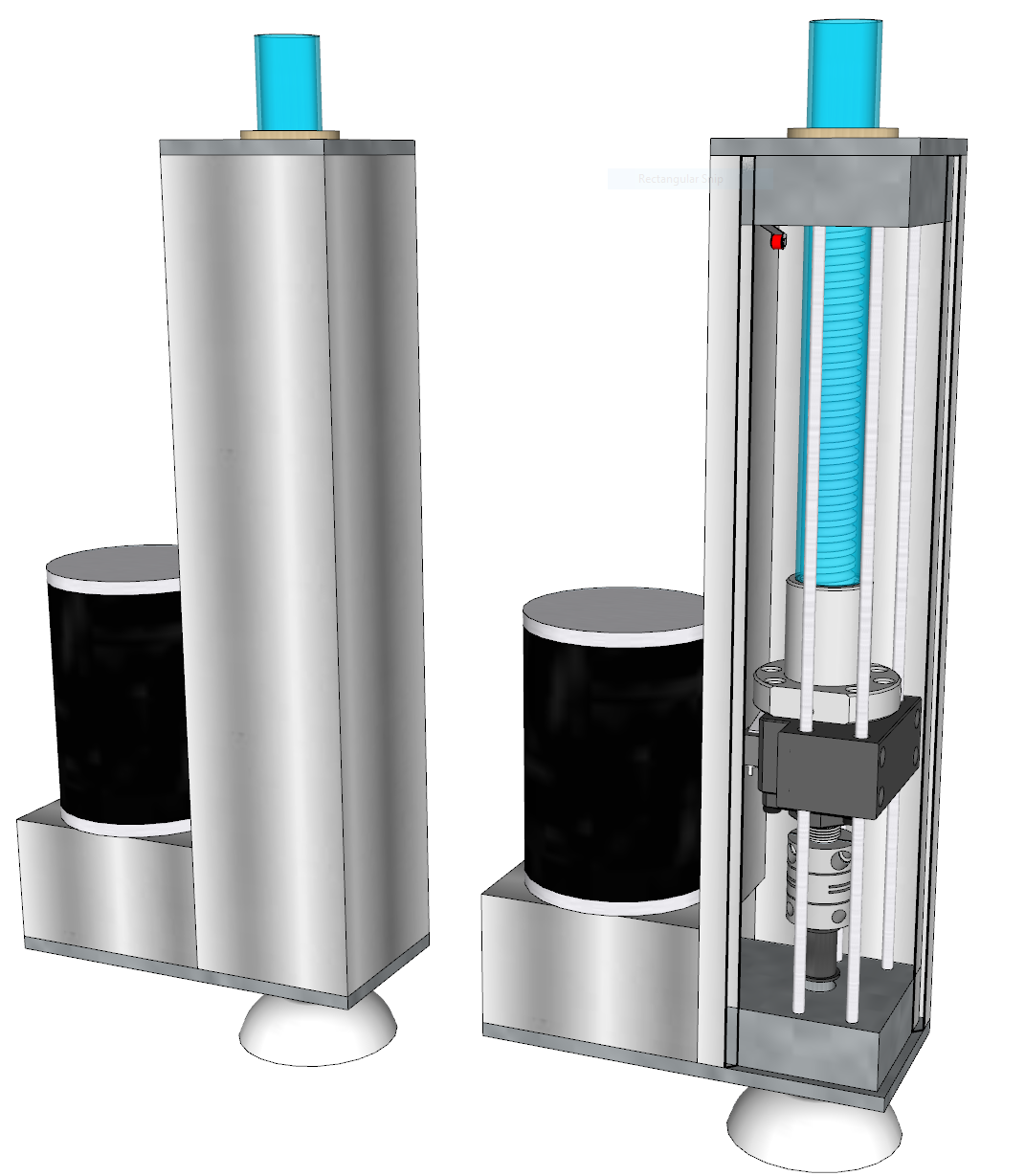

    If the 4 brass guides are replaced with 2 linear bearings, this could indeed be a useful design.
    But why always use pots as positional feedback ? Pots are always very prone to failure.
    I've mounted quadrature encoders on the motor shaft. They are very reliable, wear-free and never loose a pulse, even after an hour of playing.
    https://www.xsimulator.net/community/threads/2dof-with-wheelchair-motors.7905/page-2#post-125188
    An encoder with 500 pulses/revolution and a 300mm ballscrew with 10mm pitch, will deliver max. 500*300/10 = 15000 pulses for 300mm, a resolution of
    0,02mm! If you use a pot in combination with an arduino, you get a resolution of only 0,29mm (Or worse, because the analog inputs of an arduino always wavering around a few bits.)

    Welcome.. nice to see another builder going for smaller actuators! Nice designs but I would loose the brass coupling. And like bernd said.. although common to use a pot.. that’s why i choose the closed loop direction. An encoder is much directer and never wrong. Keep us posted on your ideas and progress...

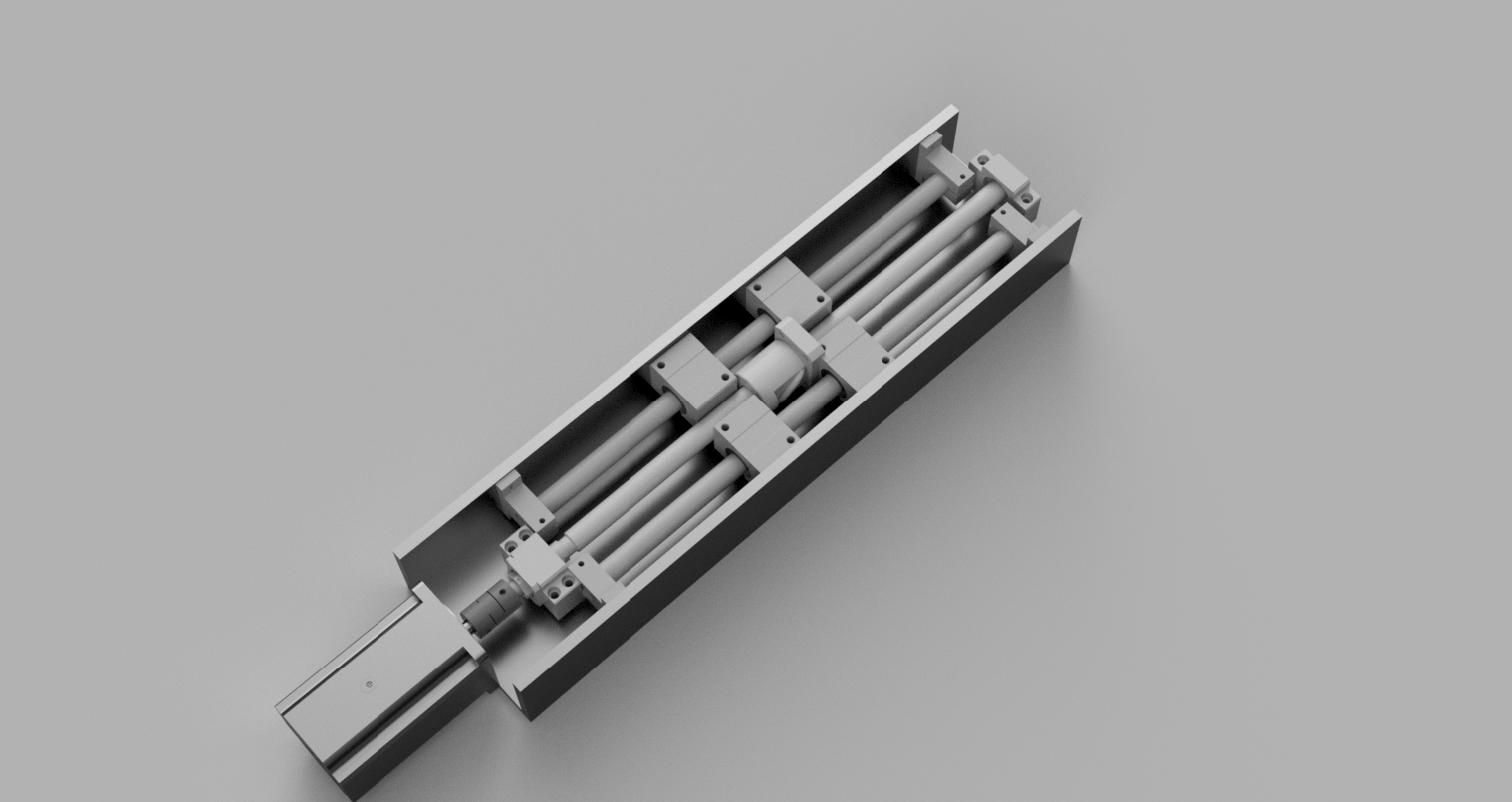

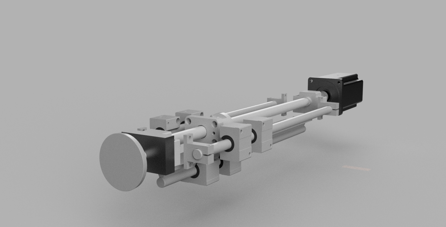

    I've whipped up a design based on parts that are available at local store or at the cheap Chinese web shops :)
    It is a pretty close fit with the 20mm rods might have to go to 16 mm so I have a bit more clearance..
    All rods are on 'normal' sizes so no special cut to size parts.. this leaves me a 310mm of travel range.. the ball bearing is 2010 and the rods are 20mm .. Just to make it a bit more stronger.. So I might have to go on to small diameters.. at least the ball bearing could go to 1610.. that would leave me enough space..and perhaps loose the bearing blocks for bushings..
    Then there needs to be some parts designed and printed.. but that is the easy part.. the frame is an U-profile .. 80x150x10mm
    And again it is just a work in progress design, but gives some insight on the actual sizing.. overall length around 800mm.. :) without the foot part..

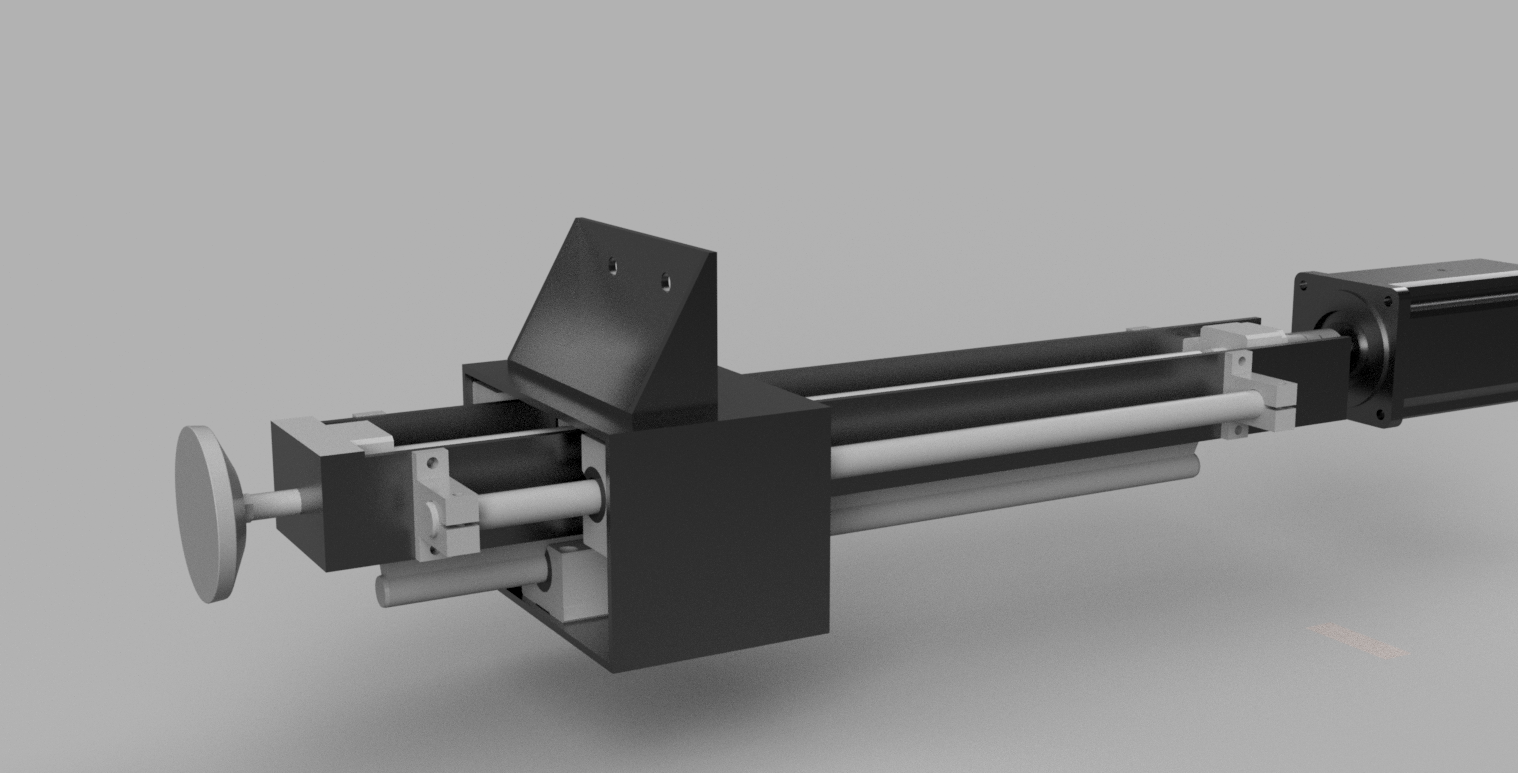

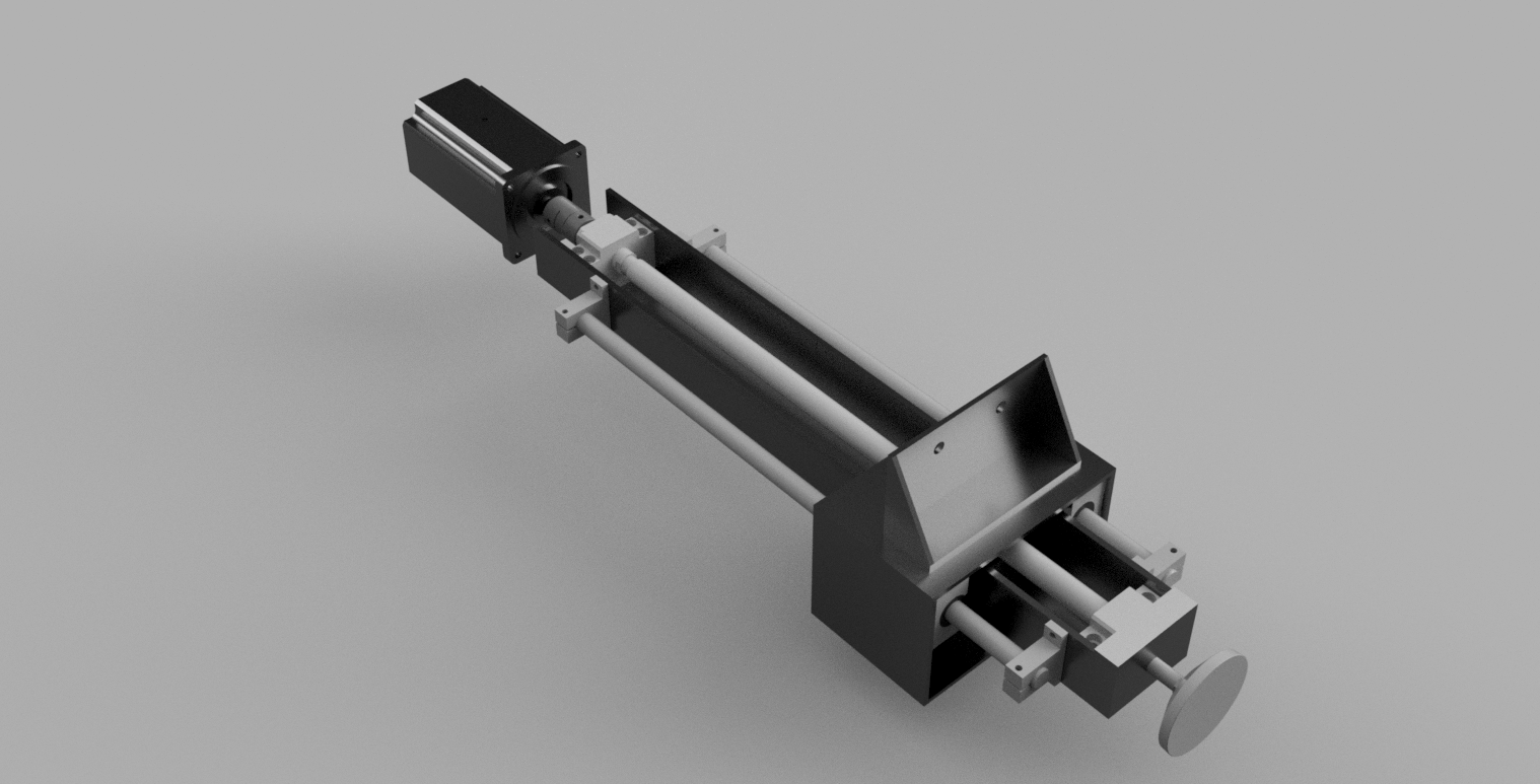

    Redo on the drawing.. This would relief the stress on the ballscrew a bot more.. An I think it makes it more beefy then before..
    Only part then needs to be fabricated out of steel is the outer box..

    Wow !! , i wish i could turn it around with my 3D-mouse and watch it from all directions. Good work, let's build a company ! :cool: (Joke!)

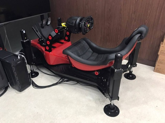

    So around €1300,- for D-Box style motion and hopefully (probably it is) better is not coming cheap, but I never wanted to go the cheap way.. I want the real stuff, the snappy motion, the close your mouth or you will bite your tongue vibrations..the 'shit ,did we just had liftoff' feeling..
    Then we are gonna top it off.. with:
    rSeat Formula v2 € 999,-
    Oculus €450,-
    PC €1500.-
    Racing gear.. €500.. (upgrade later or pitch in FeelVr)
    Aluminum €100,-
    Unforseen €250,-
    Total: €4.874,- still a good $15.000 cheaper then D-Box..

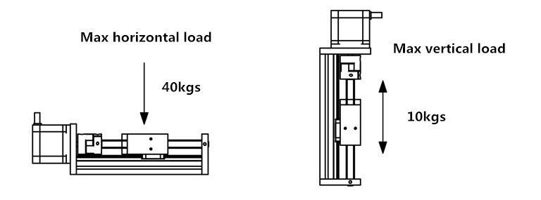

    Like your finds and I think they could/would work.. Curious about the actual load the can have if they are set vertically
    The bottom link is really nice. makes me doubting if I should get a CNC machine to make parts.. Those look like beasts of axis and they will be able to handle the force, I think

    have my doubts of the strength of the complete structure as the load will be between the spindle block and the vertical arrow row.. I would add a 3 and 4th slider carriage at least to make it wider .. I placed an extra rod at the back of the actuator to reduce the load on the bearings, but perhaps I am overkilling it.. but if the thing is capable if creating 400+ kg of force I want to have all the load divided over more then 3 points.. But again it could be a good base!!
    Edit: looking at my own design, I could try and leave the rail at the back and see it the load is fine with 2*2 bearings on the sliders on the side..
    Also I liked the harmonica covers on one of the links.. Gave me a new option for covering up

    I feel like adding a second plate or extrusion to the opposite side of the pre-built would triple the amount of force it can take vertically.
    Edit: also I wouldn't order one with the motor included. As others have found out there are many counterfeit servos on aliexpress and servos/motors are important to get from the right supplier. I believe @SilentChill found this out when building his OSW (apologies if I'm mistaken).

    Hi Michael
    I looked closer to youre last actuator design.
    All forces are comming on upper ballscrew bearingblock and could bent u profile
    Google with klein U staal this can handle those forces
