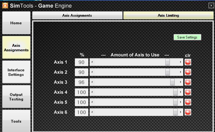

    PS: your axis limit should be 90% or below. The smoothing option of simtools can help a lot to achieve a more natural movement. Can you link something about that factory software you talked about? Thx

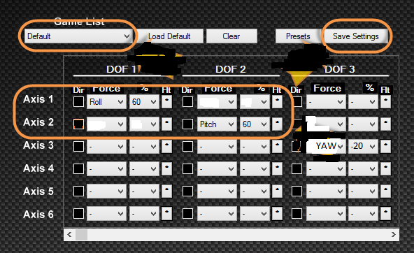

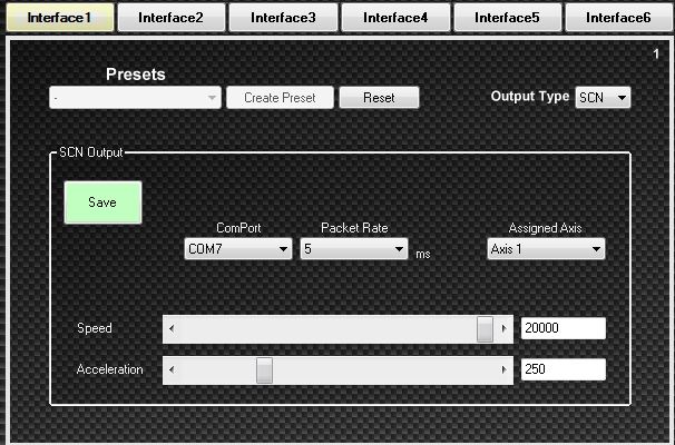

    Yup still 'grindy' with FSX. The motion in pCars is waay too fast.. but at least the actuators operate smoothly.. no grindy grindy :)

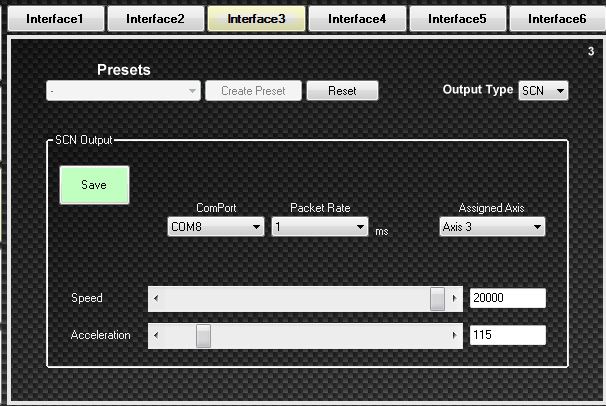

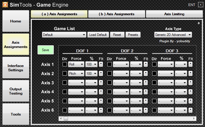

    Regarding the interfaces, here's where I'm going off the rails I think..
    Ignore the circles.. I don't have access to my sim PC ATM so here is basically what I've been doing. ROLL, PITCH and YAW corresponds to my physical R,P and Y physical axis.
    I've seen lots of 2DOF examples on the webpage but no 3dof. Setting this up seems very complicated to me. I've seen where people have had ROLL on two different AXIS with opposite direction of motion, etc.. Some of the 6DOF configs look absolutely nuts! Lol
    I've been considering offering up a 'donation' to have someone who knows what the heck they are doing to help with a more detailed config. In my mind the way I have it done this is logical and I figured I'd work on a good base before getting into adding and blending other forces. My current grinding issue has preoccupied me and therefore I haven't pursued getting more 'under the hood' with this..
    Any suggestions regarding this screen and how you have your axis setup would be appreciated :grin
    Thanks,.
    DaV
  11. yobuddy
    51,704Coins
    +5,204 / 19 / -0

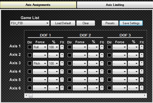

    Your only using 60% of axis 1,
    60% of axis 2,
    and 20% on axis 3..
    let's forget about yaw for now and just get the basics working.
    Setup the settings like this.
    This way Roll is tied to one axis using all of it's available travel.
    And Pitch is tied to one axis using all of it's available travel.
    let's get this working first then I believe the yaw will make more sense.
  12. DaVinster
    DaVinster Active Member
    Dec 2, 2015
    124
    What does I.T. stand for?
    AB, Canaduh
    1,150Coins
    +50 / 1 / -0
    3DOF, SCN6, Motion platform
    yobuddy.. you rock! Thank you!! I'll do this first thing when I get home from work today. Excited to try because I haven't done anything close to this type of config..
    Cheers!
    DaV
  13. DaVinster
    Dec 2, 2015
    124
    AB, Canaduh
    1,150Coins
    +50 / 1 / -0

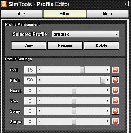

    Well I have some good news.. thanks to yobuddy and nclabs I now have a workable starting point and little to no 'grinding'. I reduced the acceleration quite a bit as per nclabs and it seemed to help alot. I don't think I would have gone that low on my own and probably would be changing so many things I wouldn't draw a correlation between acceleration and my grinding issue for sure. Saved me alot of time! Thanks Gents!!
    Also as per yobuddy, setting up just the basic roll and pitch axis for a start also helped. I've enclosed some screenshots of my new setting. I'm pretty happy with the profile now and I don't have any filters turned on either. I'm sure it could use a little smoothing but I want to get all the axis and DOFs setup properly and configured before I fine, fine tune. I'm also using the default min/max file. Afraid to do a custom capture in case it screws it up! :o:
    I know, I can also always reload the profile again by the updater. I will give it a go depending on if yobuddy thinks I'm better off adding some new DOFs before hand?

    If you are having to turn up pitch that high in the game manger profile editor, I would say that you may need to recapture your max/min settings for that game.
  15. nclabs
    nclabs Active Member Gold Contributor
    Jun 22, 2012
    165
    196Coins
    +148 / 0 / -0
    Axis 3 is 96% now, that's dangerous, turn it down to 90%. Adjust all the interfaces with 10 ms packet rate (now I saw it's 1 and 5 ms). I also advice you to keep the same acceleration value for all the interfaces, and adjust the speed with the slides on the profile editor, just to have a common ground to allow you to understand the adjustments you need to do on the profile. As yobuddy just told you, do some work on the min/max setting of the tuning center, it's a crucial part, you get that wrong and nothing will work nicely. Usually I don't even make the capture, I just enter the value and try the game, if the seat moves too much I enter a higher value and viceversa. In this way I fine tune the rig in no time and very accuratly (keep in mind I use the same min/max value to all the axis, just to keep some uniformity on the movement).
    For the profile part, that's the tricky one. Try to imagine what effect you want to mimic and how your rig should move, if for one specific force effect two actuator should move, on the axis assignment windows those to axis should have the setting for that force effect, and so on. With your previous setting you had one force effect for one actuator. It's not very clear how your rig is designed, but if you builded it to one force-one actuator kind that is correct, otherwise it's not. I ask to the community to correct me if I said something wrong.
    PS: thank you very much for the infos!
