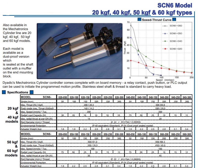

    2,572
    Every little bit helps. Your rig also looks quite heavy, so for every sharp change in direction there is allot of inertia to overcome which could be effecting your SCNs tight load/speed specs.
    The Rift and motion is just great:thumbs - I recently put a friend on my new rig with DK2 and he nearly wet his pants - should of had the video camera running:D . Cannot wait for my CV1:rolleyes:.
  14. SeatTime
    2,572
    Just for info the SCN6 specs are below. Note the limits shown on the graph are only for driving in the horizontal axis (not vertical) so they really are not that strong. But this is not surprising seeing as they were likely not designed with Sims in mind. So for a fast change in direction the load on the actuator could be double or triple of what the moving part of the rig + occupant weighs, possibly pushing past these specifications. My recommendation for building a rig for SCNs - build light/low CG were possible.

    Ya I have to look up what I have in the scn6's. I think my yaw axis has one that is "half the speed but twice the force". I'm going to figure out what is what and swap the slower/stronger one to my roll axis as that's the one with the most 'mechanical disadvantage'.
    Some other good news.. I met someone who has some good lathe equipment and is going to help me machine some new parts to stiffen the frame a little.
    Too bad Frex doesn't have the shock mounts for the SCn6's. They only designed them for their SCN5's, from what they told me a couple years ago..
