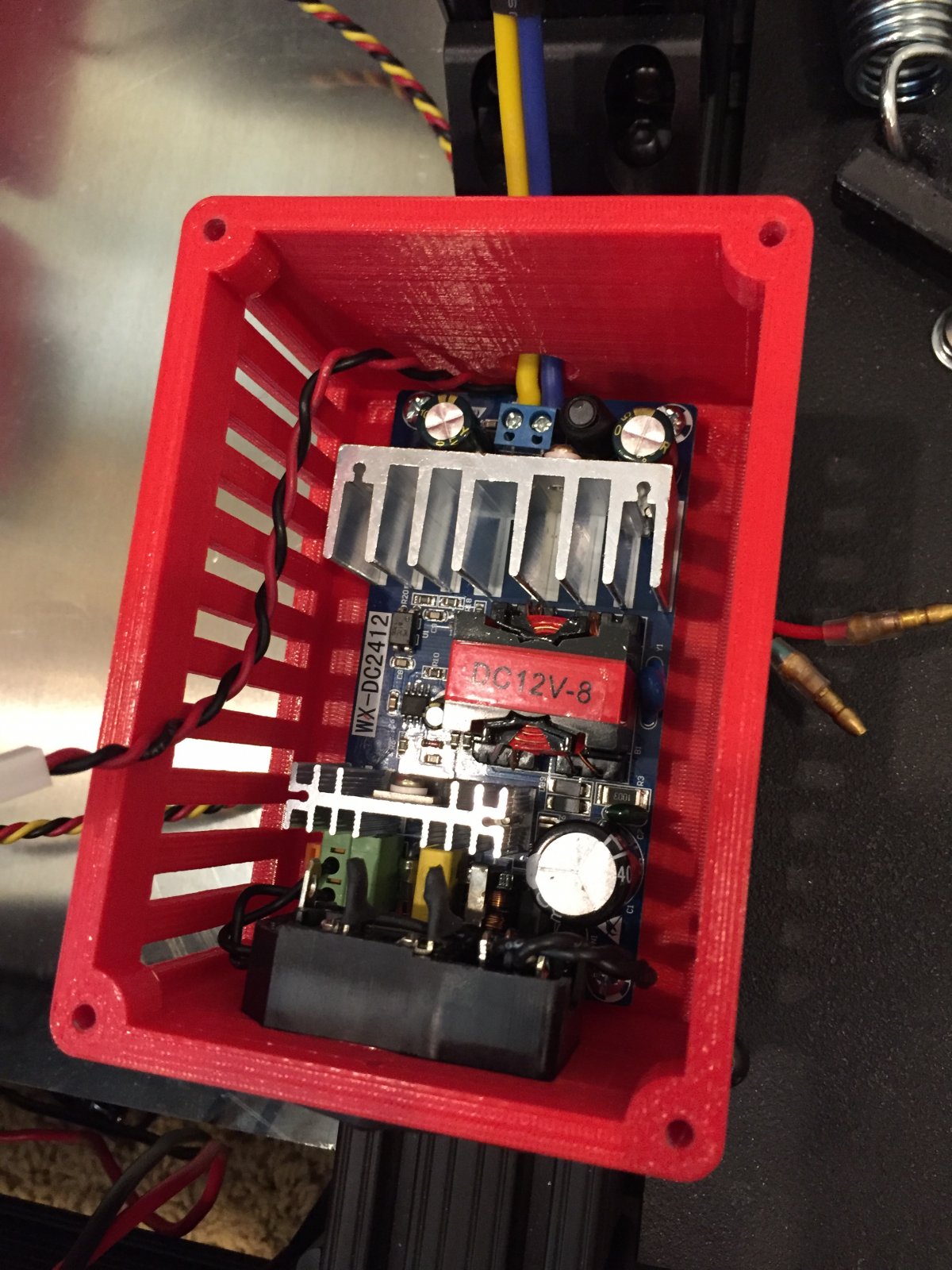

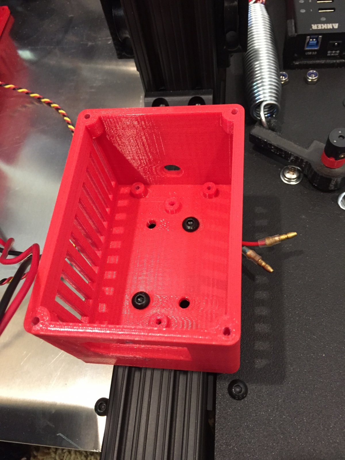

    @ferslash - thanks! This is a box for a smallish and bare power supply with the JRK up top and attached to a heat sink with the lid acting as a clamp. I did another design for the JRKs that has stronger cooling here: https://www.xsimulator.net/community/threads/jrk-12v12-overheating.10327/#post-133655
    I'll post a build thread when I get it all done and tested and hopefully it will make sense. I keep finding applications for 3D printed stuff. It is way cheaper and faster than getting things machined and has been a lot of fun to boot. I've never been able to go from design to part so quickly or easily. I've always had to draw things up and either send them off or wait for our own machinists to be able to get to whatever it was.

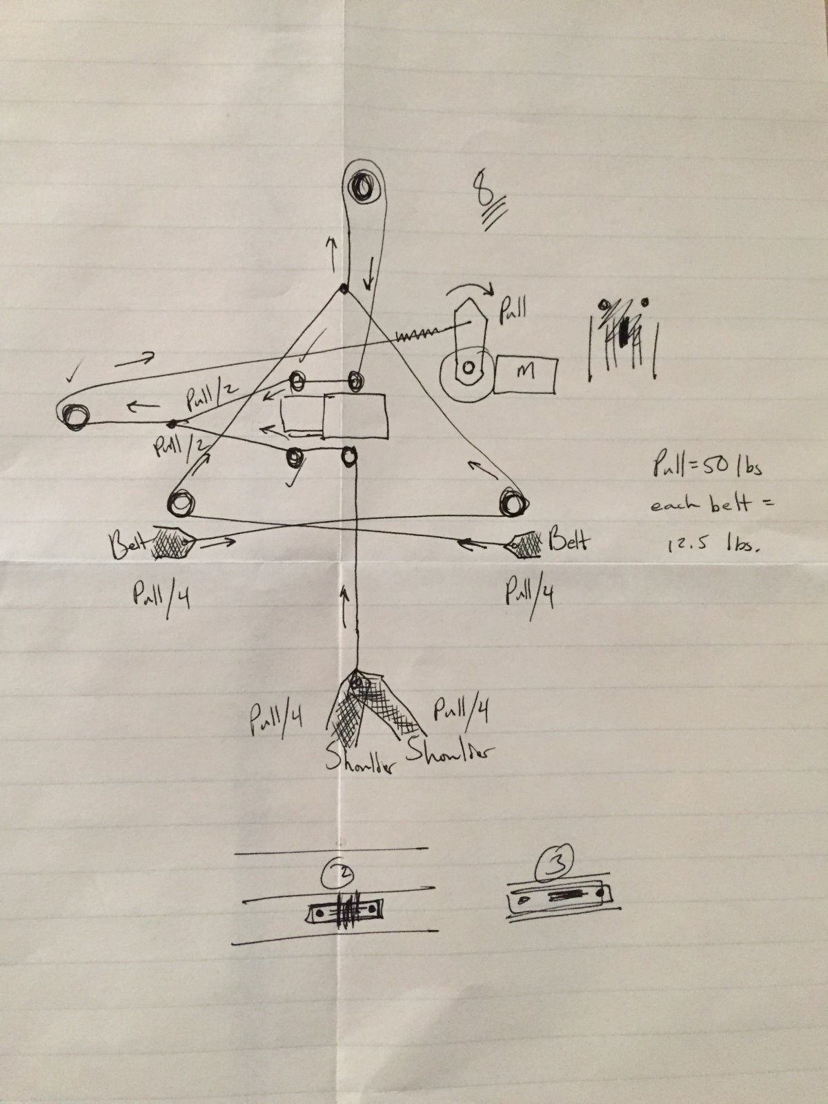

    Finalized the rope routing to get straight pulls (as straight as possible) on the belts as well as get symmetric pull down on the universal joint seat post. It's a meeting scribble... :grin
    The pull from the motor goes through a hobby horse spring and a turning pulley to then split into two to turn and go vertical at the front and back of the seat post. The rear rope just turns at the top of the seat post to the back of the seat to pull directly on the shoulder straps. The front rope turns at the top of the seat post to go forward to turn back towards the seat post. A line from each lap belt crosses each other to hit their respective turning pulleys to go back forward of the seat post so each can be pulled symmetrically by the rope that was forward of the post and turned back at the front of the seat.
    I know this sounds and looks complex but it divides up the motor/spring pull pretty much equally among all the belts, gets pulls in line with the way the belts lay around the seat frame, and keeps all but a few ounces of weight off the seat frame. The motor, feedback, and power supply all ride on the lower, non-moving part of the frame.
    With an approximate 50 lbs maximum pull from the motor and arm over a two inch throw, and a hobby horse spring rated at 48 lbs max, there should be 12 pounds of pull on each belt neglecting friction. I got a pack of 10 fidget spinner bearings (using 8) to 3D print ball bearing pulleys and made seat belt guides that clamp around the belts and hopefully reduce friction as the belts turn around my seat frame.
    If this doesn't make sense, it should get more clear once I get the last of the pulleys printed and installed. It looks tits. :thumbs

    The Bowden cable approach does eliminate the motion platform motion from influencing the seat belt pulls, but the way I route the ropes and where they split does too.
    The one rope splits to two before one rises up the center of the front of the seat post and the other comes up at the center of the rear. There is definitely a downward pull on the seat post but it's evenly split front to back so should balance.
    Up in that diagram where the one rope splits to two and it's annotated "Pull/2" on each cord, if that connection is a pulley then the platform tilting front to back will just roll cord through the pulley with the tension being equal on both cords.
    If this still isn't clear, I'll have more info this weekend when I get it all laced up. Weekdays are hard to make much progress.

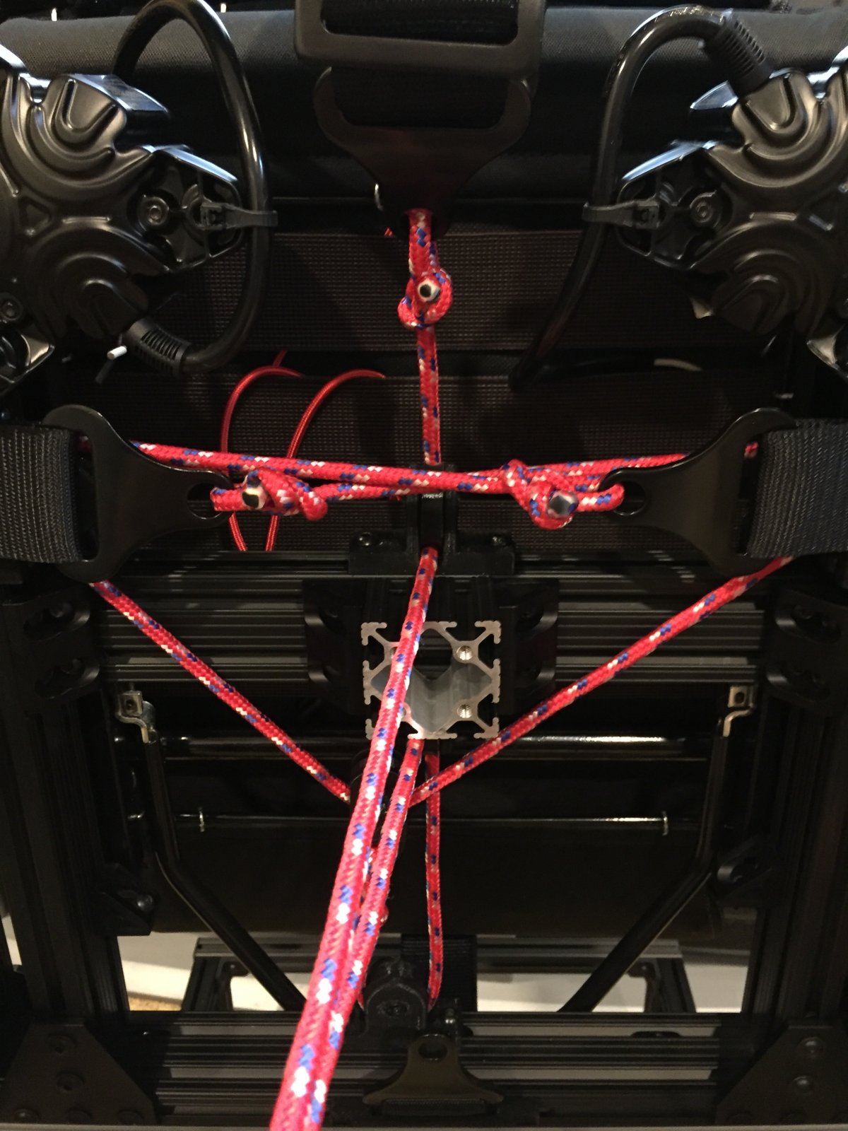

    Made progress today. My seat tensioner is all done except for the motor output arm and works great with manual pulls. It's still in two parts and I'm up to a full compliment of 10 pulleys but the tension is even and friction is low.
    Here's a pic of the bottom of the seat with the two tensioner ropes coming towards the camera that would travel down front and rear of the seat post if the top frame was mated to the bottom. The top of the image is the rear of the seat and the tensioner rope just ties to the shoulder straps and turning pulleys aim it down along the rear of the seat post.
    The lap belts have turning pulleys to pull them straight and there is a partially hidden pulley that pulls on that loop in front of the seat post, with another turning pulley to route the tensioner rope down along the front of the seat post. The front and rear tensioner ropes just form a loop where another pulley rolls along that loop (to pull evenly) with its rope turning to then pull through the hobby horse spring.
    Complex but I think for this sim it might work better than Bowden tube pulls. It was a bit of extra work to custom make the various pulleys though but that was half the fun and they fit the application perfectly by doing it that way.

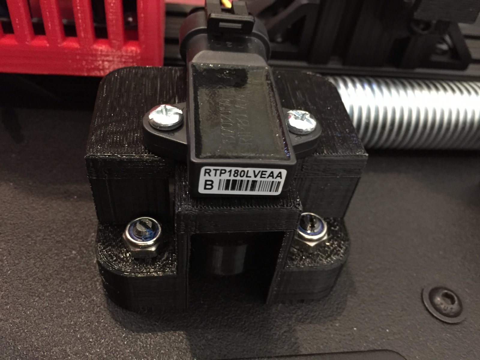

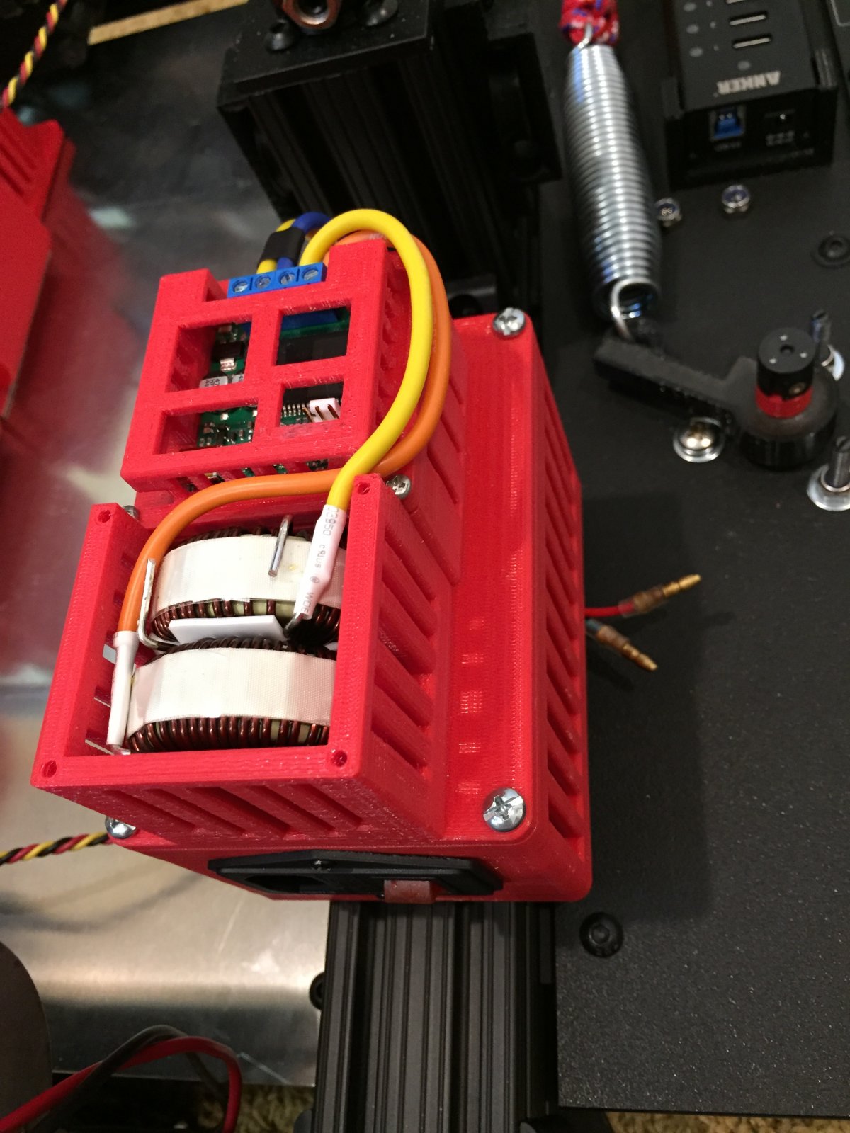

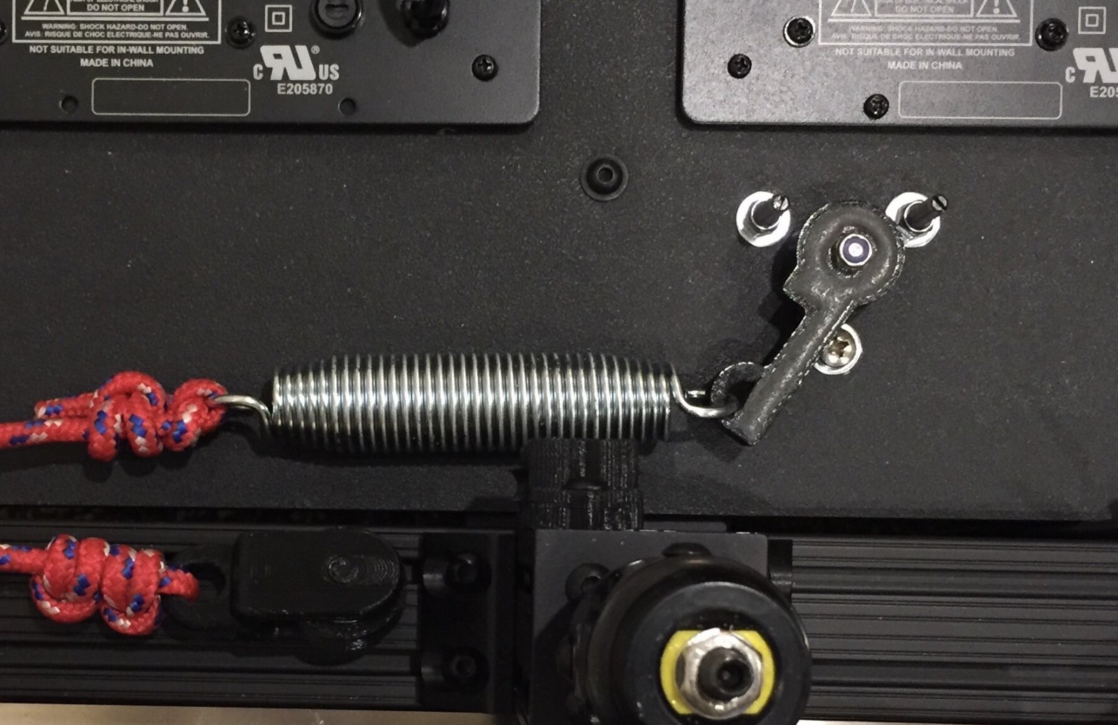

    It's been slow but getting closer. Had to make some revisions to the power supply box/mount and the mounts for the Hall sensor and sensor magnet. But it's looking like it should work well now. The Hall sensor mount is printing a revision so I'll add it soon.

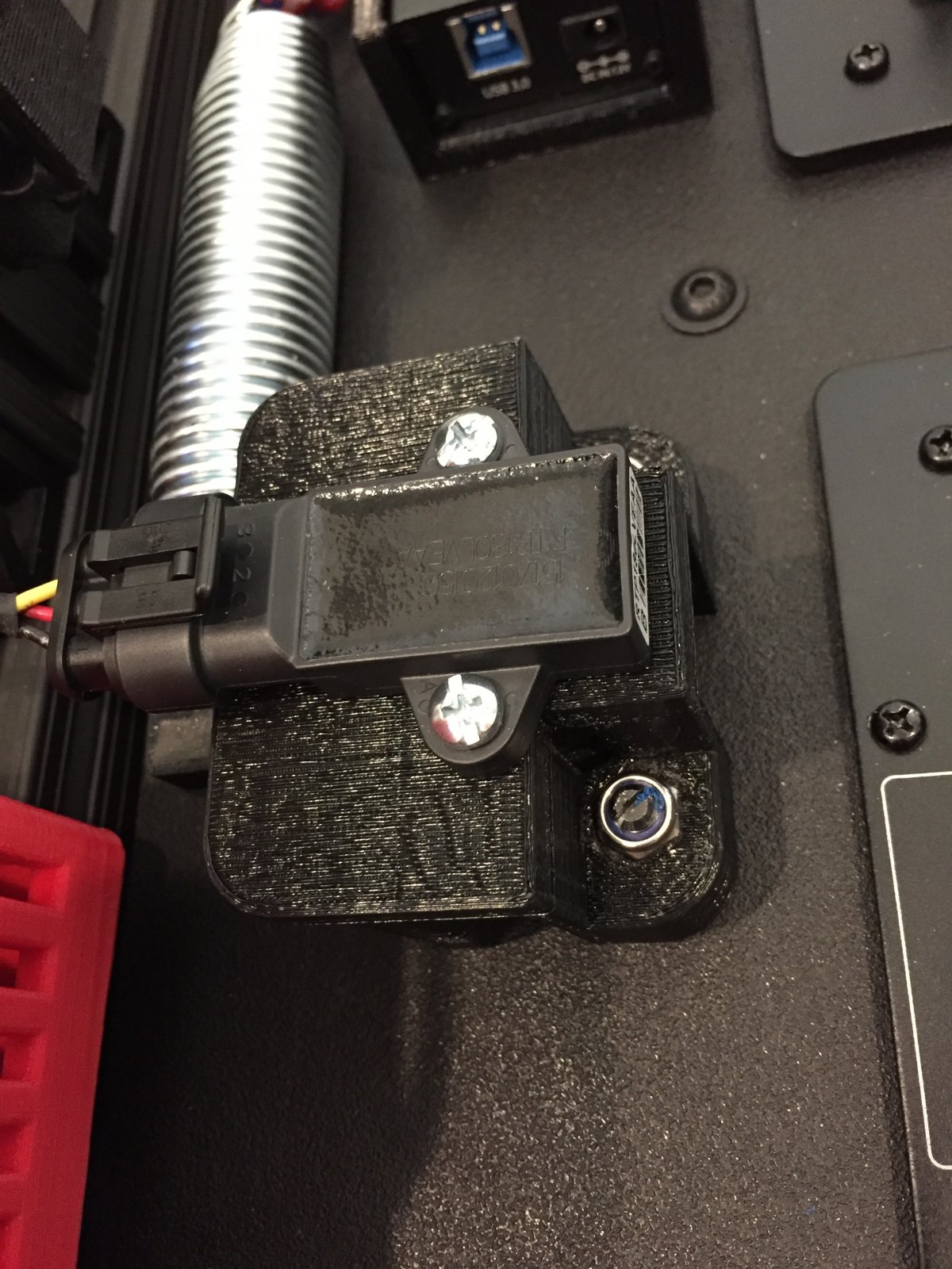

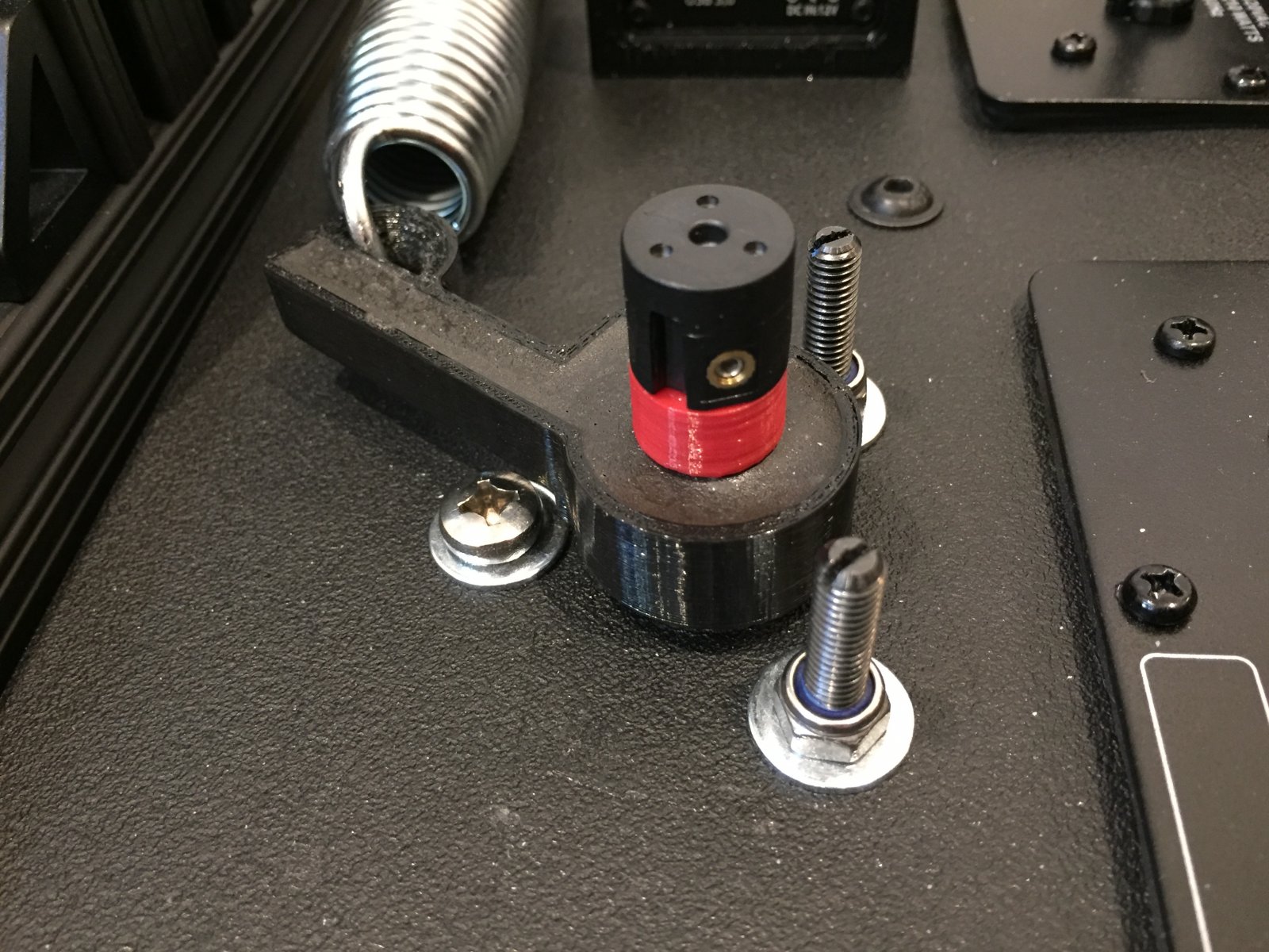

    And the Hall sensor mount. Just need the power connections to the motor and this one will ready to calibrate.

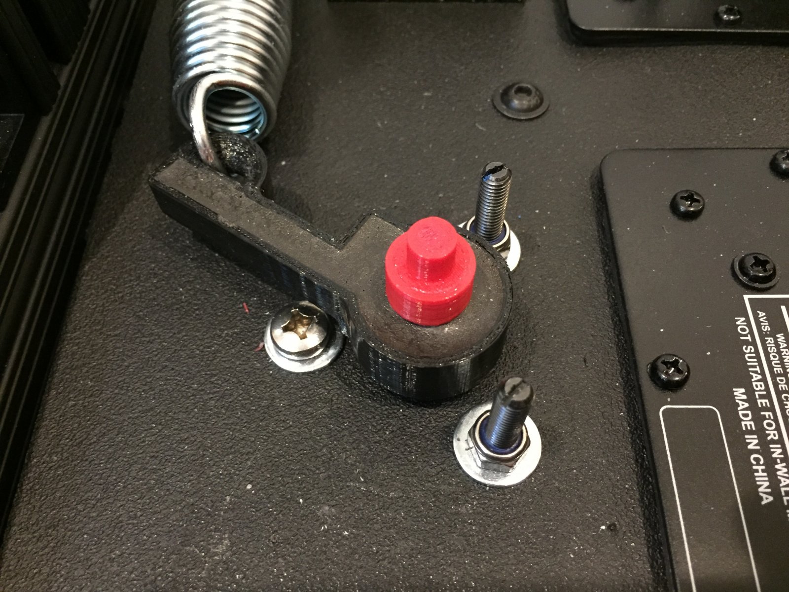

    The little red magnet mount in the post above doesn't hold the output arm down. There is another 6 mm nylon lock nut under the red adapter. There was no thread left above it though. The output shaft threaded part was flush with the top of the lock nut. The red adapter has a hex opening in the bottom of it, just big enough for a snug fit on the lock nut. There is a small lip at the very bottom of the nut cavity to grip the filleted edge at the bottom of the nut even though there is no force or contact between the magnet and Hall sensor.

    Nice, looks like it is coming along fine. FI It always looks good on paper, but every time I have used springs in whatever system on the sim, I have ended up removing them - as they just seem to mess everything up in regard to the system tracking the simulation data. As far as tensioners go, you will be surprised how much compression/flex you will get from the rest of the system (including your body) rendering their use academic. All I have done is set a limit so that the tensioner does not crush me 'too' much.

    Thanks. It's a pretty stiff spring though. If it adds too much flex, I'll take it out since it's in the main pull rope and just use a slightly longer rope. Not really much flex in this configuration, though. The ropes don't really stretch and the turning pulleys don't give any at all.
