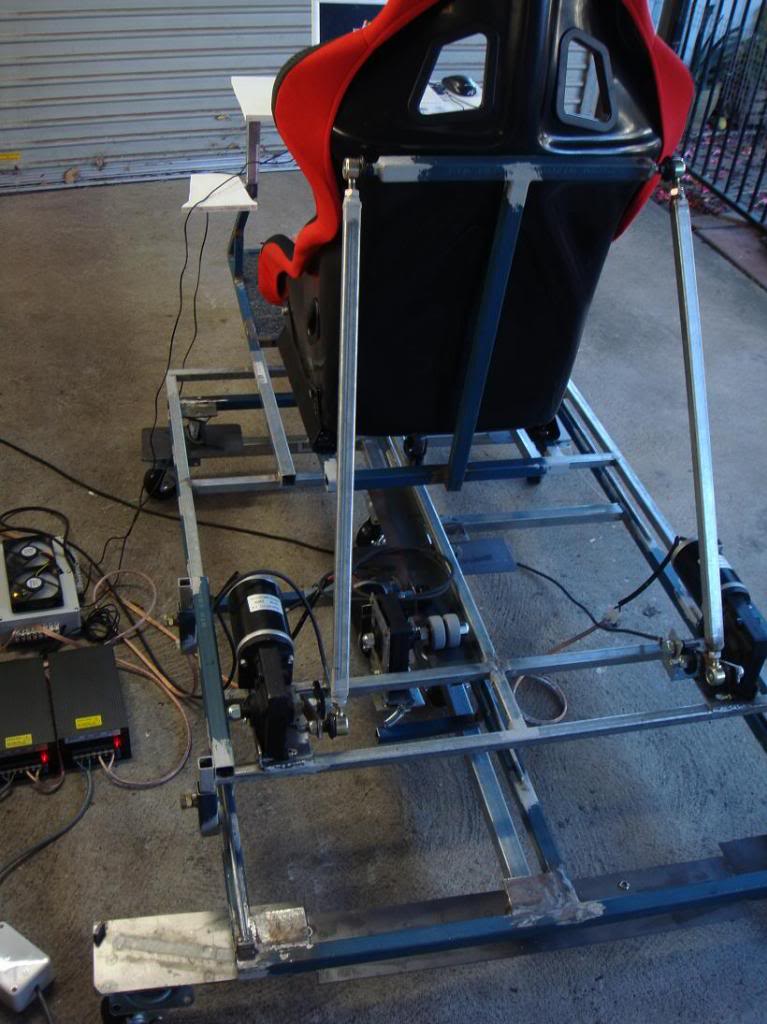

    If you could only choose a 3 DOF, would you pick the addition of heave, surge, or traction loss?
    22,124
    154,370Coins
    +11,179 / 57 / -2
    If it is mainly racing then go 3dof with traction loss and refine heave/surge in the profile settings.
  4. Yoder_
    Yoder_ New Member
    Jul 5, 2014
    28
    IT Dude
    Oklahoma, USA
    400Coins
    +9 / 0 / -0
    Regarding traction loss, did you use a "lazy susan" bearing for the front pivot, or something more specialized? Would you still recommend a chain drive? A ballscrew is tempting as well, they can be found used on eBay pretty cheap. How much throw is required for good traction loss feel?
    22,124
    154,370Coins
    +11,179 / 57 / -2
  6. SeatTime
    2,572
    Thats a good question. I do like having an independent axis for heave, surge and traction loss as it just feels more realistic, but if I had to chose one, then it would be traction loss, as it gives you motion which you cannot simulate via an input to a 2DOF seat. I use a suitably sized load bearing lazy susan for mine. Chain drive has worked out OK, but a ballscrew may be better if setup right. I have around 300mm total movement, but you could get away with half of that if it is responsive enough, I rarely use more than 60% nowadays .
  7. Al.Bundy
    Al.Bundy Member
    Jul 14, 2014
    77
    mechanic
    belgium
    682Coins
    +50 / 1 / -0
    I just used a big front wheel bearing of a ford car I had lying around, it sure enough can handle all the weight, my chain drive works ok for now but time will tell how it will last....its all an adventure ;)

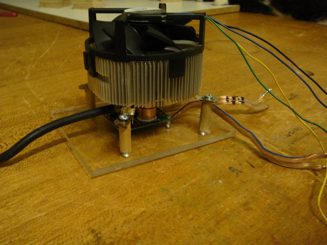

  14. SeatTime
    2,572
    New JRK and Heatsink setup (old CPU fan + DIY heat pipe) for a actuator that I am building.
    No more info at the moment, just taking it slow when I have some spare time.
  15. bsft
    wooden dowel, didnt think of that to mount stuff. Good idea.
  16. Nick Moxley

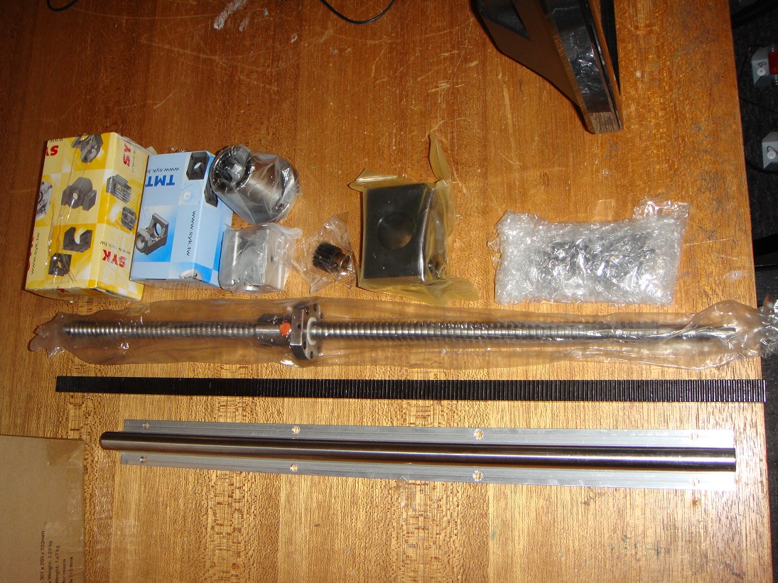

  19. SeatTime
    2,572
    Thanks dualclick.
    Even through my sim is working fine, just cannot help myself in developing stuff:). Some parts finally turned up for my actuator project. Will see if I end up using some or all of them - there are lots of ways to skin a cat.
    • Like Like x 6
  20. bsft
    looks good. at least you ,may actually get something done.
