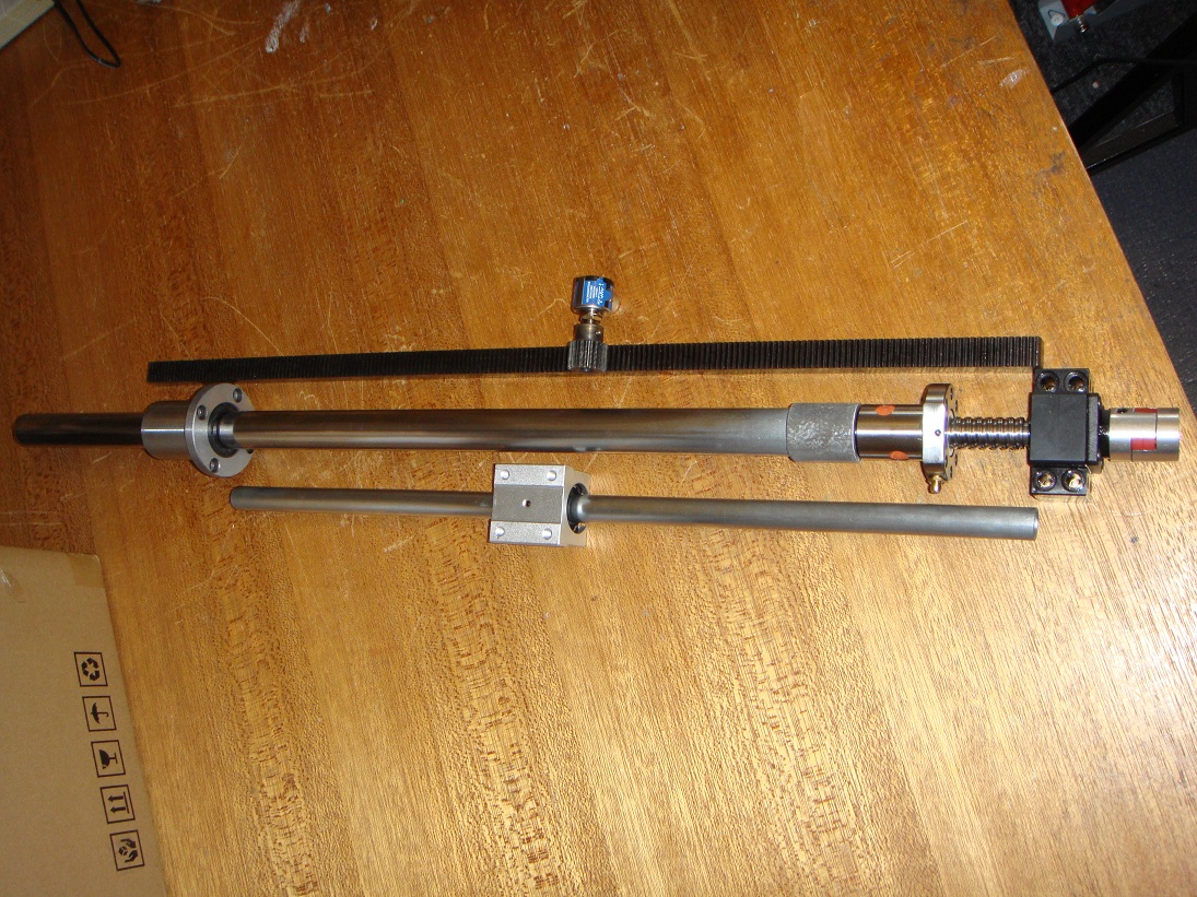

    Busy with the festive season, but have managed to source and hand fit the required main tube, support tube/rail and multi-turn pot. Decided not to use the purchased support rail, as it was heavy and not really needed for an actuator (maybe if I was building a CNC machine). Now to build the frame to support all this and the motor.

    Curious what the Flex coupler is for the on the Far Right with the red bushings.
  3. SeatTime
    2,572
    +2,854 / 40 / -0
    That's were the motor will connect.

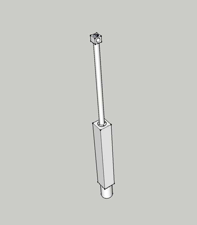

    Concept drawing below : although the motor will be covered as that is were the base mounting point will be.

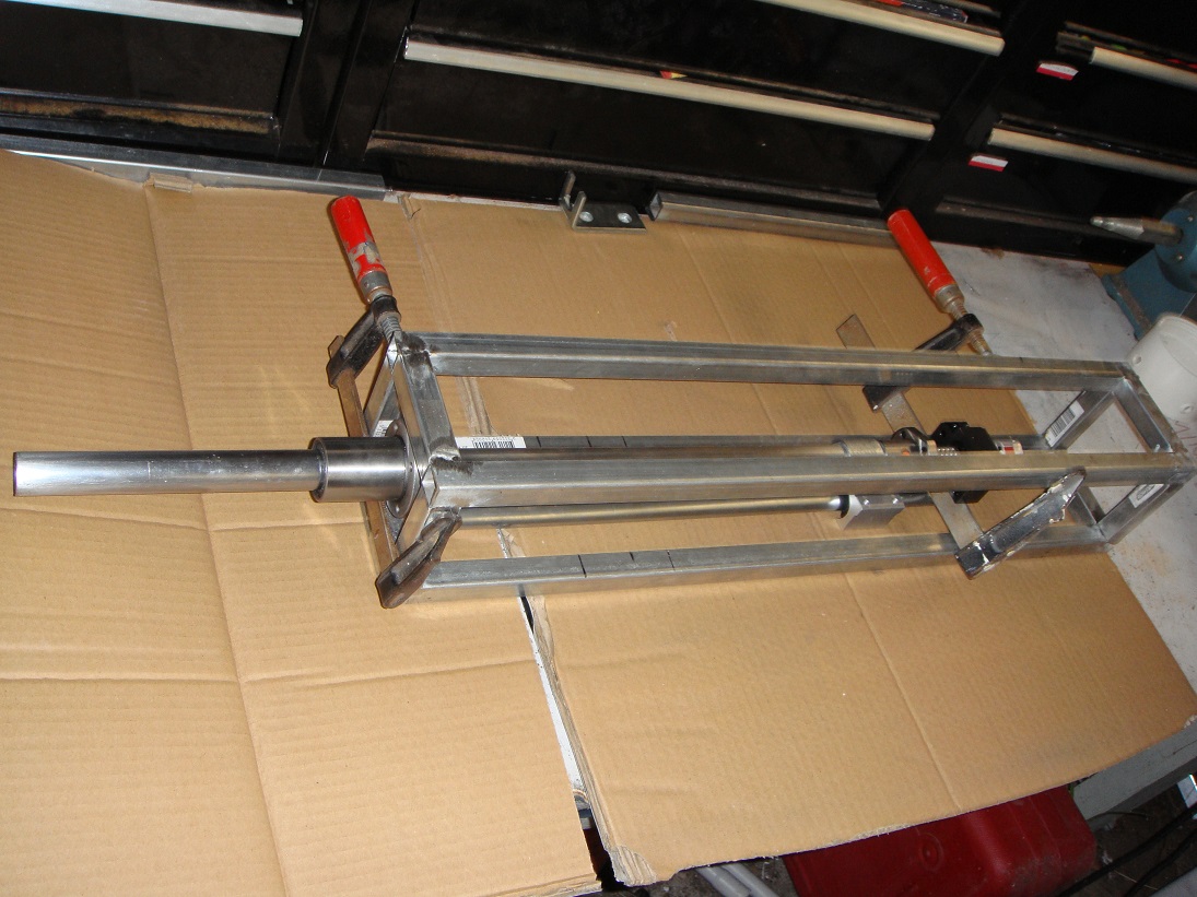

    Actuator build continues.

  6. bsft
    makes more sense to me now
  7. Nick Moxley
    17,057Coins
    +2,507 / 30 / -2
    Ah now i see it. Cool beans buddy, Keep it up.

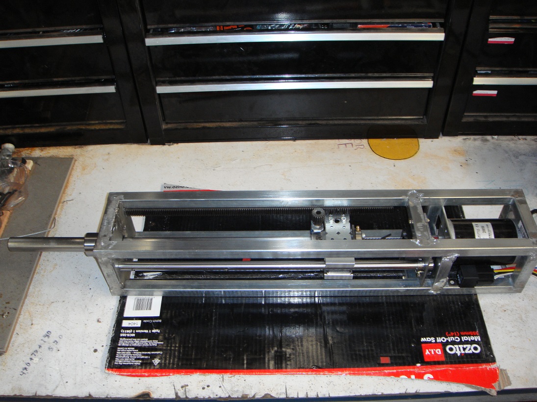

    Building of the Actuators mechanical parts has basically been competed, I just need to wire up the pot, limit switches and fail-safe relay. If testing goes OK, I will wrap it in alloy sheet.

  13. noorbeast
    22,208
    154,711Coins
    +11,211 / 57 / -2
    Looking forward to seeing it in action @SeatTime.
    Were there any unexpected gottchas in the build or did it fall into place as simply as it looks in the photos? I am guessing keeping everything square and aligned may have been the trickiest part.
  14. SeatTime
    2,572
    +2,854 / 40 / -0
    Alignment is certainly key, this although can be simplified by cutting items together in groups (so they are all the same size) and drilling the end plates while they are clamped together (ensures holes for the shafts are aligned). The Ball screw nut bracket was also complex to design. I had purchased a solid steel one which was very heavy, so I decided to built my own light weight version (may try a commercial alloy one in the future) as this is part of the mass being driven by the motor. The design also had to enable parts to be removed if required. I'm also very interested in seeing how it performs in regard to speed/torque.
