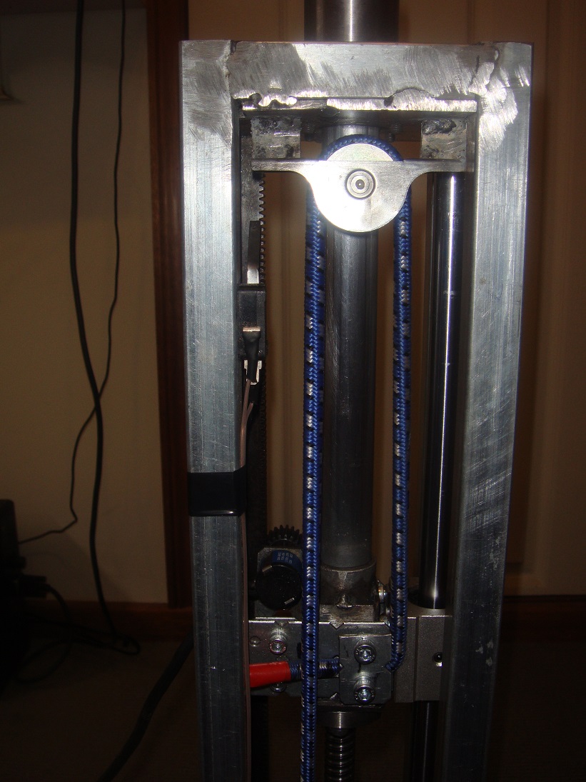

    I'm quietly happy, and these would be excellent for most sim builds, but when I loaded it up more, it could lift it OK but when it quickly dropped in-game the inertia caused the motor to overload/slip and it dropped further and enabled the failsafe. Would like some headroom before I invest allot of time/effort in building six of these (unlike Australian Politicians when they build Submarines:rolleyes:). As I don't want to go any slower, I am going to test some bungee cords inside the actuator frame (I have the room) to balance the expected load as per another actuator design.

    Fitted one bungee on the actuator, works really well and has improved the tracking and removed the inertia issues at wanted load. It seems like the way to go. It may not look like it, but I have room for four. I'm amazed at the speed and weight this actuator can move with a little 200 Watt motor.

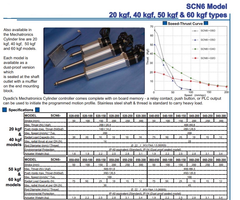

    Linear Actuators certainly have some positives apart from complexity and cost. For interest I looked up information for the SCN-6 (approx $1000 + postage), as I thought it would have similar specs to mine (although mine has a 380mm stroke and I have tested it moving at approx 200mm sec at required load (24kg). Data for the SCN-6 is below, take note of how the max load must drop as the speed increases (max 5kg at 200mm sec). At a similar load to mine their best model can only run at 50mm sec:(. I know you can get actuators with better performance, but the price becomes astronomical ($3000 +), so in that sense the SCN-6 is reasonable pricedo_O. No wonder I'm building my own. Also just read that 'maximum vertical load' is actually 'Maximum Push Mode' so you can take 5 to 20 kg off all the graph data.

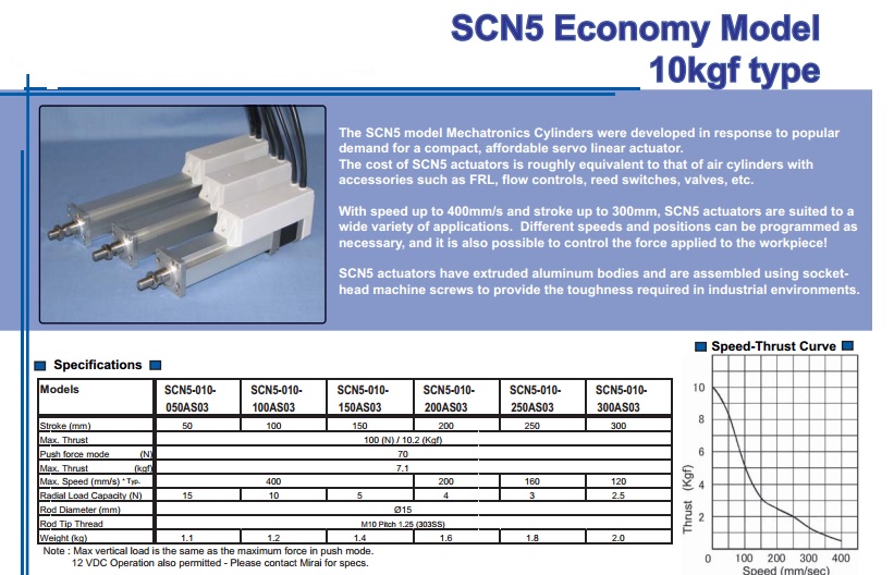

    Also as a comparison here is the data for a SCN5 - No wonder you have to be so careful with them. Good luck ever seeing 400mm Sec:rolleyes:. Maximum vertical load 'Push force Mode' is also less than shown in the graph as per the SCN6.
