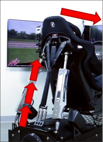

    Yes SeatTime has done a very nice job indeed! Actually, I think a true “surge table” for g forces would be hard to implement unless it were on a long track and lacking outside visual miscues. So I understand the reasoning how the opposite way feels better that moves the body the proper direction even though the forces are backwards. However, I think its better not to have the wheel (if not the pedals also) move with it (or at least not as much). This way the compression of the arms against the wheel adds to the realism. And also this setup looks perfect for implementation of a seatbelt tensioning system. If you want to try this @SeatTime an easy way you could do it is to mount a stationary smooth bar, parallel to and at shoulder height, behind the chair (far enough so you don’t hit it going back of course). You may have to modify the belt straps to make them longer but throw them over the bar and mount them at a 90 angle to the frame. Now when you brake they will pull and compress against your chest and when you accelerate they will decompress. You may have to add a spring or something between the strap and the frame if the compression is too strong to relive it some. Its low tech but it works well for me and every bit of additional feedback adds to the experience.

    Here a picture of what BlazinH spoke about: belt tensionning system with springs
  19. eaorobbie
    20,506Coins
    +1,687 / 23 / -2
    Why not use an Ardunio and a small motor (wiper) to run the tension on the belts. This has been done before to good effect and is adjustable via code too.
