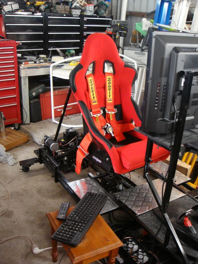

    Fitted a self tensioning (during braking etc) racing harness, works great and stops you naturally fighting the movement of the sim.

    That is a really nice setup you have SeatTime, I am jealous ;)

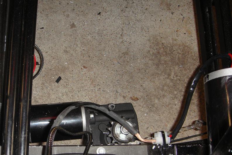

    You made a comment a way's back about replacing the rubber wheels with chain drive. Can you share more information about that? I am experimenting with under body ball castors right now, while they are working I doubt they will for very long.
    I built my CNC table using chain drive so I am somewhat familiar with it, I am wondering how you implemented it for sway?
    Thanks,
    David
  16. SeatTime
    2,572
    +2,854 / 40 / -0
    Hi David, a picture below. This is not ideal, but as I did not want to totally redesign the area I basically just added a sprocket and chain where the wheel drive was. The motor is mounted on a pivot point and there is a serious tensioner that you cannot see due to the limited teeth contact are. Works fine, but I did add some smoothing in the setup to stop any teeth jumping when the car crashes as the changes of direction can be quite violent. Note that the feedback pot is not connected to the motor drive but the moving frame, so teeth jumping/slipping is not really an issue apart from the noise.

    Hey, you dont need high tension to drive chain, what you are missing is angle on the chain or in another word as much teeths in the chain as you can:
    Sorry for simple drawing but i hope you will understand. Tensioner sprokets have to spin freely. Make tensioners axis at least in one line in you main axis and you will forget about chain jumpimg even without much tension on the chain.

    Thanks kurgine thats a good idea - similar to a motor bike. Have to see how I can implement it in the current setup. Likely mount them to the motor mount (seatime at the controls of sim).

    A video of how the sim sits today with harness and a stand for the keyboard (top still in primer). Very close to were I want it, (trying to get it as close as I can to my car on the track) although I am getting some pot jitter/lag on the rough areas of the track when I turn the wick up on the seat motors. Will try connecting the pots directly to the motor shaft, or go magnetic.
