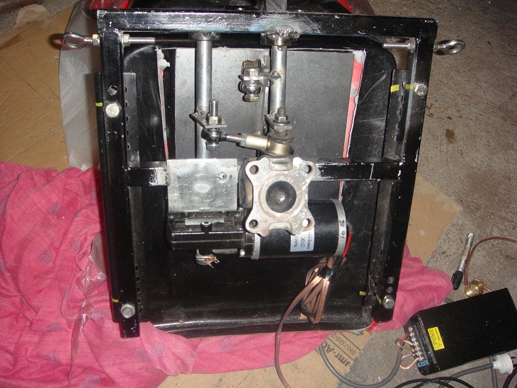

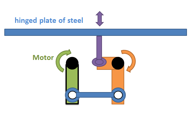

    Racing Mat - Nothing complex going on here it just levers as shown in the first photo. Too hard to get any other shots now that it is on the sim.

    I was just wondering why you seemed to have used two axles? instead of only one ?
  3. SeatTime
    2,572
    +2,854 / 40 / -0
    Yes levers, it hardly needed a diagram. Needed two so that it would work on my rig.

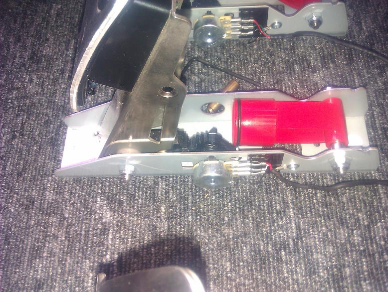

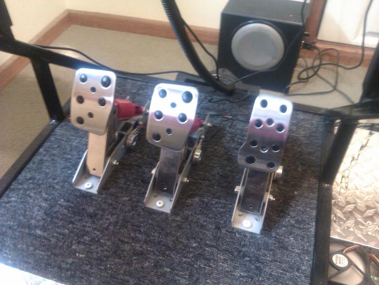

    Finally got around to fixing my pedals so they are spaced the same as my real car and I can now heal and toe with the side of my shoe like I am use to doing. Every bit helps.

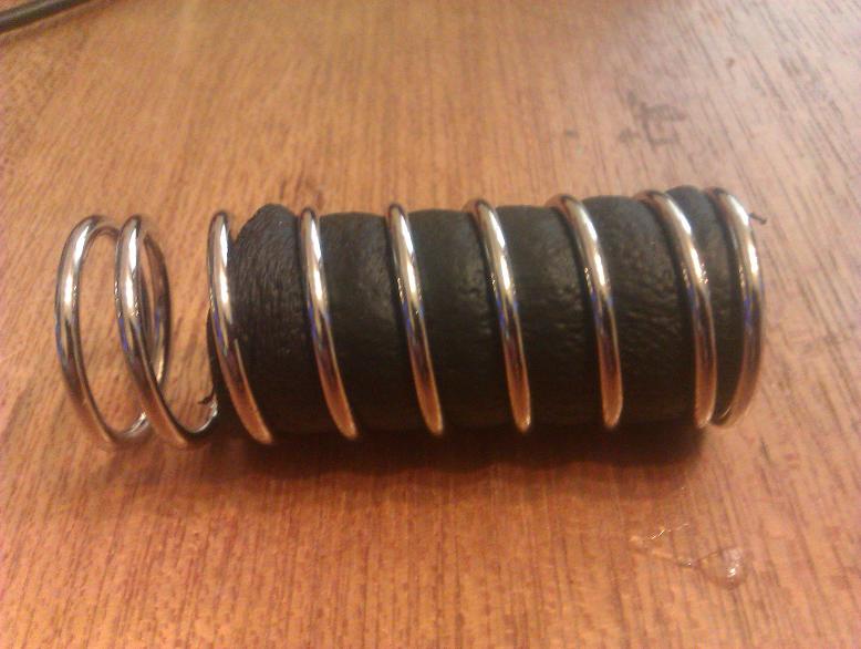

    Added some rubber with the piston mod to firm up the pedal to better represent a real car.
    Piston mod - note O-Ring.
