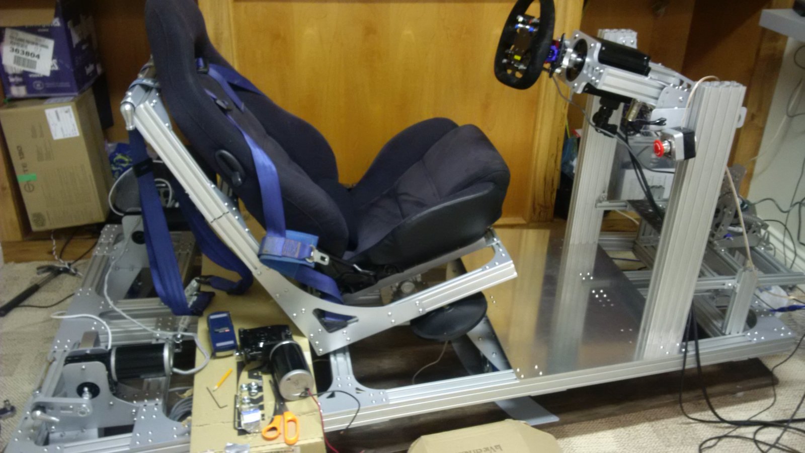

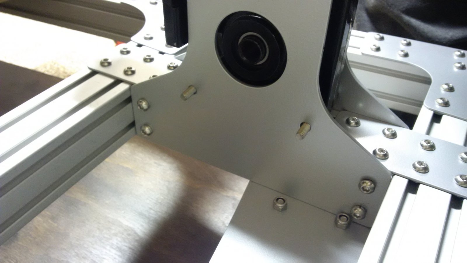

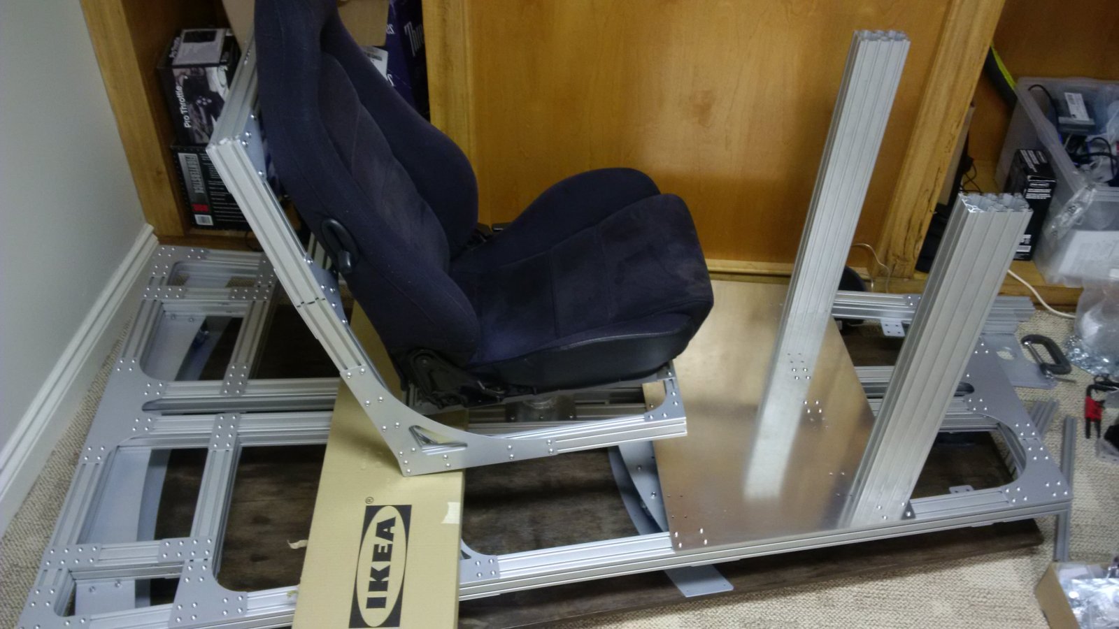

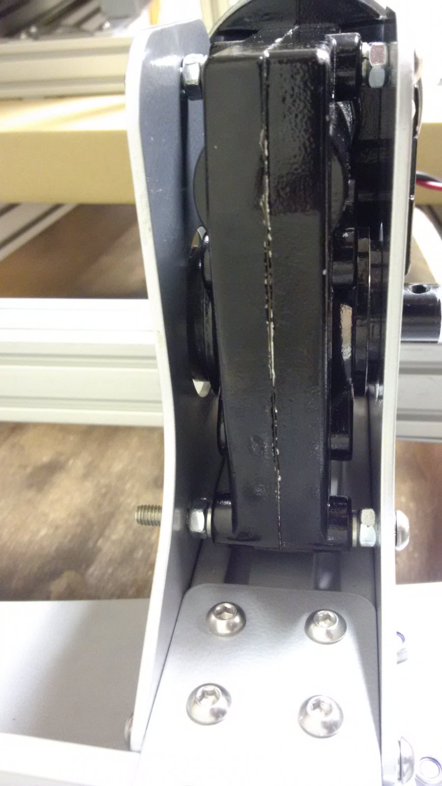

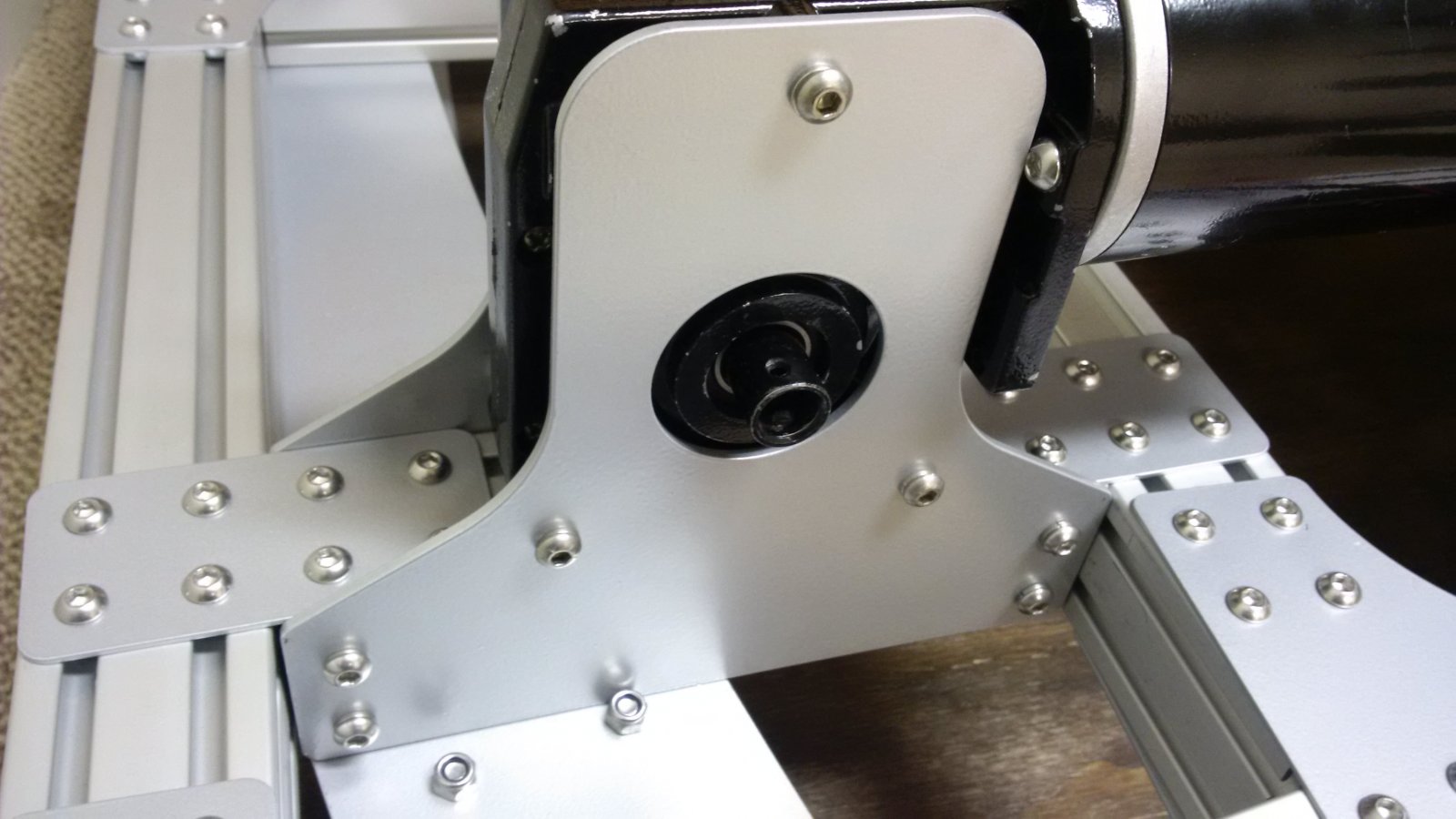

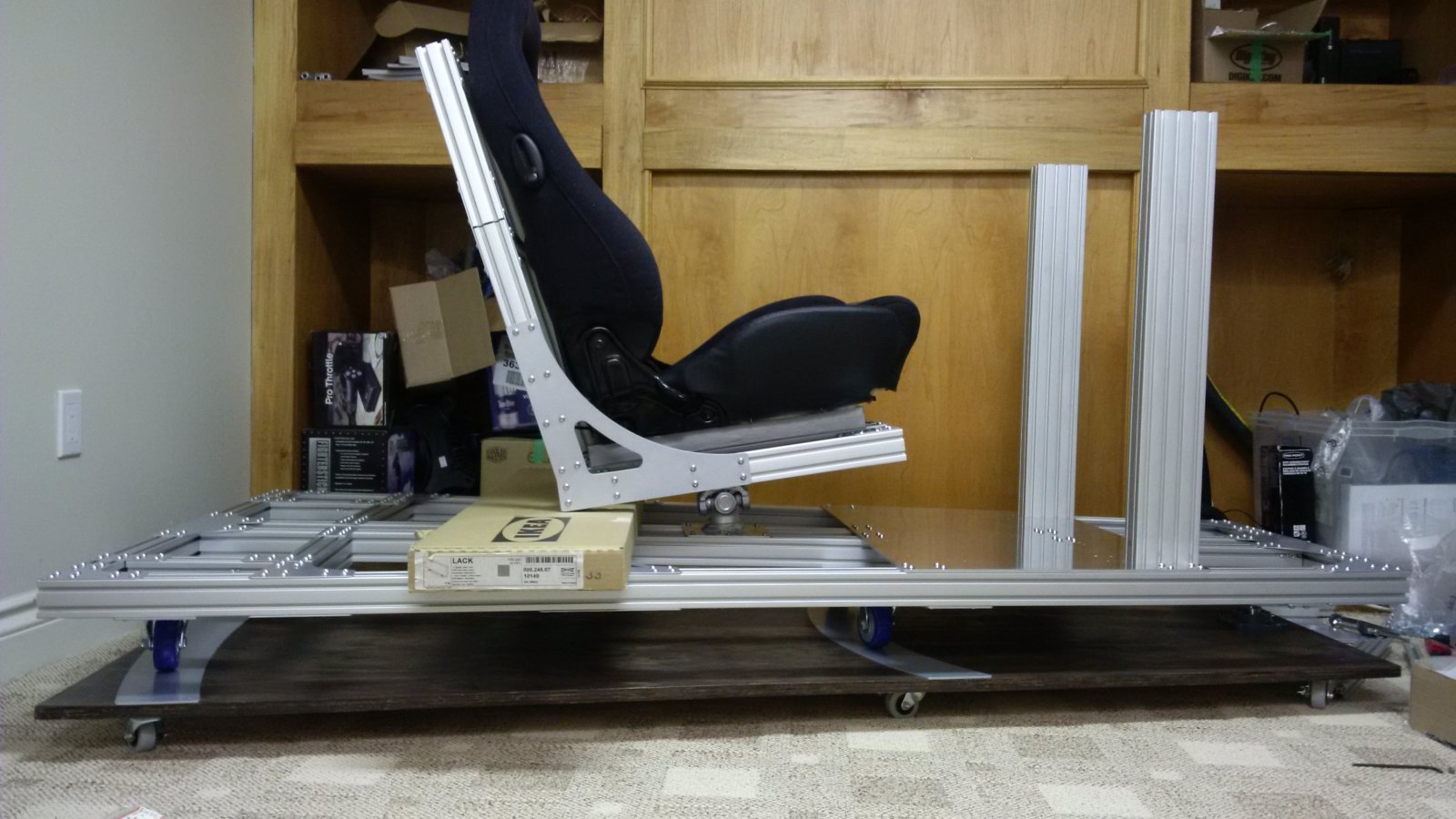

    Bit more progress. Wheel uprights installed, motors mounted.
    Working now on wheel assembly, front pivot point.

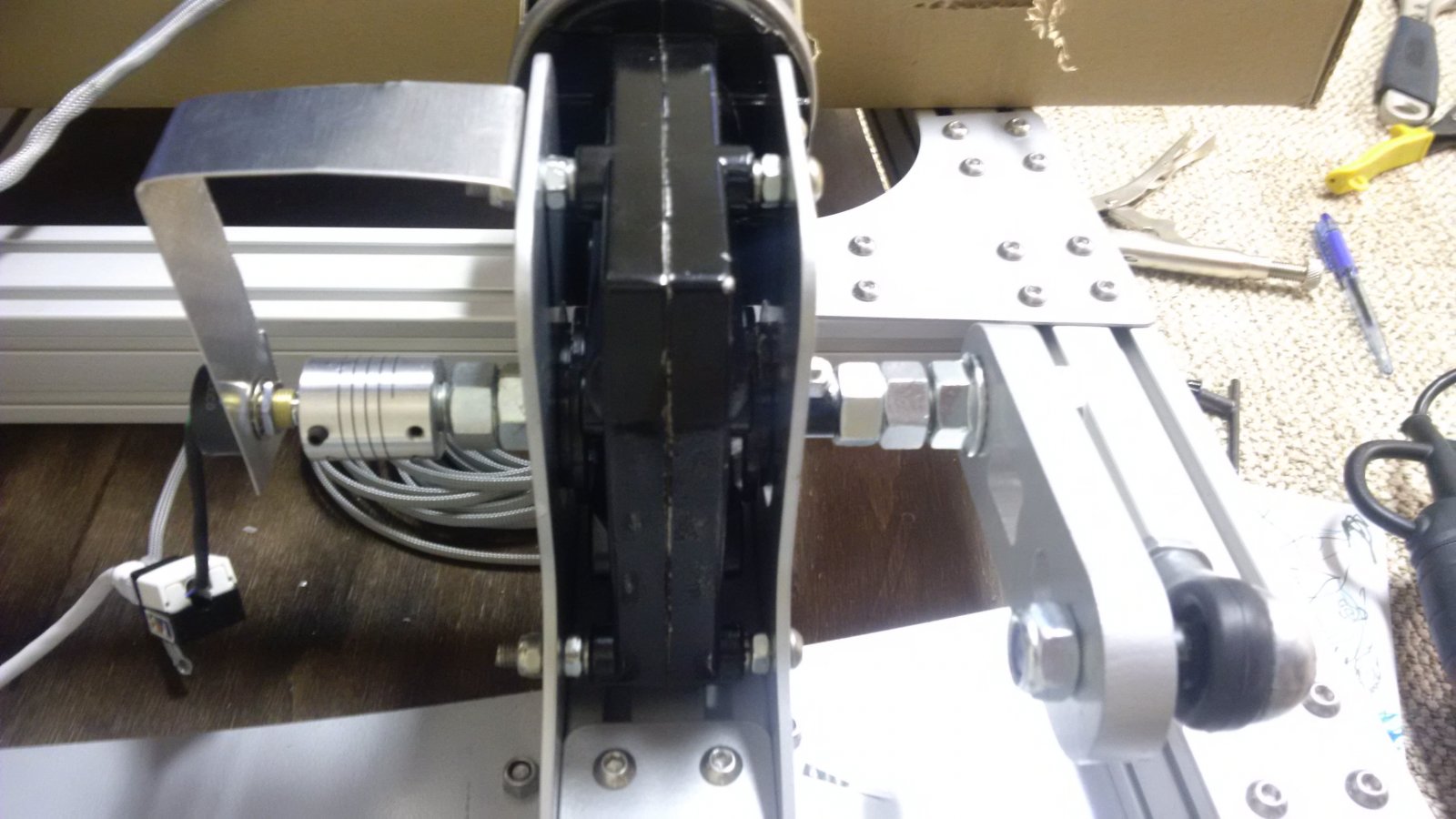

    moved ahead quite a bit. i am in the process of mounting and configurating motors. Hope to be done this month.

    @Sebj ... Thanks for the pics! I am in the early stages of building these same plans ... In Series 15 extrusions tho. (It's what I have better access to.)
    I struggle to see the details in my mind when trying to plan this build ... But seeing pictures really helps me get my head around it! So thank you for that!
    How did you end up solving the front pivot wobble you were concerned about earlier in this thread? That is something that concerned me as well!

    There is no wobble at all in the front hubs - flange bearings. that part of it is rock solid and makes no sound at all when moving. Actually, the whole rig is silent aside from the mechanical noise of the motors and seat.
    There is some 'wobble' in the front of the system where the OSW is mounted because its so high relative to the bottom and the only support is the front pivot. That said, it's not really that much and in practice when racing I have not noticed it. The only way around that likely would be some castors perhaps on the front corners of the unit as well but you will still get some rocking back and forth because of the wheel assembly so i didnt think it was worth it since it doesnt interfere with driving. (I use VR btw, so notice more nuanced motion)
    15 series profile, hmm, might be ok. But are you using 30mm wide pieces or is everything just 15mm? Most of my sim is in 50mm profile. (5050, 50100) <-- 25 series.
