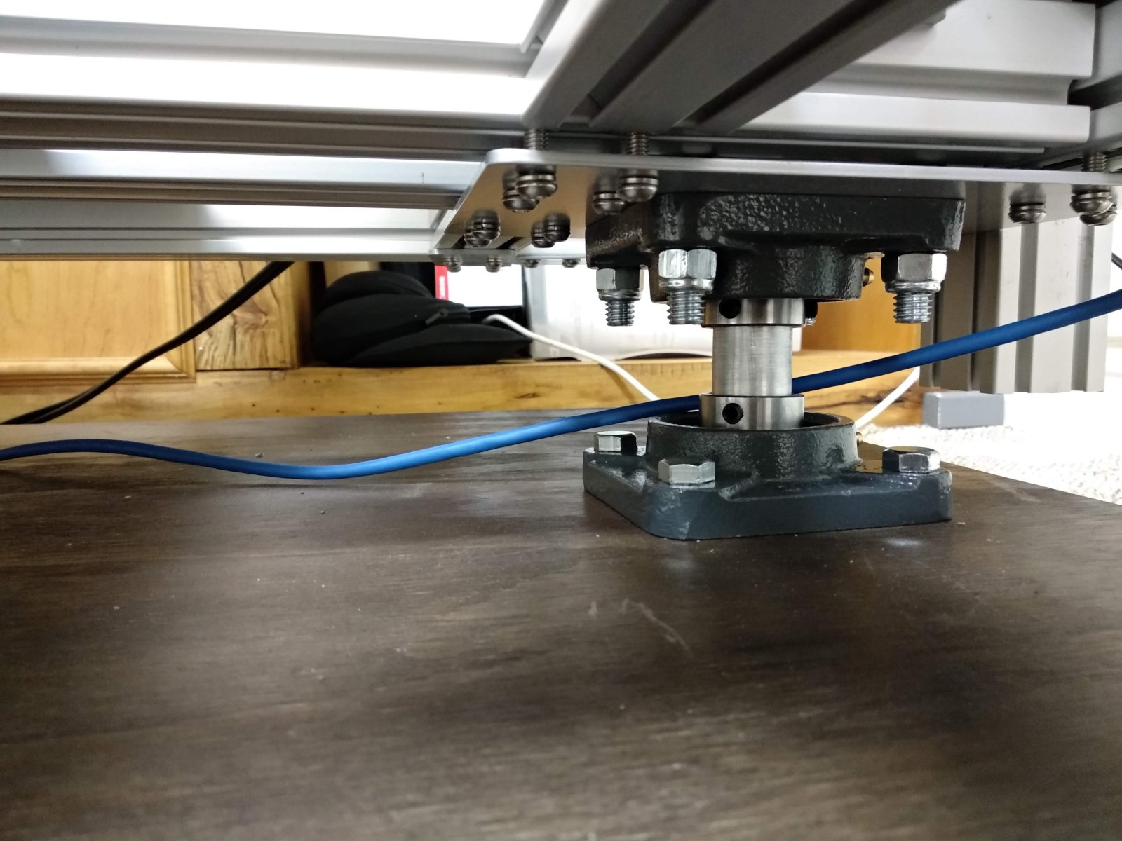

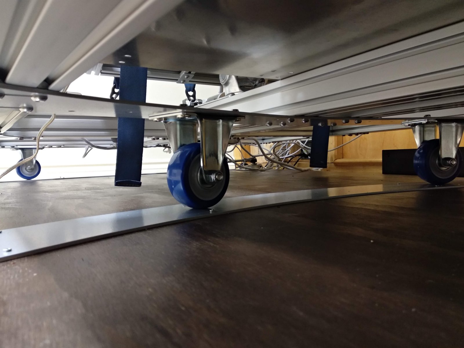

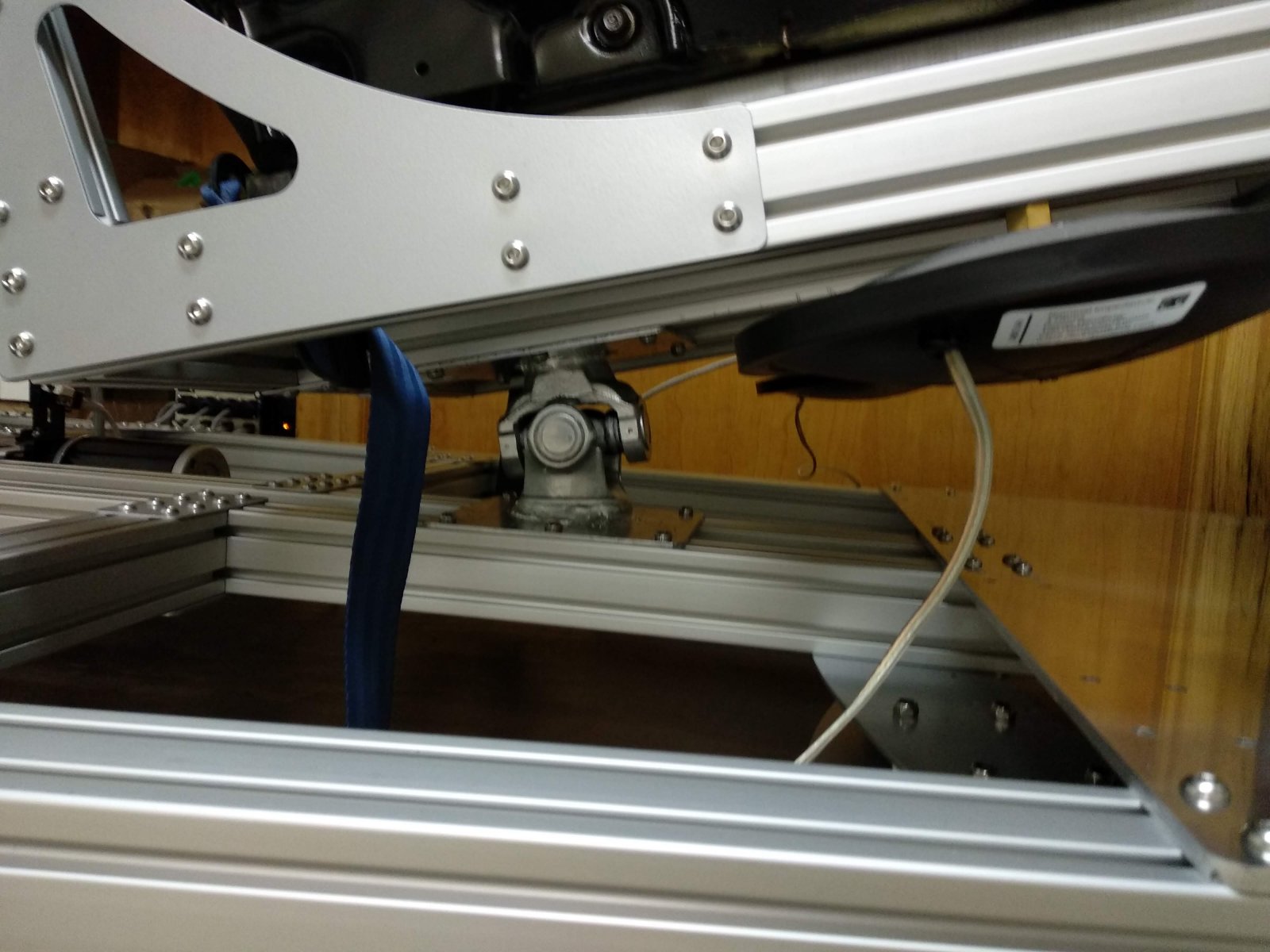

    38mm should be good as you say
    it is the side rocking motion of the rig at the front, its not in the wheel stand posts, those are rock solid attached by 8 screws each from the bottom of the foot plate into the 8020. When you have a single point of contact at the front you'll always get some motion like this no matter what. You could eliminate it more so by adding castors underneath but like i said, I didnt see the point since this movement is negligible when driving only when you rock it with your hand can you product larger motions.
    You can adjust the seat position as much as you want since you can slide the joint underneath it and also adjust how the seat sits on the joint itself - i.e. adjusting the center of gravity (very important!)

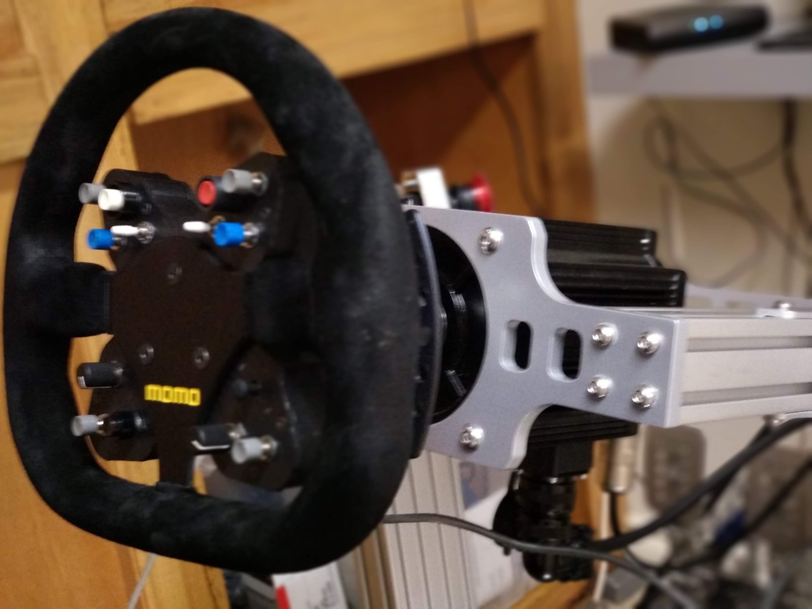

    the wheel is amazingly adjustable, up/down, forward back, angle...

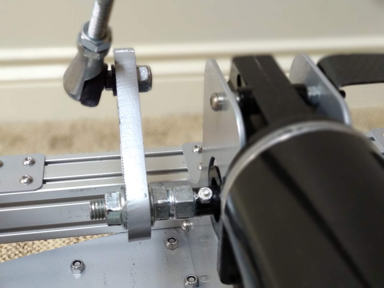

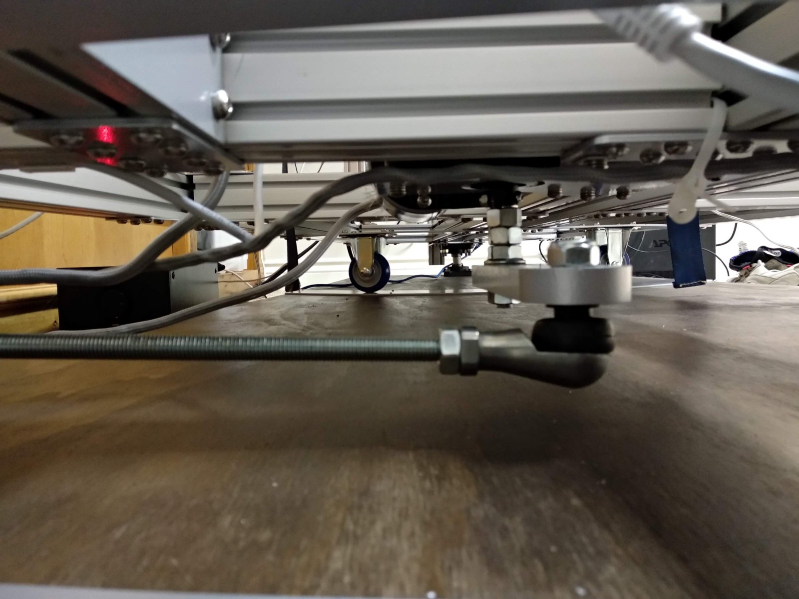

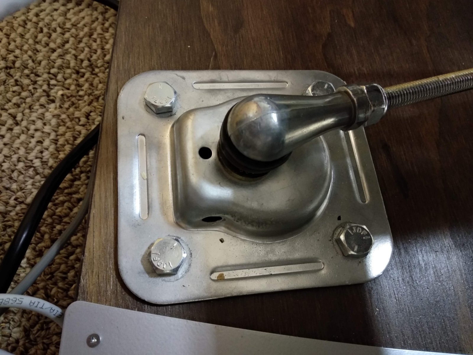

    On TL
    I deviated from the original design on how to anchor my TL rod to the base. I saw this at my local fastener shop for $6!
    took out the ring, drilled a 10mm hole for my rod end, secured it in the middle then secured the anchor to the bottom and connected the rod to the motor level. Works like a charm guys.
    https://www.homedepot.com/p/Husky-1-666-lb-Recessed-Anchor-Ring-54528/206967359
    ...pictures forthcoming

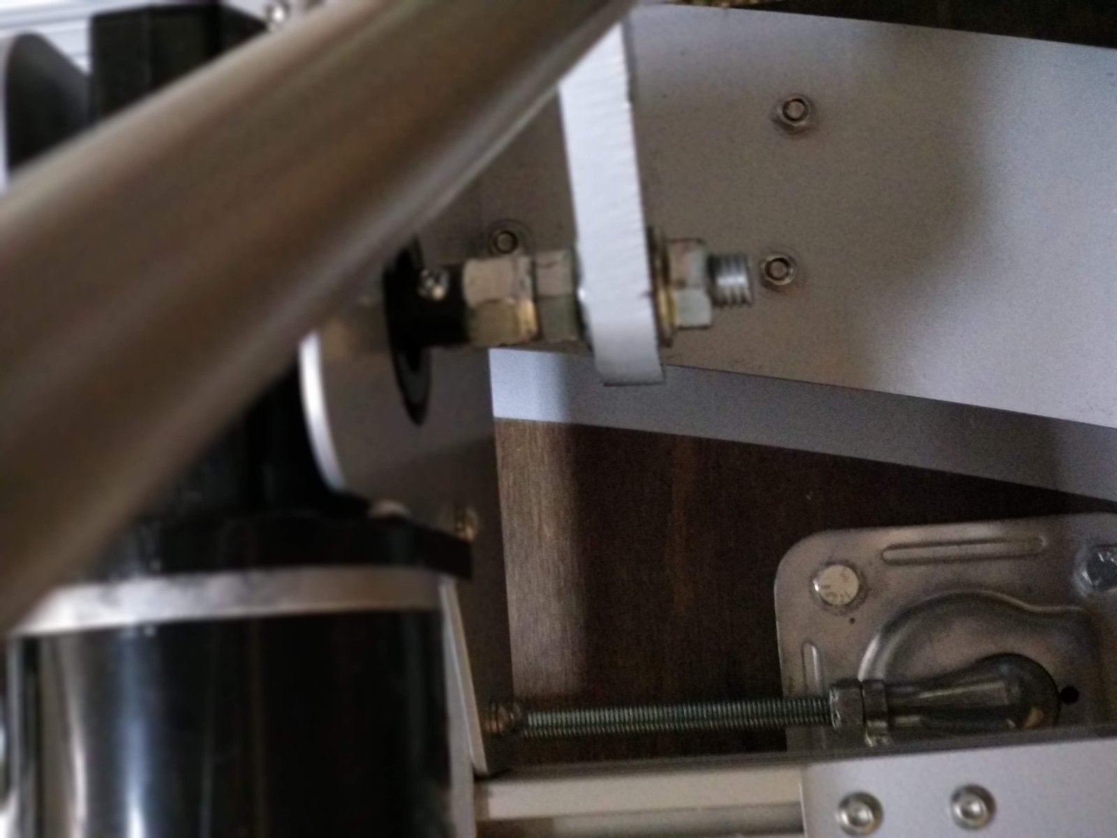

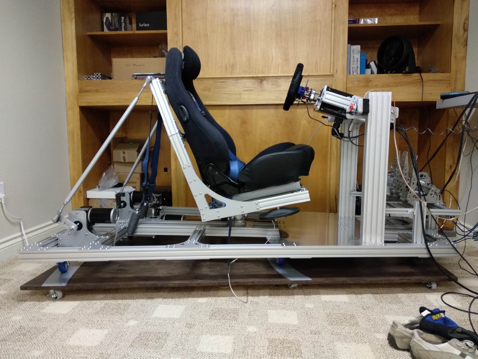

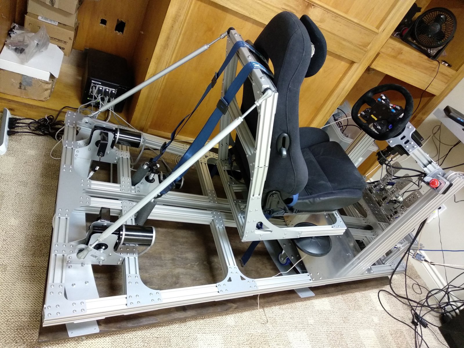

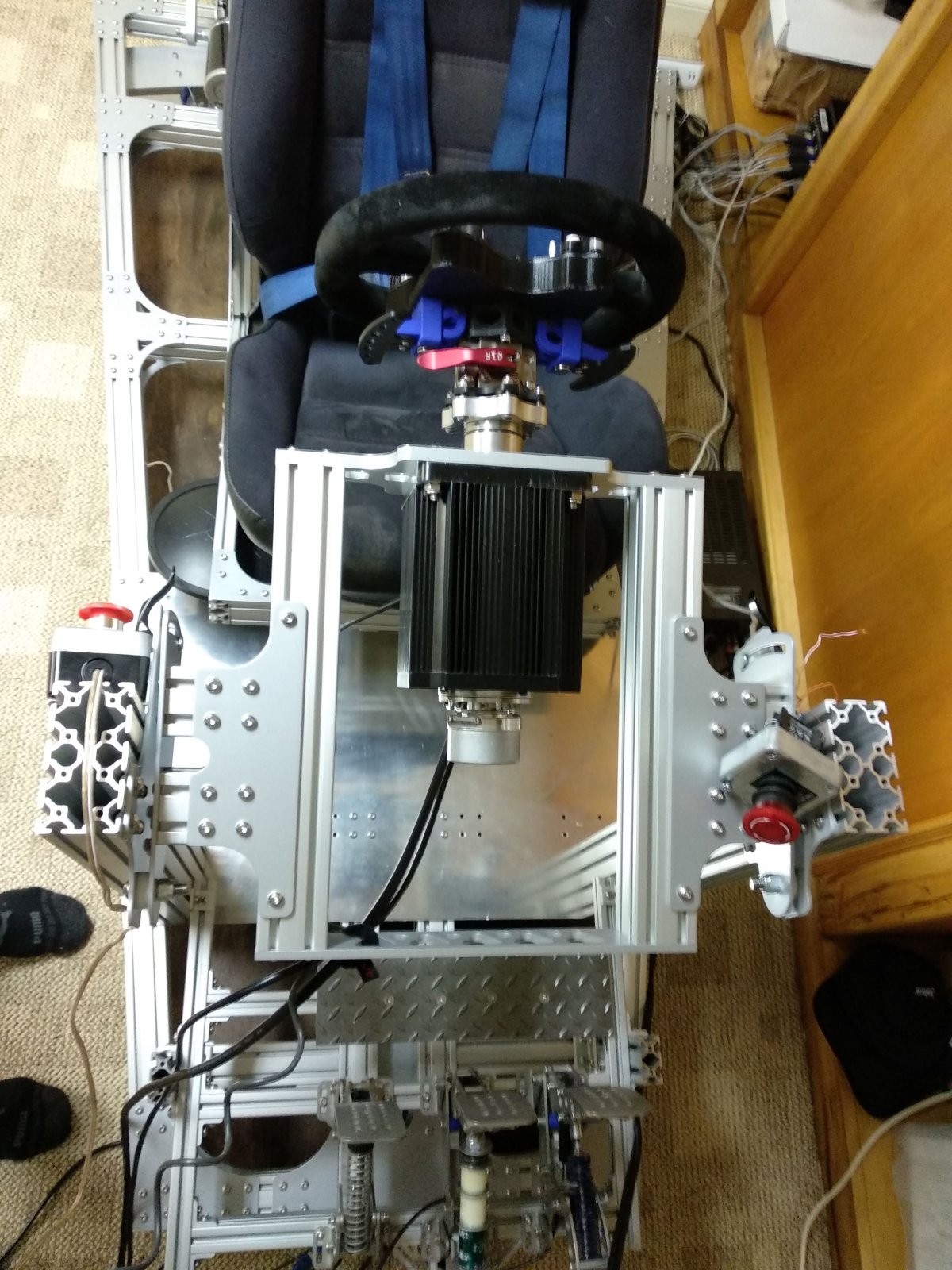

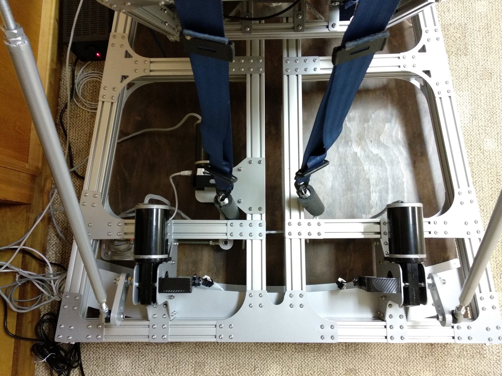

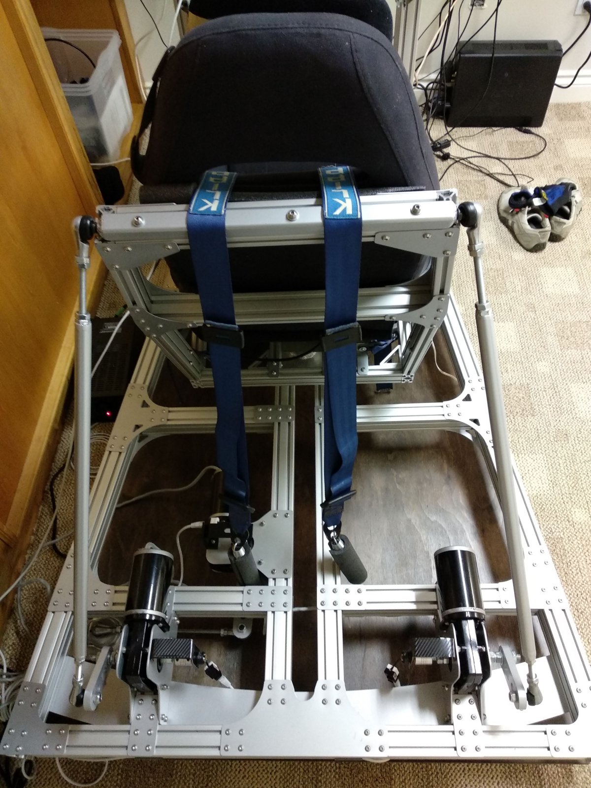

    Still getting things cleaned up, have to mount estops, change my pedal mount somewhat but essentially running now.
    IMG_20180818_225018.jpg IMG_20180818_225129.jpg IMG_20180818_225458.jpg IMG_20180818_225827.jpg
    22,185
    154,750Coins
    +11,196 / 57 / -2
    Looking good, I really like the craftsmanship for all the custom mounts and brackets :thumbs

    Wish I could take credit for the design...Brackets and overall design is opensimracing.com
    The rest is DIY
    Hit up @Nick Moxley if you need anything like that, wheel related or otherwise.

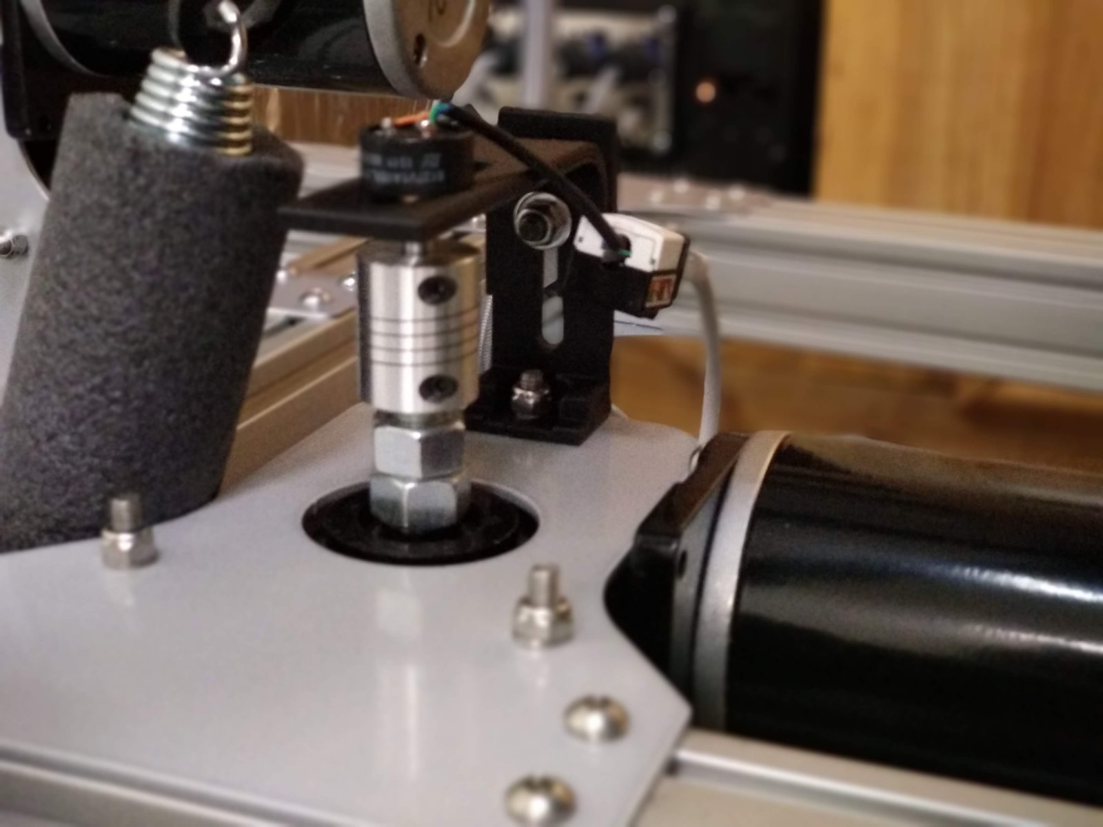

    As I turned on the unit today, I noticed the traction loss motor was spinning. Hmm.
    I broke the screw which I have through the shaft/axel last night. It was a 3.75mm OD screw. I'm going to make a new axel with a 4.7mm OD screw. Hopefully that will be thicker enough to work. The axel is 12.7mm OD.
    This is on a 50:1 wiper motor with a 120mm lever.
    Any other ideas?

    all done. also secured all nuts with locktite on axel.

    Once you find a Big enough cross pin bolt, The problem shouldn't re appear...I haven't touched my TL in years.

    btw, i got my traction loss lever welded to the axle and this is wholeheartedly better than using a screw through the axle.

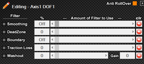

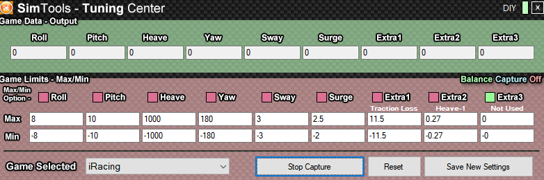

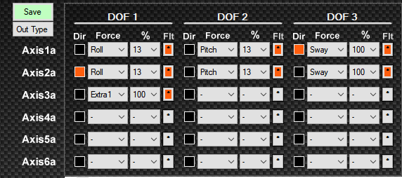

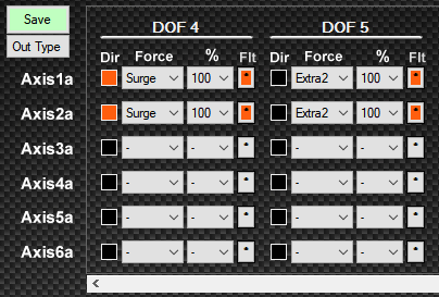

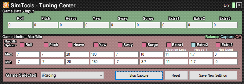

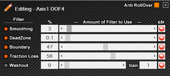

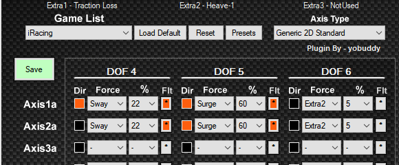

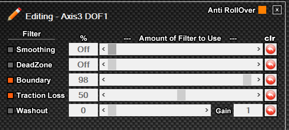

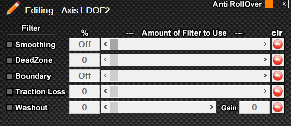

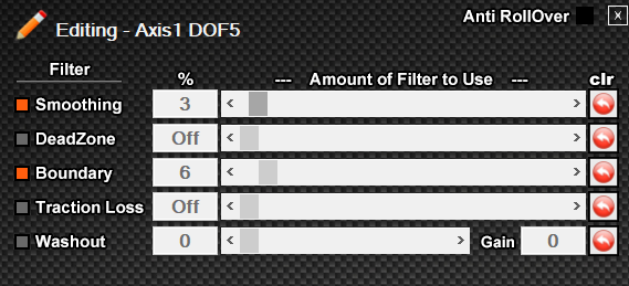

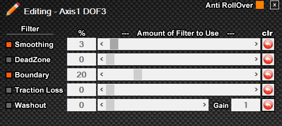

    Thought I'd update. Been running a few nights a week practice on iRacing and some Canada league racing, lots of fun. Took more time to tune the beast. Here are some insights.
    I used to focus on limiting the axis in game engine where I did not want lots of movement. I kept running into the issue of though of not getting the nuanced forces from the sim on the small movements. I then started using the BOUNDARY filter, and what a difference!
    This made all the difference running Extra2, Surge and Sway. I kept roll and pitch axis limited for now since I have been happy with the movement in these axis, I'm not looking for much here from a seat mover. Of course tune the Game Manager to each car, I find the Lotus79 needs some tuning down of Extra2 and Surge.
    Extra2 - Heave/Road bumps
    Extra1 Traction loss
  16. Sebj
