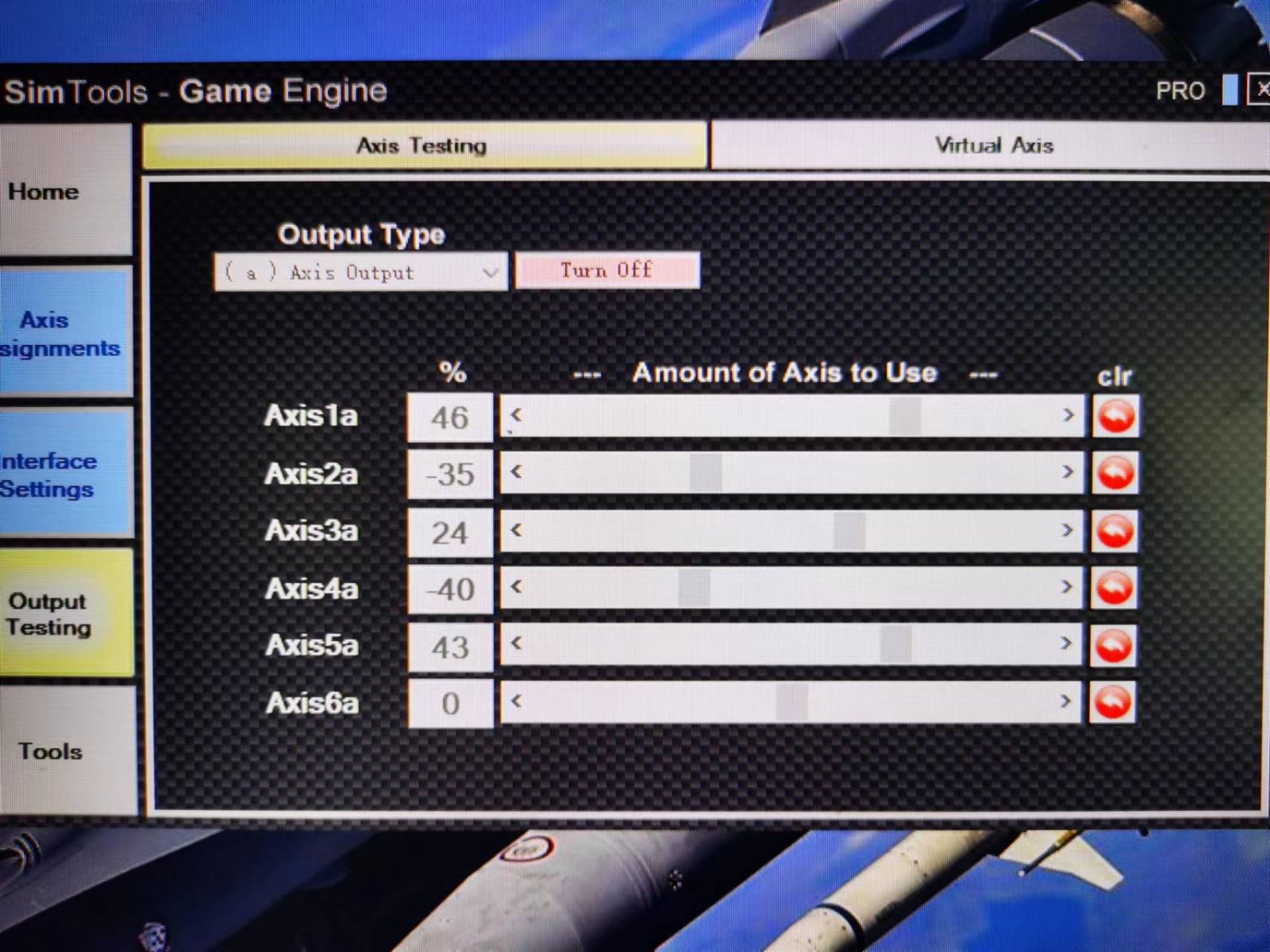

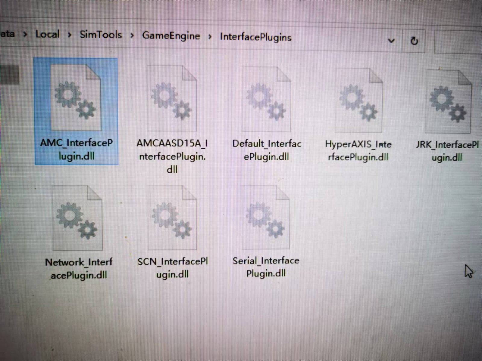

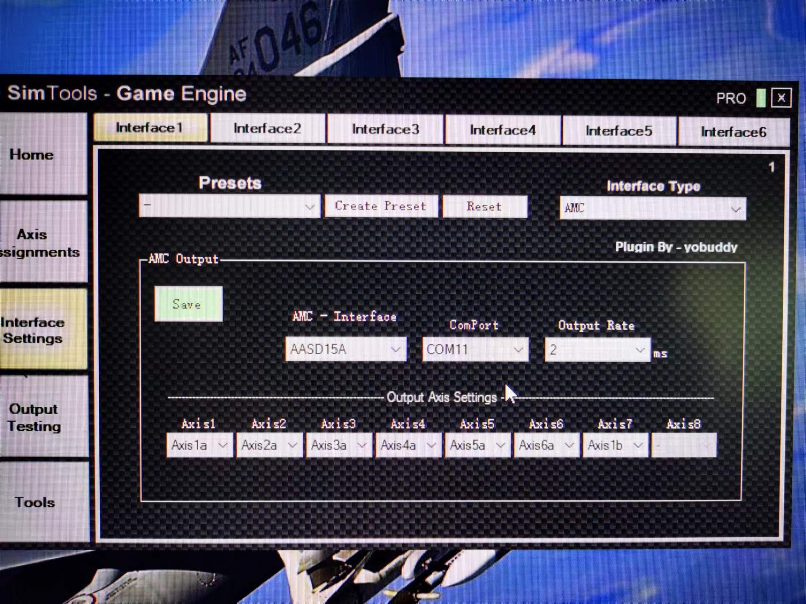

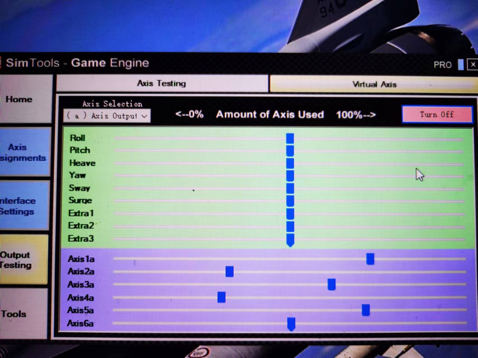

    Simtools has installed the game plug-in and AMC plug-in, and the AMC controller is correctly connected. However, when simtools clicks the axis test, the AMC screen does not display motion data. What is the reason?

    The test sliders will work if you select AXIS, not DOF... like in this video:

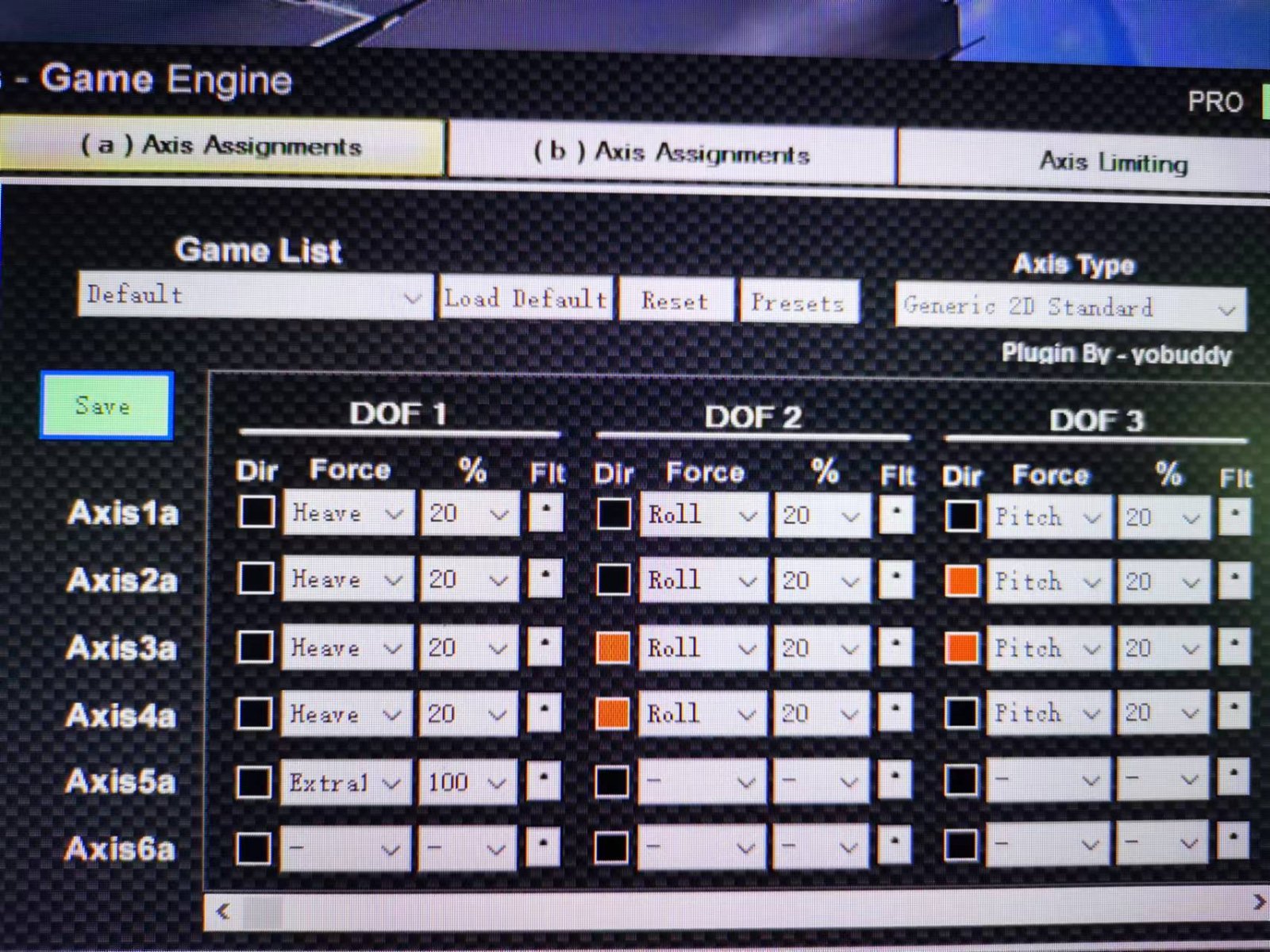

    I set simtools according to the instructions, but the servo motor still can not move. I want to know what the problem is?

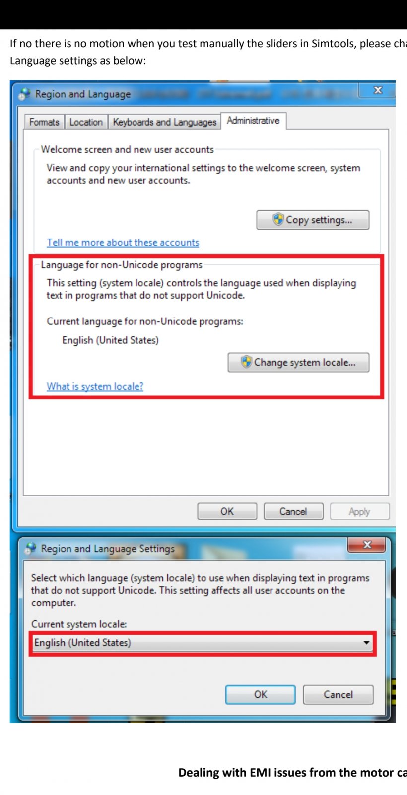

    Is your PC non-unicode set to US locale?

    Thank you very much. I can control the servo motor through simtools. I'm so happy.
