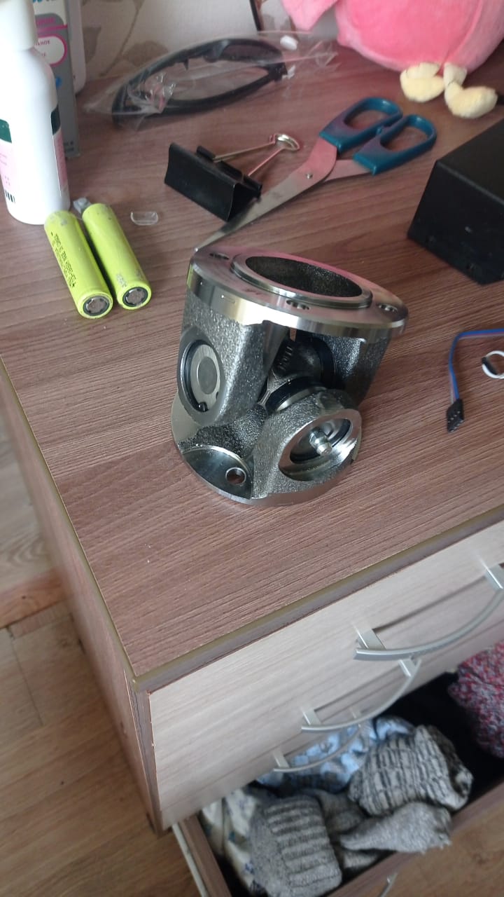

    Great job. I used car parts. They work great in my project. But I had to modify the grinder

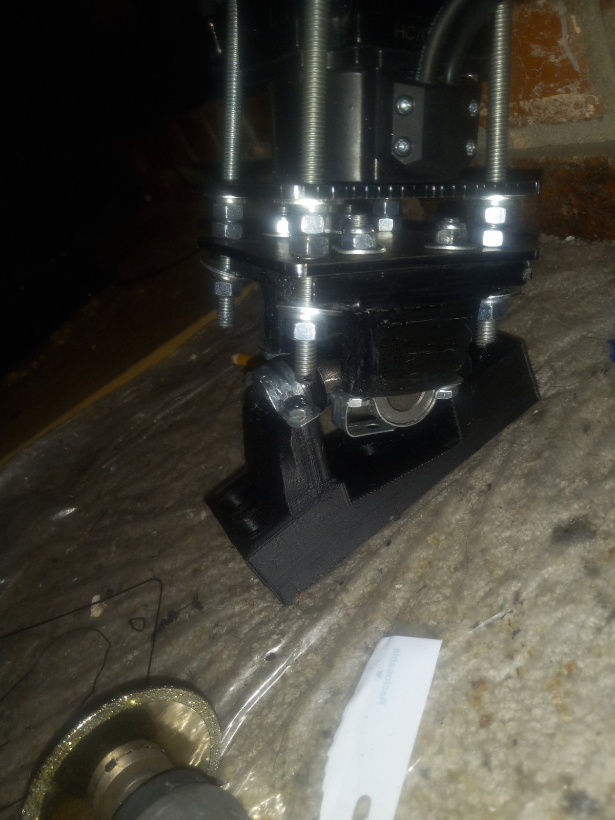

  7. Rodeo5150
    Mar 21, 2019
    222

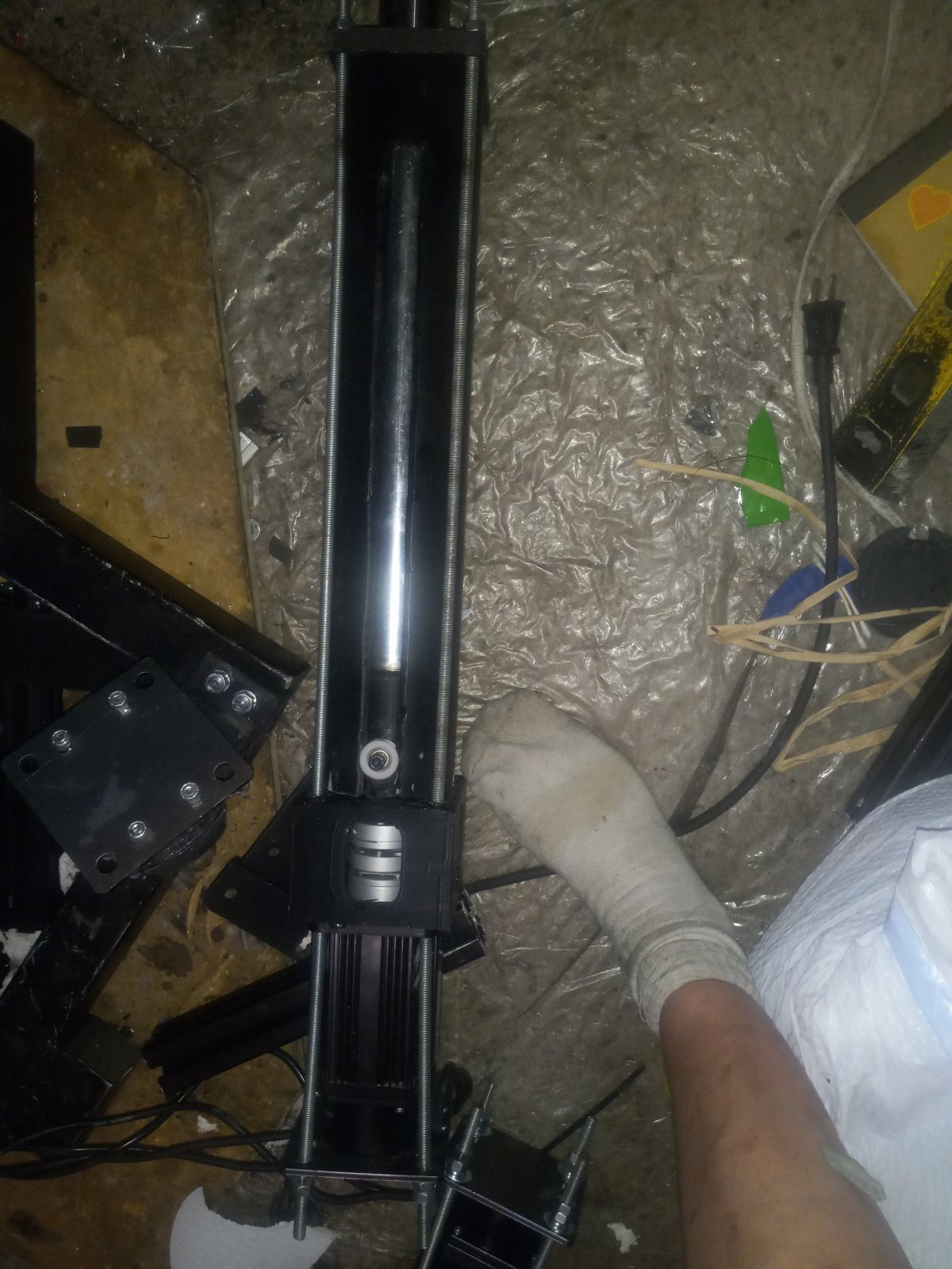

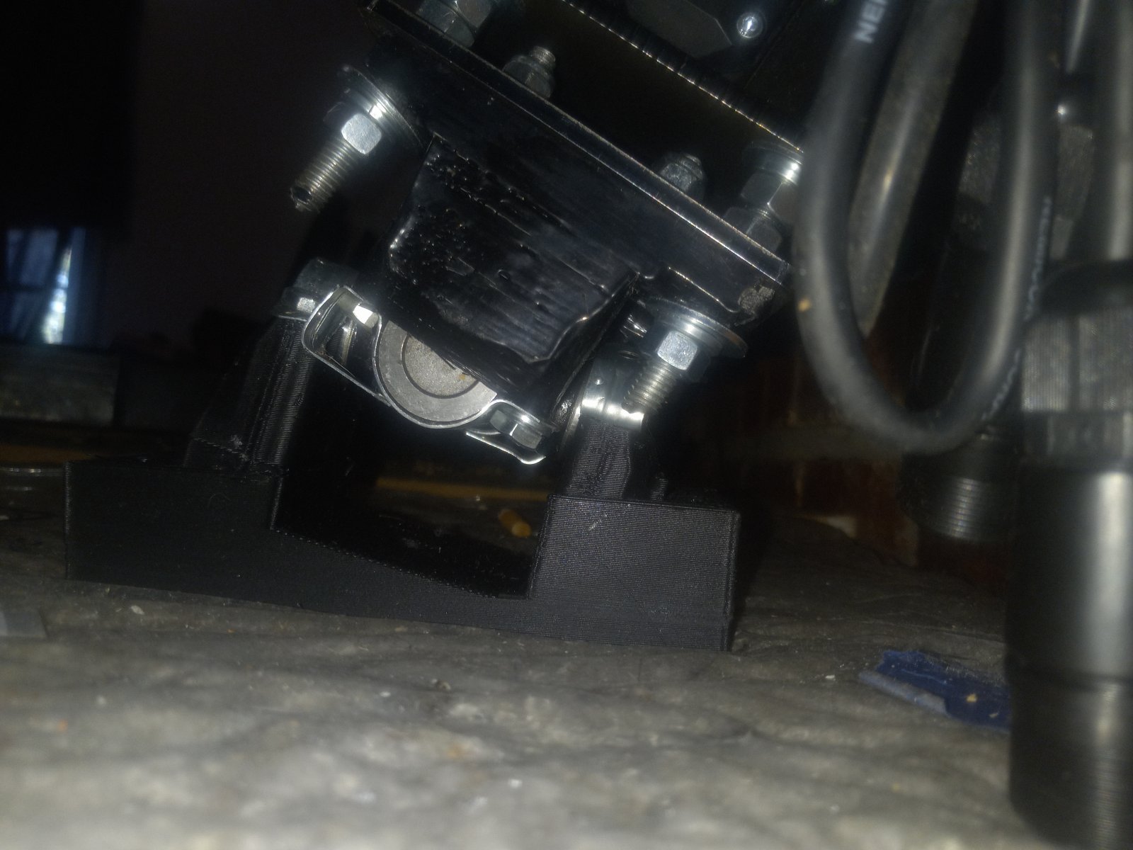

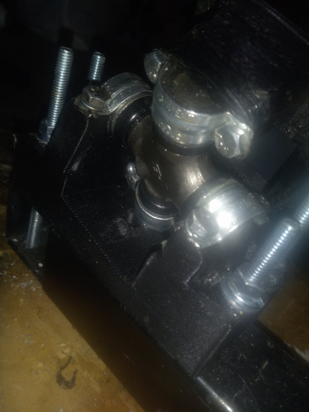

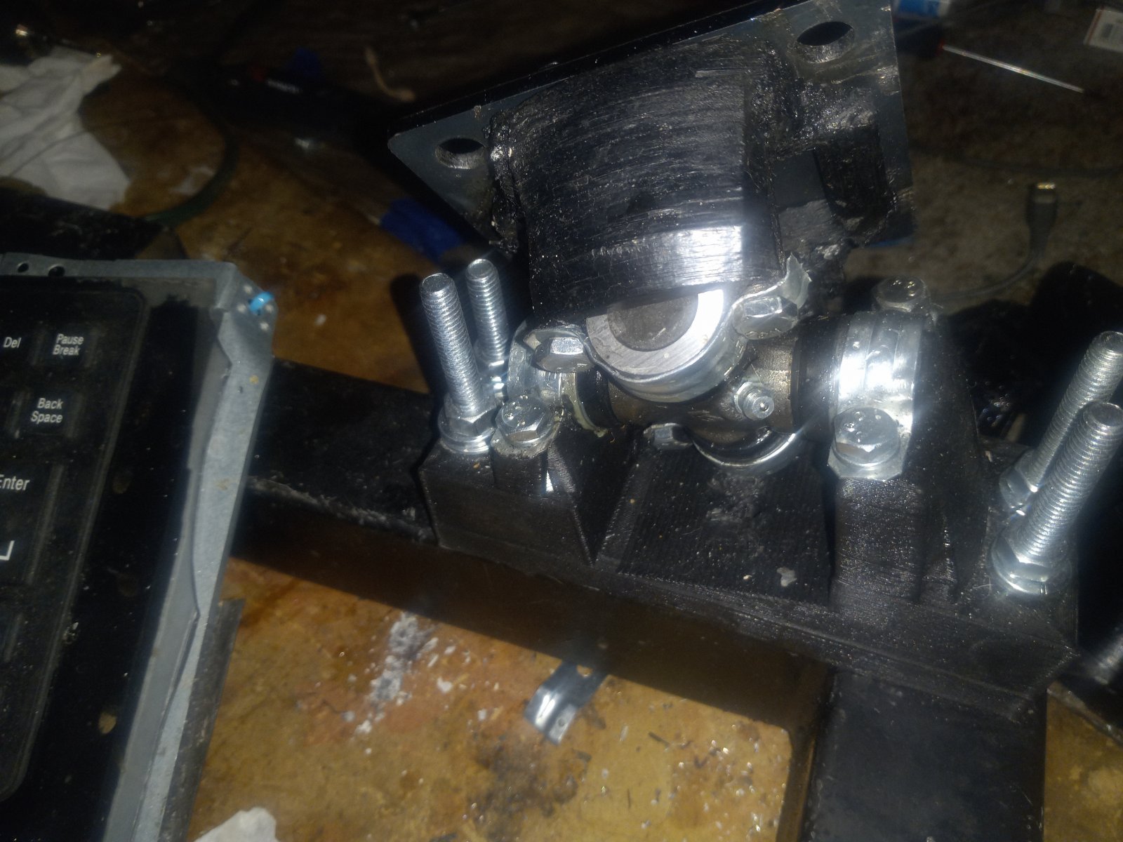

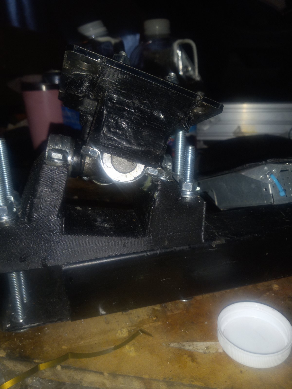

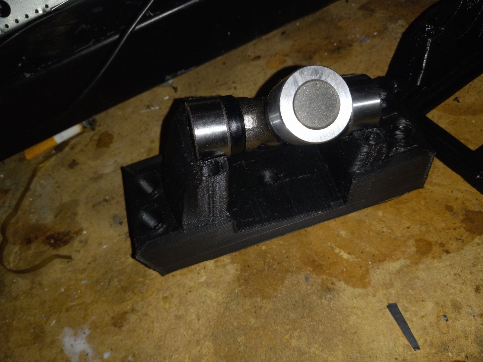

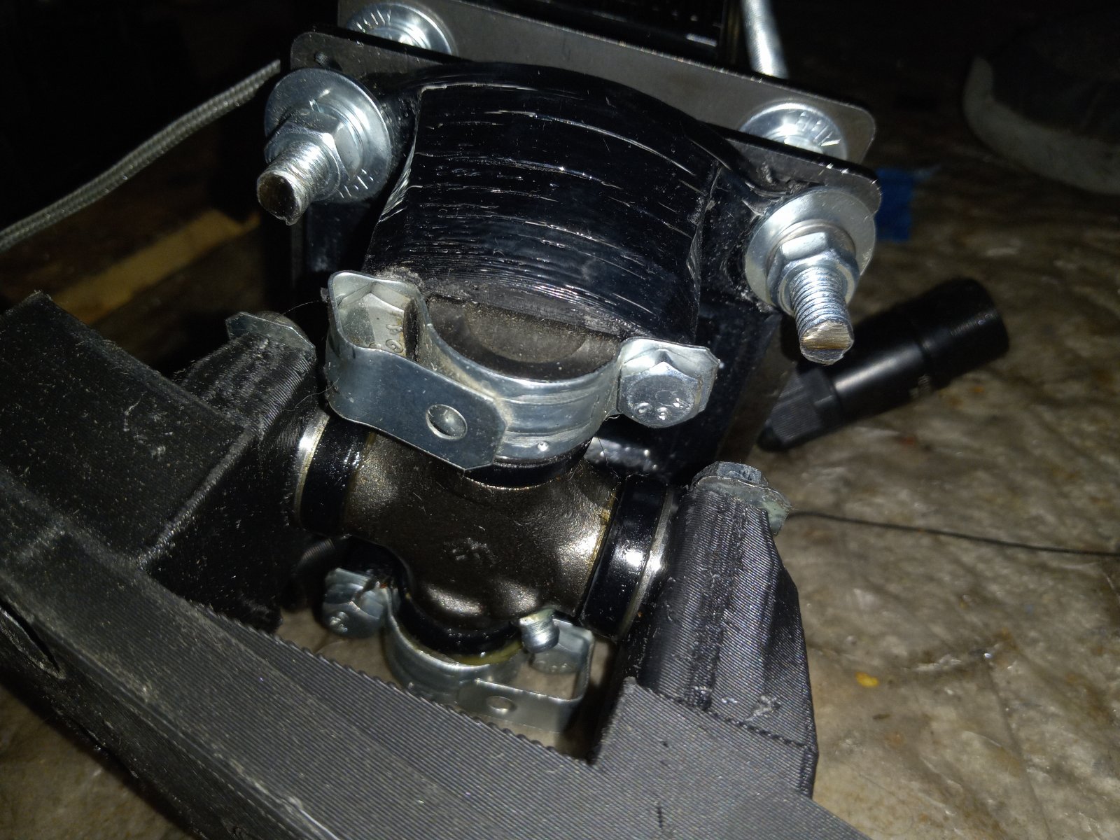

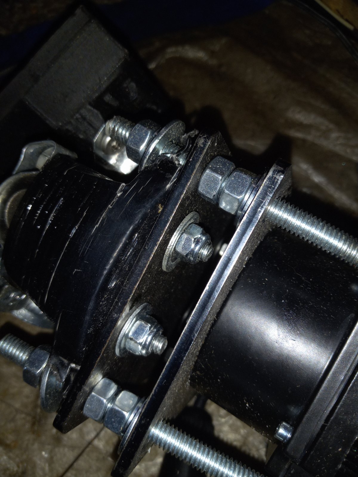

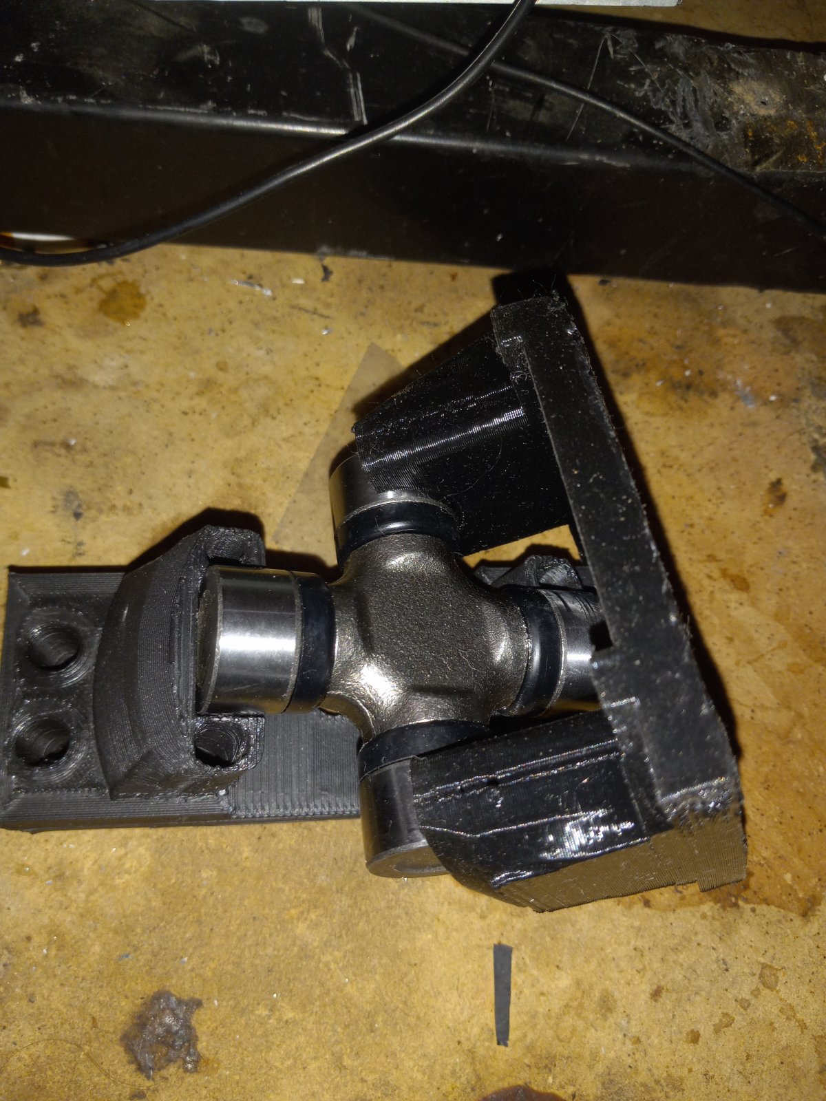

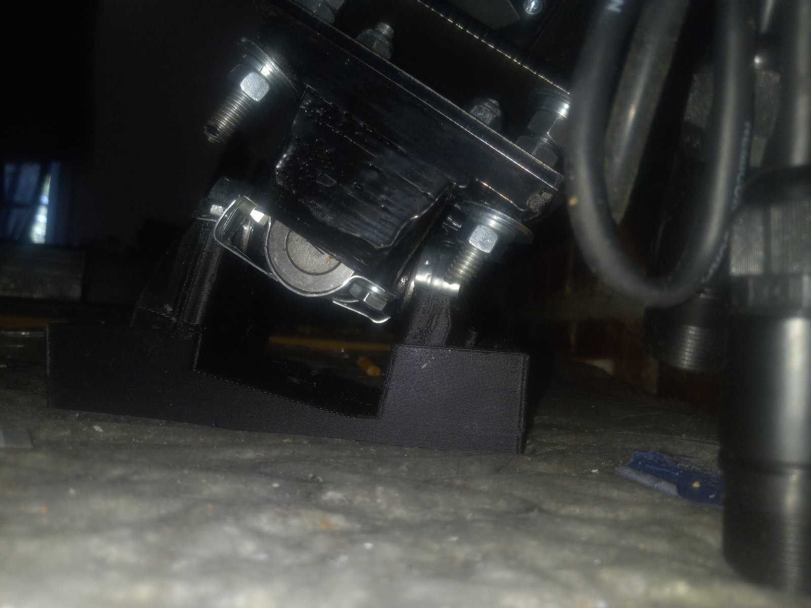

    I designed them in Tinkercad and 3d printed in carbon fiber pla with my ender 3. Some of the top peices are in PETG cuz I ran out of cf-pla and petg is half the price lol 16911576793168106422815298818844.jpg 16911577122656933142651600474923.jpg

  8. Psionic001
    Psionic001 Active Member Gold Contributor
    Mar 5, 2017
    138
    Sydney
    997Coins
    +59 / 1 / -0
    Motion platform, 6DOF
    I can’t comment on the design as the photos are so dark and blurry.
    Are you confident 3D printing will take the loads required?

    I think so I made them out of carbon fiber and petg I believe a carbon fiber PLA and the top sections of the mounts are out of petg because I ran on a carbon fiber so yes I think so they are extremely strong the petg I'm a little worried about but the carbon fiber absolutely not I'm sure that's going to hold. And I won't lie I'm a little concerned I am that's why the the top piece of the mounts are they go through they go around the the cross bearing through the mount and into a steel plate that mounts to another steel plate that's connected to the actuator so the bottoms are made out of carbon fiber which they can be they can go around this the cross bearing through the mount and then into the metal of my base when bolted so it can be made very strong I believe I'm hoping they're going to hold

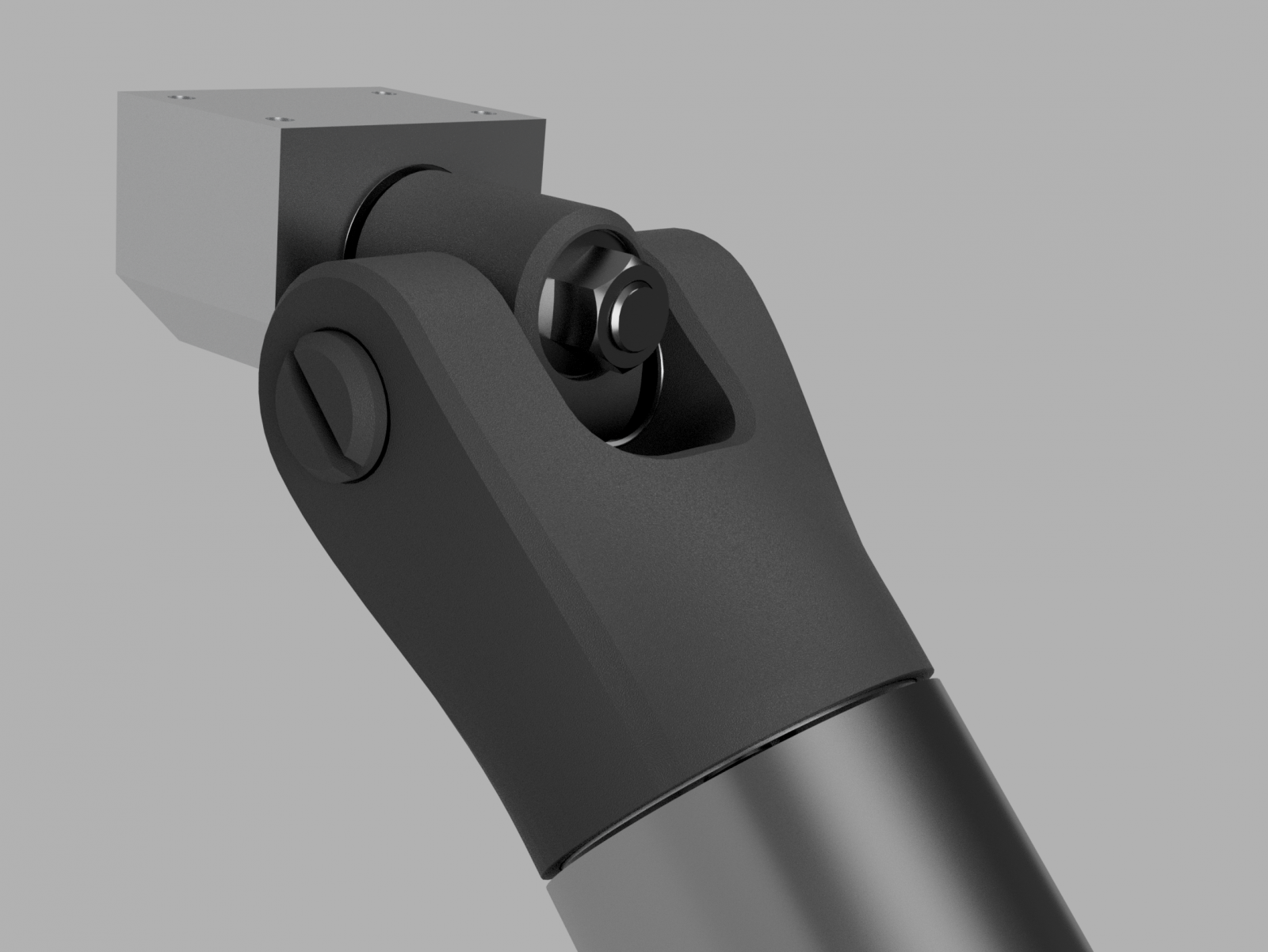

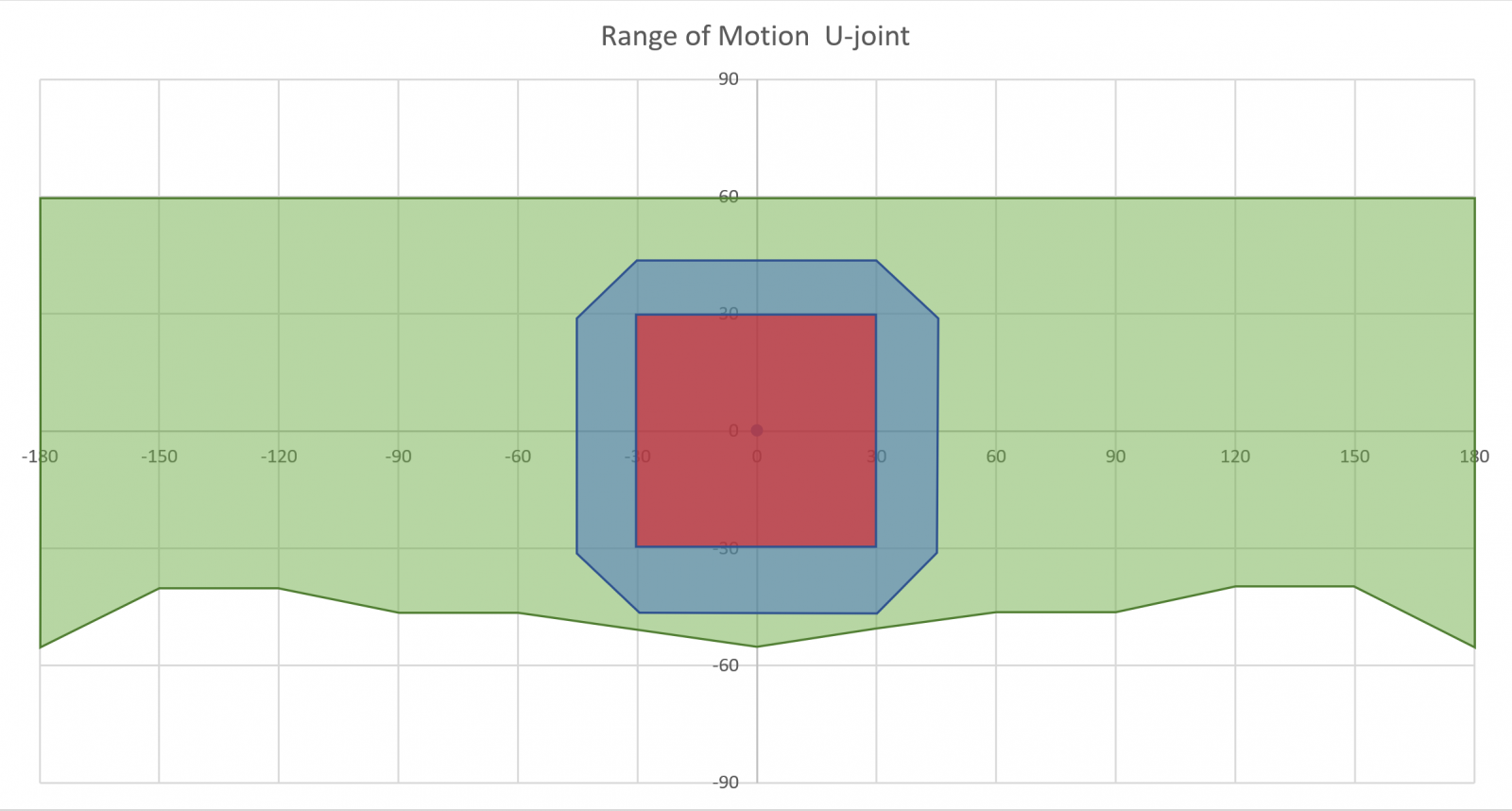

  15. Dirty
    Oct 15, 2017
    746
    All the way up front.
    7,981Coins
    +890 / 3 / -0

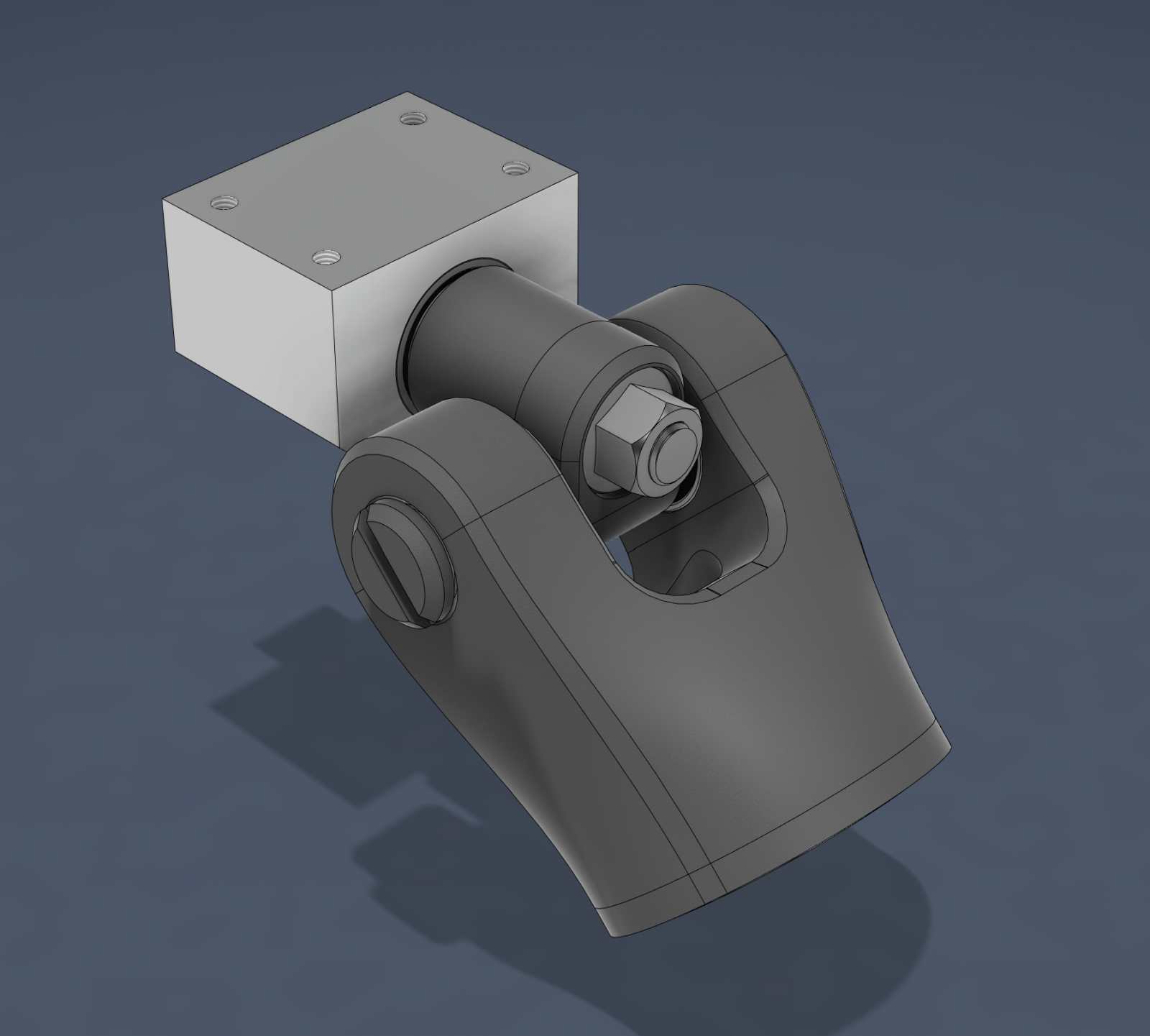

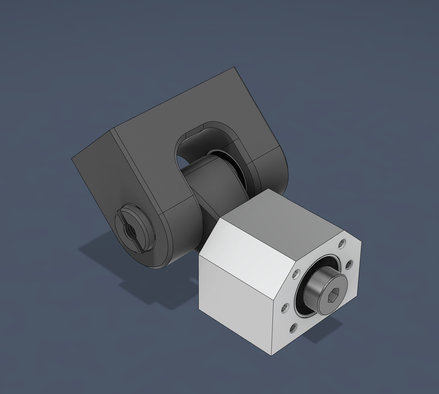

    Sure!

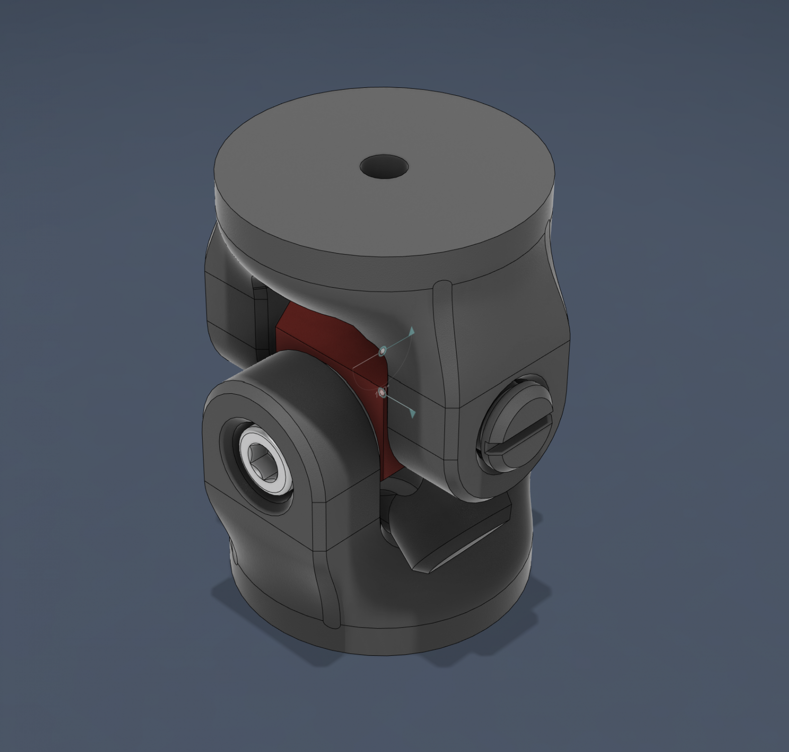

    Fusion360 project here: https://a360.co/3yPN6ZU
    All parts print without supports. PETG @285°C
    ...or did you mean those?:
    Lower: https://a360.co/3zUtapW
    Upper: https://a360.co/3DWZ1Zu
    Let me know, if you need STLs. And be sure to use actual shoulderbolts, not just ordinary hex screws.
    I will be travelling (Vancouver and Portland) for the rest of August, so I might take a few days to answer.
    Cheers... Dirty :)

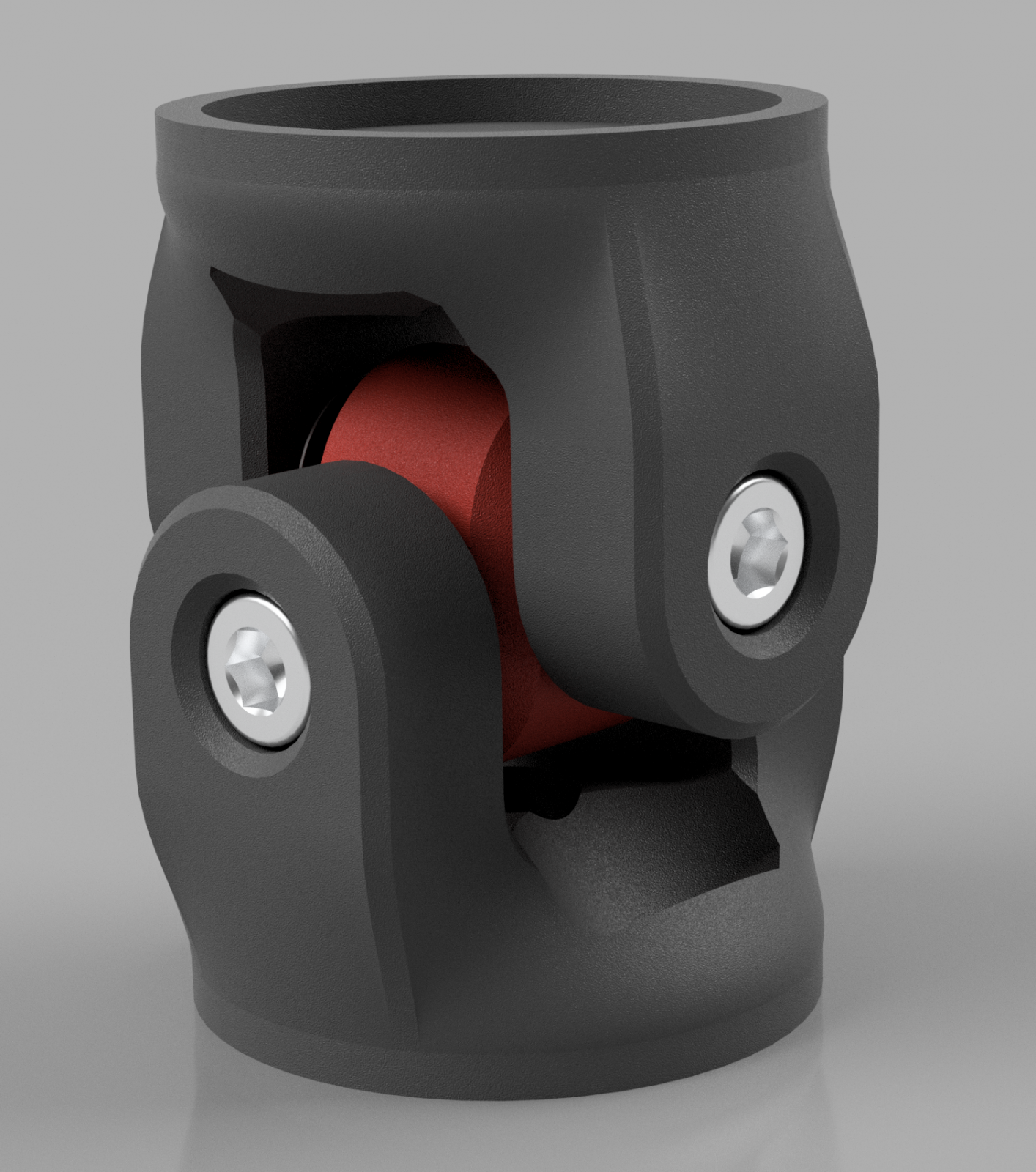

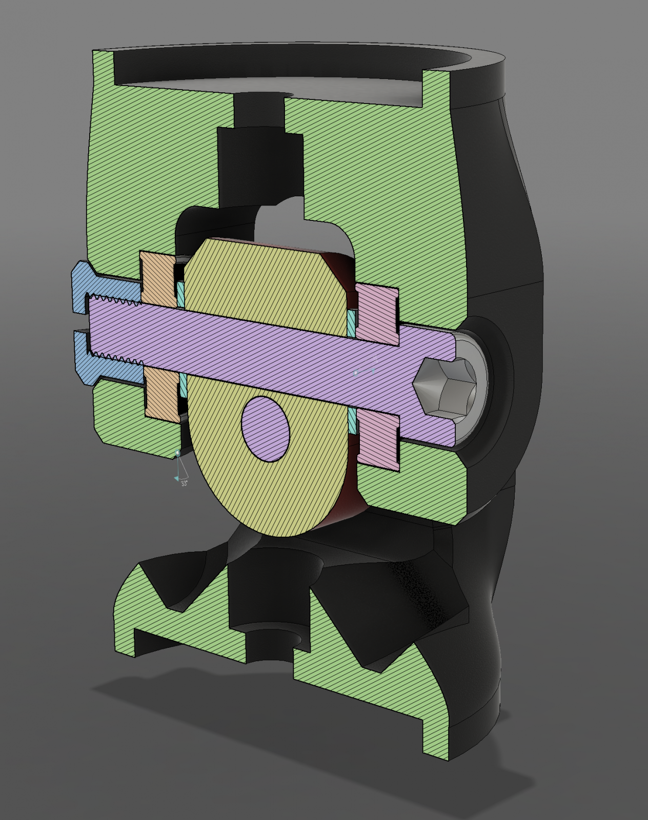

  17. Dirty
    Oct 15, 2017
    746
    7,981Coins
    +890 / 3 / -0

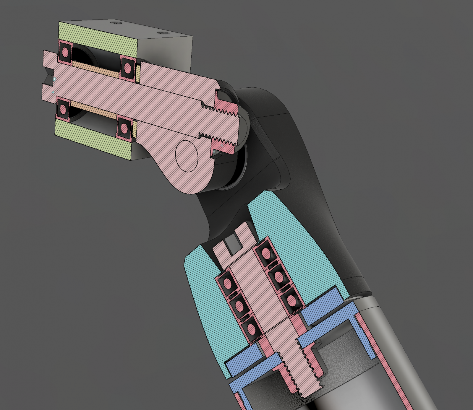

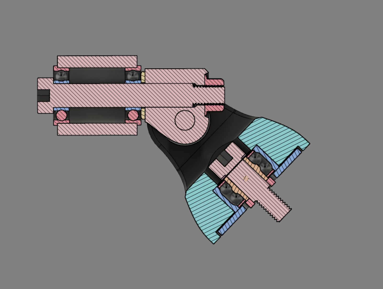

    Here are the STLs, but you should definitely get Fusion360 (it's free) to understand and adapt the design. 3D printing allows for a highly integrated design, meaning you can pack a bunch of functions into the same part. On the other hand you will then get a part that is specific to your needs only.
    In this case here, you should adapt the design to match the diameter of your rods, the method of mounting them to the rods, the dimensions of the bearings you want to use, the dimension of the thread (metric or imperial?). And also, if your actuators are not internally constrained, you can omit the axial bearing on the single-sided design alltogether.
    Mechanical design is a solution to a problem. Make sure that the solution matches the problem! Or even better: Tailor the solution to your problem for best results :thumbs
    Cheers,... Dirty :)

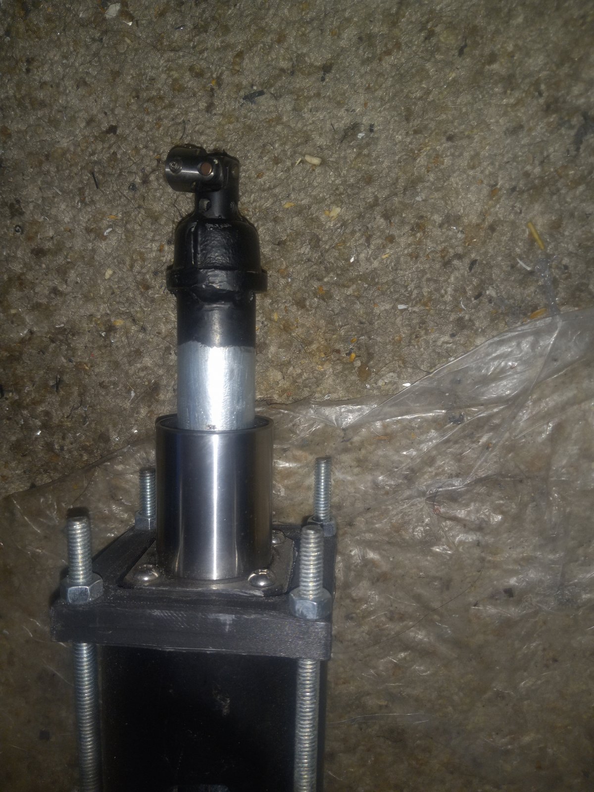

    Heres some pics of the ones a made 20230818_201013.jpg 16927036405801240734944764619377.jpg 16927036957656685439441581007529.jpg
