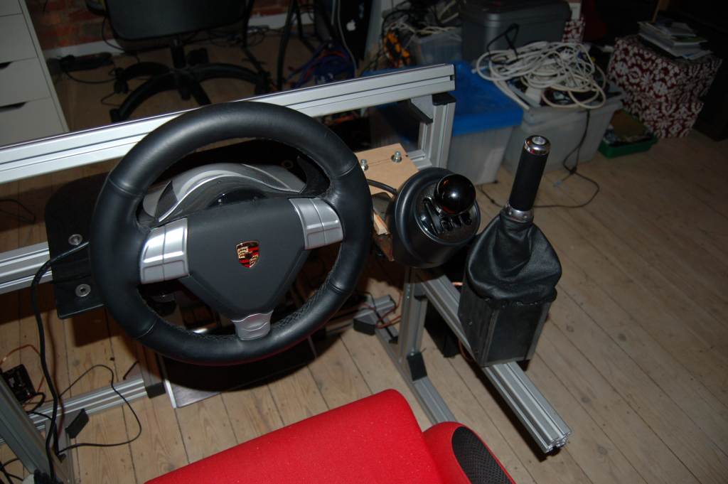

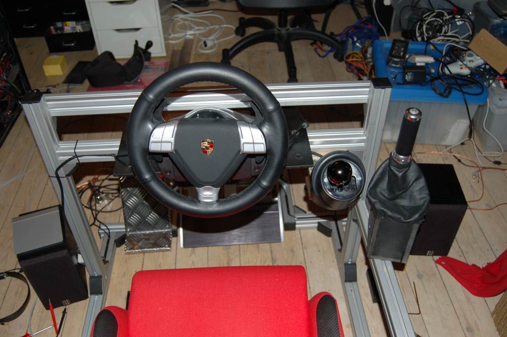

    A few pics taken tonight :
    The 911 Turbo S wheel, the RS Shifter 2006 with custom black chrome gear knob and DIY handbrake : DSC_59171.jpg

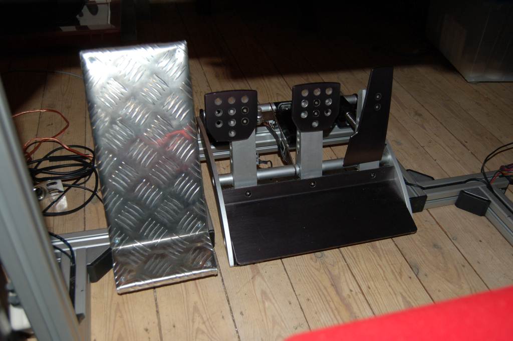

    DIY foot rest plate (aluminium+MDF) : DSC_59215.jpg

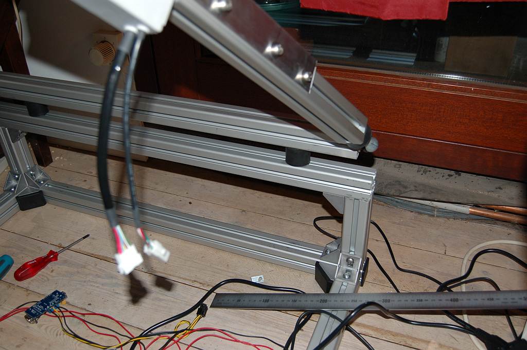

    The infamous SCN5 in their aluminium arms : DSC_59226.jpg

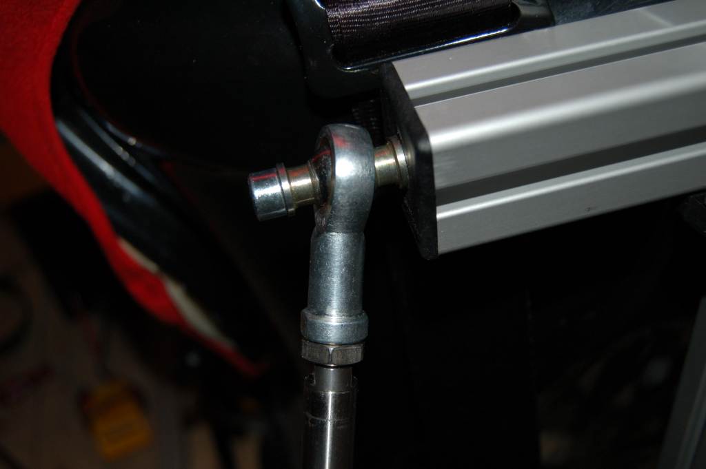

    M10 fine thread (1.25) RH Rose Joint for the SCN5 threads and high misalignment spacers for maximum angle : DSC_59237.jpg
    Left arm up close : DSC_59269.jpg

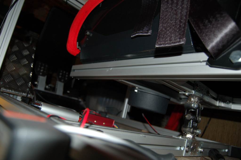

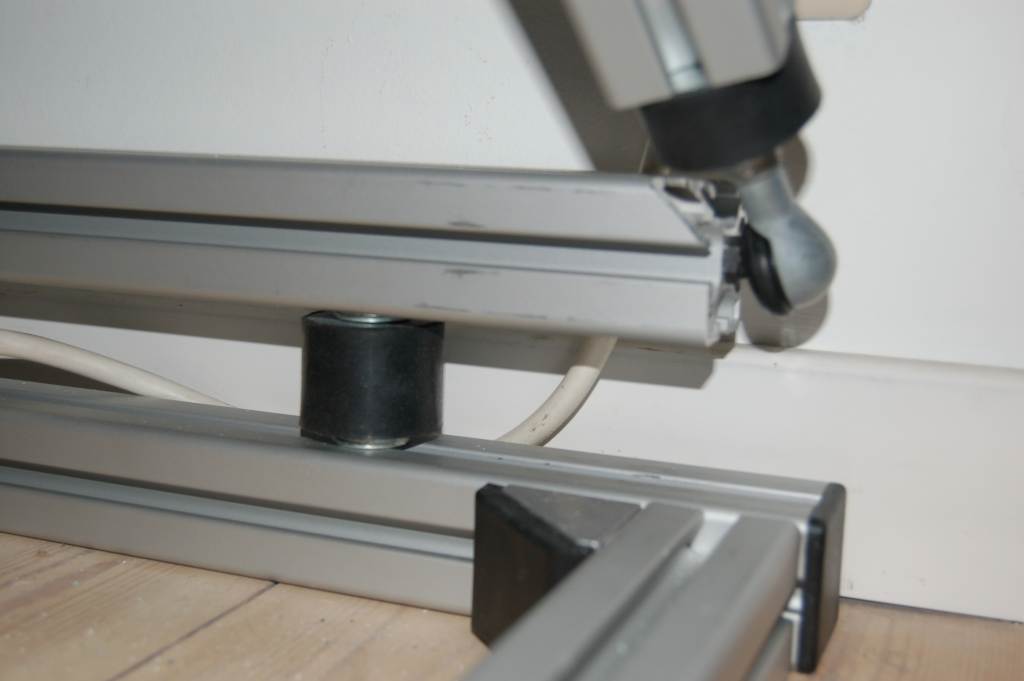

    I had to cut into the dampening bar to allow maximum range for the lower joints : DSC_593517.jpg
    I added a bar behind the wheel to attach my gauges : DSC_594022.jpg
    The bass shaker not very far from the pivot : DSC_593013.jpg

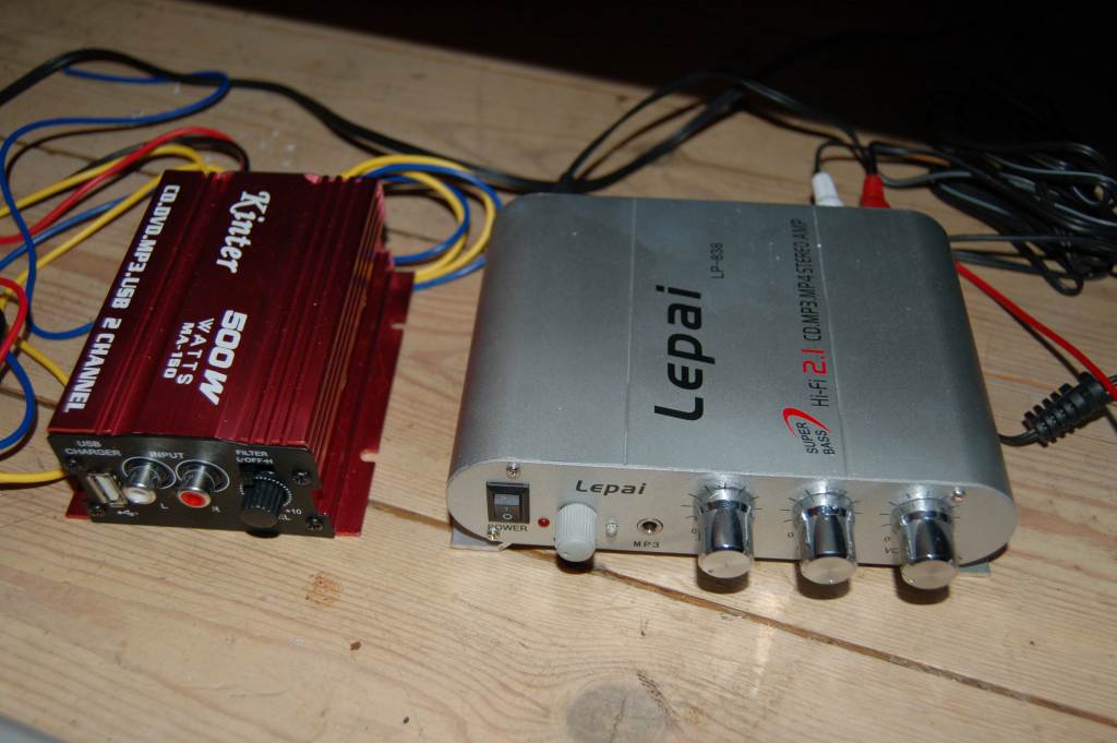

    And the cheap amps I found on ebay for my bass shaking experiments (10€ each incl. shipping :p) : DSC_593618.jpg

    I also did a video of the arms lower joint in action to show the dampening, but it's not very well shot so bear with me.
    http://www.youtube.com/watch?v=16TfHc4GKiA
    The dampening seems very soft/chewy to me, what do you think ?

    It should not be possible to bottom out your actuators (assuming a driver that is 250lbs or less) with any combination of actuator speed and acceleration if you have the proper pivot point location and actuator angles.
    I would suggest experimenting with your actuator angles and pivot point rather than detuning your motion profiles.
    You dampening bar looks fine to me. Keep an eye on the rubber to check for stress cracks. I tested many different dampeners. Most of them didn't hold up and eventually broke.

    That's a relief. I'm using german made silent blocks, 40mm diameter and 30mm tall. They don't seem prompt for stress cracks but I'll keep an eye on them nonetheless, thanks for the tips.

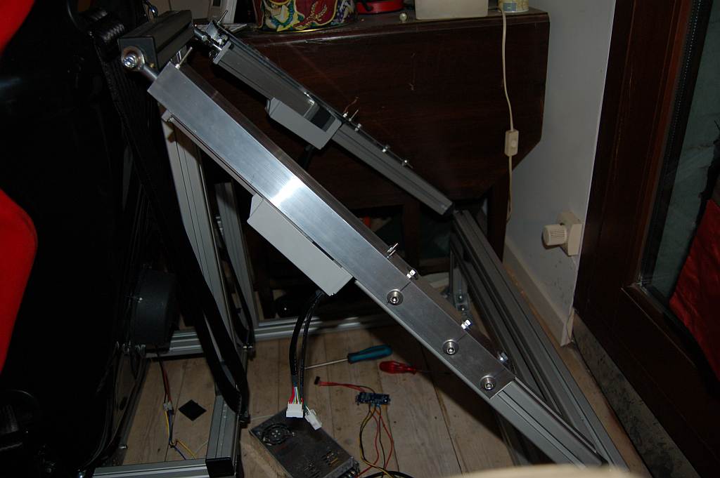

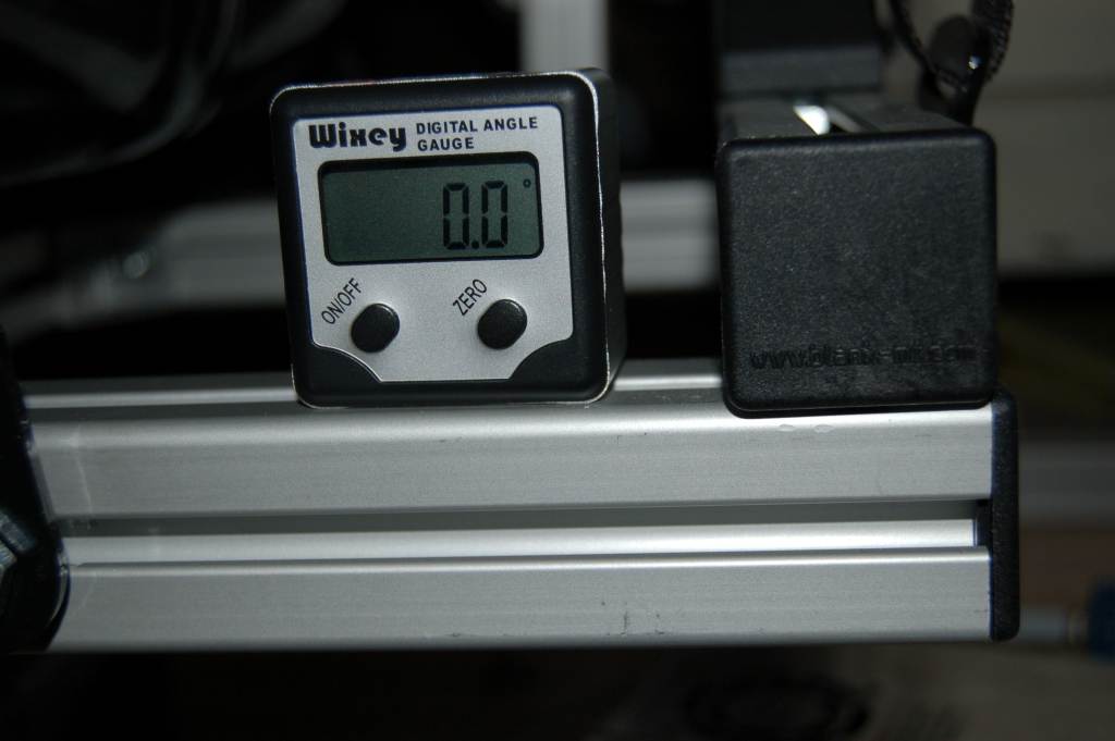

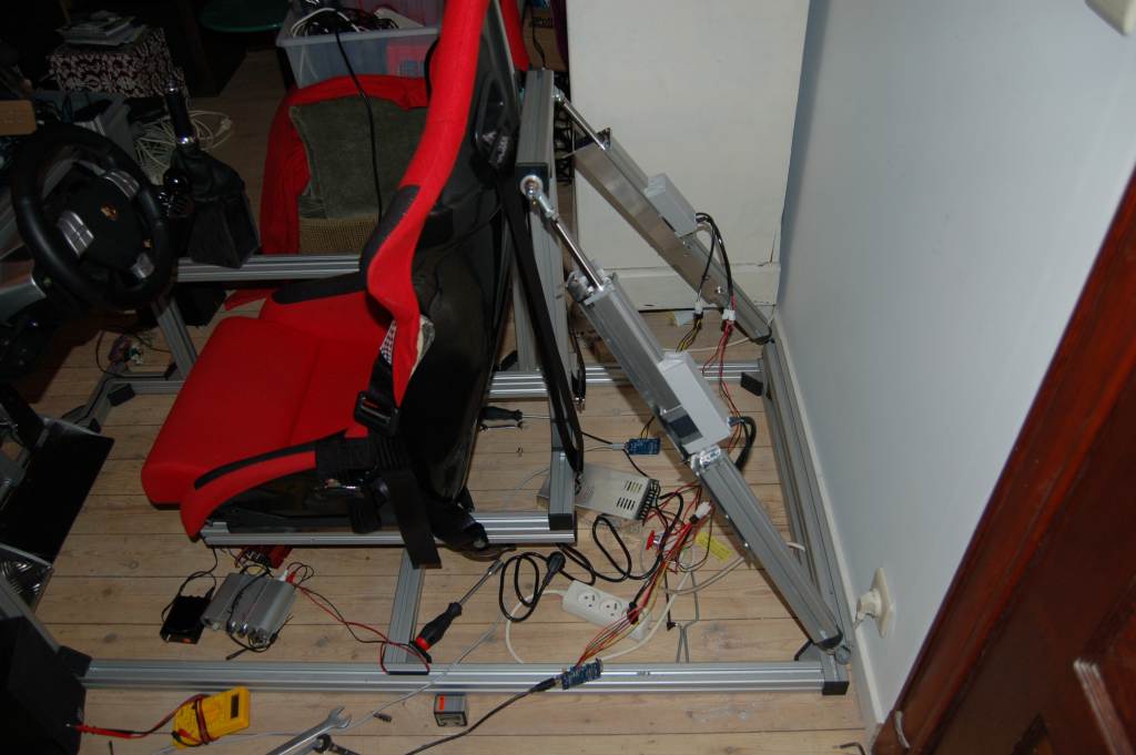

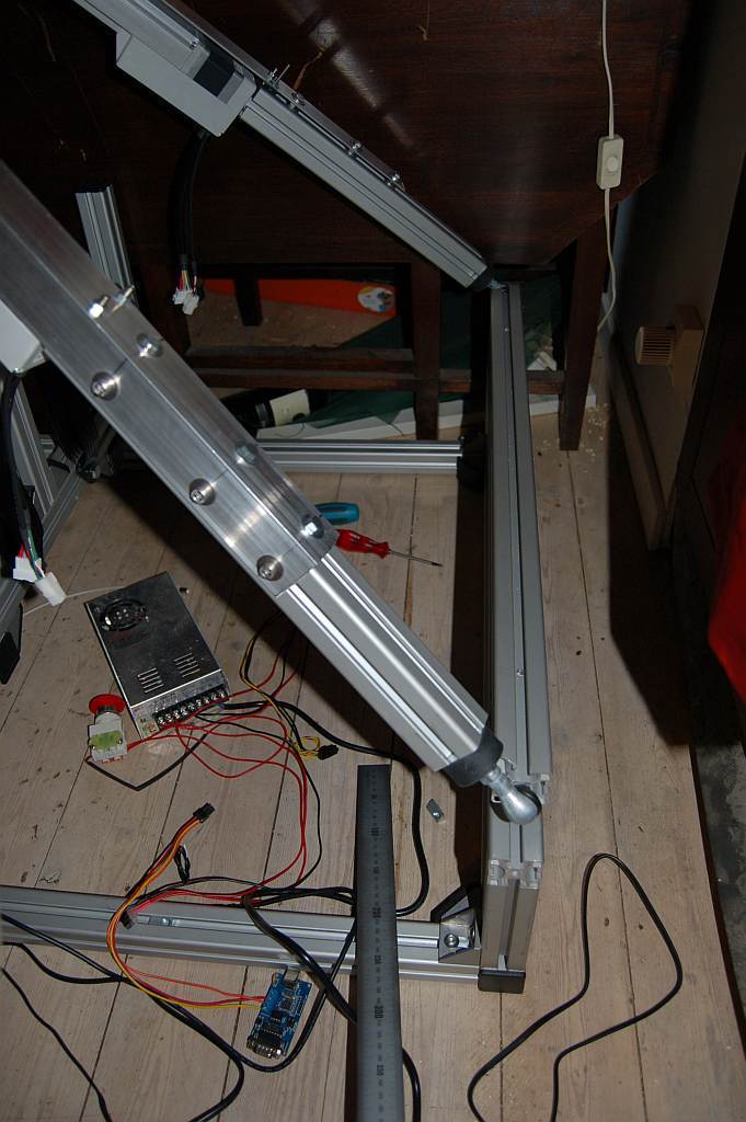

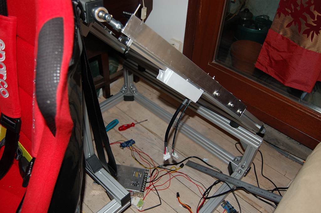

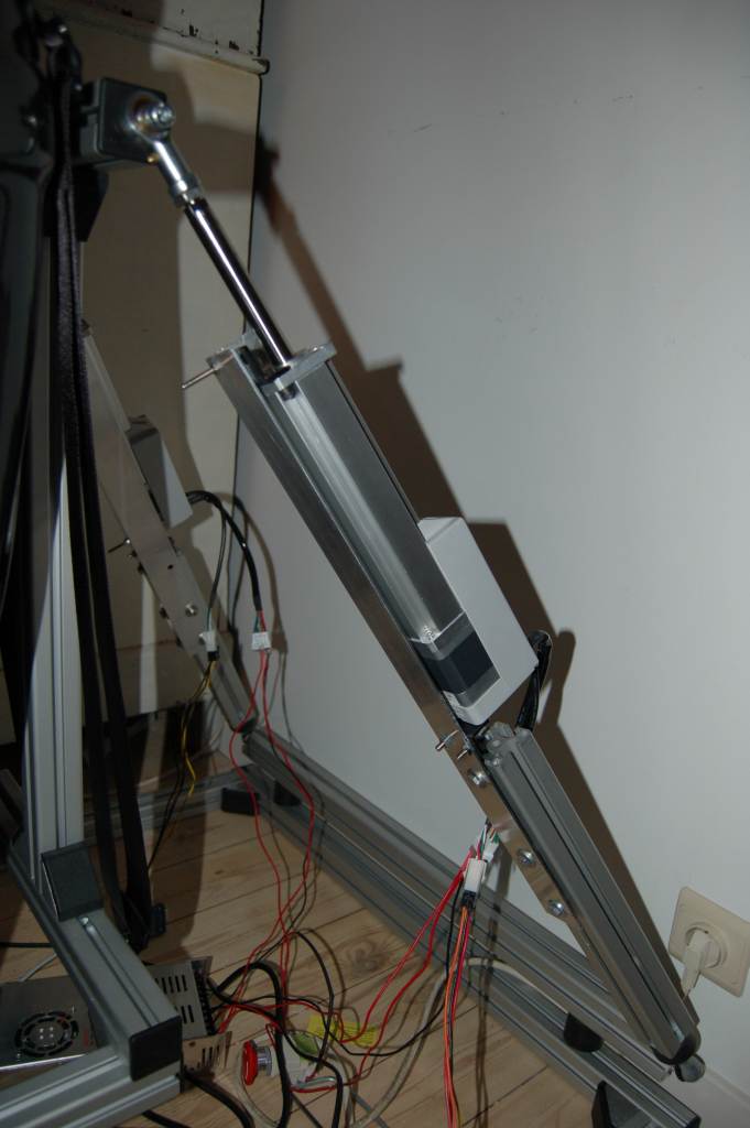

    Ok so complete change of plans.
    I think I understood the goal of the structure in terms of angles. Everything must be done to use maximum leverage. There are 2 axis : the first is the lever, from the pivot to the top ball joints of the actuators, the second is the actuator arm itself. From what I understood while brainstorming with a friend (architect), we must have the center of gravity of the driver as close as possible to the pivot or at least as close as possible to the lever axis, and the angle between the above mentioned 2 axis must be as close as possible to 90 degrees when the seat is in horizontal position (SCN5 at mid-travel).
    I had the revelation when showing the beautiful work of Ralph (from Porsche Specialist in NL) to my friend to get ideas... I simply have to heighten the dampening bar and in consequence shorten the actuator arms ! Easy as f*** with the aluminium profiles, I had some spare with the exact dimensions needed. I'll have to wait for tomorrow before shortening the arms though, it's 3AM here and I don't think my neighbours would be very happy with the sound of the Festool saw cutting through aluminium ;)
    Here are a few pictures of the WIP :

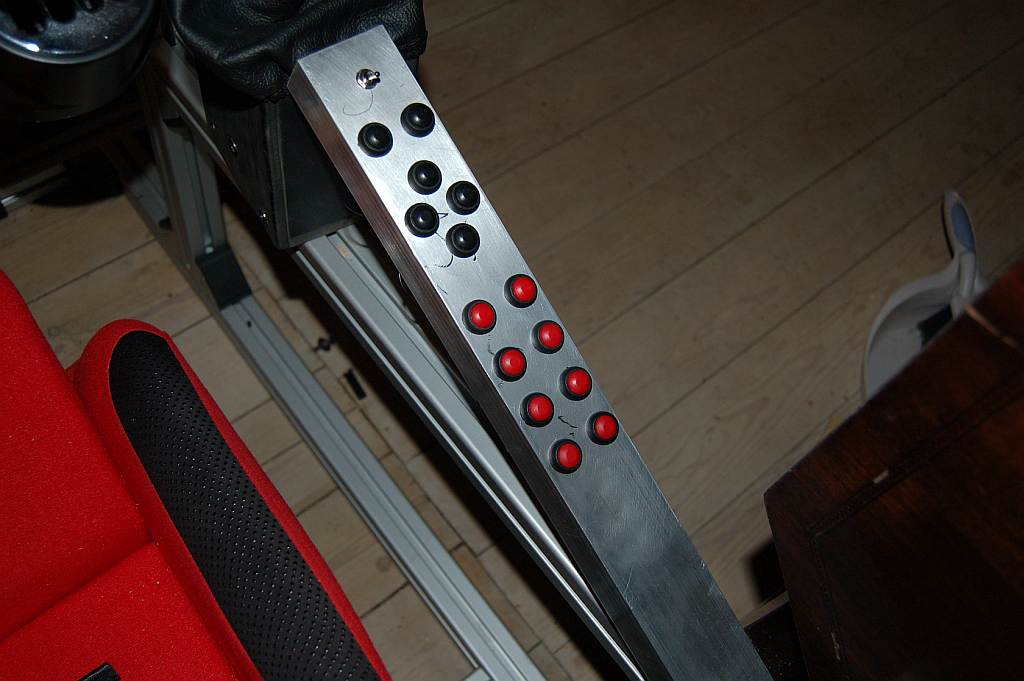

    I almost forgot : the buttons ordered from China arrived yesterday, so I dremeled an alu U profile I had at hand initially intended as SCN5 support and screwed the buttons on it. They will be connected to the miniPAC (http://www.ultimarc.com/minipac.html) along with the handbrake. At the top, you'll notice a switch, it will be configured as a Shift key in order to double the number of functions available on the panel. The 2 top buttons will be Esc and Enter, then a cursor <v^> followed by 8 buttons, in total 28 assignable keys. So I won't need a keyboard anymore. I thought of integrating a trackball to complete the computer interface but I'm out of cash for the moment so it's left for later. Here it is :
    As always feel free to comment :)
    Cheers,
    Silly(c)One.
  17. Silly(c)One
    Silly(c)One New Member
    Oct 11, 2010
    68
    ex-Web & Industrial Dev/Sysadmin
    Brussels, Belgium
    327Coins

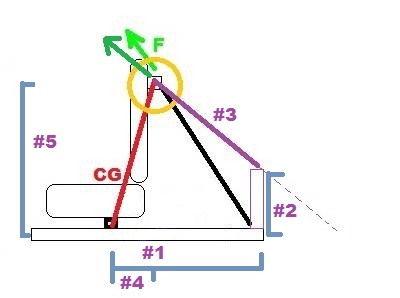

    A quick drawing on known bases to illustrate my line of thought :
    The red line is the lever. The purple one is the actuator. The most important angle is inside the orange circle.
    The most important variables that we can act on are :
    - #1 : distance between pivot and actuators lower attachments ;
    - #2 : height of actuators lower attachments ;
    - #3 : length of the actuator arms ;
    - #4 : distance between pivot and the T behind the seat ;
    - #5 : height of actuators higher attachments behind the seat.
    Ideally :
    - #1 should be as short as possible to reduce the sim length behind the seat and allow the shortest possible #3 ;
    - #2 is relative to #5 in order to obtain an angle of 90 degrees between #3 and the lever ;
    - #3 is the length of the actuators + dampening + a short arm allowing adjustments in length + 2 ball joints ;
    - #4 is relative to the seat dimensions, angle of the back rest and the driver's CG ;
    - #5 should be as high as possible so the lever is longer, but not too long in order not to reduce the travel too much.
    All those observations are only applicable to a normal horizontal driving position. I believe a few observations should be adapted for a laid back Playseat F1 style position and this is not the direction of my study.
    If the pivot is positioned in such a way that the driver is stable with the seat in horizontal position without the actuator connected, that means that the SCN5 will have a load of 0kgf at mid-course (75mm in our case) and the maximum loads at the extremes will be balanced and still quite light.
    Think of when you balance yourself on a chair (I have ADHD so plenty of practice at the back of the classroom ;)) : when you're at your point of balance, that's when a feather like push in one direction or another is the most effective.
    It's also when the actuator makes an angle of 90 degrees with the lever that it has the most torque... Hence the idea of mounting the arms higher so they can be shorter while still having a great angle and thus the length needed behind the seat can be limited further.
    I don't know why it wasn't clearer to me at first, when you know what my principal means of transportation is :
    Those are my pride and joy : Kris Holm KH36 and KH26 munis (muni = mountain unicycle)
    But I disgress... back on topic : am I completely out of my mind or does it make sense to you ?

  18. bvillersjr
    bvillersjr Active Member
    Oct 11, 2008
    1,174
    Ohio, USA
    438Coins
    +23 / 1 / -0
    Your thinking is correct. I did the same thing on my very first sim. Unfortunately, in that case, the design was suffing from being extremely narrow. Raising the bar on the rear helped, but the design wasn't sufficiently wide enough. To answer your earlier question, yes, as little as an inch off in any direction can negatively impact performance. Somewhere I posted an example of this on a wooden testing platform a year or so ago.
    I think in your case, the rear bar change may prove to be helpul.

    So I just traced a line in Sketchup from the pivot to the SCN5 top joint, and moved the pivot relative to the seat until my CG crosses that line. I haven't changed anything yet, but on paper, that should put the pivot approx. 14 away from the back of the seat base, which is approximately your dimension. I'm currently 5cm (2) away from that position, hence the extra effort given by the SCN5s...
    Also in the process of heightening the dampening bar, I noticed the top angle between the SCN5s and the seat base was much bigger... The rose joints were at their angle limit and were putting strain on the SCN5 arms, so I had to enlarge the top of the seat base T. It's now 36cm instead of 27cm long, and the angle is back to the normal range of the rose joints.
