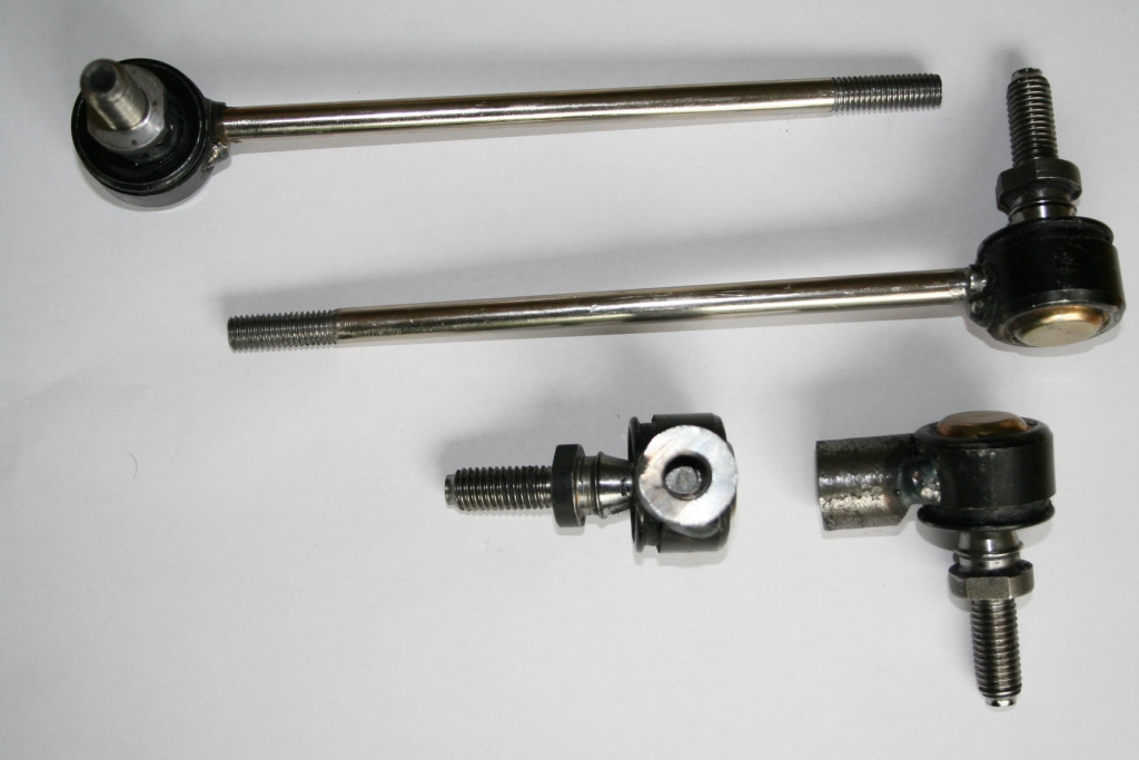

    By any chance, do anybody know where to find ball joints with an M10 1.25 female thread for the top of the SCN5 ? I only could find rose joints with this thread size, and the misalignment angle of the rose joint is far smaller than the ball joint's...
  2. pitstopp
    pitstopp Active Member
    Feb 12, 2009
    116
    Dortmund
    634Coins
    +55 / 0 / -0
    3DOF, SCN5, SimforceGT
    Hi
    i had the same problem.
    The only manufacturer I could find is this one
    JJ Bearing in China!
    So I found a DIY solution
    Made out of a pair of coupling bars from an VW for 12€ both
    and a screw tap for 10€. Never had any need for m10x1,25.
    There are more Pics in my Gallery!
    Works great, no backlash, smooth and enough angle alignment.
    But be careful when welding, immediate cooling is recommendet!
    regards
    kai

    Thanks guys... Eventually, with the correct angles, the rose joints are working fine.

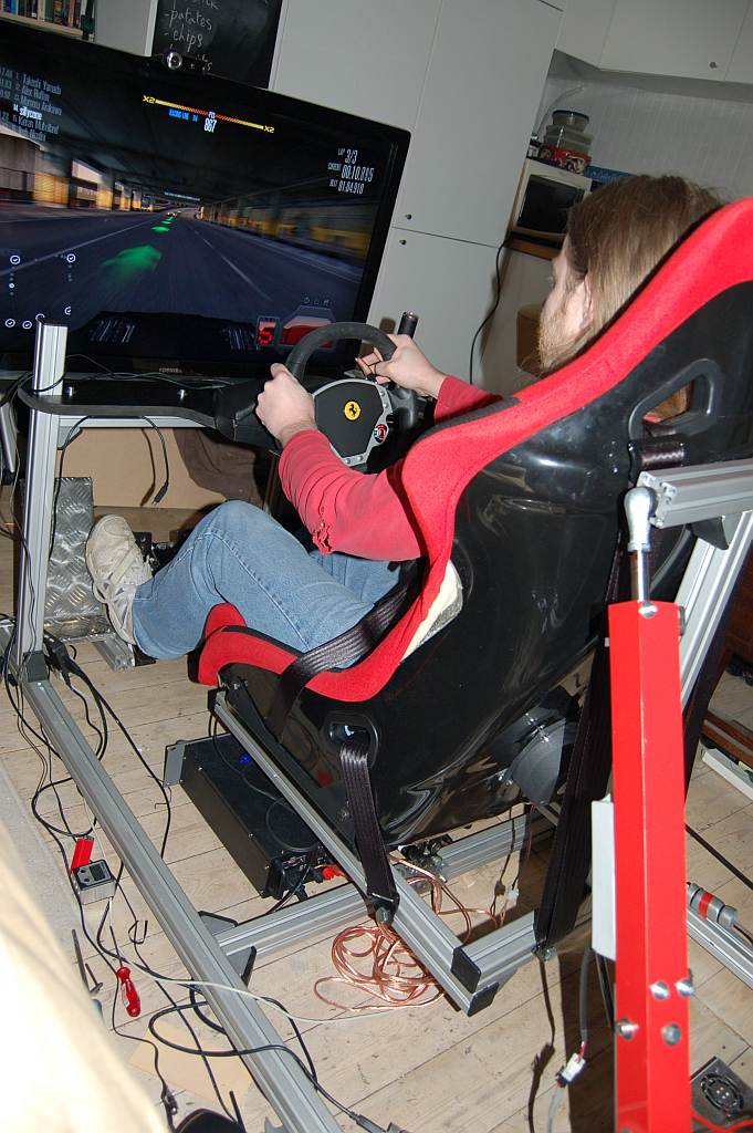

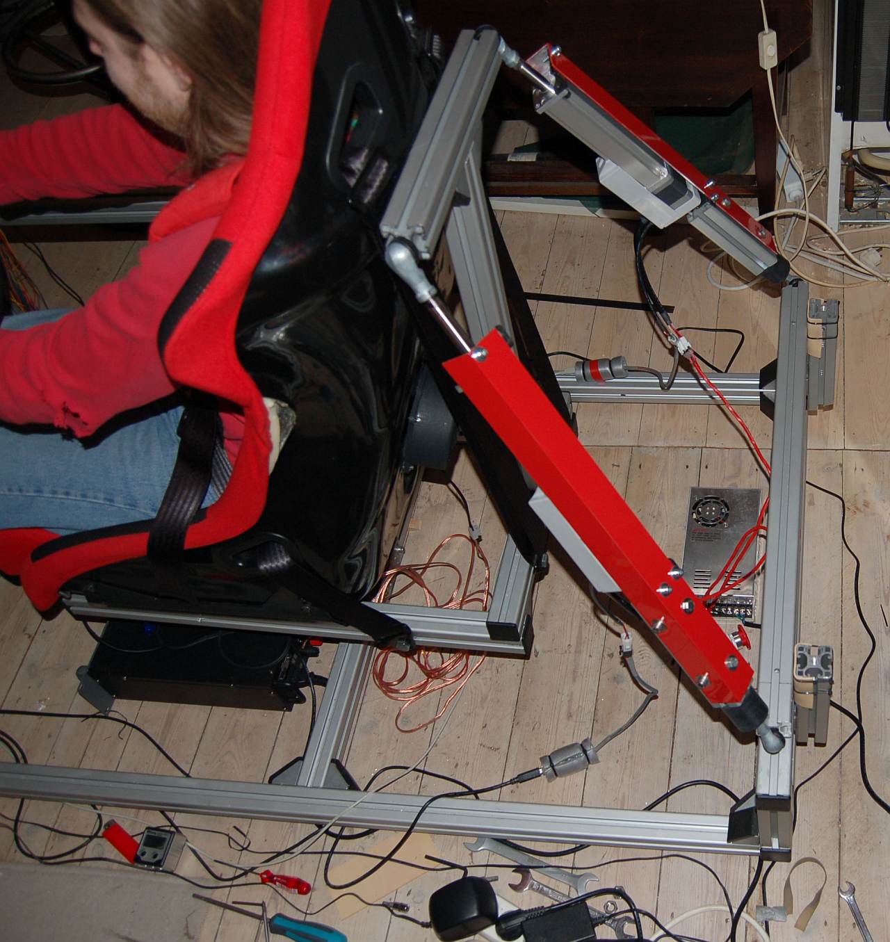

    Here are 2 pics of the actual configuration of my sim :
    - I painted the arm covers in red,
    - changed the rose joints to ball joints on the SCN5s end,
    - added 2 pieces of alu profile behind the dampening bar to prevent it from moving too much,
    - tidied up and gained both SCN5 power and RS485 cables,
    - switched the RS485 adapters to smaller ones that only do USB<>RS485 (no RS232 : the less components, the less possible interferences, like in HiFi audio),
    - covered the RS485 adapters with foam for protection,
    - made a new wheel support in 18mm MDF with a cut out on the left for easier entry in the sim,
    - integrated the arcade keyboard PCB and my DIY handbrake in the wheel support,
    - installed the base on 6 silent blocks for the vibration (but will remove them as it moves too much, to be replaced by a 175x80cm MDF board to add weight and structural stability to the base)
    - and last but not least, adjusted the geometry again.
    The most important dimension to get right is definitely the position of the pivot relative to the seat.
    I tried with the pivot more to the front of the seat, and that was a real torture for the actuators, and now with the pivot much more to the back of the seat, I can feel in my back that they have to support much less load and they now balance me from left to right and front to back effortlessly (and thus also much faster !)
    They are also much noisier due to the speed, but that's a good thing for my peace of mind :)
    Now I have to finely tune the Profiles to get the clues I want and the less arcady feeling possible.
    I tried the sim with NFS Shift (unmodded, all aids off) and hated the horrible physics and unrealistic car specs : the motion is fun but not much of a driving tool... But maybe the problem is in the wheel itself (Thrustmaster F430). I own the game a chance with a Fanatec wheel and modded physics (and a real car, because a Lambo with 1000 BHP, come on !)
    To be continued.
    Feel free to comment as usual :)

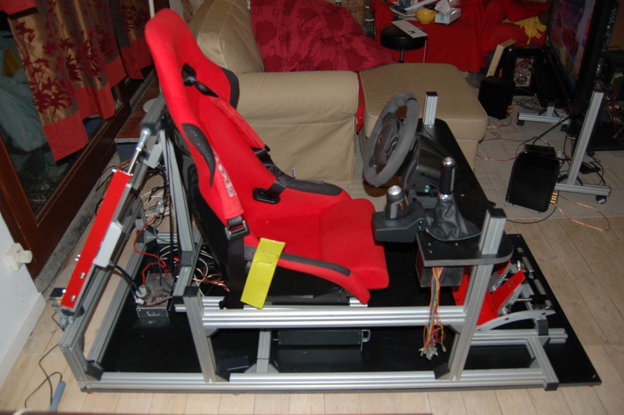

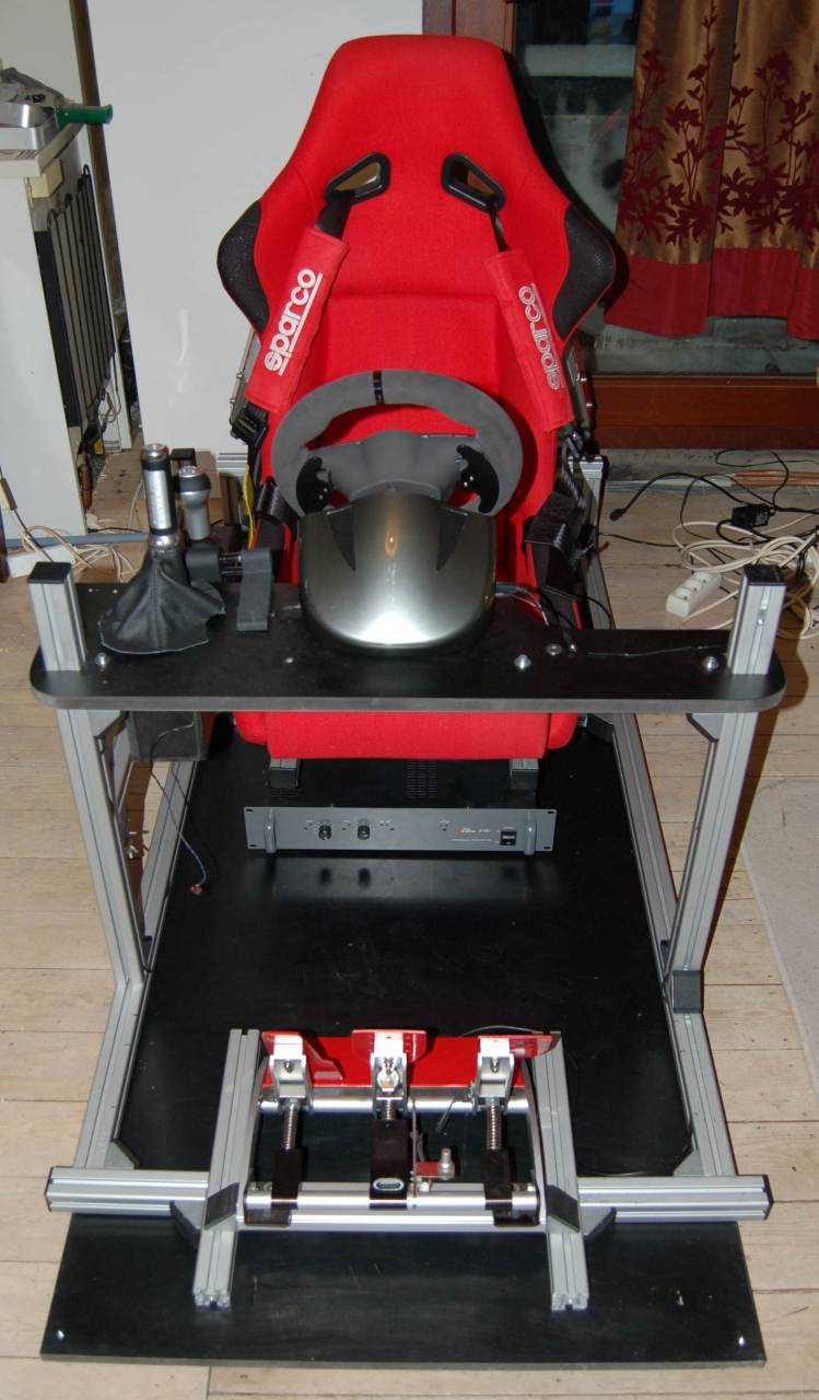

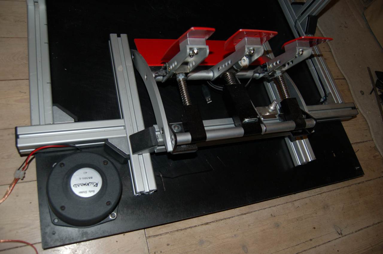

    A little pics update...
    With the MDF board painted and fitted :
    Side view :

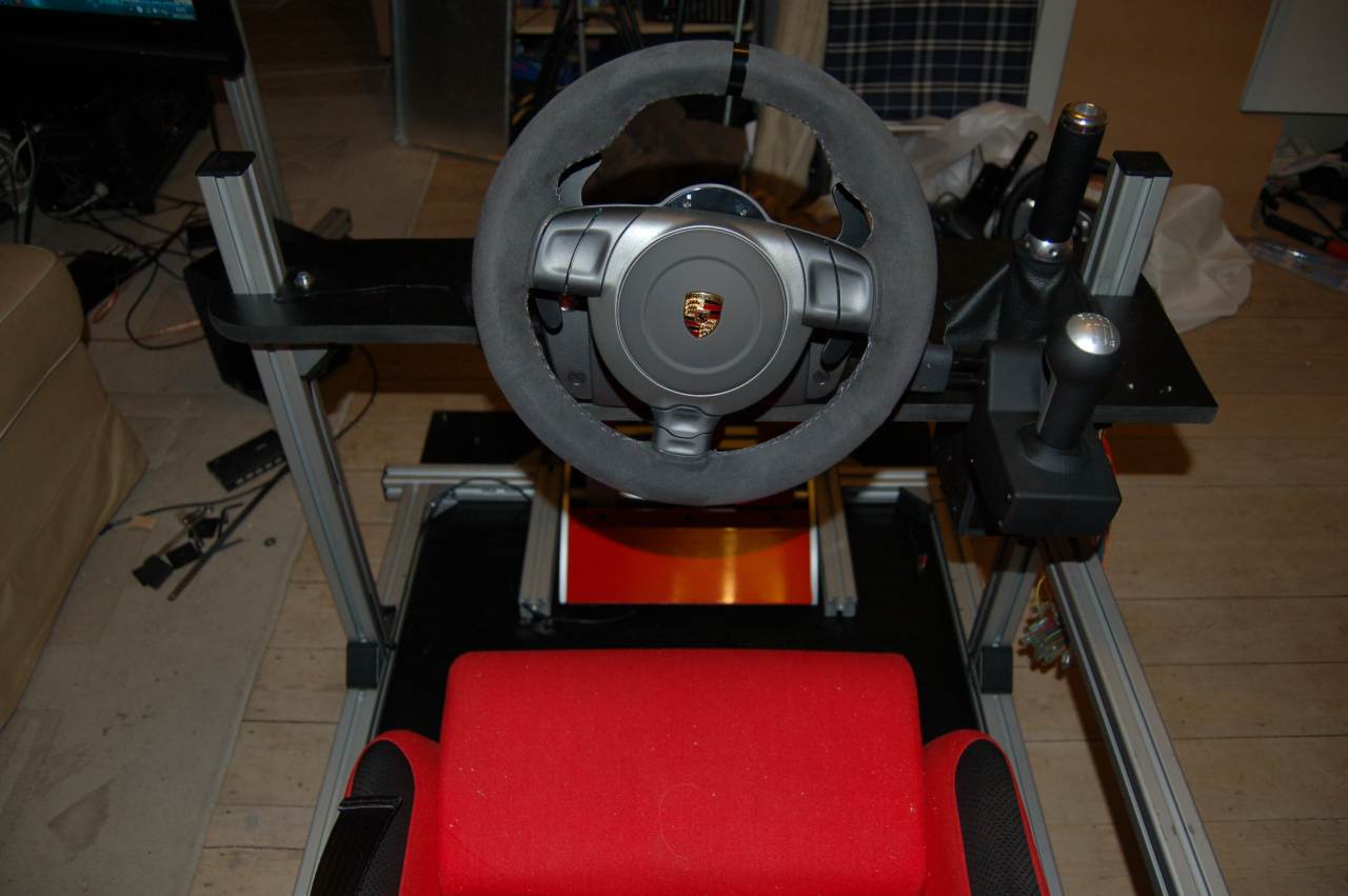

    The brand new Fanatec Porsche GT2, simply gorgeous :

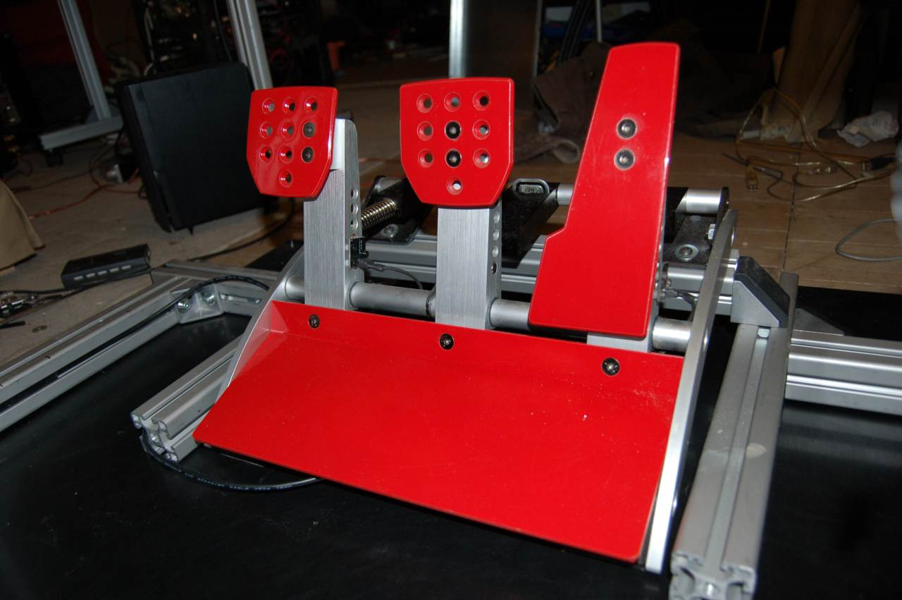

    The Clubsport pedals painted quickly in shiny red :

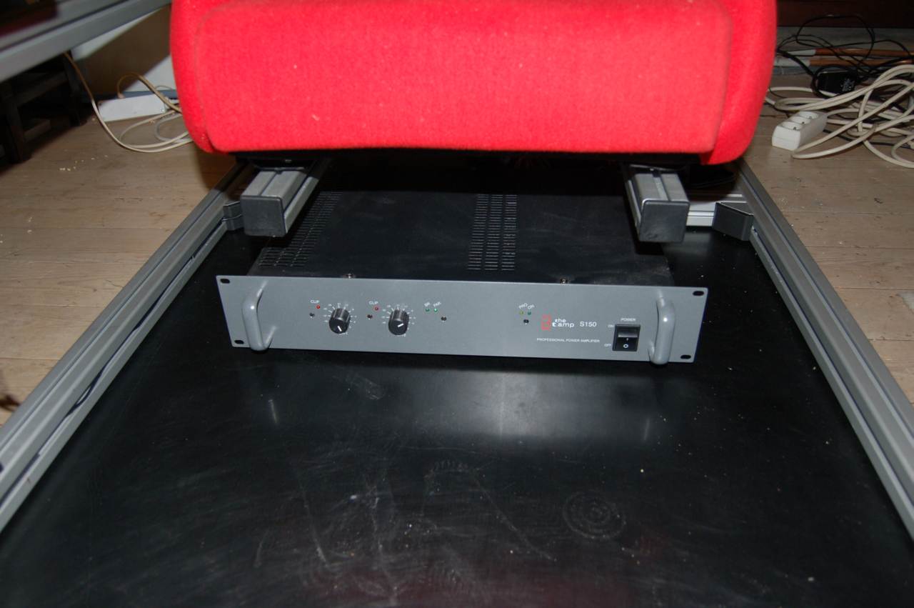

    The T.Amp S150 from Thomann for the bass shakers :
    And the new place for the second bass shaker :
