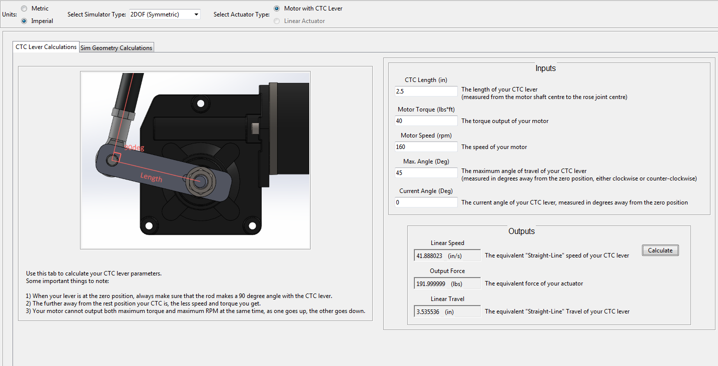

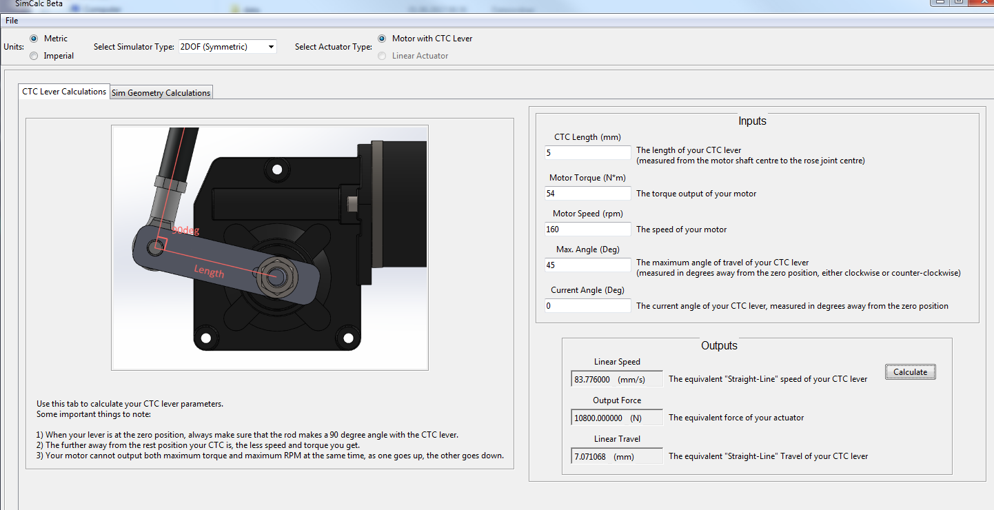

    http://take.ms/6OShr@Tim McGuire New home is here: https://www.xsimulator.net/community/marketplace/simcalc.184/
    Unfortunately i also was not able to upload the file from the forum system. Think it executed the max php upload limit and its too much work to overwrite it just for temporary reasons. So i had to upload it manually via FTP. If there are any update i have to upload them manually again. Alternatively if you like to upload it to github or any other "permanent" available source i can link it to there.
    Btw. I think there is something calculating wrong in metric mode:
    Imperial:
    Metric equivalent
    The parameters are converted by me into their metric equivalents but the output force and Linear Travel differs totally from the imperial results:
    41 in/sec != 83 mm/s
    191 lbs != 10800 N
    3.5 in = 7 mm
    10800 N are 2427 pound force which is a little bit more;-)

    Hey René, it looks like your CTC length is just 5 mm. Did you mean 50mm or 63mm (about 2.5")?

    @Zed It's just for example. The length of the lever should not affect the correctness of the calculation

    As for the incorrect results, I think it's just stemming from my kind of clunky implementation of unit conversion. When you change the units, the values don't recalculate themselves, which they probably should, so if you input a calculation in mm, and then it gives you a result, and you switch back to metric, the units will change but the results won't... Good catch, I'll add it to my list of bugs to fix in the next revision!

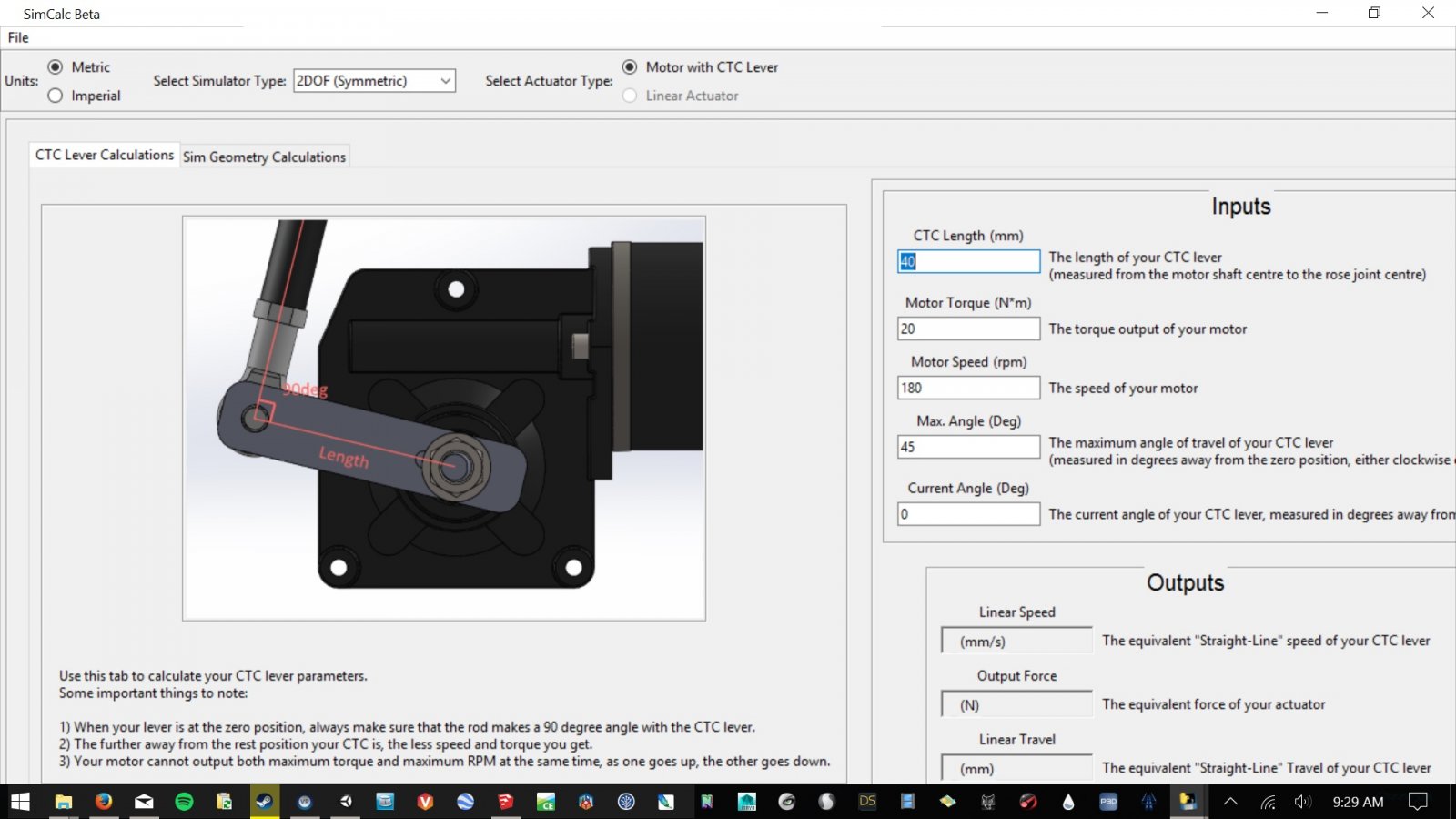

    Is the program Windows 10 compatible? I cant get it to run. just a blank window opens with a blinking cursor.

    It should be windows 10 compatible yes, mind uploading a screenshot of what you see?
