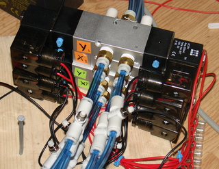

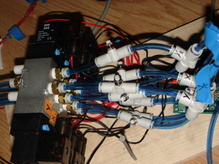

    Hi SimHawk,
    Could you make a photo of your pneumatic assembly please :blush: ? if it's not already do...
    Thanks =)
    Max
  8. SimHawk
    SimHawk Member
    Oct 3, 2007
    120
    Engineer
    Norway
    0Coins
    +0 / 1 / -0
    Here you are! :)

    You only use distributor 5/3 open and card velleman K0855 for pneumatic assembly?
  10. SimHawk
    SimHawk Member
    Oct 3, 2007
    120
    Engineer
    Norway
    0Coins
    +0 / 1 / -0
    I use 5/3 center closed and one Velleman K0855. And one way checkervalves for regulating exhaust port air flow. (Cylinder speed control)

    arf closed what i said^^.
    Are checkervalves necessary?
  12. SimHawk
    SimHawk Member
    Oct 3, 2007
    120
    Engineer
    Norway
    0Coins
    +0 / 1 / -0
    The needle check valves controls the air flow and thus the cylinder speed. Pneumatic theory I found on the internet says that to control the force of the cylinder adjust the air pressure, to adjust the speed - adjust the airflow. And restrict it at the exhaust port (not input port) of the cylinder. See below for more info. :)
    I found this on the web explaining the best way to control an air cylinder:
    You can read it here:
    http://searchwarp.com/swa78890.htm
