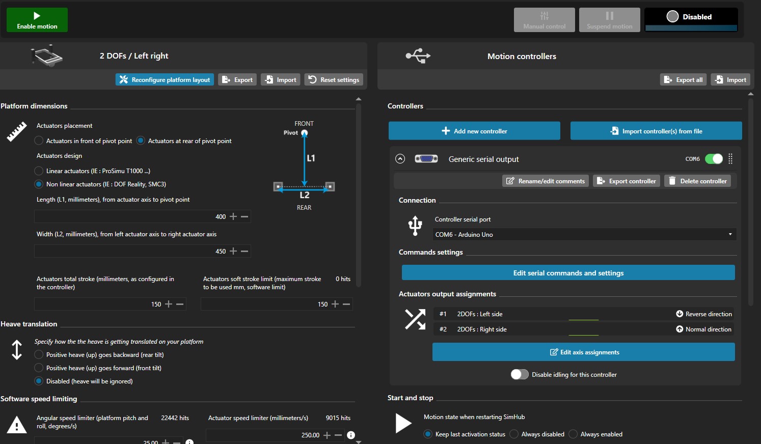

    Hello, I switched to the simhub motion software too, it works very well, just a quick question, I can't find where to change the direction of the right-left effects. Thanks

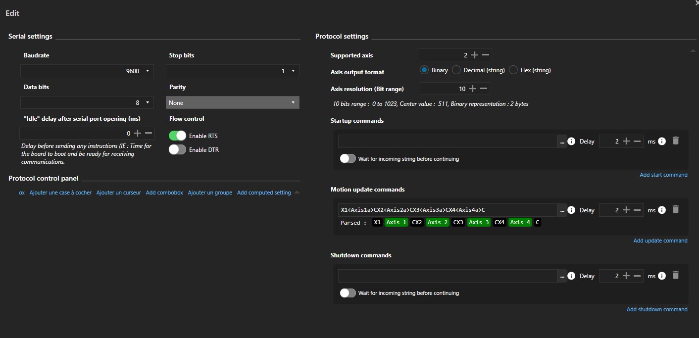

    Screenshots help :) it's likely the bit rate being /18 when it should be /16
    When you assign the axis' just make sure they move the right direction, or reverse them. It's under the output settings

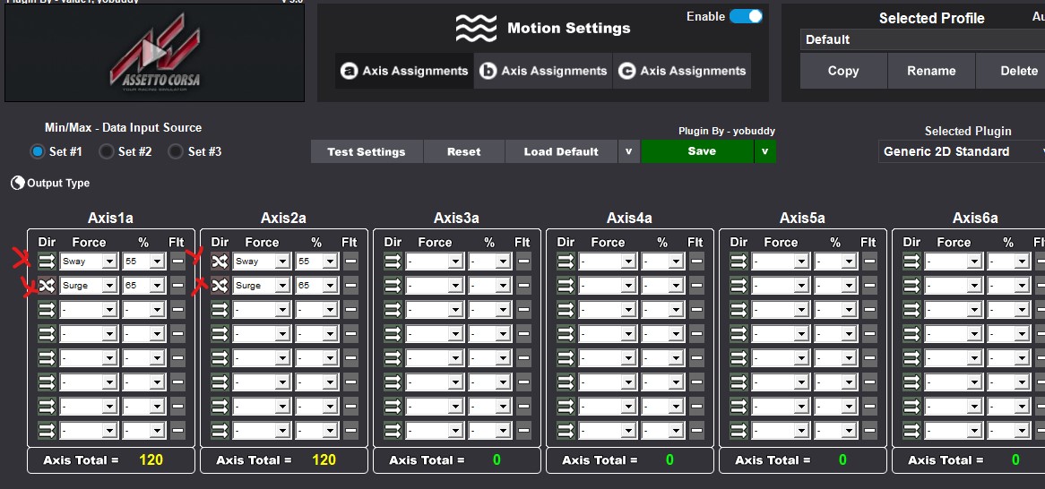

    S'il vous plaît, aidez-moi dans simtools, nous pouvons changer la direction des moteurs par effet, mais dans simhub, le mouvement n'est pas trouvé

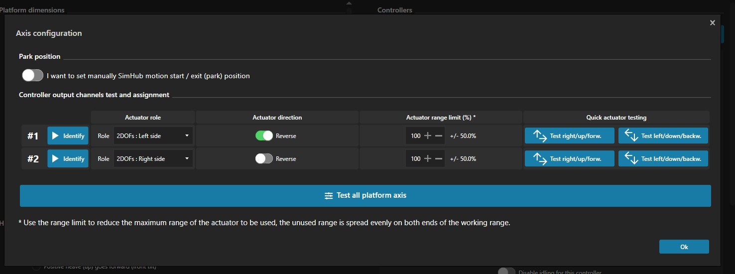

    I see motors are set in your screenshot with one reversed, it's the effect specifically you want to reverse? Which effect and why? Does it not move as it should?

    Make sure your axis resolution is set right here

    I have two motors, braking and acceleration effect are perfect just right left which are reversed I changed the direction of the motors and there the braking and acceleration are reversed on simtools we can reverse each motor with its effect

    When you use Manual Control, does it move in the correct direction?

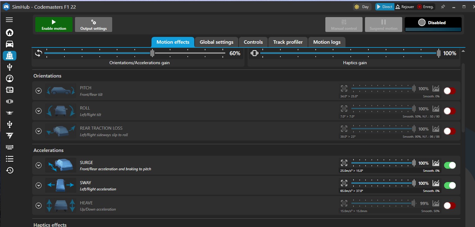

    Enable motion button, then the button on the right that says manual control

    for roll effect my seat moves forward and backward and for pitch effect it goes right and left

    Sounds like you have them configured wrong in the output settings.
