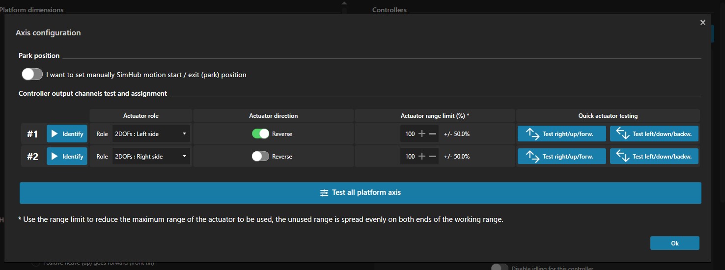

    Hello!
    Can someone help with movement settings? The program works perfectly with all games. There is one exception to the WRC 9. And there is only the " surge " function. When I accelerate, it tilts down, when I brake, it tilts up. Is there a way to reverse only this? Simtools is work perfectly, but Simhub not. I have no idea how to reverse this one . I tried to turn the actuator output, but then everything gets messed up in other games, and the parking position also goes up.

    I might have wasted a lot of money here. How come Simhub doesn't allow you to choose which actuators are heave, roll, sway etc?
    Simtools and the old x-sim softwares allowed this.
    Further more, Is FLYpt software the same as simhub where it constraints you to the 4 corners sim.
    It is real shame because the reason I purchased was to have motion compensation XR and motion telemetry all in one go.

    1) it does not allow you to choose 4dof and then decide which actuators can do sway or surge.
    it incoaperated all axis to dothe same. there is a limited geometry you can choose from
    2)does anyone know if you can run simhub for motion compensation only for the VR and run simtools at the same time for doing the motion of the rig?

    @Silyn Just saw your video on YT. Very helpful. How/where do I set axis resolution? I was reading something about grounding pin 8 of the Arduino for some reason, is that what I need to do.
    I'm also having some issues setting up motion compensation. The roll and pitch axis test are reversed. Pitch does role and visa-versa. Not sure if it's a program issue or maybe I did something wrong, but they seem to work OK in-game.

    How do you make the right setting for the layout when there is only 4-5 types of layouts available in SRS and SIMHUB.
    How can you make 4 corners sim rig; but then choose front two for surge only and back two for sway?
    Simtools allows you to make any setting you want.
    SRS and simhub is limited? I must be doing something wrong. I purchased simhub and then got a refund, i then downloaded SRS and saw almost carbon copy of simhub.

    Simhub has only few chosen Layouts for a reason.
    It should be as easy to set up as possible and has therefore only been developed for the most common layouts.
    SRS has been around for much longer, so to speak of "carbon copy" is not really indicative of your ability.
