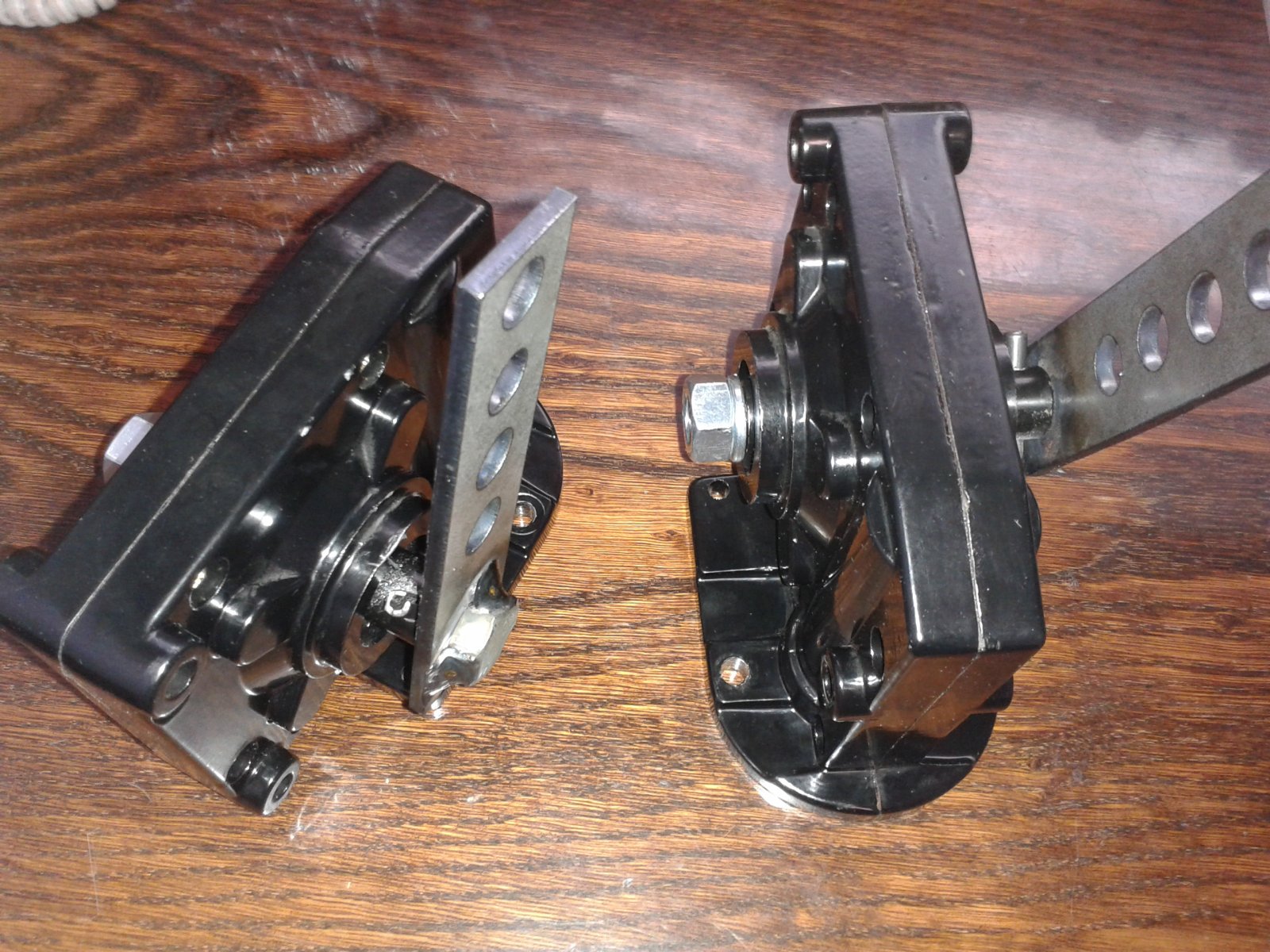

    I ordered these 2 pcs motors. They are
    150/160 rpm 25:1 ratio.
    http://www.ebay.com/itm/351066992384?_trksid=p2057872.m2749.l2649&ssPageName=STRK:MEBIDX:IT
    or better i needed these? Thank you for your advise.

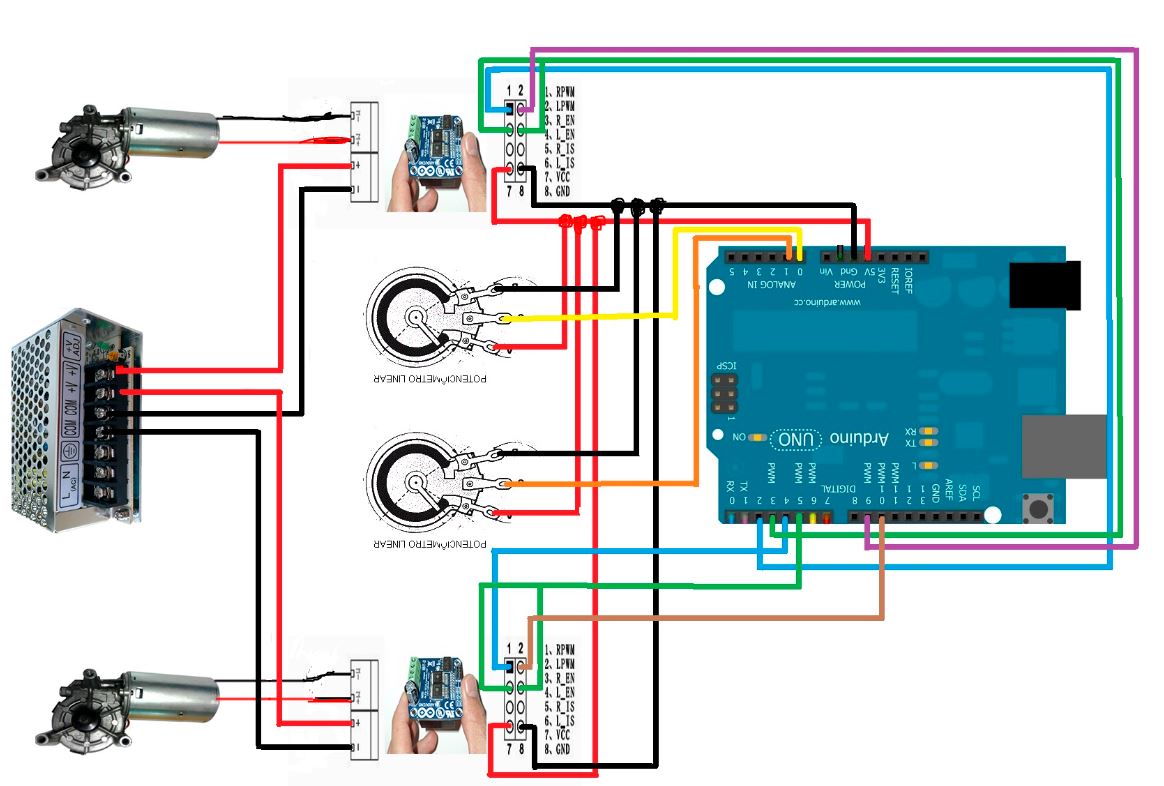

    My one of 2 monstermoto has died. I ordered 2 pcs. 43A IBT-2 found on ebay ( now think needed more ). If something wrong with one IBT-2 Is it possible to use one monstermoto and one IBT-2 with the same arduino uno? I think it is possible to wire but will not be any mismatch?

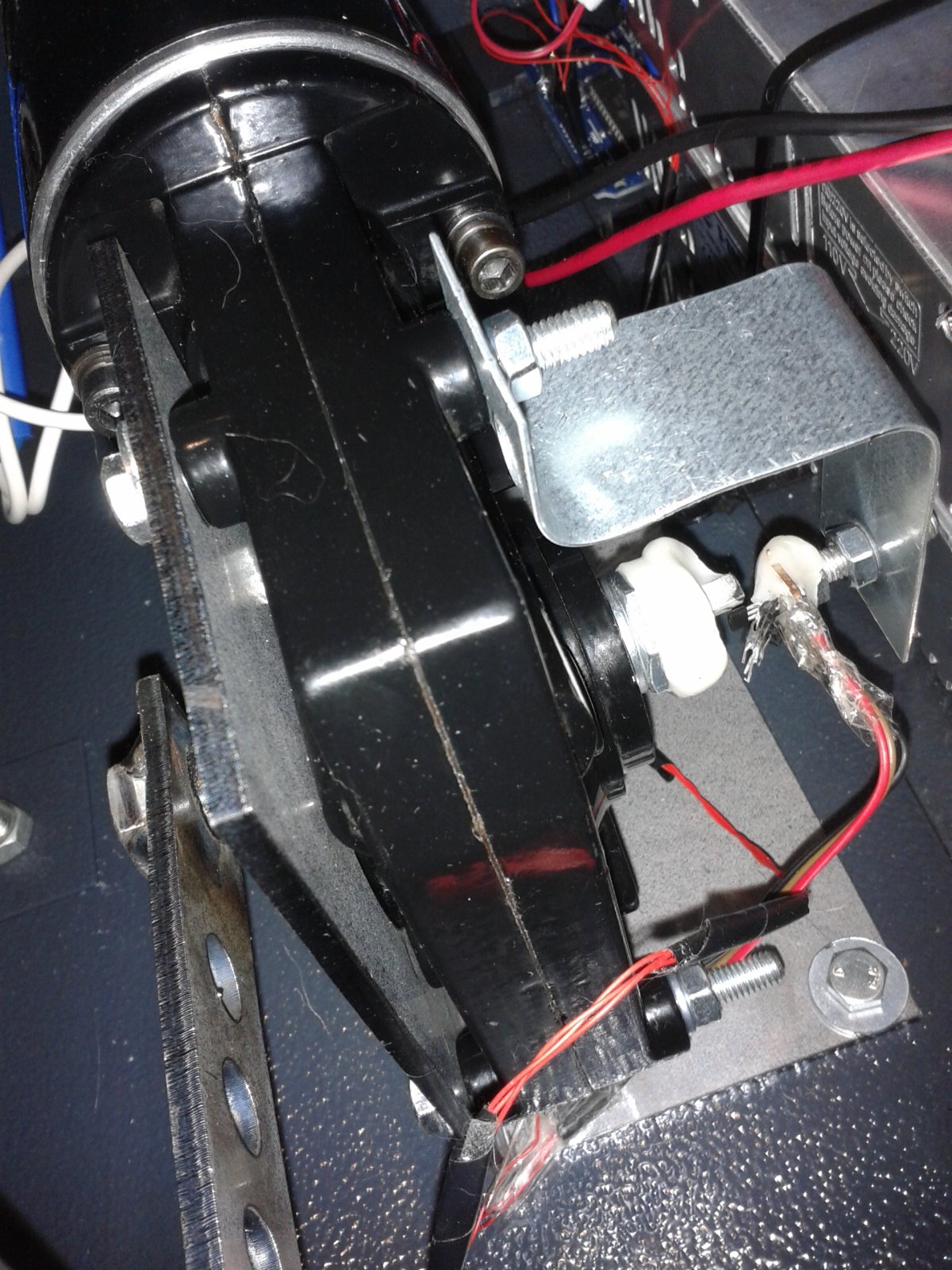

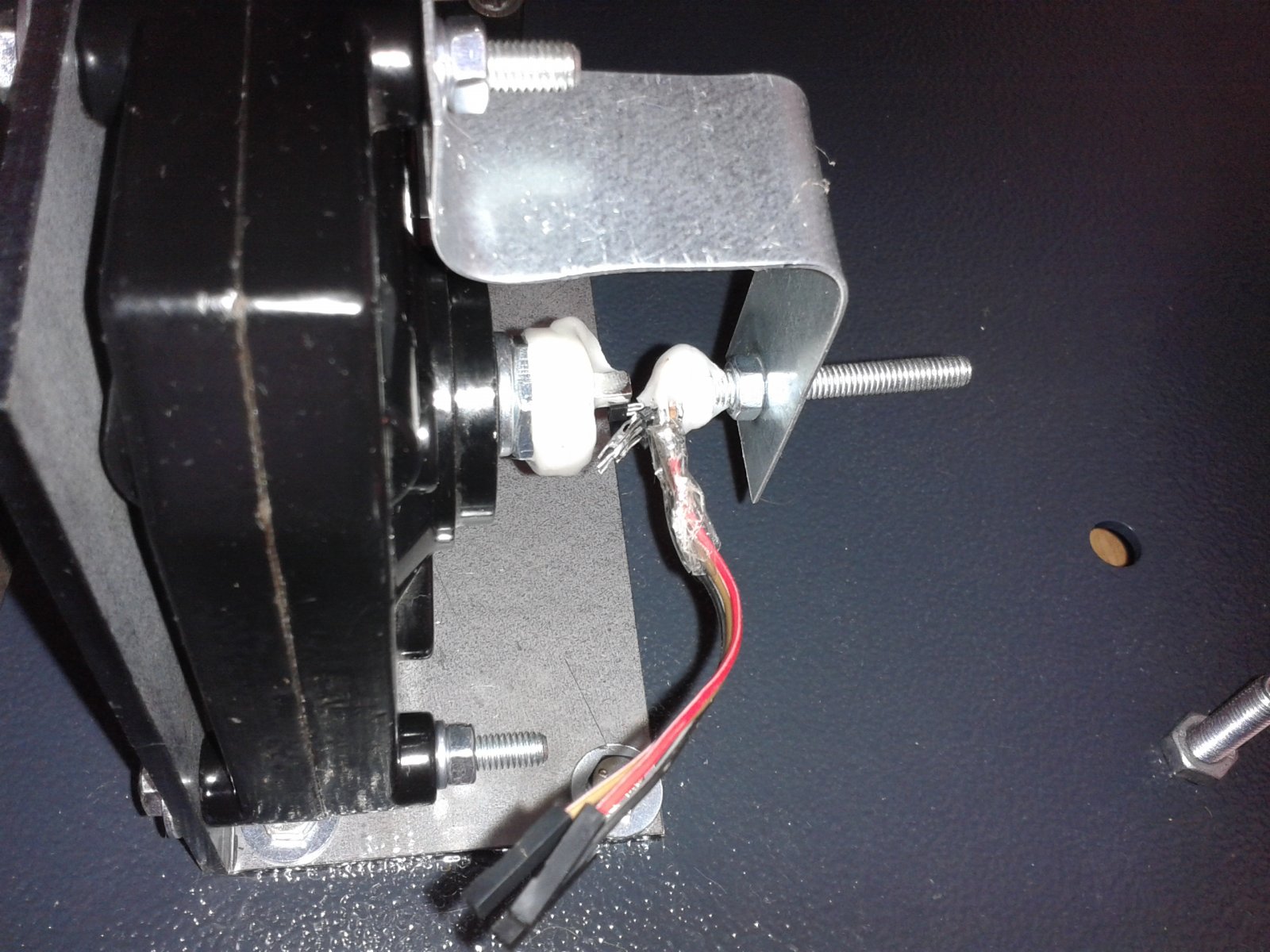

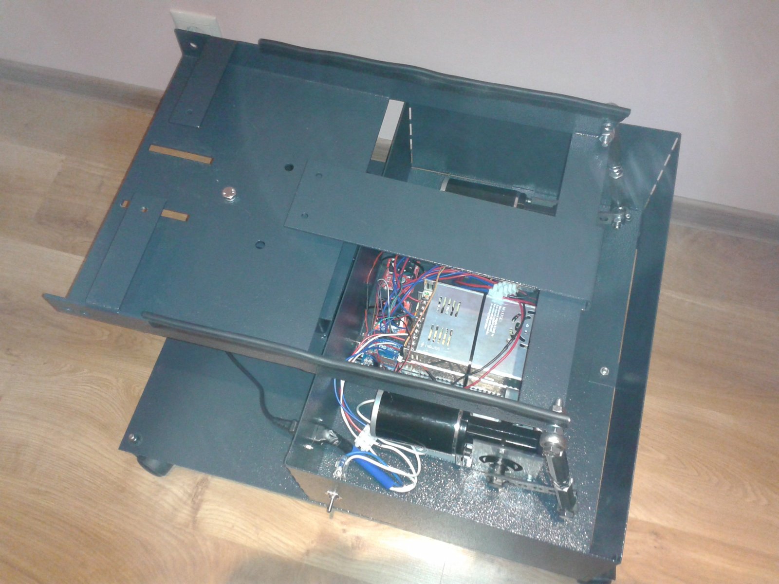

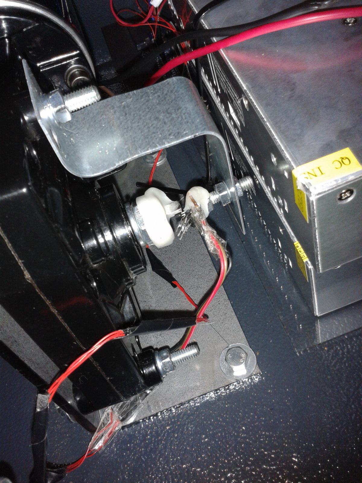

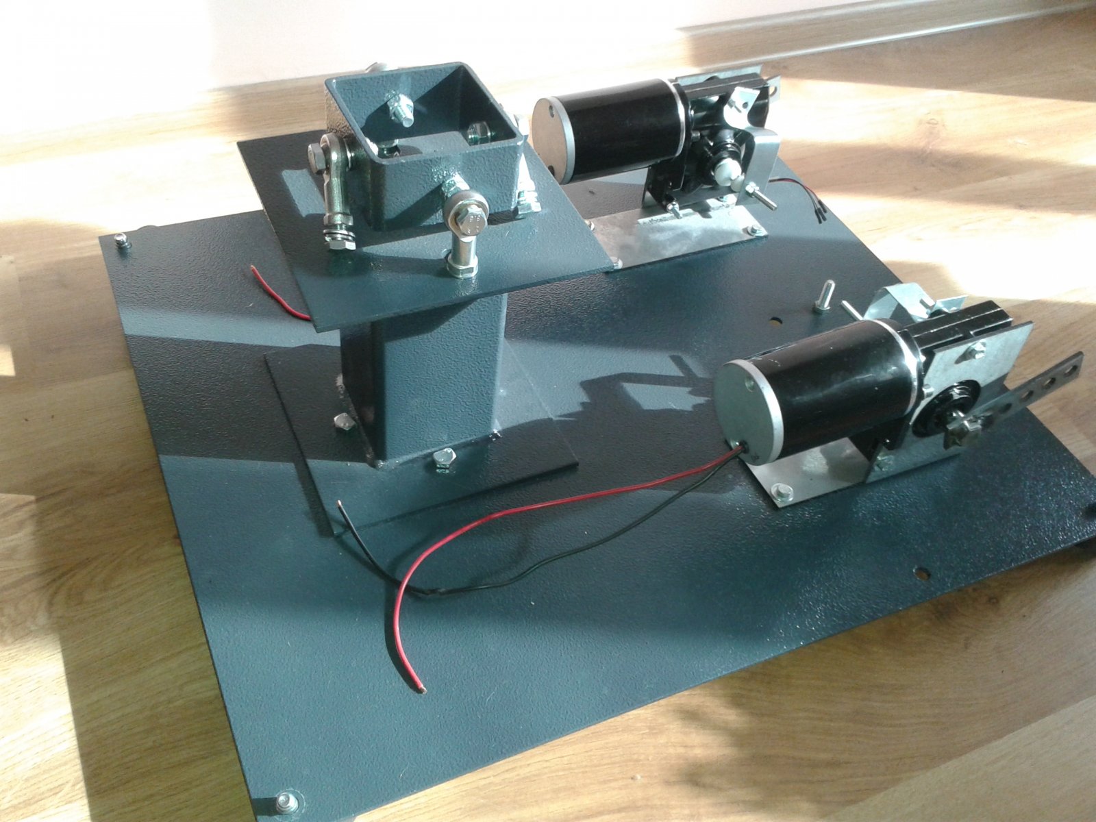

    My new motors arrived. Continue my project.
    Used polymorph ( ) to fitt hall sensor on motors. It is more accurate because hall sensor has no mehanical conections with magnets. Some photos.
    22,211
    154,729Coins
    +11,213 / 57 / -2
    Nice progress @Arunas.
    I suspect the levers are a little long, somewhere in the 30-40mm CTC will likely be the zone to drive what is a pretty compact design.

    Yes that works. Do not forget to enter "Mode 2" in the ArduinoCode. That happened to me. :rolleyes:
    // Set to MODE1 for use with a typical H-Bride that requires PWM and 1 or 2 direction inputs
    // Set to MODE2 for a 43A "Chinese" IBT-2 H-Bridge from e-bay or equiv
    #define MODE2

    Found :D . Made test. Both IBT-2 output to motor -6 V - +6 V. Will IBT2 43 A be good for my 12 v motors with 15 A ( 180 W ). 6v* 43 A - 258 W. They must be ok for my motors. Am i right?

    Yes that's right. Mode 2.
    I'm still a beginner with this Sim technology. But the power should fit. Just test and observe the temperature of the IBT2 heat sink when using.
    Thanks for that polymorph information. I find it very interesting :thumbs

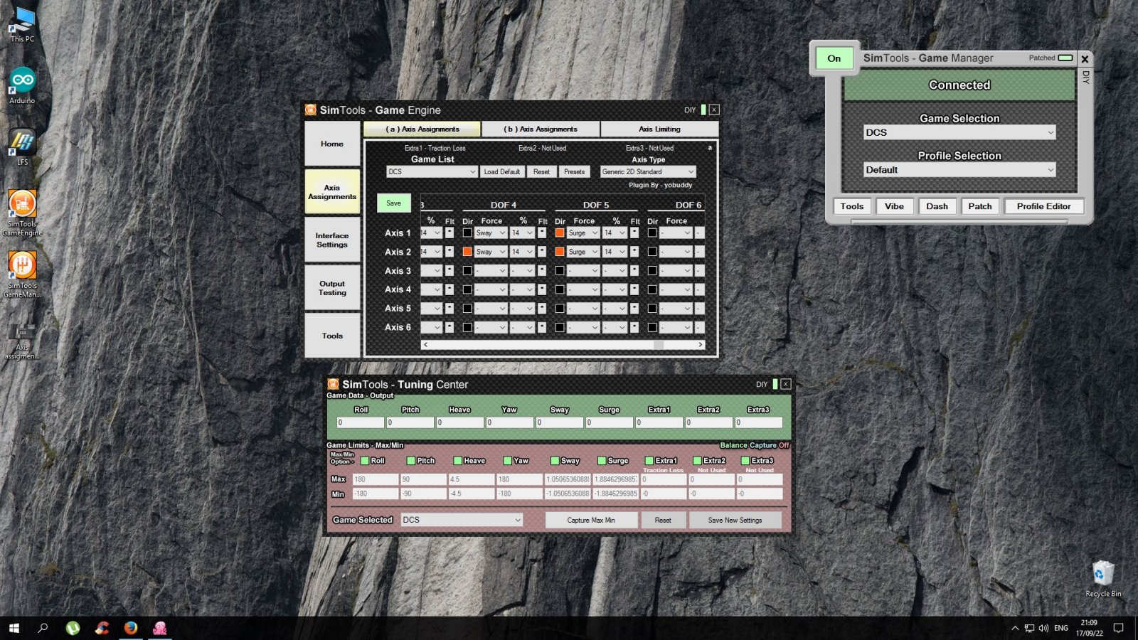

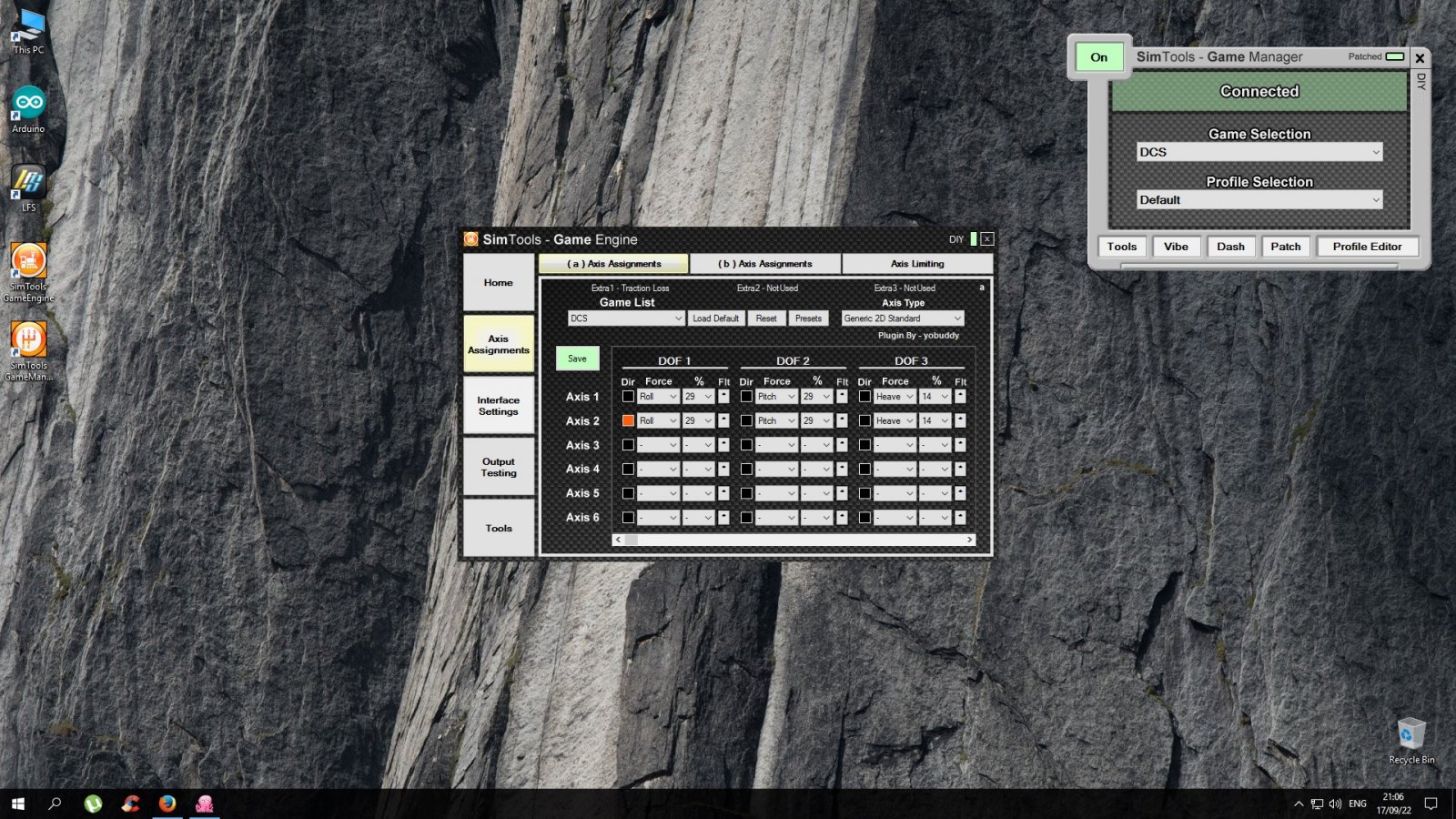

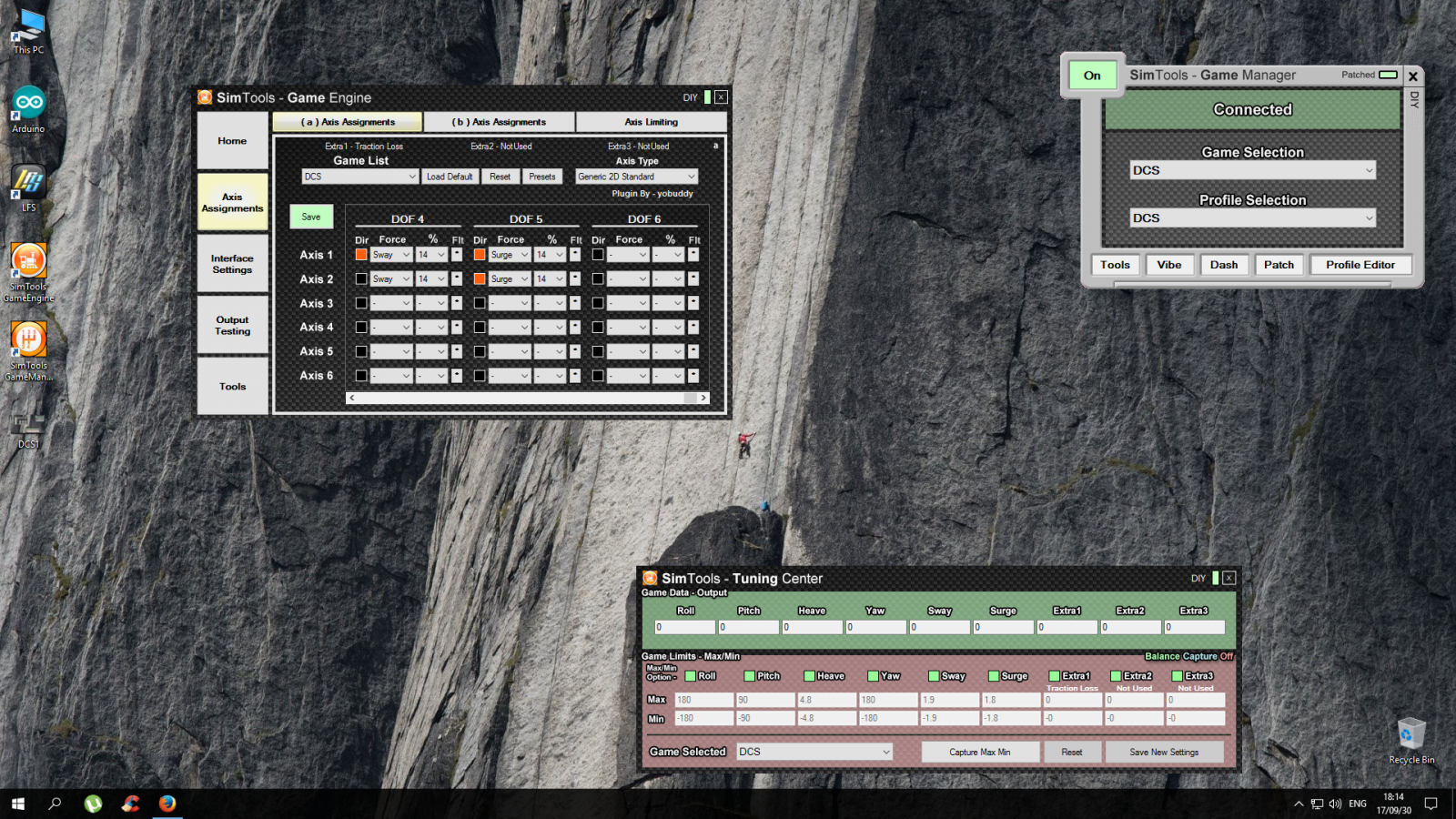

    Thank you very much for free Simtools lisence and for game plugins. Made some video with Joystick plugin. :grin
  18. Arunas
    Arunas Member
    Feb 27, 2017
    50
    Lithuania
    2Coins
    +26 / 0 / -0

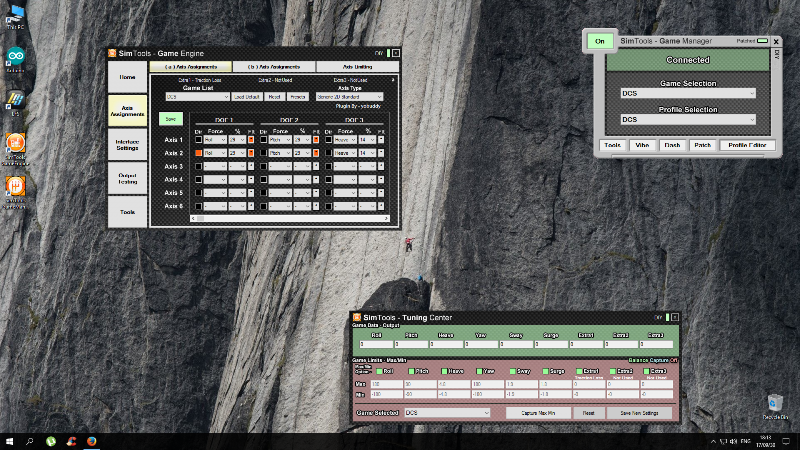

    Made a little video with DCS BF 109. Axis assigments for me is very good. I am very pleasd with my 2 dof seat. :D Thank you for advices if something not very good.
  19. Arunas
    Arunas Member
    Feb 27, 2017
    50
    Lithuania
    2Coins
    +26 / 0 / -0

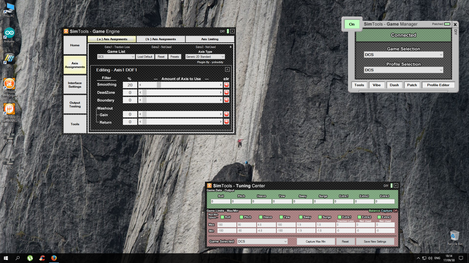

    I think this was wrong axis configuration for sway. Sway must be opposit roll. Smoothing for roll and pitch 20 % :)

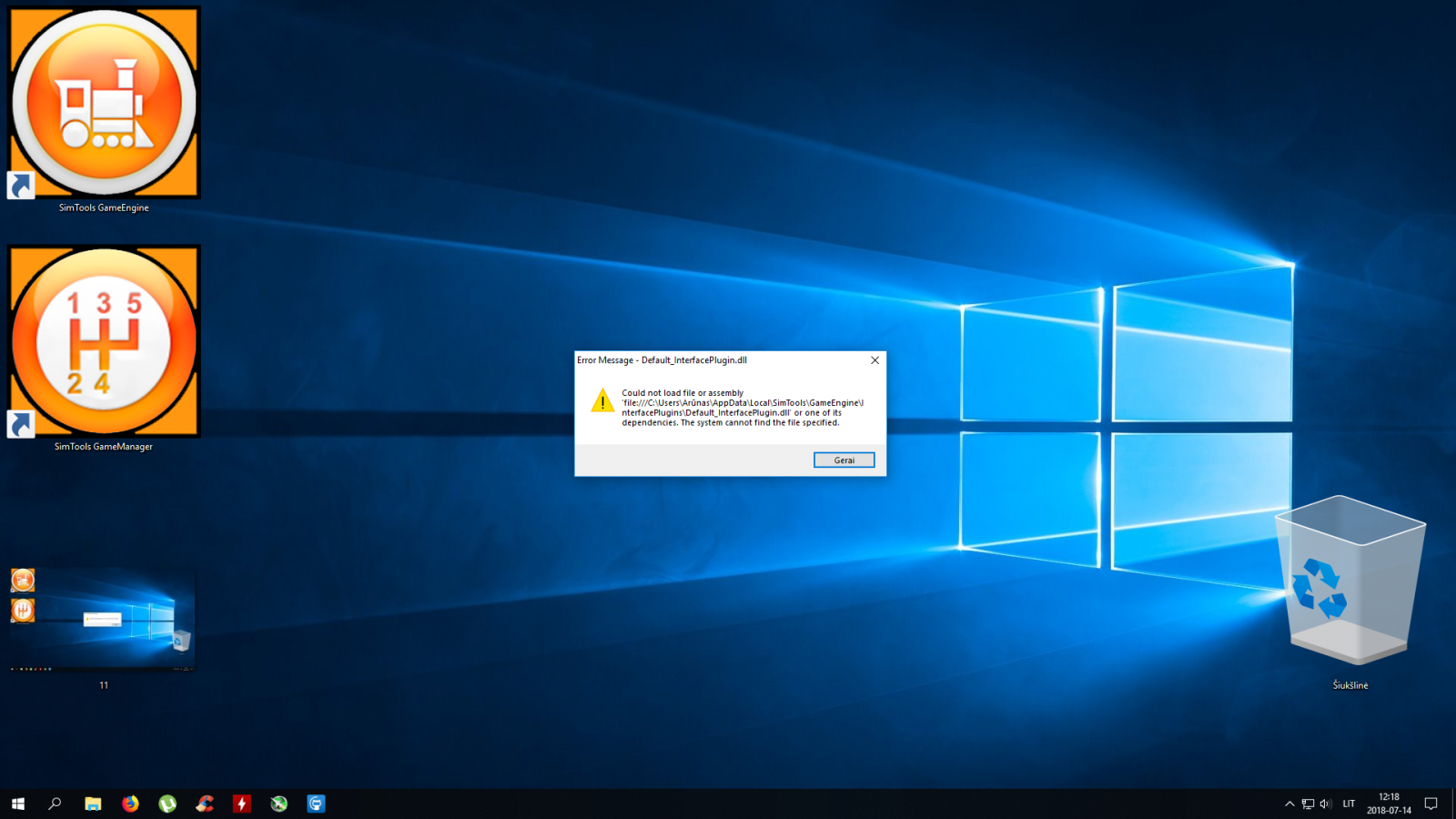

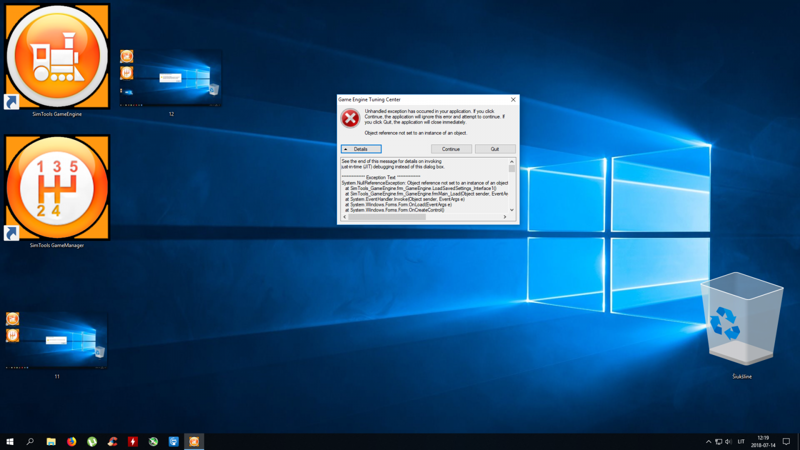

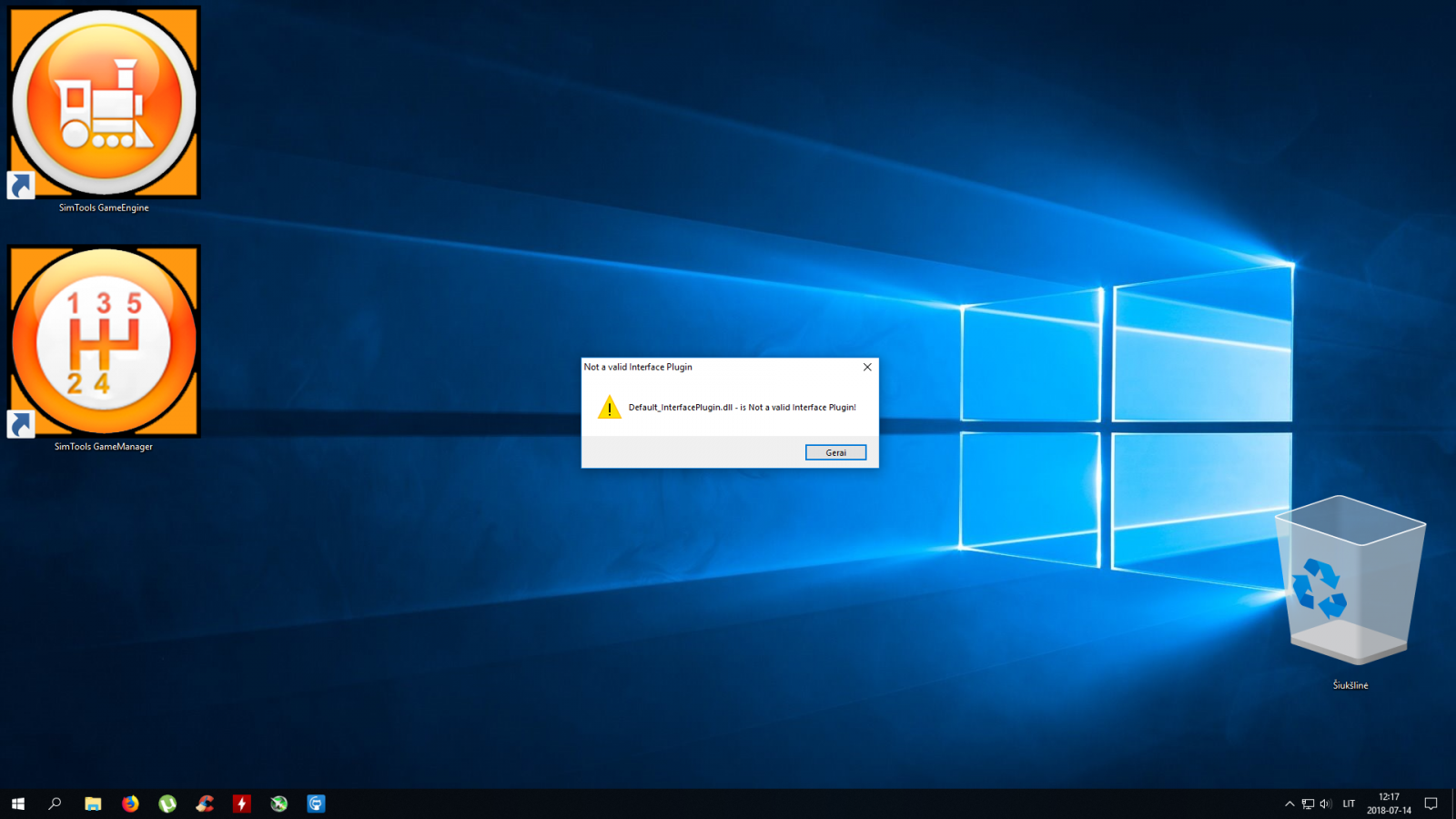

    Hi all. I had to reinstall simtools. Deleted folders Simtools and Simtools license from c/user/name/Appdata/local/... Tried reinstall few times. [​IMG] [​IMG] [​IMG] Simtools DIY registration is ok. Please help. SimTools_2.2.5 version.
