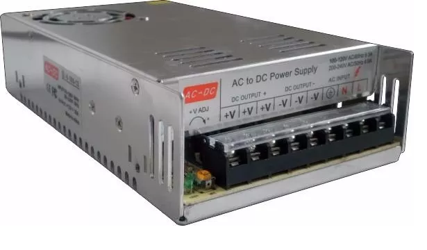

    New 24V 20A 500W power supply purchased to support new engines, now just wait to get there.

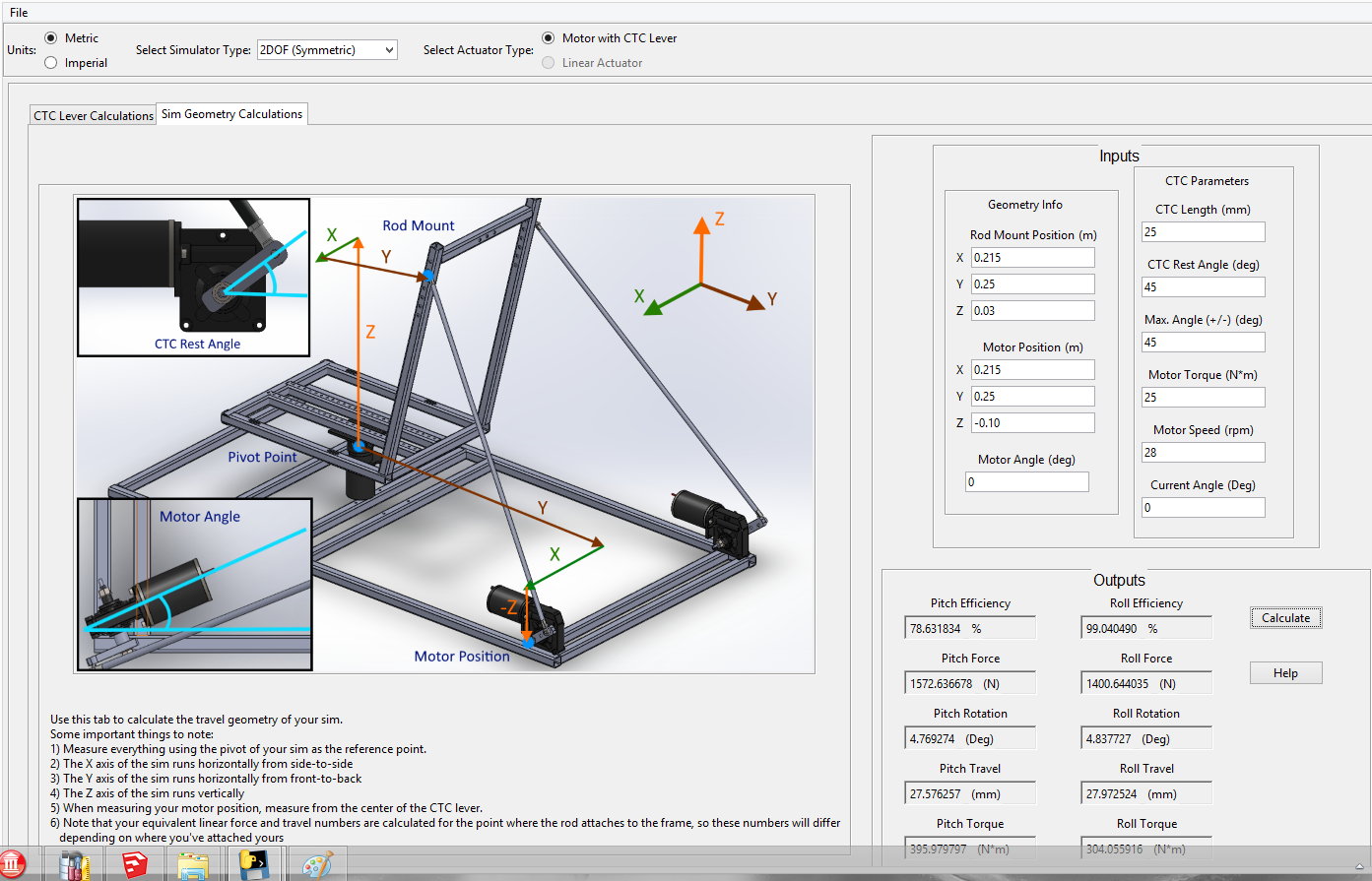

    New calculations of the performance of the motion from the engines I bought, and the measurements, one thing I did not understand is, there in Roll and Pitch force, is the force that the 2 engines can handle working together?
    22,150
    154,526Coins
    +11,185 / 57 / -2
    Simtools mixes the axis/forces allocations on the fly, so even on a 2DOF you can have sway, surge, heave, pitch and roll allocations. So there is the theoretical of just the single axis force possible for both motors, then there is the reality that axis/forces are mixed in practice.

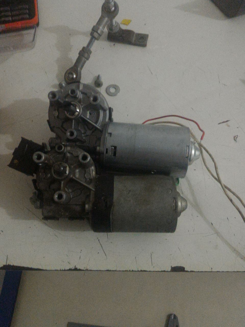

    The engine has arrived, much more robust than I have, now it is necessary to mount the lever and wait for the source to arrive ... that will take time :(

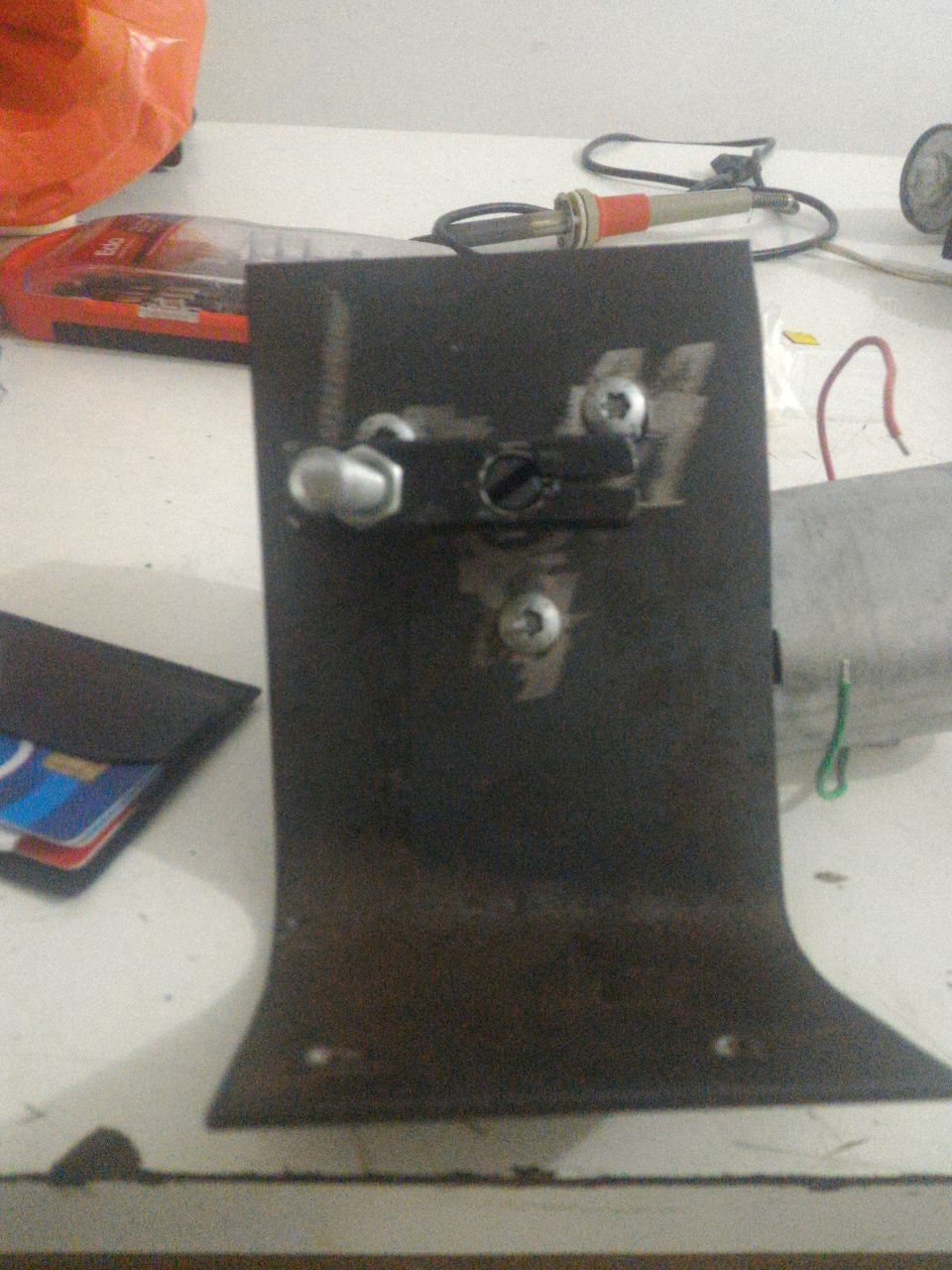

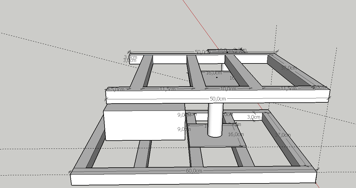

    This is the design for the new engine, now all that remains to be done.
  11. Joao Neto
    Joao Neto Mucilon
    Jan 13, 2017
    61
    Computer engineer
    Salvador - Brasil
    310Coins
    +36 / 0 / -0

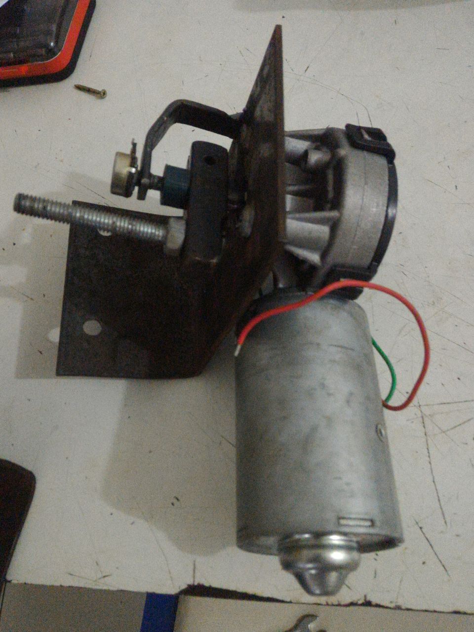

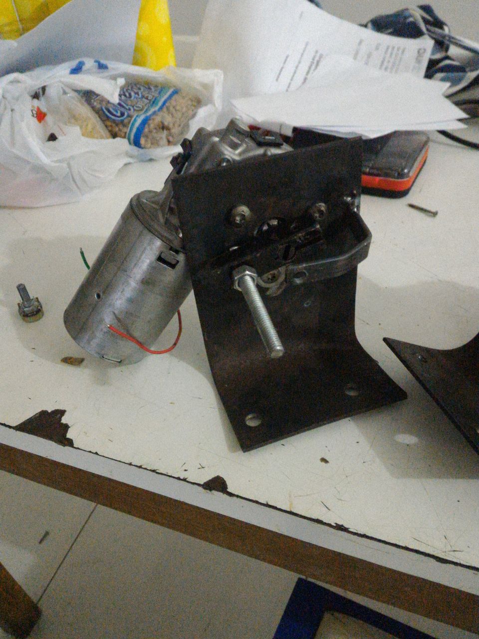

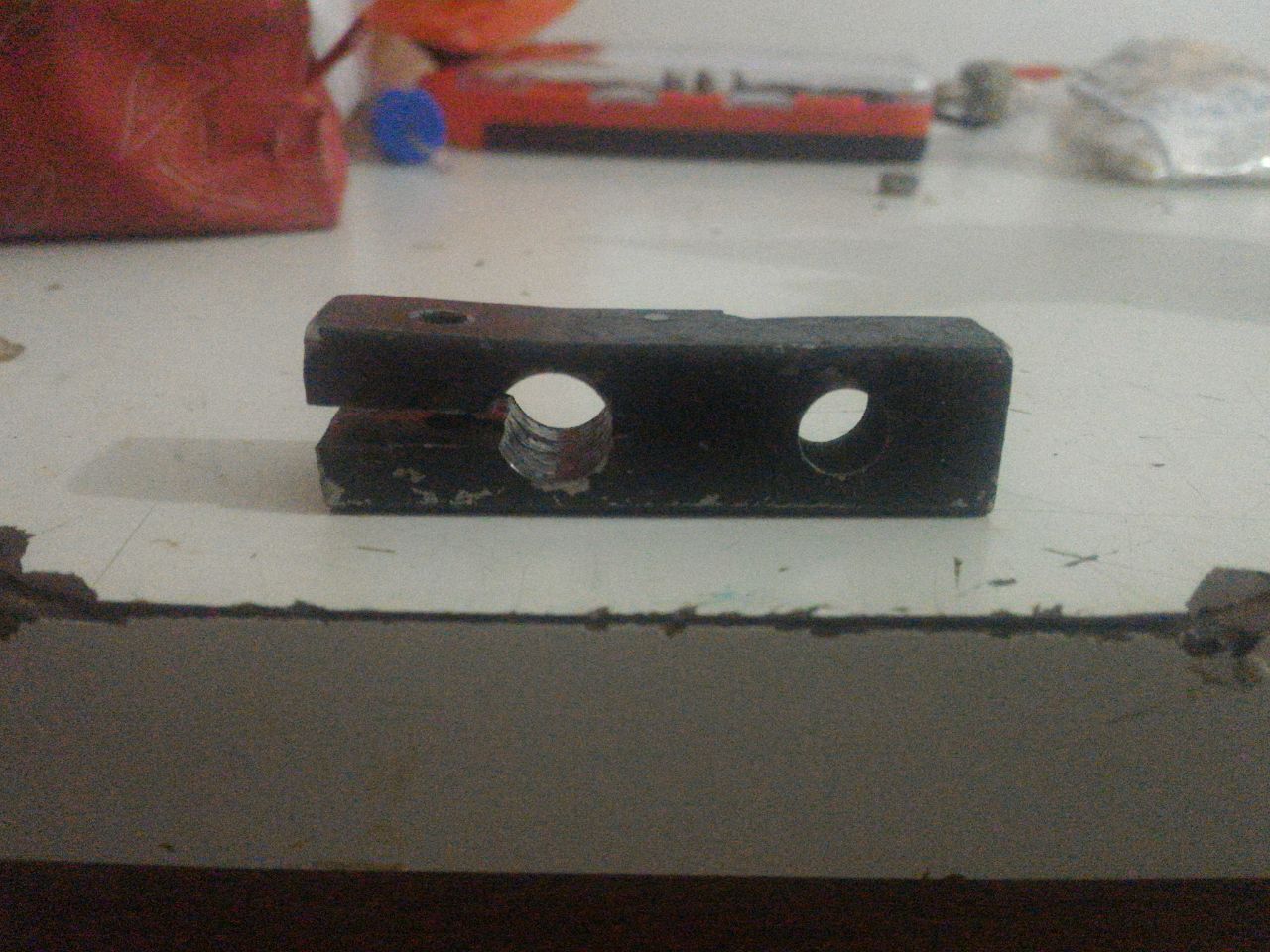

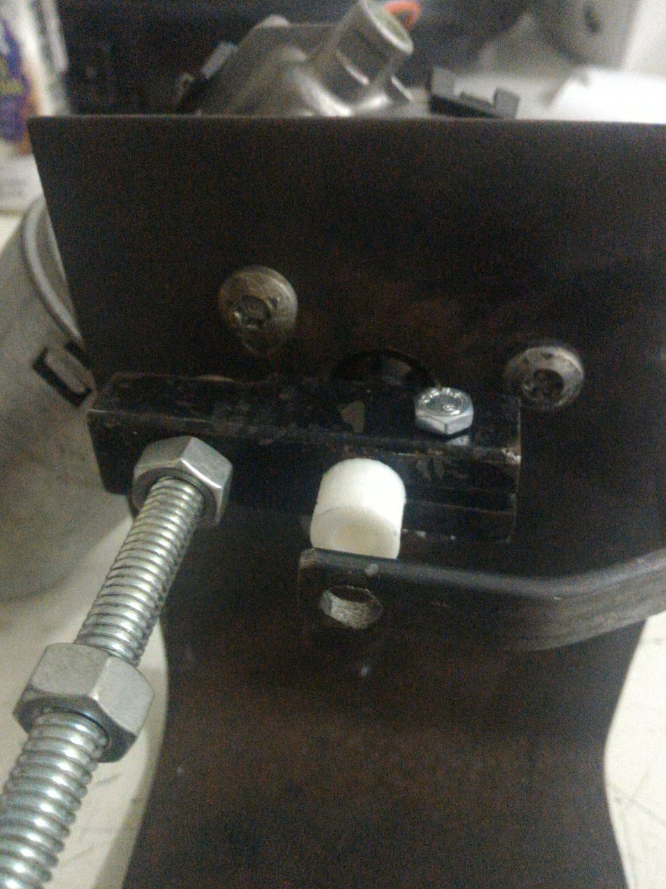

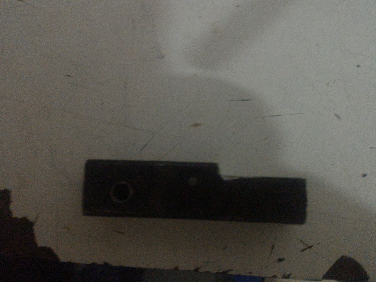

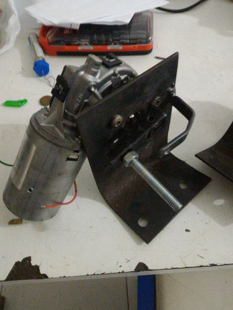

    Frets mounted a bit different from the planned, but functional.
    Lever attached to the engine.

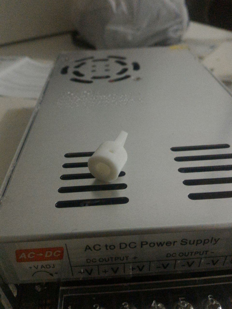

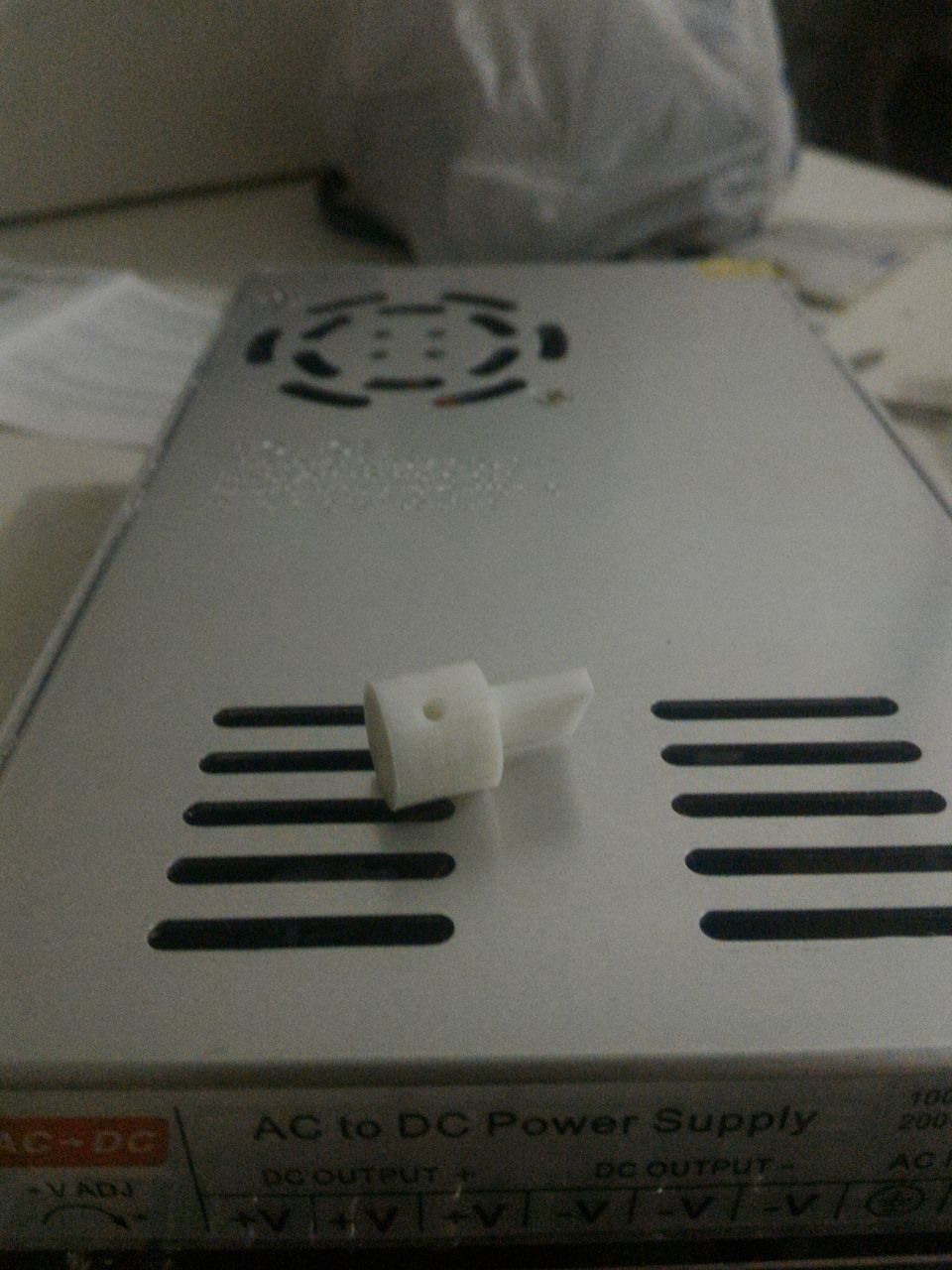

    I'm thinking of having this part done in a 3D printer, to put it on the motor shaft and fit the potentiometer into it, I think it was good.

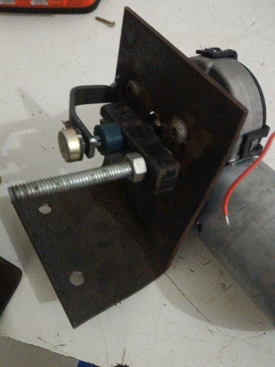

    New, arrived my support of the potentiometer everything assembled embedded and SMC configured, now it is to configure the axes in the Simtools and to make the tests with weight.

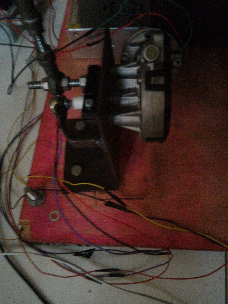

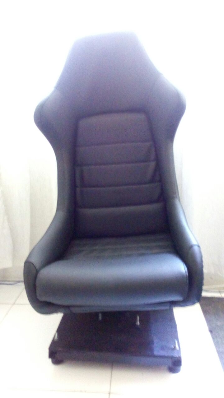

    Resuming jobs after a long time, stopped. Bench lined and painted motion.
    I had a problem with wires of the potentiometer, the same let out and finished that the engine turned more than it should, thus leaving my bracket crooked, Already is aligned and painted.
    Next step reconnect the motors.
