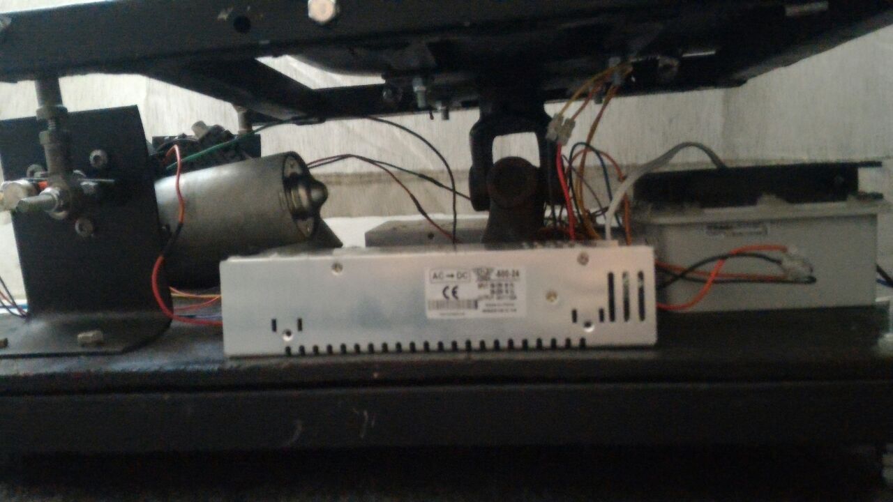

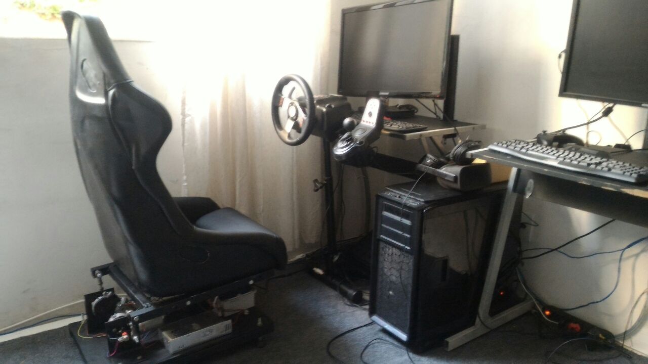

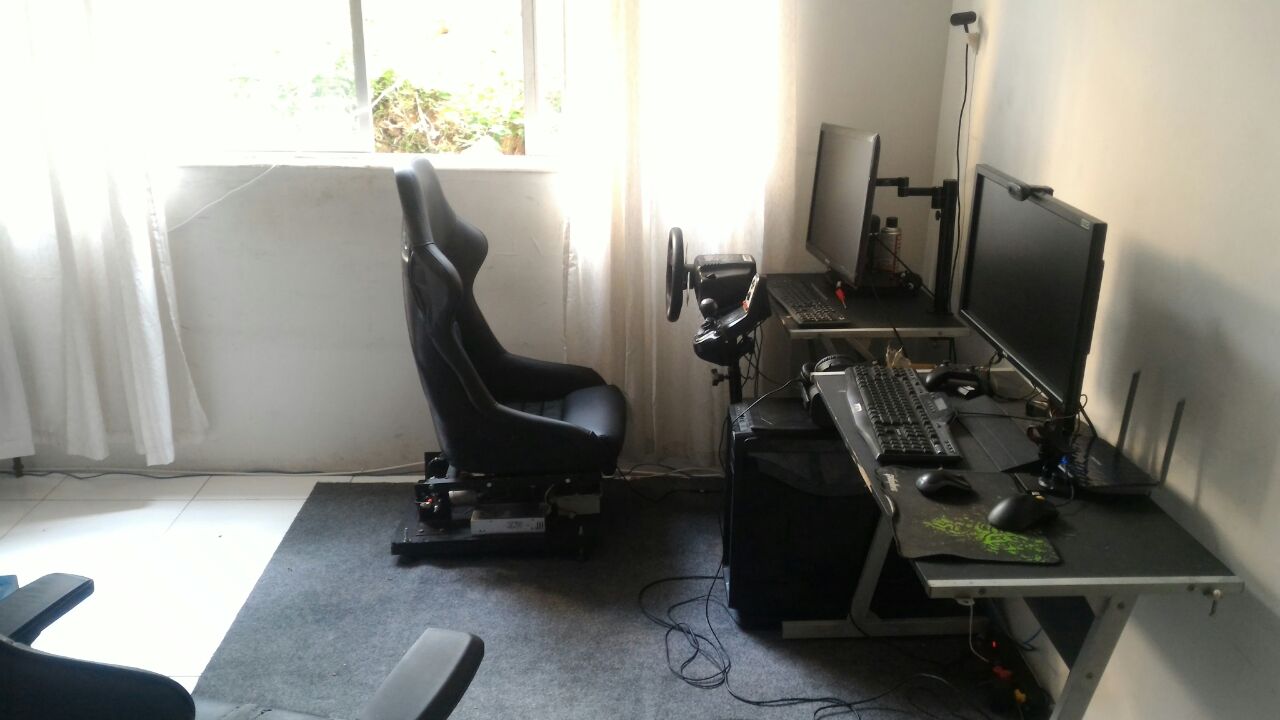

    Motion Yes fully reassembled. Next step is set up and test.

    Well all configured and tested, it works in a very satisfactory way.
    But I'm having a problem with loss of centralization during the game. It happens more to the left, but it happened in the right one time, but the strangest thing is that when I close the game and open SMCutils it comes back to the right center. I thought the lever could be slipping on the motor shaft, but if it was that it would not go back to the center when I called SMCutils, does anyone have any idea what it could be?

    I made some modifications to the SMCTools configuration and solved my problem, before I was using PWMmin = 0 and PWMmax 200, now I'm using 180 and 220 respectively.
    I used a lot this weekend, it is working 100%, but I still think it can improve on the motor support, to decrease the vibration and to decrease the deadzone of the potentiometers that I am currently using in 3.
