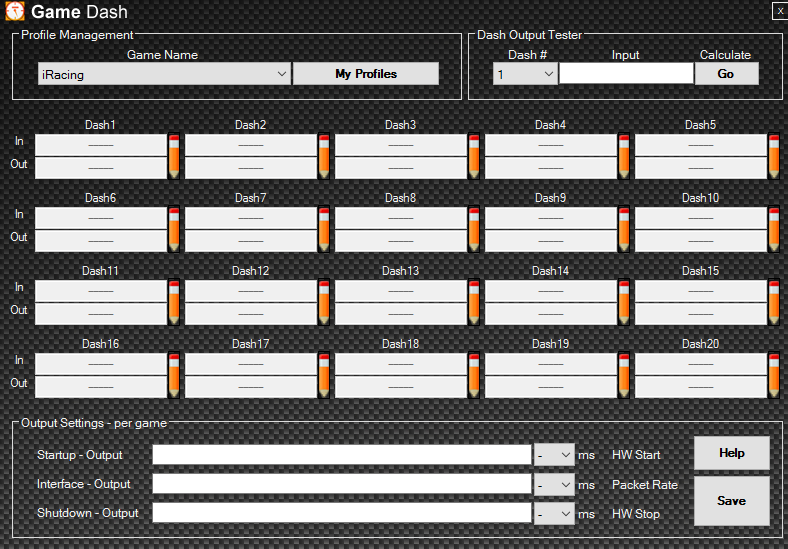

    Hi @TOPMO3
    I have downloaded and installed the Plugin (iRacing_Plugin 1.0.5.2). when I load game dash and select the plugin from the menu nothing changes (dash Headings). I have attached screenshot below. I have tried uninstalling, patching, restarting PC. Just can't seem to get this to work. Have you got any ideas?

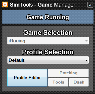

    Do you get "Game Running" in Game Manager when you start iRacing session?

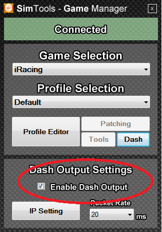

    If yes can you please check that you enabled Dash Output in Dash setting?

    Yes I do get game running as well as enabled the dash. I used the default 127.0.0.3 (I think) IP address beneth enable dash, as well as my PC IP address and still nothing.
    All the dash code has been written into game dash also as per your screenshot.

    @TerminalKaos if you are using one pc for simtools (game engine, game manager and GameDash ) IP should be 127.0.0.1
    and then you have to configure game dash as described in first post. the only thing that probably be different is the COM port. you have to find which port your arduino is connected to.

    Hi @TerminalKaos ,
    I agreed with @insanegr , you should try 127.0.0.1 address.

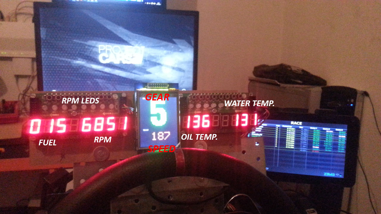

    My Modded lcd+ 2 TM1638 working on Project Cars (PS4 Version)
    I have 3 arduino boards running
    One TM1638 plugged to Arduino Mega
    Other TM1638 plugged to Arduino leonardo
    and Lcd to arduino UNO Rev3
    How that works?!?!?!?!?
    Simple :) . I have 2 virtual machines in the some pc running each one are running the software Gameengine, Gamemanager and Gamedash thats the only way to make the 3 Gamemanager connect to PS4 port 5606
    Thanks to @TOPMO3 for the project
