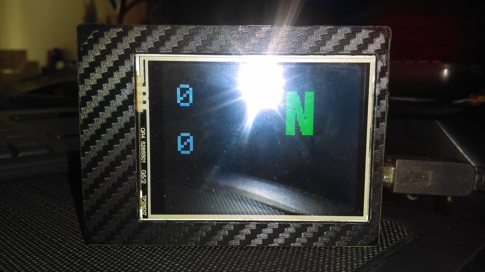

    Because when I play LFS, gamedash speed output is m/s, and is an integer
    So this number * 3.6, the unit is a multiple of 3.6 to increase,
    If I do not want this, do I have to modify the plugin

    You can try to modify the plugin, but if the game itself output only integer m/s, then you can do nothing with it even in the plugin

    In addition gamedash currently takes only integers as input. Decimals will be ignored. So modifying the plugin only will make no difference
    As @TOPMO3 said, those extra digits/precision may not be worth the code/performance effort. Is a tachometer needle precise ?
    Anyway speed is changing very fast so anyway you couldn't read decimals and probably not the last digit either, unless you drive a snail :p

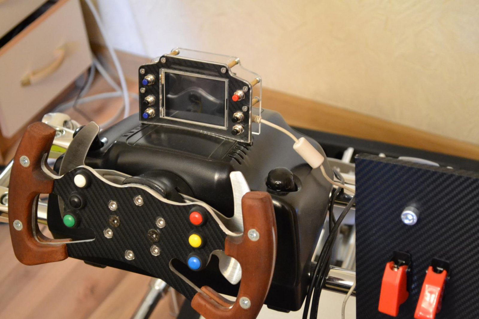

    Nice Wheels, Jordan. I am thinking of ordering one with the orange & white striping (which I will be alcantara/suede wrapping, BTW!), am I right in that it originally has a gap across the top (can't quite tell from the pic)? Would you happen to know what that gap dimension is across the gap and perhaps even the dimension from the centre part of the wheel? This will help me determine the size of screen and button/rotary switch layout design.
    Cheers
    Seb

    There is a gap across the top, but I cut the gap larger, so I'm not sure what it was orignally.
    Thanks,
    Jordan

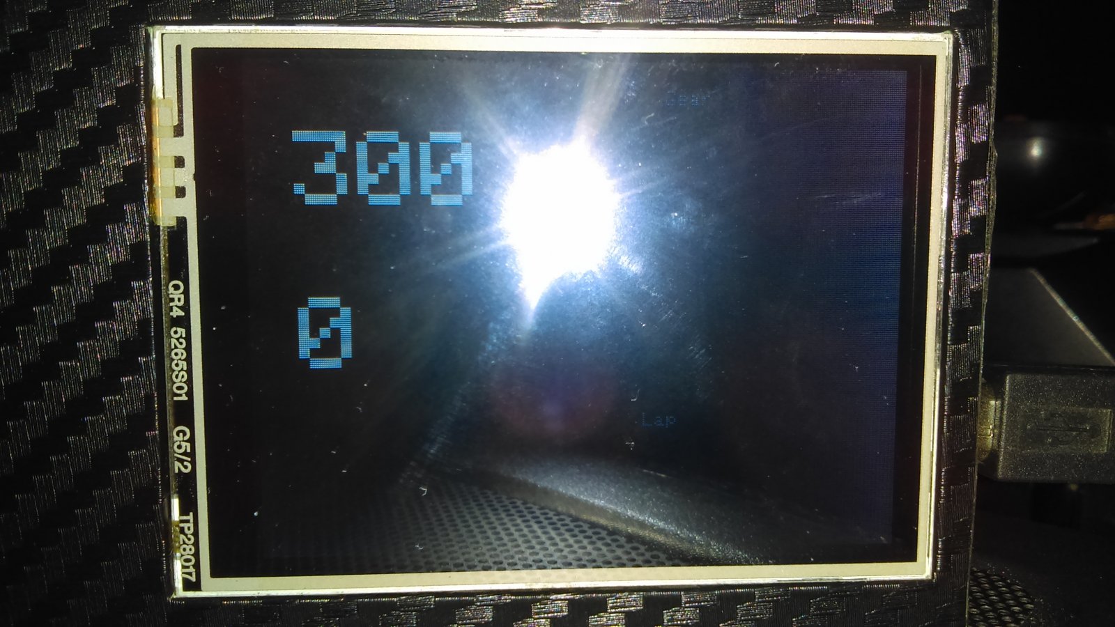

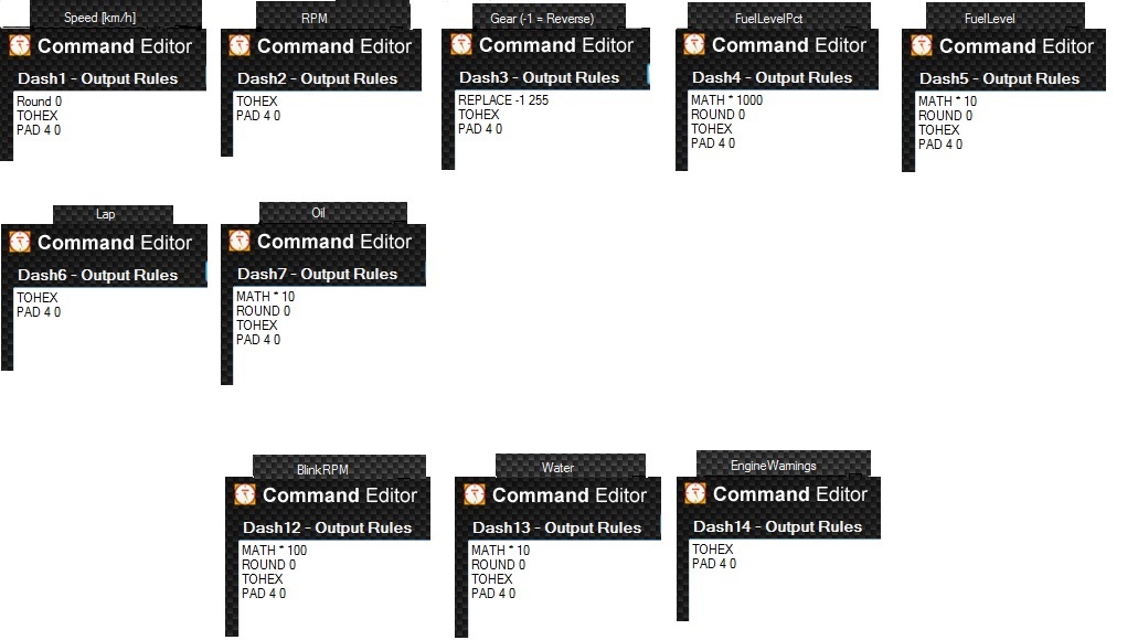

    hello everyone im having trouble with the code.. it keeps coming up Exit 1 cant comply to board.. any ideas

    Hi Evan
    Do you install all required libraries as stated in the OP?
    If yes please post screenshot with the error

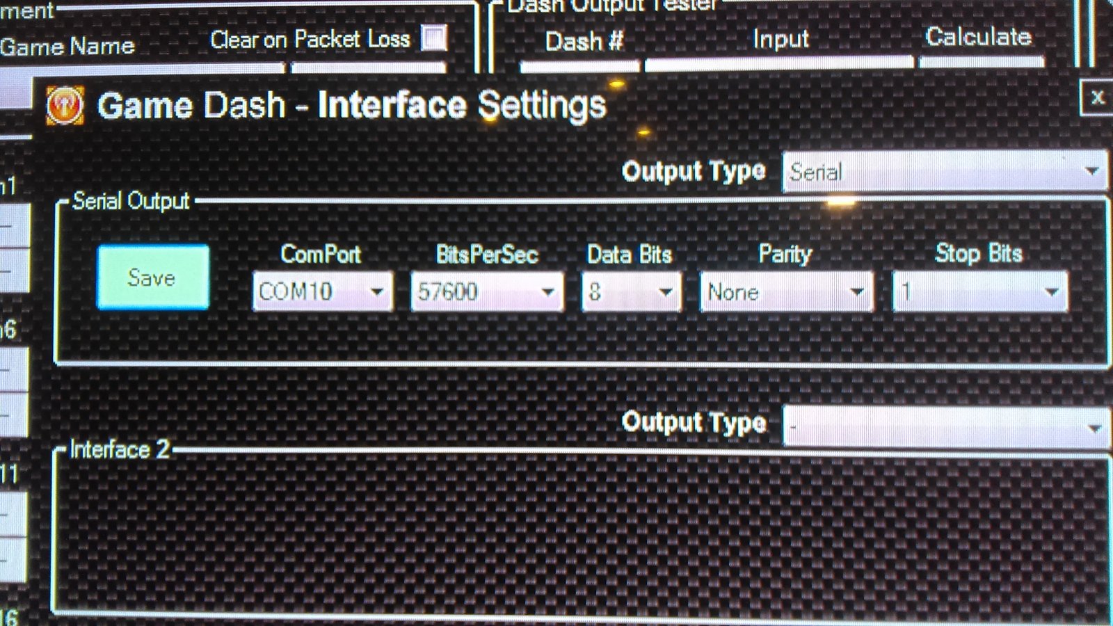

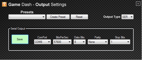

    hi mate
    ive copied your setting but everythings in the wrong place and wrong when i use 57600 everything in the right place but noting works in game.. the rpm changes to 300 just before entering the game on iracing but when i select a gear it still said N and the rpm is stuck on 300 any ideas

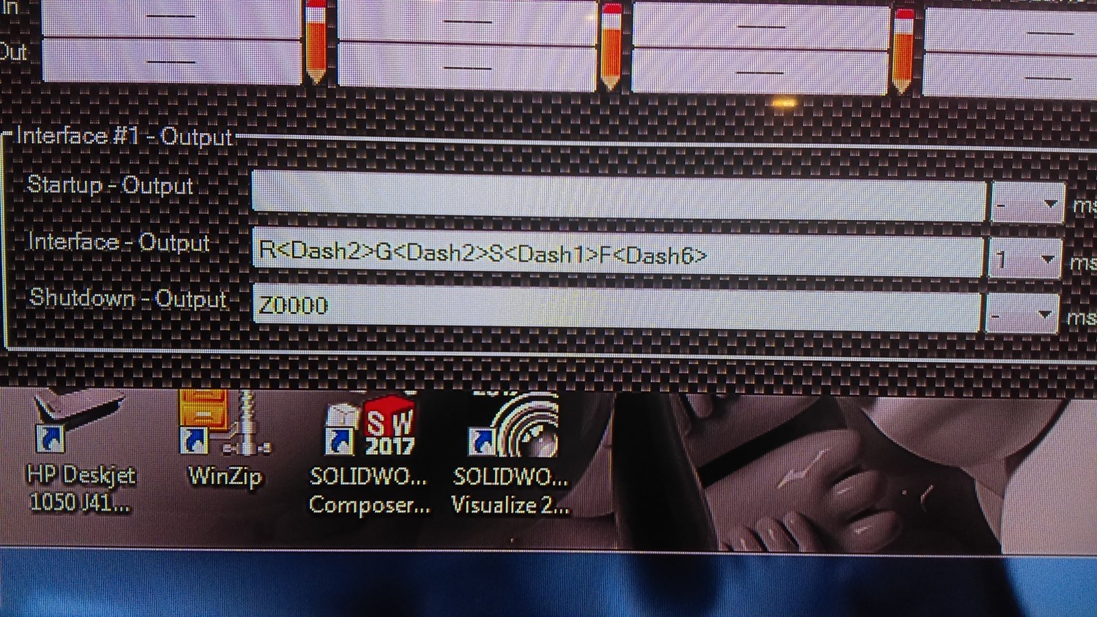

    yes mate ive found the issue i think ive got a screen up now..my next issue is when iracing loads a screen with the shift rpm and speed comes up but as the server open to the game the gear indacator flashers off and the rpm read 300
    when you go in game nothing is working i can see it working fine in simtools dash here are my settings i copied from here..
