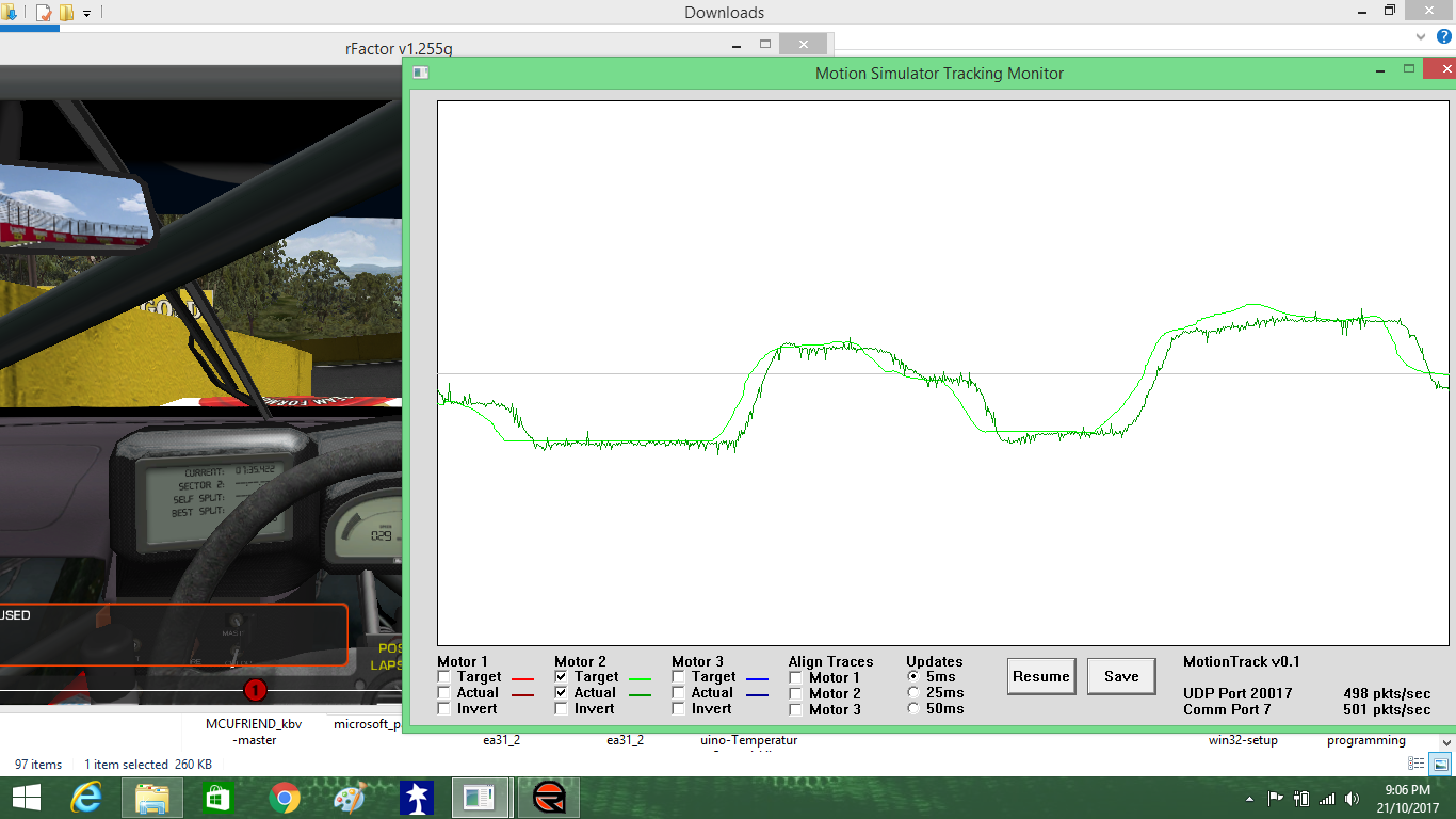

    i know this is an old thread now but have just done some testing. I am using an arduino mega and sabertooth 2 x 25 with @vthinsel code with tft touch screen that has made it really handy for changeing pid settings. Anyway using @RufusDufus simple scope it was really easy to track the differences pid settings and game settings made. Am very happy with the movement and response sim tools osciiliscope.png

    couple more shots of both motors this time across the top of mount panorama and down conrod straight in v8 supercar rfactor,
    Again very happy with it all so a big thanks to @RufusDufus the simple scope as it helped so much in the tuning of the rig.

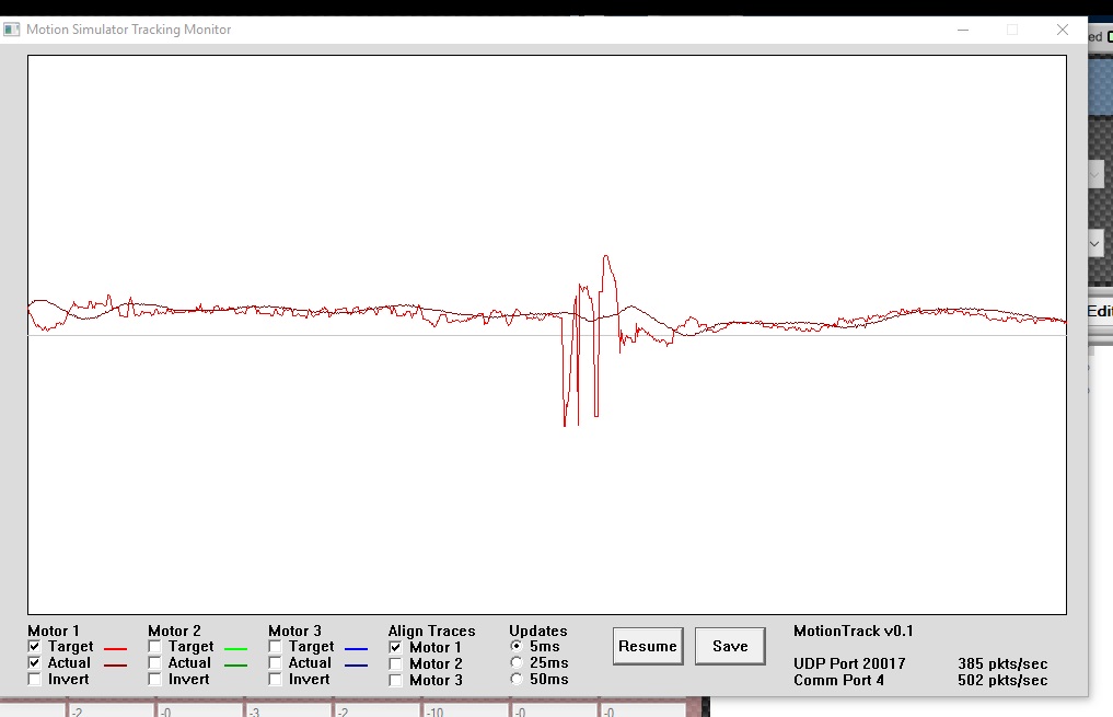

    That's what gives it to Surge, Heave and Pitch
    I think it's bad, as I felt in games I think it lacks resolution, how can I improve the rendering?

    no ideas to improve the operation, the curve?
