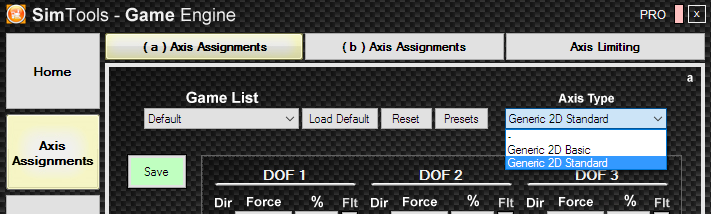

    Just updated .net framework 4.0 to 4.6.2. Now it works :thumbs Thanks a lot.
    Also thanks to Blame73 and spyderwash.
  2. Blame73
    Blame73 Well-Known Member
    Nov 6, 2014
    1,216
    8,316Coins
    +1,141 / 5 / -0
    You're using BASIC settings probably. You have to use STANDARD ones

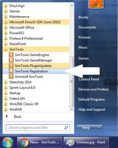

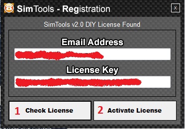

  12. speedy
    speedy Well-Known Member
    Feb 1, 2012
    1,193
    Alexandria , Egypt
    7,951Coins
    +1,288 / 10 / -0
    Go to purchasing SimTools and press Buy Now ...
    In the next page , insert the "Discount code" you've got in the mail and press "Apply" then it will cover your payment ...
    and get you a "second bigger licence number" for Free DIYers :thumbs ...
    That can be copied and past in the SimTools licence checking and activation ...
    [ found in the start menu SimTools ]
    Make sure to Exit the "Game Engine" & "Game Manager" .

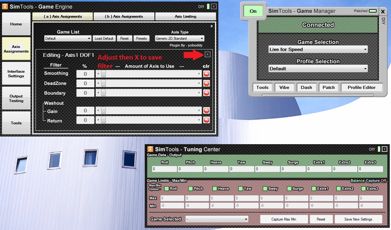

    vsp19.
    Yeah, but that filter tutorial is for version 1.3.
    In 2.0 there are a bit different, and smoothing
    not working, unfortunatelly....
    Cheers,
    George
  14. bruce stephen
    Jun 7, 2015
    1,286
    general contractor
    michigan
    9,115Coins
    +1,243 / 9 / -0
    Smoothing works.... How are you attempting to adjust and use it. It is much less pronounced than before. Use the main slider in the engineEDIT: GAME MANAGER/profile editor for overall smoothing.
    • Agree Agree x 4

  16. George Dobransky
    Sep 29, 2016
    223
    Hungary
    - 37Coins
    +130 / 4 / -0
    Bruce,
    in the engine there is no profile editor (or maybe I miss something). in the manager there is, if u mean that. Only the
    main level % effects some 'smoothing-like' thing, but I have to set it near to zero.
    I don't think that 'main level slider' has to mean smoothing?
    Isn't it has to mean the main level of the connected 'plugin' or the plugin's global level?
    But back to the filter smoothing in game engine. That slider 'smoothing' doesn't effect anything at me.
    I tried with '0' and after '100' - nothing changes. It looks like an unconnected slider at me.
    At you is it effect anything guys????
    Cheers
