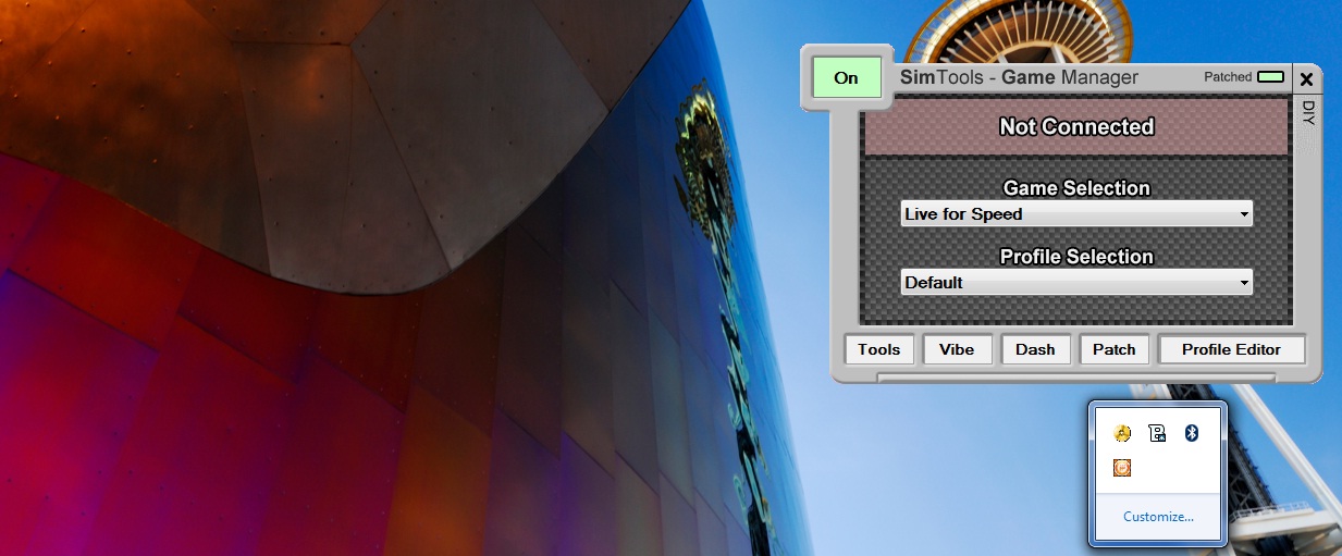

    I did also try Assetto Corsa! At what point should the the Game Manager say connected,
    When the Game Engine is opened or when the interface is correctly setup and connected?

    In Asseto Corsa GameRunning does not show until you are actually in the car on track
    Edit: Also you dont need any Interface settings for gamemanager to show game running as far as I can remember. Are you sure you have deleted all old simtools folders

    It's a windows 10 problem ... try to run both programs as administrator .
    Exactly when the Game Engine starts ... I have no interface listed and the status is "Connected" .
    If I quit the Game Engine ... it says "not connected "

    Unless the Axis Assignment and Interface setting's Tabs are blue....You aint Connected to jack.

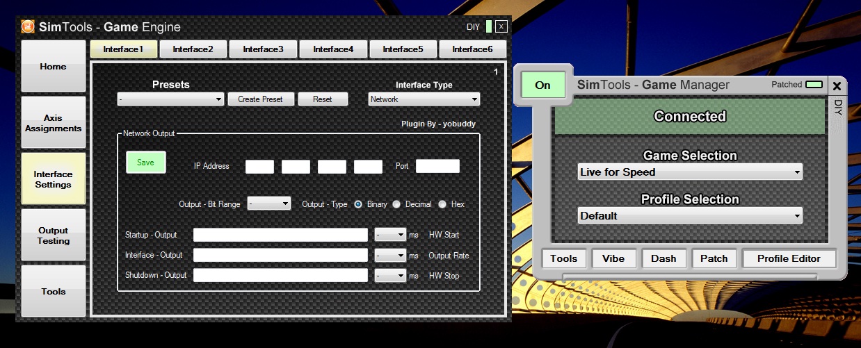

    It appears that your not patched. The connected status you are seeing is manager and engine. Axis assignments, interface settings will turn blue when you are connected to a game.

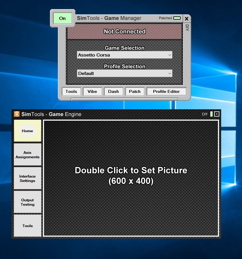

    @MWB open the game manager.. Bottom left it is labeled tools press it. Take note of the ip address in the upper right of the drop down.
    Click engine IP what does it say? put in the same IP address from the first drop down.

    I tried uninstalling Simtools and reinstalling it again! But I have the same problem, I have setup the interface and can control my sim from the output testing in game engine, I have downloaded Live For Speed installed it (C:\LFS) patched it (C:\LFS) and I can't get it to connect. I've tried running all programs as administrator. :(

    Do they match @MWB ?
    Missmatching these ip addresses allowed me to possibly duplicate your issue. This is why I ask.

    First one was 192.168.1.196 and the second was 127.0.0.1 Set them the same, it prompted me saying I would need to re-patch the games, so I've uninstalled LFS patch, going to open it first then I'll patch it and I'll let you know how I get on.

    ^ This is important, if you did not run LFS before patching then try unpatching, run LFS for a few laps and then repatch.

    @MWB before we worry about the in game we need to get you set up so that when you open both the manager and engine it shows connected. Without this they are not "talking" to each other.
