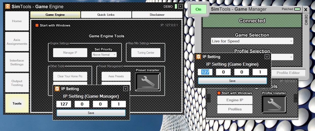

    @MWB ...

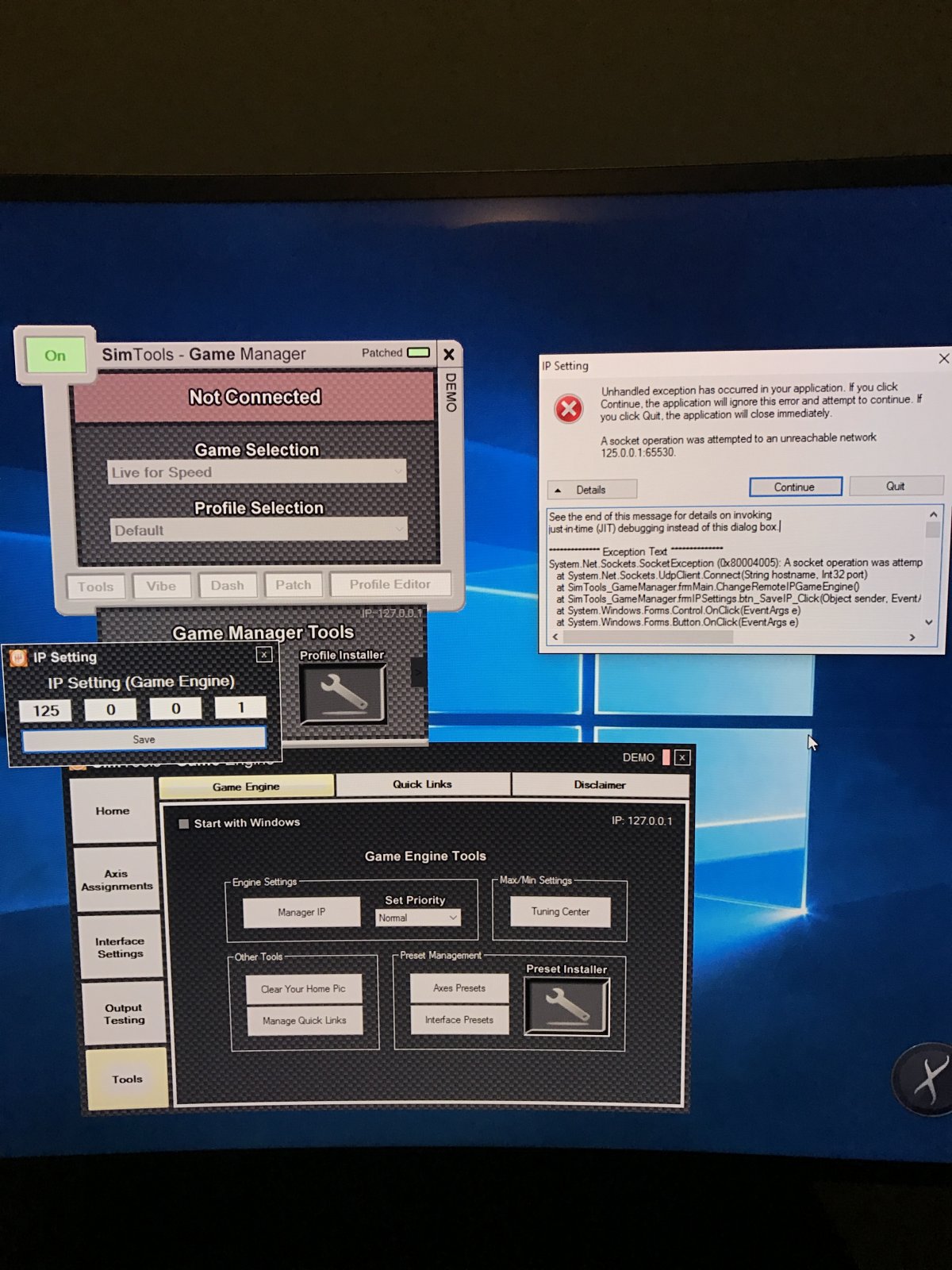

    I have managed to reproduce the error ... me windows 7 Ultimate x86 .
    In the Game manager write an IP 125.0.0.1 and save it press continue to reset the socket or may not needed as I was connected ... with that got me out "Not Connected" ... close and exit .
    Re-open Game Engin and Manager again "still not connected " and reinter the correct IP 127.0.0.1 and save it ... it should get you back to the connected status ... close and exit .
    Game patched and tested ...
    Let us know if that worked :thumbs ... Me just hate =>> windows 10 :grin ...

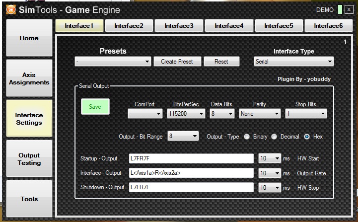

    When i have 2 Motors, must i set the interface setting to this?
    [A<Axis1a>][A<Axis2a>]
    I dont understand what A or B is.
    Many thanks

    Yes,I am assuming you are using SMC3 sketch? a and b designates the motor to be used a and b are like 1 and 2 on that arduino
    for two motors with SMC3 sketch your interface output string (engine/interface) should read
    [A<Axis1a>][B<Axis2a>]

    I using arduino with RacingMan sketch.
    When i understand that right,i must set this:[A<Axis1a>][B<Axis2a>]
    Right?

    no for @RacingMat code it needs to look like this
    you will enter the correct com port in the comport field

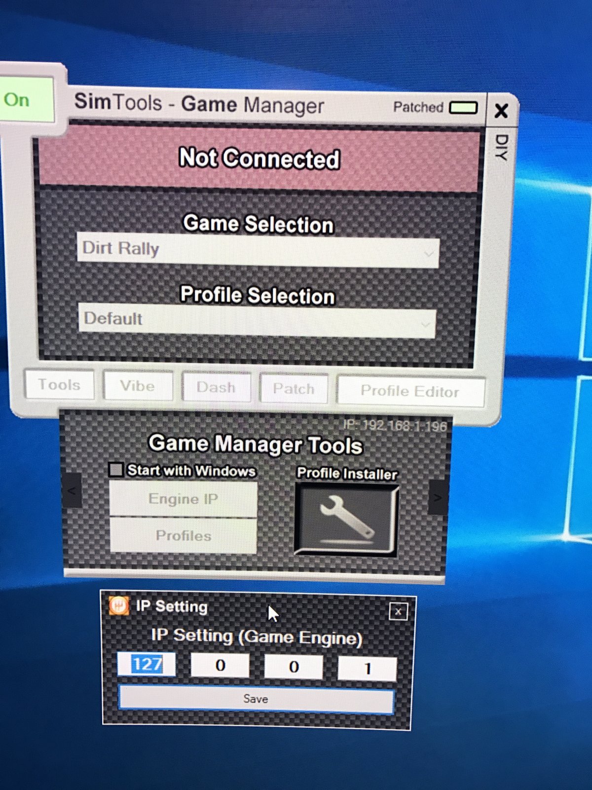

    Hi @bruce stephen, @speedy, @yobuddy

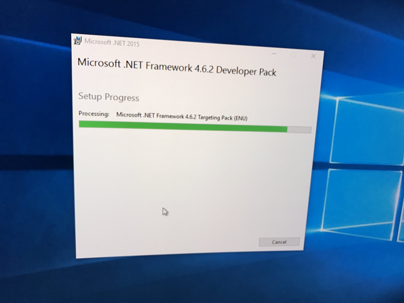

    I have tried what speedy recommended earlier, thing is the IP address will not change, if I click on tools in Game Manager the IP address in the top right corner says 192.168.1.196 if I click Engine IP set the IP to 127.0.0.1 and click save the IP doesn't change, if I then close Game Manager and reopen it the IP hasen't changed
    Also tried installing .net Framework 4.6.2

    @MWB ... Maybe it is something with your router auto DHCP ... unplug the cable from the network and try ... or leave it plugged and try to make the IP's within the same subnet mask as your network card like 127.0.1.1

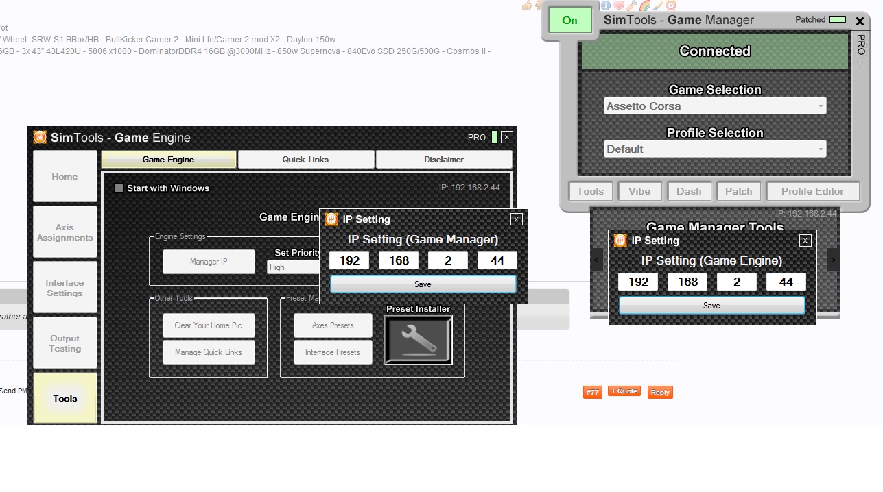

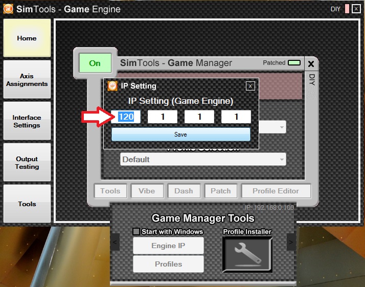

    :grin@MWB ok do it like speedy said in both applications but this time put in the ip (upper right tab of tools in manager) then do the same for the engine like this
    see if that work around does the trick.
    EDIT: This is what I was going to have him do last night as both apps have to match. He was tired tho

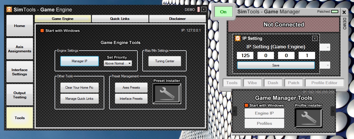

    @bruce stephen ... It seems like this is the only field that makes me unconnected ... no matter I change the other numbers to whatever ...

    @speedy according to your screenshot if you set your ip as 192.168.0.100 in both apps it should connect. Same as 127.0.0.1. I just figured he was set at 127.0.0.1 out of the box and it wasn't working that way so try something different. Not really sure what It changes as this is above my understanding. I just know it works on my system.

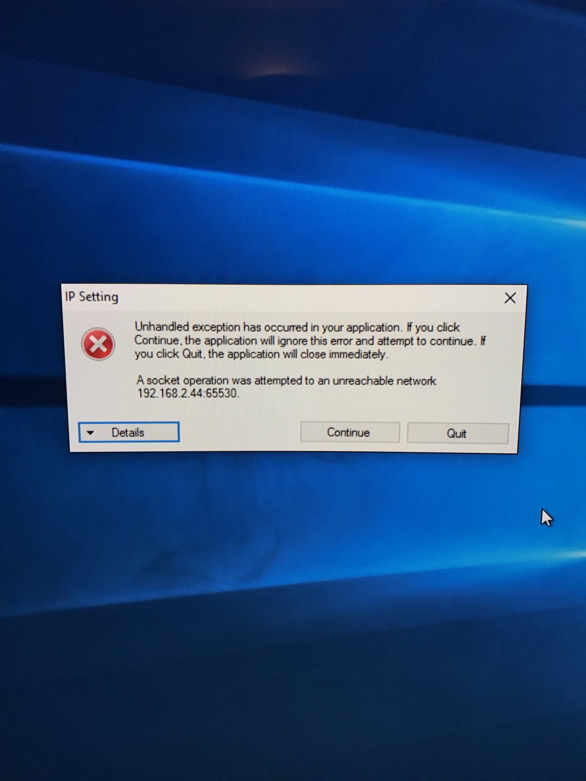

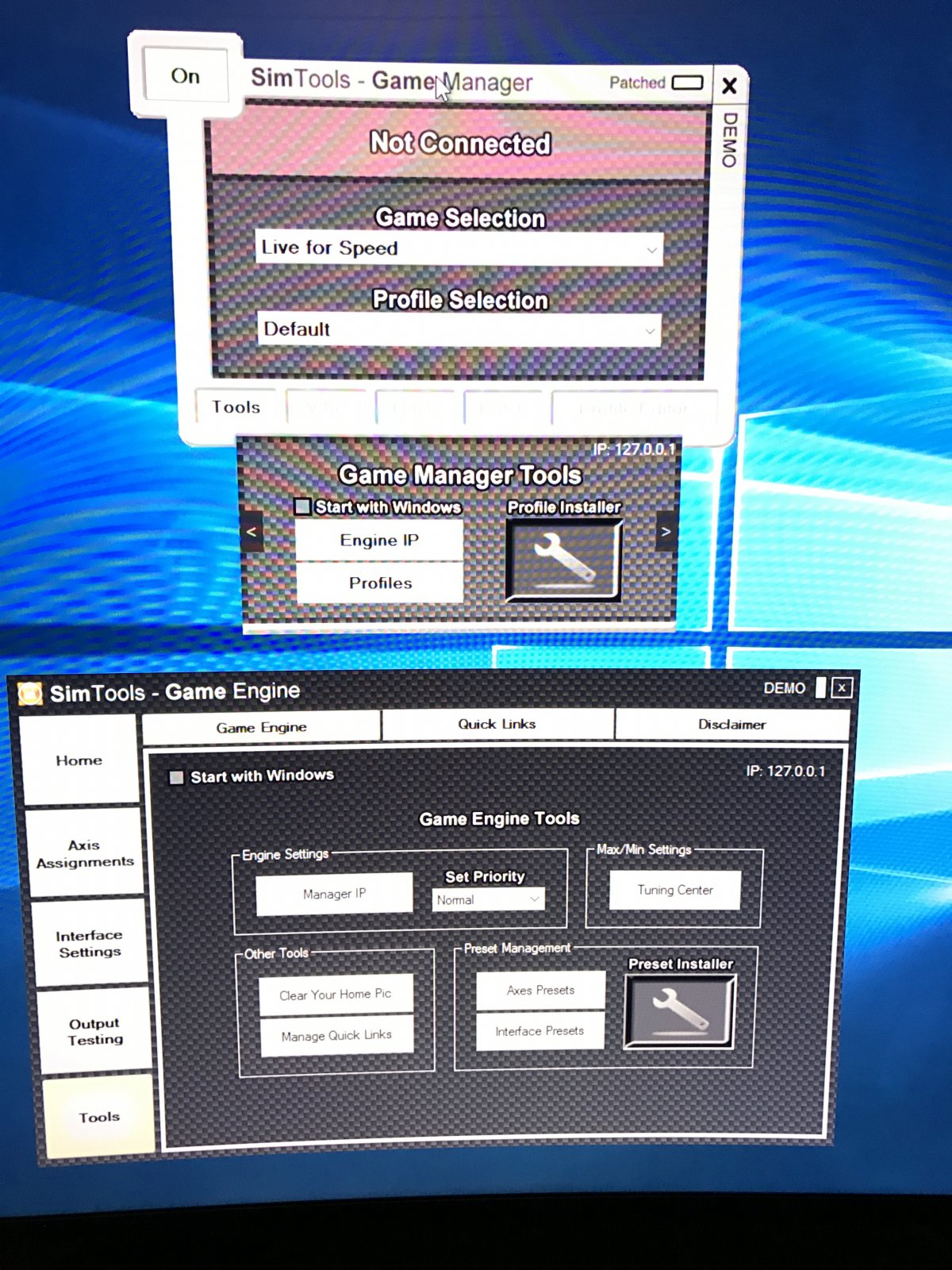

    Hi all, @yobuddy
    I removed my wireless dongle that seemed to alow both Manager and Engine to have the same IP address when the PC starts up, but if I try and change any of the IP settings I get various errors
    Both Manager and Engine with the same IP 127.0.0.1 no connection
    Error I get if I try and change the Engine IP

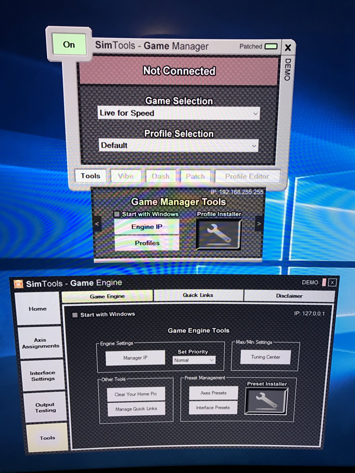

    IP on the Manager if I carry on regardless and close and open the program (192.168.255.255)
    So I tried putting IP 192.168.255.255 into the Engine, this happened.

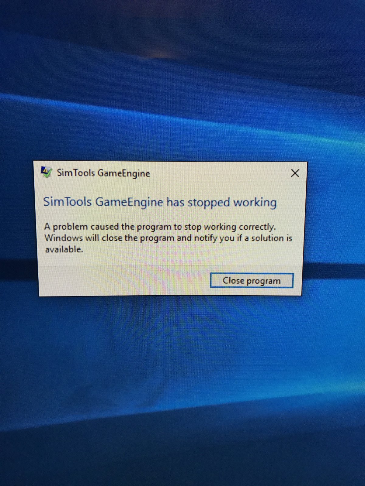

    Try to open Engine, get this
    I have no idea what the problem is :think:sos
