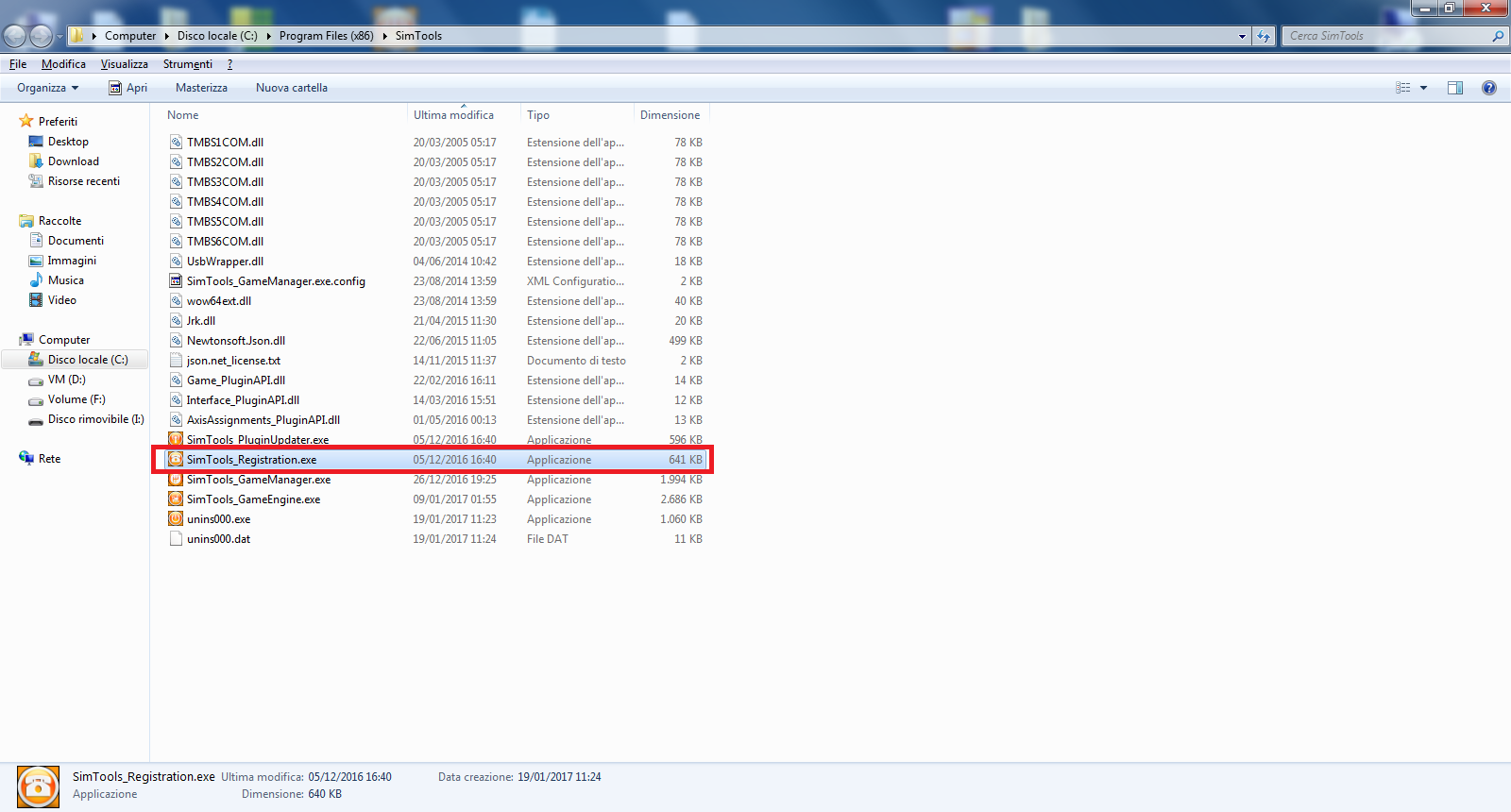

    Hi guys,
    Bought a license key for 2.0 but this dumbass can't find the place to enter it.
    Probably very simple but still to hard for me :p
    Can you point me in the right direction?
  13. ilbiga
    ilbiga Active Member
    Apr 4, 2014
    233
    Network Engineer
    103Coins
    +139 / 0 / -0
    Ciao, In the game installation folder you can find an executable called SimTools_Registration.exe. I have not done yet, but I think that it is enough to launch and follow the on-screen displays.
    Ciao, Nella cartella di installazione del gioco trovi un eseguibile che si chiama SimTools_Registration.exe. Non l'ho ancora fatto, ma credo che sia sufficiente lanciare quello e seguire le indicazioni a schermo.

    Tnx,
    I just finished building my new rig since I moved to the US, installed Win10 and having some issues with it (Like some files can't be opened as Administrator while it says I am).
    Also have a issue with my Microsoft account so maybe that is related. (will be fixed on Feb 4th)
    In the Setup folder of Simtools I only have 2.0 exe file, no registration exe.. (and can't open the EULA file which was also posted in this topic)
    If any ideas come up feel free to post (or put it in a PM ;))
  15. ilbiga
    Apr 4, 2014
    233
    Network Engineer
    103Coins
    +139 / 0 / -0
    You have not SimTools_Registration.exe the installation folder?
    I only performed a "full installation" and this is what appears in the folder:
    Try to re-run a full installation
  16. GTHQ_koop
    GTHQ_koop Active Member
    May 11, 2015
    115
    Something with airplanes..
    Lakehills Texas USA
    1,786Coins
    +65 / 1 / -0
    2DOF, SCN5
    Thanks again, re-install fixed it..!!
