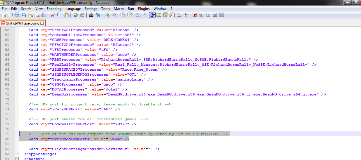

    Hello
    I'm looking for a way to run simtools and simhub at the same time ...
    They work independently, but not at the same time
    if i run simhub and simtools, simtools is enabled but the engines do not function and are free
    Have you a solution
    Thank you

    i had the same problem and excluded my simtools com port in SimHubWPF.exe.config (line 80)

    I excluded my com port in SimHubWPF.exe as you said and now it works fine without problems.
    I can already use both programs together.
    Thanks insanegr and yobuddy :cheers

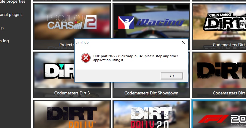

    Hi.
    I was able to run Dirt Rally and Dirt Rally 2.0 simultaneously on Simhub and Simtools.
    In F1 -2017 and F1 2018 only Simtools work if I turn on first.
    When I turn on Simhub an error message appears.
    If I turn on Simhub first it works and the simtools does not work.
    The door used is the same and gives conflict.
    Does anyone have any solutions for this?
