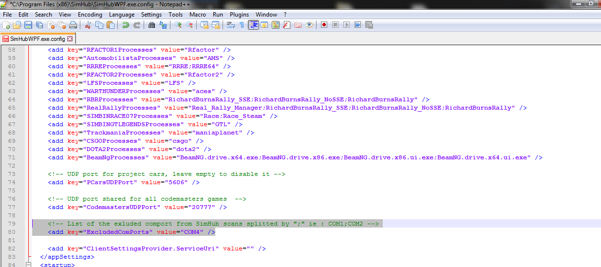

  8. Kashif Saeed
    Kashif Saeed New Member
    Nov 23, 2019
    16
    49Coins
    2DOF, 3DOF, 6DOF
    hello there,
    i am new in simtools and simhub.
    i tried to use both of them at the same time using Arduino but simtools is not providing any output values and i did not find simtools com port in SimubWPF.exe.config.
    looking forward for the solution.
    TIA.

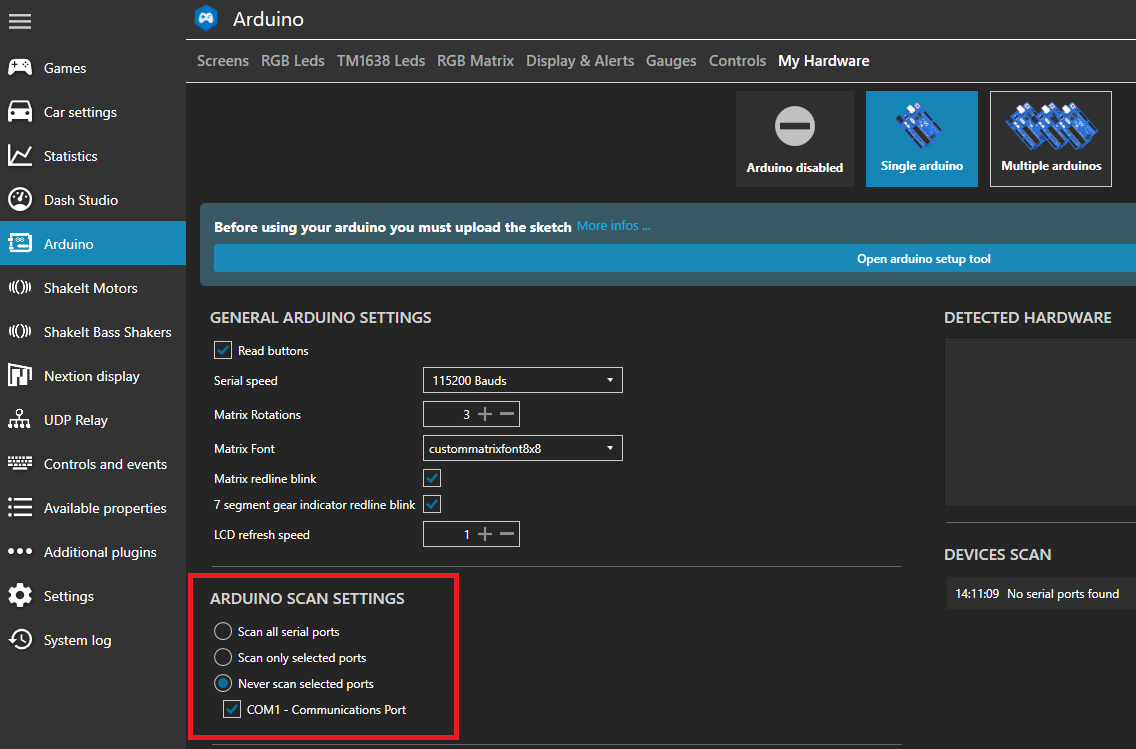

  16. pfm21
    pfm21 pfm21 build 3dof dinamic
    May 13, 2020
    157
    374Coins
    +34 / 0 / -0
    2DOF, 3DOF, DC motor, Arduino
    hy friend ca help me? i can't try line of inibite the por of simhub!!
    thanks
  17. insanegr
    insanegr !N$@n€
    Jan 14, 2014
    503
    Athens
    16,726Coins
    +499 / 1 / -0
    now you can exclude com ports in simhub app.
  18. pfm21
    May 13, 2020
    157
    374Coins
    +34 / 0 / -0
    thanks friend i try it
