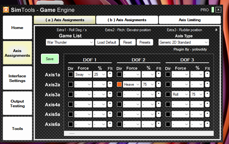

  14. Björn
    Björn New Member Gold Contributor
    Dec 1, 2022
    Germany Hessen
    - 11Coins
    Motion platform
    Good Morning!
    I'm Pretty new in the field of motion simulators - just bought a used YawVR bowl ;)
    The yawVR Game-Engine had an incredible amount of lag so I decided to try out the sim tools, which already feel much better. I try to dig as much as possible into the tutorials here but would be glad if you could share your settings for the axis Assignments.
    Do my settings make any sense for Warthunder?
    Where is the difference between the DOF1 DOF2 DOF3 rows? would it have a different output if I put all the axis assignments in DOF1 ? trying to figure that out ;)

    I haven't really played War Thunder with my YawVR bowl. But looking at the plugin I would do the following assignments:
    Axis1a: Yaw
    Axis2a: Pitch, Surge, Heave (possibly Extra2 (Pitch relative to earth) instead of Pitch depending on the aircraft and how you fly)
    Axis3a: Roll, Sway (possibly Extra1 (Roll relative to earth) instead of Roll depending on the aircraft and how you fly)
    You want each Axis row to total 100%. How you divide it up is up to you.
    I assume you are using the Interface Driver for YawVR posted above. Makes setting up SimTools with YawVR much easier.
    You should check out the YawVR discord if you are not on it already.
    Good luck.
  17. Björn
    Dec 1, 2022
    Germany Hessen
    - 11Coins
    Motion platform
    Thanks a lot! will try this and play around with the percentage distribution =)
