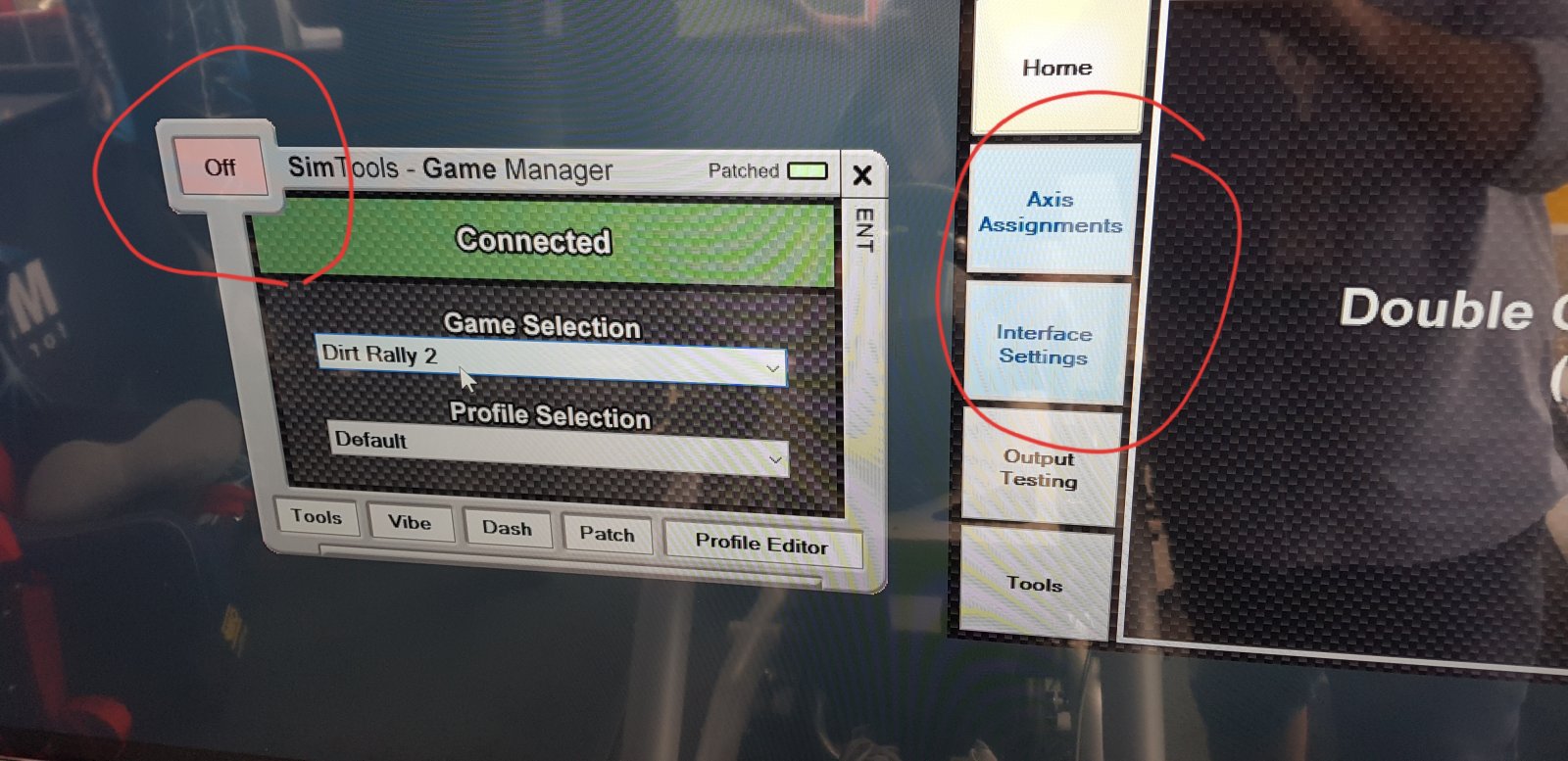

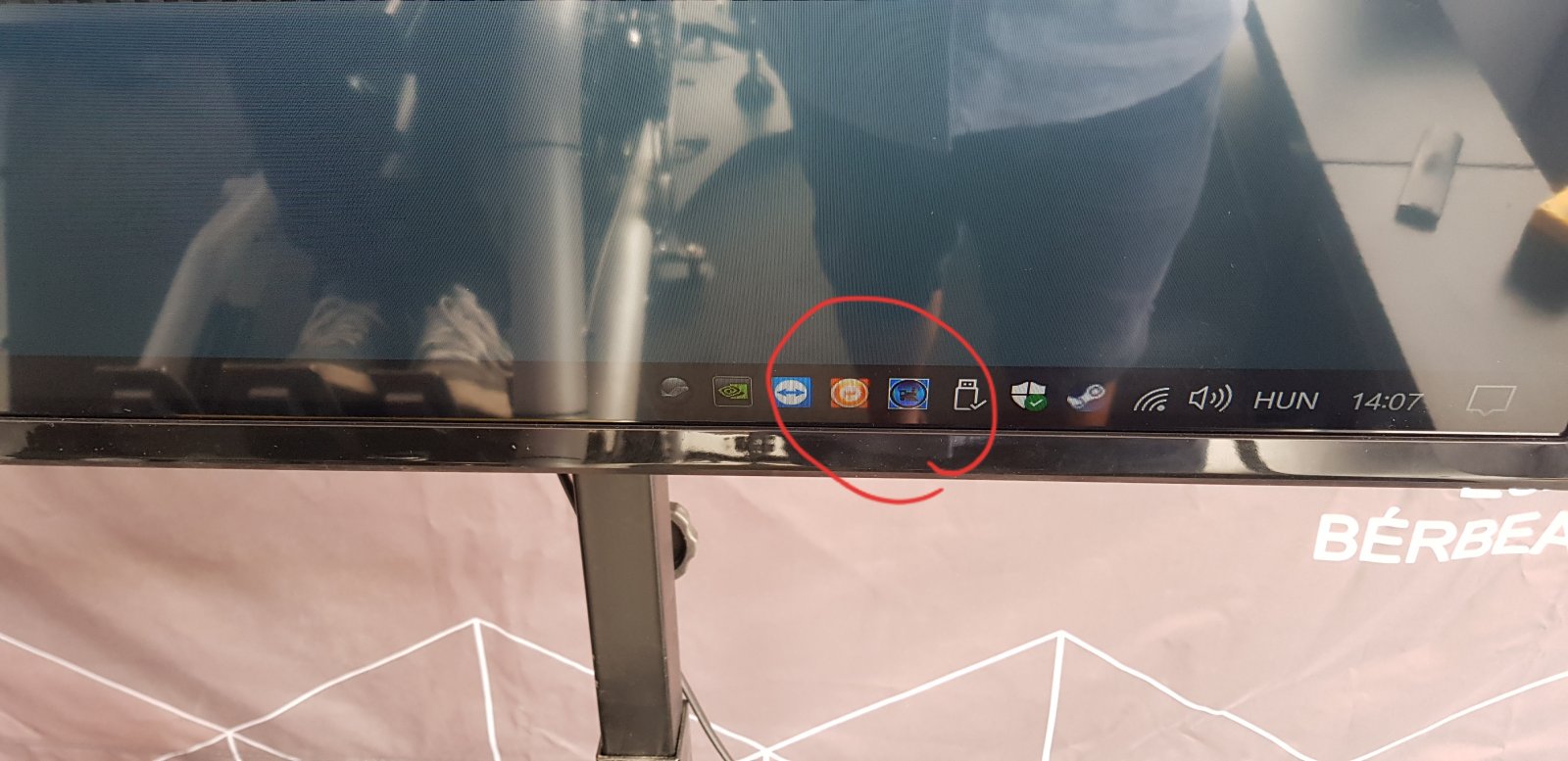

    After this installation, I experienced many good changes, this is an awesome update, thanks for that,
    But I do not understand one thing,
    During dirt rally 2 game - after a pause and restart - simtools stops 2 axes from 5, and the game engine's icon blinking blue.
    I must restart simtools game engine all the time after this situation,
    what could be the problem with this?
    please help me, what does blue blinking of icon means?

    Can you please post a picture of the icon that blinks blue, as I am not sure if it is game manager or something else.

    Yes, here they are

  12. yobuddy
    51,747Coins
    +5,205 / 19 / -0
    This happens when you try to exit GameEngine and the sim still needs to center.
    It will blink blue till the centering is done and then exit.
    Take care!

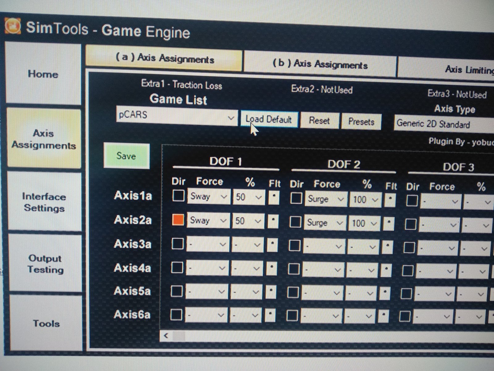

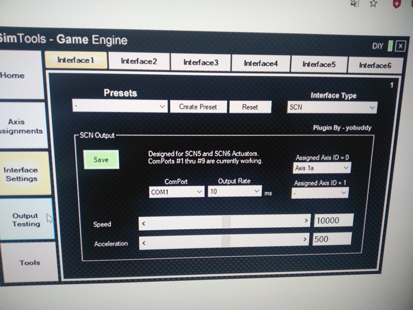

    Hello to all. Im using 2 scn5 at the back of a seat and i installed the new simtools and arent working correctly. Im getting mad.
    The seat works correctly.
    I have the same axis asigments in a and b axis.
    And in interface settings 1 assigned axis:0 to axis 1a and interface 2 assigment axis id 0 to axis
    I also modified surge max and min but nothing happened.
    Please can somone help me ,
  19. yobuddy
    51,747Coins
    +5,205 / 19 / -0
    Does the seat center when you start GameEngine?
    Have you used the seat with a older version of SimTools?
    Have you tried Output Testing and setup your default Axis Assignment profile?
    Let me know buddy, take care!
