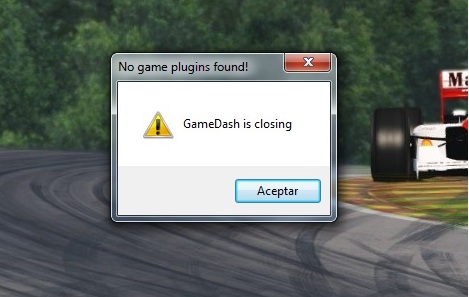

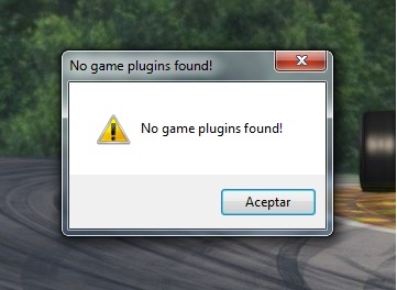

    Hi. Maybe ayone could help me with this? I follow all procedure to install Gamedash, but appear these screens. What must I do? In Game Manager, Dash ouput setings is enabled.
    All the best.

    Game Dash for Simtools v2.0 has not been released yet

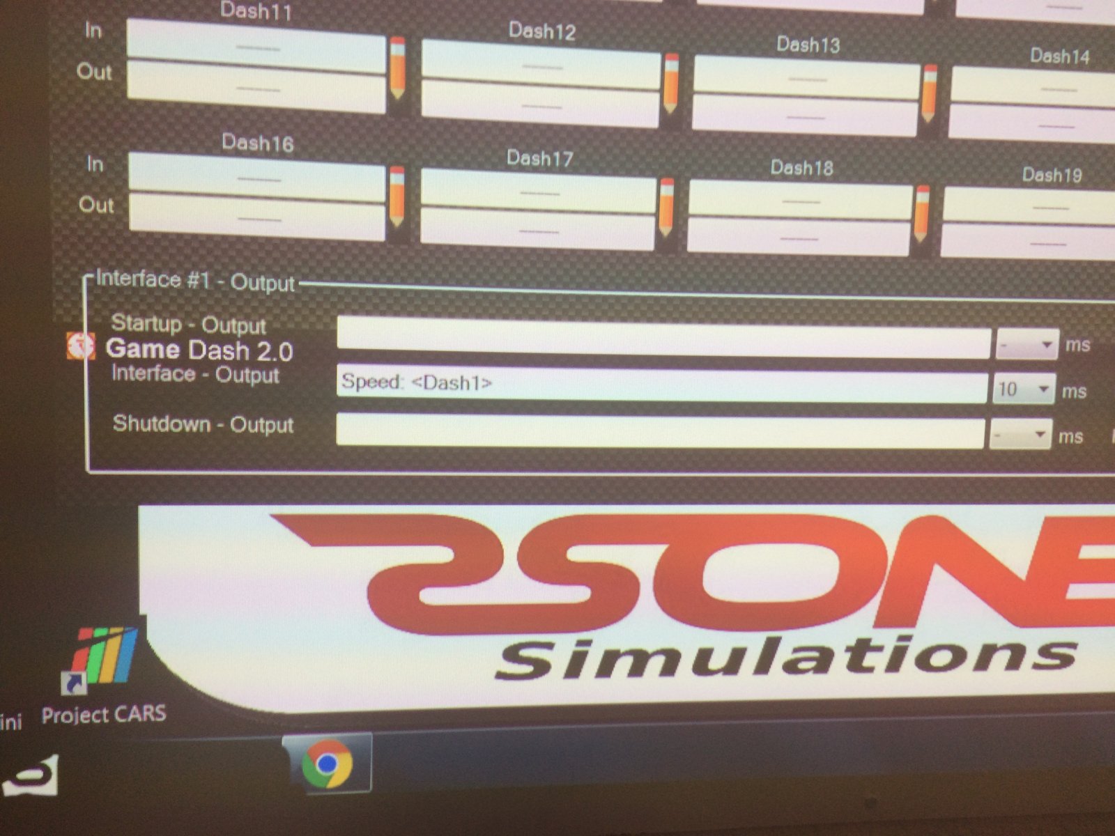

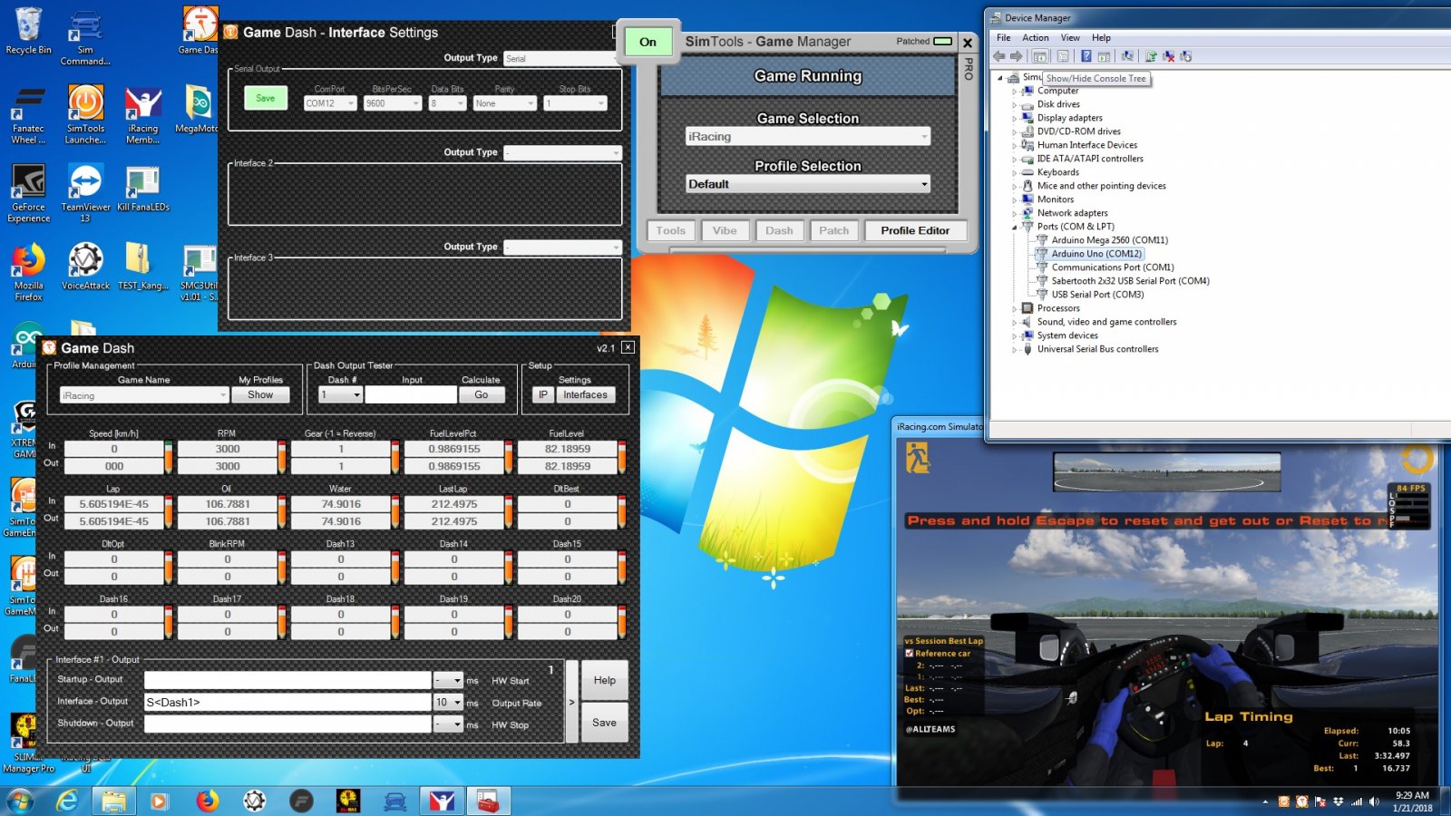

    Thanks for the great addition, I am currently trying to implement fans and struggling pretty bad. I have my arduino program setup to receive serial commands in the form of S followed by a three numbers to represent the speed. for instance at S100 would turn the fans on full speed and S000 would turn them off. I can confirm this works great by opening up the arduino serial monitor and manually typing in different commands. however I cannot for the life of me get game dash to send the commands to the arduino. I have iracing working to the point that I can see values being updated in game dash but again no output to the arduino.
    I am running windows 10 with an arduino uno on com 12. the arduino is setup for a baud rate of 9600.
    speed dash is using output S<Dash1> on interface 1
    Math is setup as
    MATH * 1
    ROUND 0
    PAD 3 0
    I have purchased a pro license which i understand is required to get dash working, but it seems like i am missing something simple.
    any help is greatly appreciated

    I created a 2 virtual ports and linked them and I can see data output from the game engine when I do axis testing. however I get no output from game dash when applying the same method. It seems like I need to somehow turn on game dash output and I don't know how.
    I have also tried the virtual output within game dash and I get nothing.

    I got it working, everything was correct, I just uninstalled/reinstalled game engine, game manager and dash. everything is working now.
