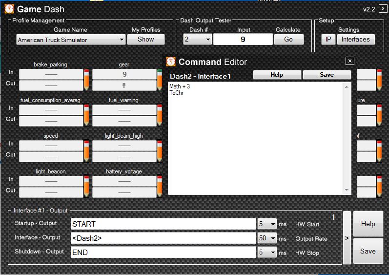

    Thanks for the help guys. I’m still not having much success. @yobuddy Math +3 works to remove the negative numbers but adding ToChr is returning unusual symbols in the output. Some gears are not outputting anything and the others appear like Windings.
    If I do not apply any conversions and try to Serial.print the incoming string in the arduino serial monitor it just remains blank.
    Here is my serial interface settings:
    This is some of the output characters:
    Here is another example which shows the functions applied and the virtual output
    I've been running various test code on the Ard such as these:

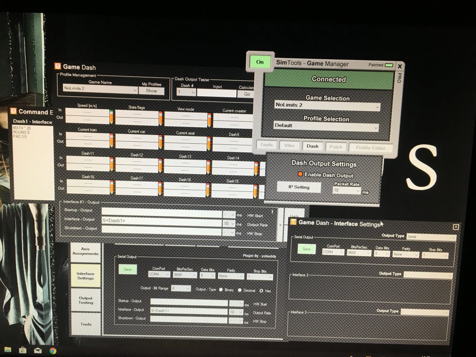

    I have just updated game dash to v2.2 and now I'm having the problem I had before with my fans blowing at full speed if I turn game manager on and off. Only way i can stop it is by unplugging my uno and plugging it back in again.
    Cant think for the life of me how I fixed it last time it was doing it.

    Yep, That is expected.
    These chars correspond to the acii table and they hold the value you would expect.
    So all you need to do I believe is convert the string to an integer in the ard.
    int InInt = atoi(InData);

    @SilentChill
    Are both GameDash and SimTools running the latest version?

    @yobuddy thanks so much for your continued help on this forum. It's amazing how much I am learning from trial and error and from the info on these pages. I discovered something, which is fairly obvious in hindsight - you can't use the ARD serial monitor when simtools is communicating with the board. I spent two evenings reading and revising my code wondering why I had no data before I realised that!
    I just setup an i2c link to a second board and passed it the incoming data so I could see what was going on with a second com port. Well I now have my gear value appearing correctly :grin

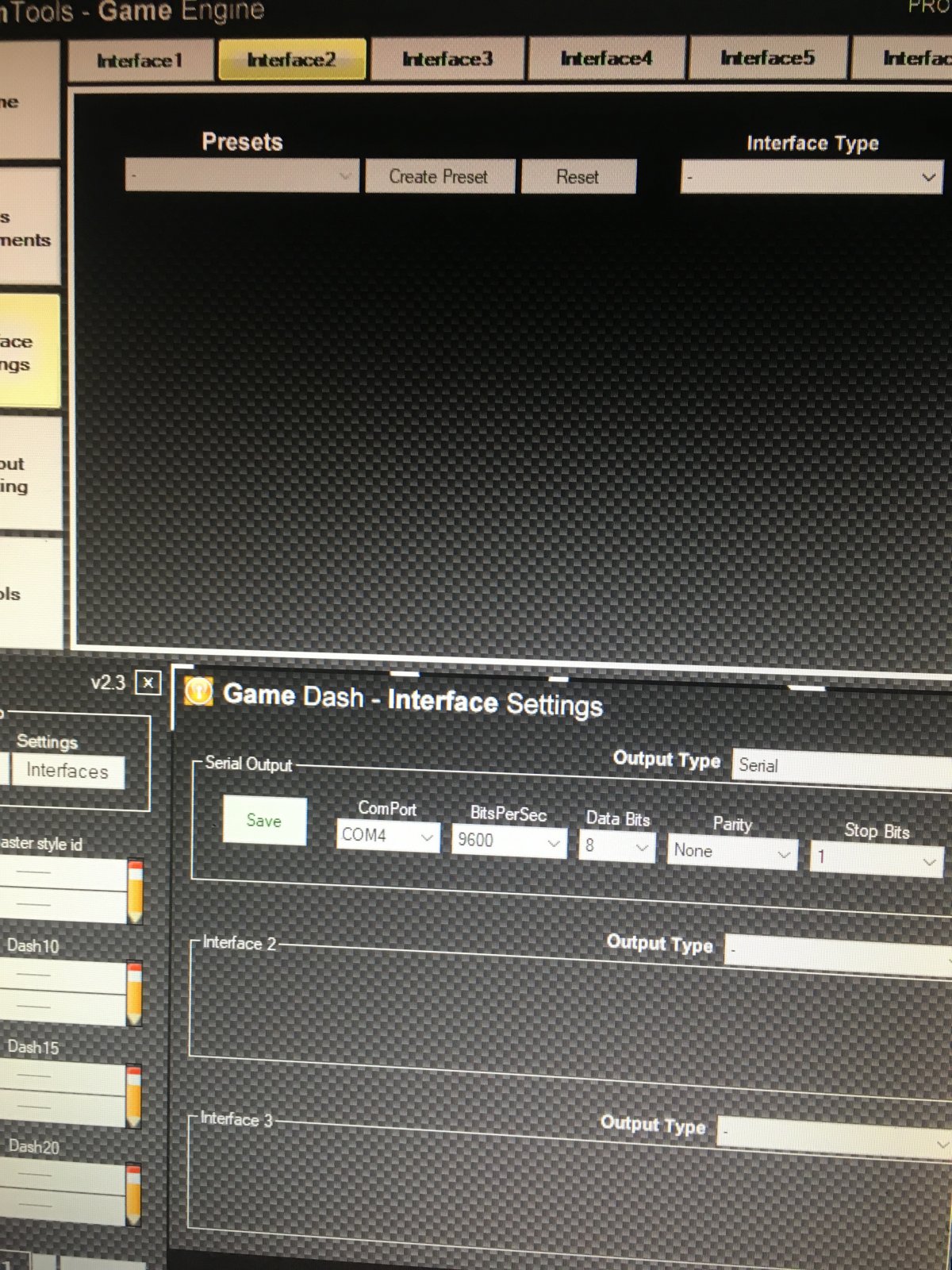

    I use game dash v2.3 and simtools v2.4 and now I have a problem with full fans speed when I start the game. The only way I can stop it is by disconnecting the usb cable. I started the game several times with the same settings and the fans worked as they should.
    Anyone have an idea?
    P.S. I use arduino uno with code by @SilentChill on com port 4
    I reinstalled the game dash and everything works perfectly again !!! :)))

    The problem is not solved. After restarting the computer, the fans run at full speed again. I tried with and without oculus rift cv1. I tried reinstalling the game dash again, but that no longer solves the problem.
    I'm going to go crazy with this. This morning I turned on the pc and started the game and everything worked fine, I restarted the pc and started the game again and the fans were running full speed. Game dash normally reads speed from the game both when everything is ok and when the fans are running at full speed.
    I made a video that you can see in the links below:
    Work fine
    https://drive.google.com/open?id=16g1twhYgY9o9tF21eVek-dxHrpmho4Wo
    Full speed
    https://drive.google.com/open?id=1cuTL-BXj5Dc6DAh_GiZlrhY91AhBAKlE
    Full speed
    https://drive.google.com/open?id=17mKbai2Z-CUfWQSC1htJfexarCBUAy9w

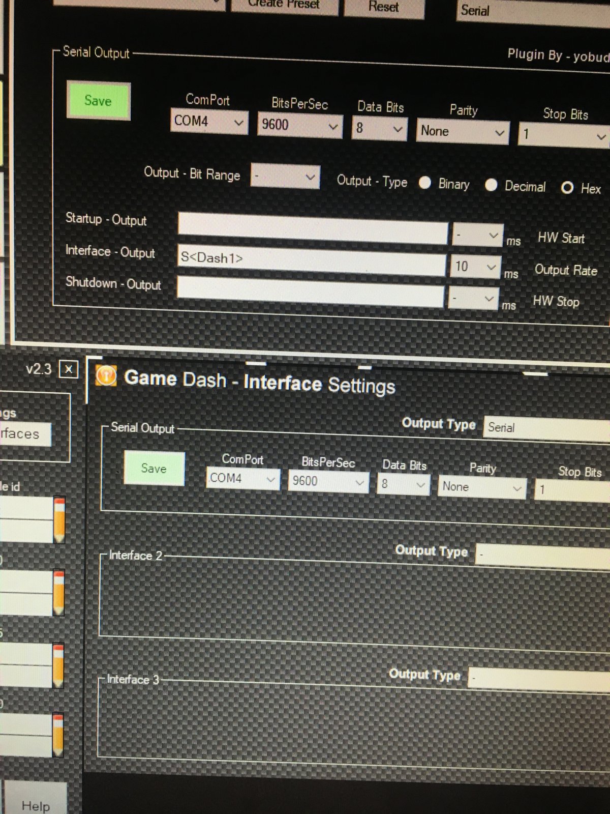

    Definitely problem solved !!!
    The problem was that I had 2 same interface settings typed in game engine and in game dash.
    What i did to solve it is that i removed interface settings from interface 2 in game engine.
    When it doesn't work
    When it works
