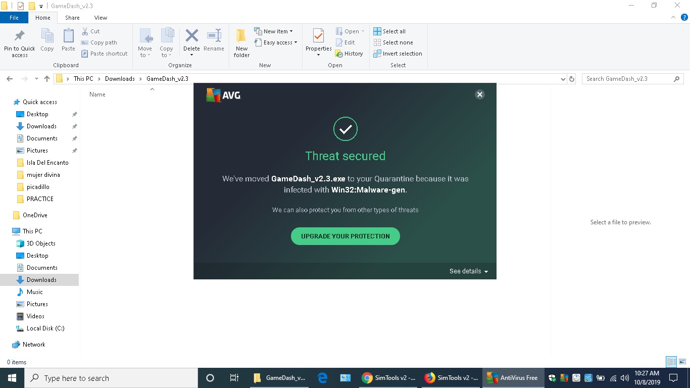

    when i download game dash and extract.. it says it is infected with malware?
    im getting virus from the 2.3 download, but 2.2 is ok..

  5. hannibal
    hannibal Active Member
    Sep 29, 2018
    677
    4,492Coins
    +298 / 4 / -0
    i used free AVG
    i dont have any issues with simtools 2.4
    and game manager runs OK for me..
    also running game dash 2.2 was successfuland ok for me
    how ever game dash 2.3 i am getting anti virus warning.
    i also experience my temp folder being filled up with remote scratch files, and i had next to 1 percent free drive space left after i downloaded game dash 2.3..
    can someone download and double check?
    i really think its infected...
    i also download Gamevibe.. no problems there...

    I am using Kaspersky Total Security, and it also prevents me from unzipping and installing Game Dash 2.3. Never had problems with 2.2.
    I added security exceptions to Kaspersky for the Game Dash folders and the file itself in order to exclude them from anti-virus scanning, but it did not help.
    When installing Game Dash with deactivated security software, Game Dash is deleted as soon as I restart Kaspersky. My next step will be to contact Kaspersky support for checking if I missed anything.

    as @noorbeast explained, i reported it as a false positive to the avg servers. when ever avg clears it hopefully ill have it installed and running.
    usually ill let files that have issues that i assume is safe added as exception even though avg flags it..but after something ate up drive space i got concern.. and i hope it was not game dash that caused it

    im happy to report that gamedash 2.3 is good with AVG antivirus! :)

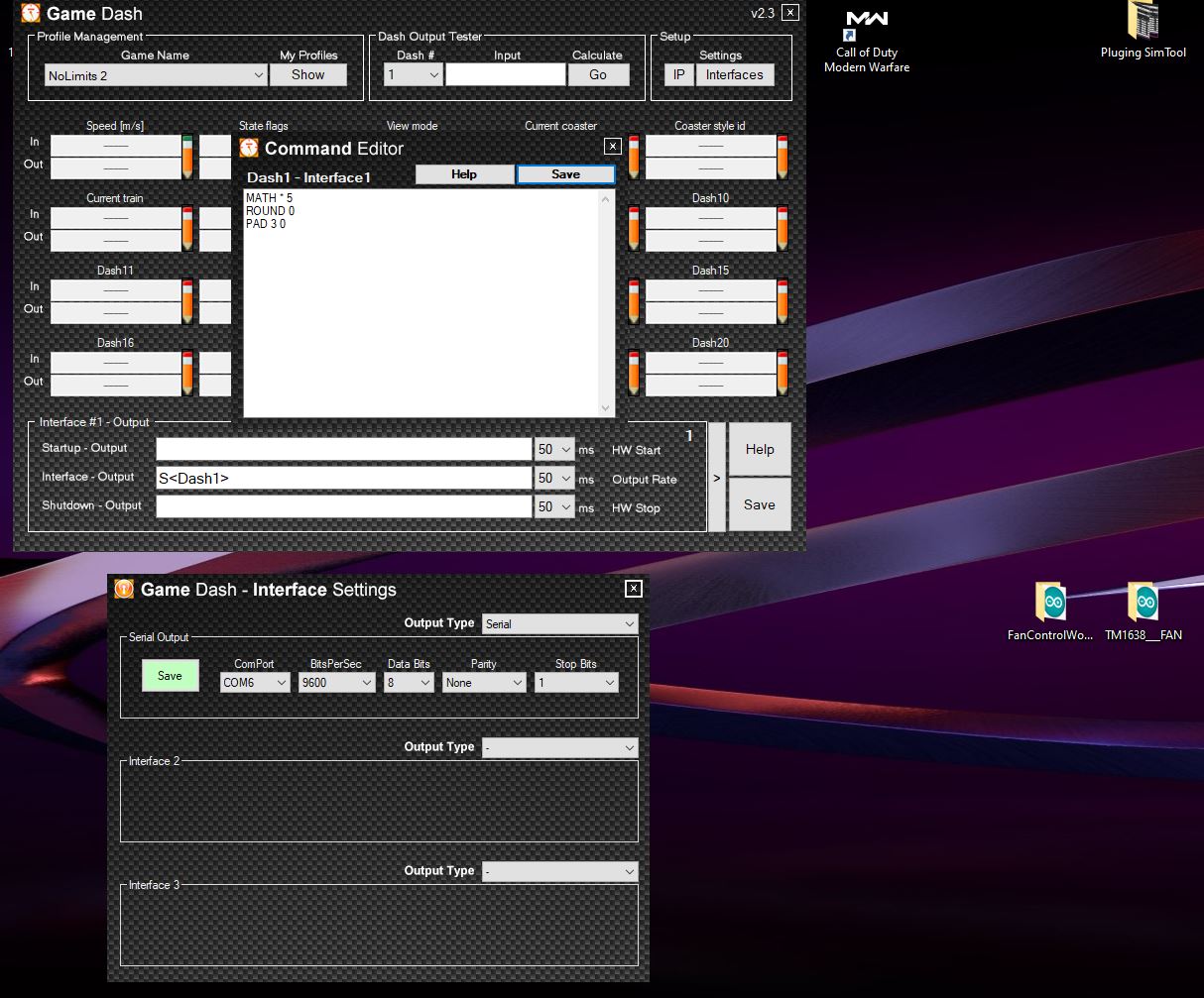

    Bonjour,
    j'ai un problème avec le système de ventilation, j'utilise la carte monstermoto avec les ventilateurs seaflo et une arduino uno r3.
    J'ai tous configuré comme dans le premier post de silentchill mais la ventilation ne fonctionne que quelque seconde quand je met 50ms dans interface output si je met 20ms rien ne se passe.
    si je débranche usb et que je rebranche ça remarche mais pas longtemps (environ 5 secondes)
    j'ai changé de cable usb, de carte uno et le variateur avec le même résultat.
    j'ai regardé les pilotes de la carte arduino, du gamedash et simtools j'ai bien les dernières version.
    j'utilise aussi gamedash avec un tm1638 et il fonctionne parfaitement sur dirt rally ou rollercoaster
    Je viens de reinstaller l'ensemble des logiciel simtools
    J'ai installé Game engine et gamedash sur un autre pc, avec un adressage d'ip, et j'ai le même résultat
    si vous avez une idée je suis preneur
    I have a problem with the ventilation system, I use the monstermoto card with seaflo fans and an arduino uno r3.
    I have all configured as in the first post of silentchill but the ventilation only works for a few seconds when I put 50ms in interface output if I put 20ms nothing happens.
    if I unplug usb and I plug it back in, but not long (about 5 seconds)
    I changed the usb cable, uno card and the drive with the same result.
    I looked at the arduino, gamedash and simtools drivers, I have the latest version.
    I also use gamedash with a tm1638 and it works perfectly on dirt rally or rollercoaster
    I just reinstalled all the simtools software
    I installed Game engine and gamedash on another pc, with ip addressing, and I have the same result
    If you have an idea, I'm interested

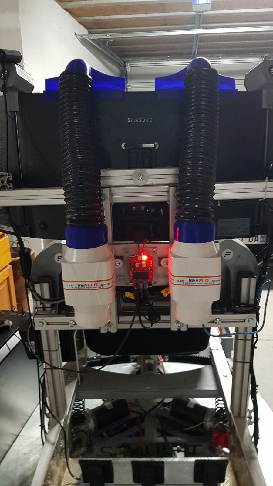

  10. RacingMat
    2,234
    21,099Coins
    weird, it looks like your power supply or hbridge shut down... it's a big beefy fan?
    show us some pics
  11. dutiti
    dutiti New Member Gold Contributor
    Feb 23, 2018
    15
    - 240Coins
    20200105_203833.jpg J'utilise des ventilateurs seaflo 130cfm, qui consomme 2amp chacun et une alim de 10amp. (j'ai changé d'alim avec le même résultat)
    je pense que le problème est lié avec le port USB ou le logiciel gamedash
    quand je met 50ms dans interface output rate sa marche environ 5 secondes si je met 20ms sa marche environ 1 secondes et ça s’arrête puis je rebranche l'USB c'est repartie pour 5 secondes ou 1 seconde.
    I use seaflo 130cfm fans, which consumes 2amp each and a 10amp power supply. (I changed the power supply with the same result)
    I think the problem is related to the USB port or the gamedash software
    when I put 50ms in interface output rate it works about 5 seconds if I put 20ms its work about 1 seconds and it stops then I reconnect the USB it is left for 5 seconds or 1 second.

    for example this...
    MATH * 5
    ROUND 0
    PAD 3 0
    'DOF Sway 15 (<- %)'
