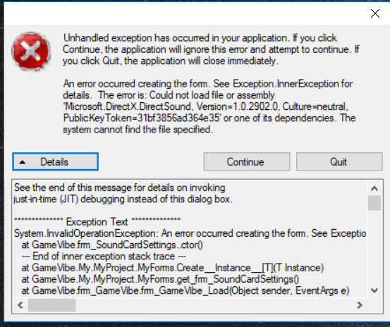

    how did u go to fix this ive got the same issue
  14. jcgsa40
    jcgsa40 New Member
    Jan 6, 2018
    New York
    - 55Coins
    Hi JACOAJ484,
    After reinstalling Windows 10, I went to https://www.microsoft.com/en-nz/download/details.aspx?id=8109 , downloaded and run DirectX runtime. I had tried it once before and it was unsuccessful. It worked the second time.
    Good luck.

    Hi jcgsa40,
    yep I tried exactly what u tried and it worked first time, very good, and thanks for the advice, cheers.

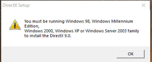

    I have the same problem as at least 3 person in this thread. I tried all the recomendations as above. No luck.
    Tried downloading the microsoft files, no luck, dx9, no luck installing at all, (popup message below)
    Any help?

    Thanks, I gave it a try the second time and it works
