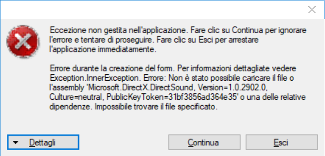

    Sorry for the question. A damn virus has damaged my system. :mad:
    I'm trying to restore everything, but when I start Game Vibe I get this error:
    I tried to reinstall the Microsoft .NET frameweork, but I can not fix it. :(
    Any suggestions? :confused:
    Thank you very much!!!
    22,228
    154,837Coins
    +11,227 / 57 / -2
    Make sure .net 3.5 is installed: https://www.xsimulator.net/community/threads/simtools-v2-game-vibe.11359/page-7#post-155042
    And reinstall DirectX: https://www.microsoft.com/en-nz/download/details.aspx?id=8109
  7. ilbiga
    ilbiga Active Member
    Apr 4, 2014
    233
    Network Engineer
    103Coins
    +139 / 0 / -0
    Thank you @noorbeast ! I have resolved the issue!
    The problem was directx. I do not know why, but reinstalling it from scratch everything started to work again! :cool:
    Thanks again. :cheers

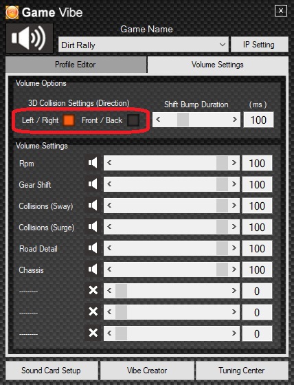

    Greetings again @yobuddy .
    This could be a stipulating question, but I need a clarification.
    Using the Game Vibe in "3D mode" and configuring the 4 channels [FR+FL & RR+RL], the positioning of the speakers must follow the same pattern, or the pattern must reflect the configuration of Game Vibe, ie [FRONT+REAR & RIGHT+LEFT]?
    These are two schemes to better explain the doubt:
    Thanks to you and to all the people on the forum that support our projects! :thumbs
  9. yobuddy
    51,776Coins
    +5,206 / 19 / -0
    Use a setup like in the first pic you posted.
    It just makes more sense as that is how the cars wheels are sitting.
    Take care,
  10. ilbiga
    Apr 4, 2014
    233
    Network Engineer
    103Coins
    +139 / 0 / -0
    Thanks @yobuddy!!! :thumbs
    I was misled by these flags:
  11. yobuddy
    51,776Coins
    +5,206 / 19 / -0
    That flips the direction of the 3d output is all buddy.
    should you hit a wall head on and the sound comes from the back, this will fix it.
    Take care,
  12. ilbiga
    Apr 4, 2014
    233
    Network Engineer
    103Coins
    +139 / 0 / -0
    Ok, now it's clear to me. In fact it is a function that can be useful.
    Thank you @yobuddy ! :thumbs
