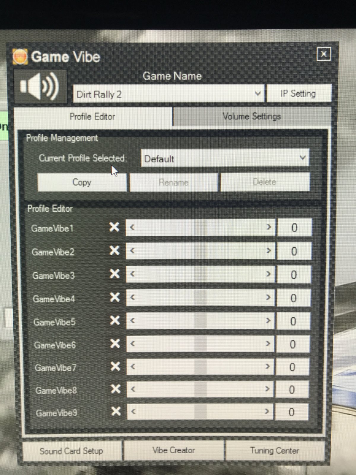

    But in both profile manager and volume settings I can’t change anything. I believe it should say like RPM... instead of GameVibe 1 -9 and a cross and zero. Can’t change nothing.
  3. yobuddy
    51,772Coins
    +5,206 / 19 / -0
    It needs to connect to the game once, then it will know what the outputs for the game will be.
    If your all setup, launch the game once and it will fill in the RPM, Turbo, etc...

    I have launched the game many times and it won’t fill in RPM... why isn’t it connect to the game? It is patched.

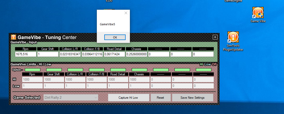

    I would like to go back to my popup problem.
    Indeed, I have never been able to run the gamevibe application because as soon as I run a race on dirt rally (and dirt rally 2.0) a popup appears (see screenshot) and blocks the sending of data. If I close the popup, the data is updated, but immediately a new popup appears.
    I have installed the dxsetup, I have the latest versions of simtools + gamvibe + plugin games.

    It's Ok now !! I don't know why, but the problem was my tablet android connected with share connection in USB. When this connection is disable, all ok. Now i put my tablet with wifi connection to my dashboard application (it's not cheap for me, but it will be ok until i find better)

    Finally, my problem solving had nothing to do with my usb connection ... idiot I am!
    It was the story of the list separator "point" that had to be put in place of the "comma" in windows settings (https://www.xsimulator.net/community/threads/simtools-v2-game-vibe.11359/page-6#post-153758)
    However, there is still a small bug in Dirt Rally 2.0.
    If you want to "start again" in the middle of a race, the problem reappears. As if the telemetry values contradicted each other between the two moments: stop and restart.
    By cons if we stop the game manager then we close the popup, and restart the game manager, everything goes as it should.

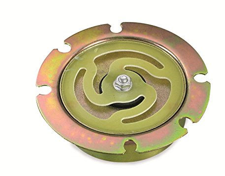

  15. baykah
    baykah Active Member
    Sep 1, 2016
    137
    Toulouse - France
    414Coins
    +133 / 0 / -0
    Hello guys,
    Question, do I need an analog low pass filter between my DAC to my shaker amplifier ?
    The dac is USB/jack cheap sound card, the amplifier is from an old auto project
    See the picture for my shacker type.
  16. ilbiga
    ilbiga Active Member
    Apr 4, 2014
    233
    Network Engineer
    103Coins
    +139 / 0 / -0
    Ciao @baykah
    For Game Vibe use, you don't need low pass filters.
    I use the same bass shacker in your pictures with an amplifier directly connected to the right/left channels from the Game Vibe dedicated Sound Card. :thumbs
